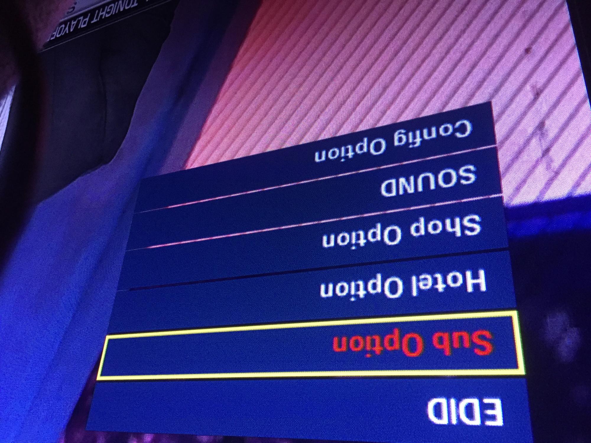

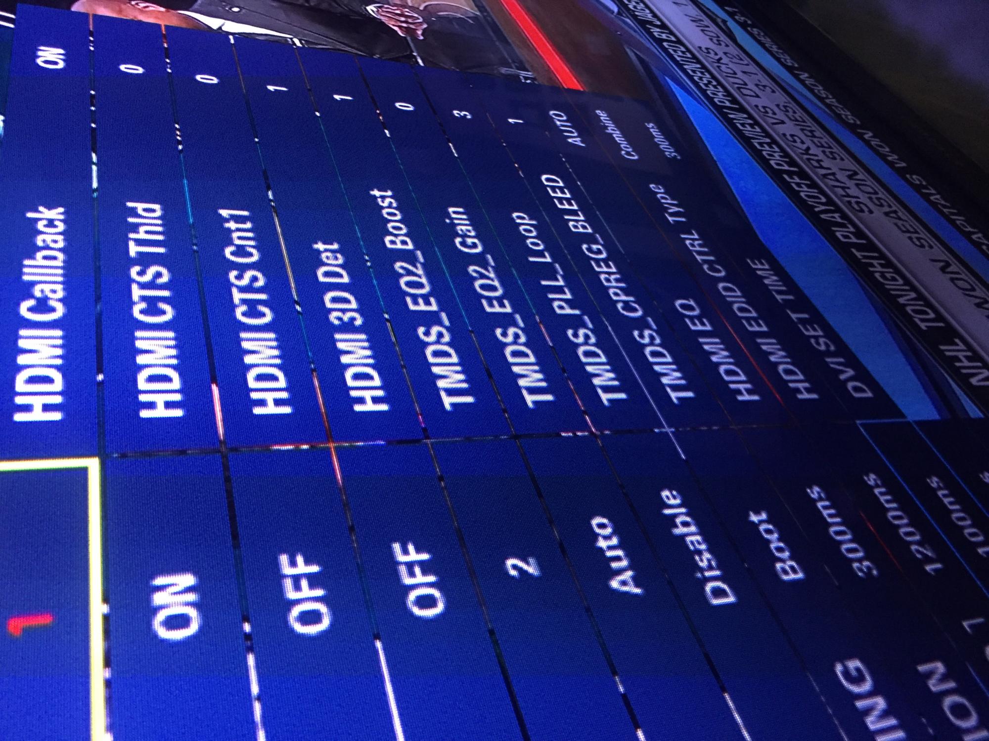

        Re: Samsung P58C8000 ~ Power Supplies have failed (2)

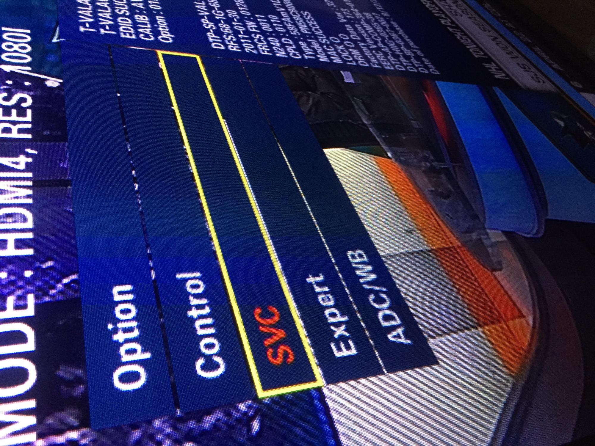

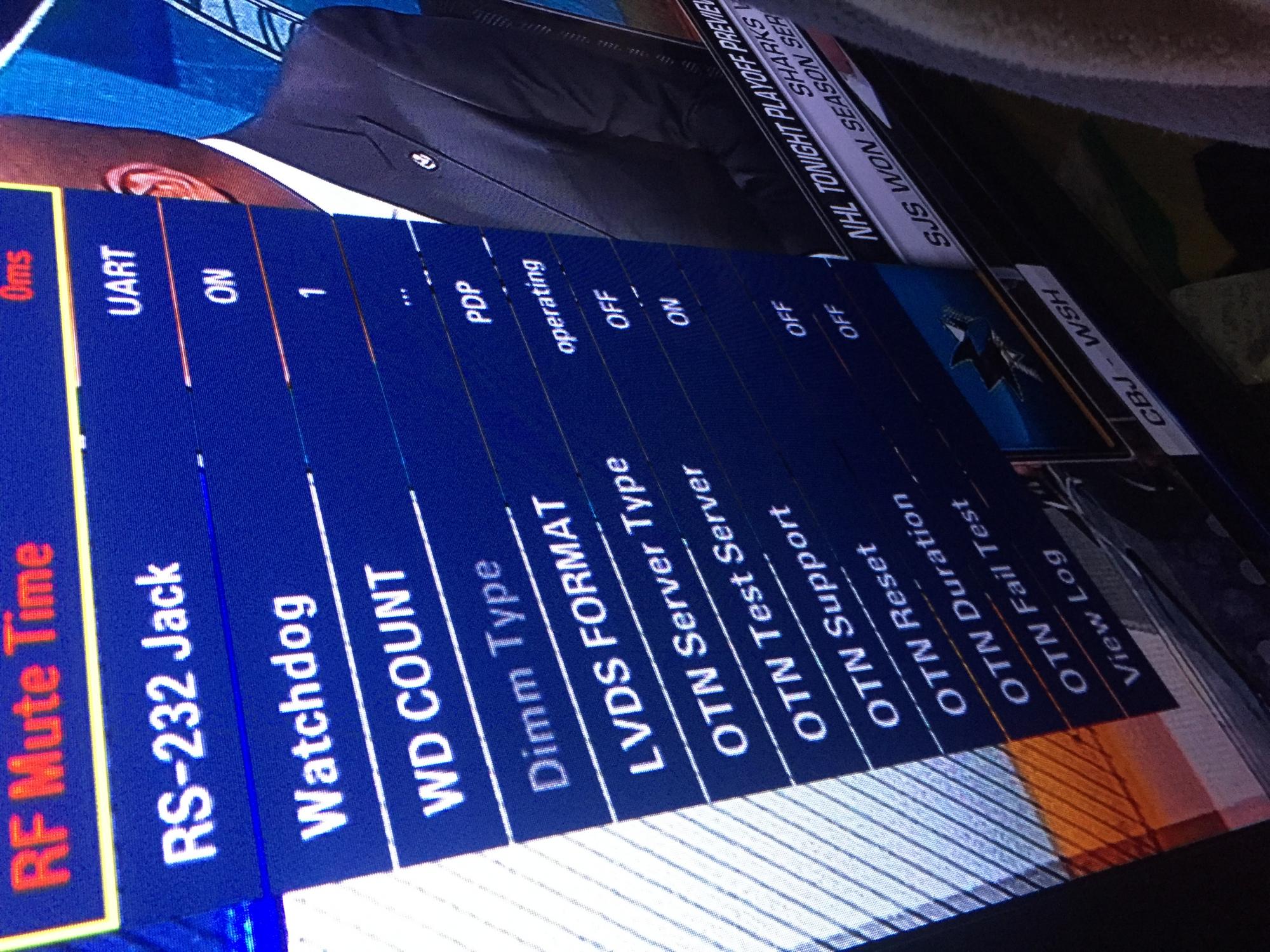

        That link to the AVSforum is helpful, and most of its logic led me back to try the Hotel Menu and to turn that setting on. Did that, but it was another dead end.
        I'm going to post all the pictures I took tonight of these Factory Menus, and hopefully they will ring a bell.

          #44
          And, here are a few more, including the last 2 focused on the HOTEL MENU .....
            I'd think that .zip needs to be unzipped unless explicitly stated somewhere to just change the extension.
            • freakaftr8
              • Oct 2012
              • 3743
              #46
              Yes indeed. You shouldn't rename the file. The bin file exists within the .zip. use winzip or windows built in unpacker for this. Mac should have one too.
              Renaming the zip file will cause an unknown file architecture and the TV will not understand what this file is

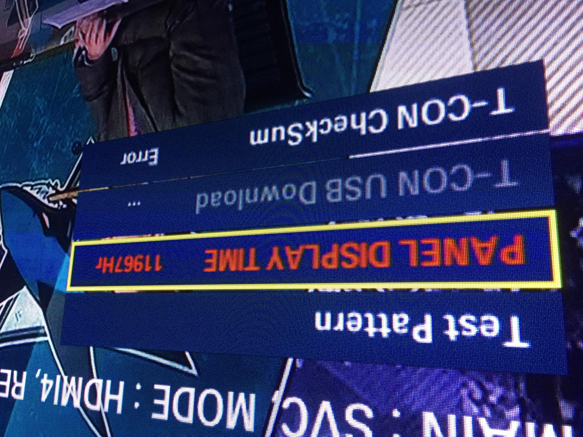

                Hello all ~
                Yes, the Zip file was opened automatically and I saw all the files located within. It was the bin file itself that still had an icon with a zipper image, so I was wondering if I needed to somehow unzip that as well for it all to work.
                But, here's the latest on the story:
                I am pretty confident that the 3D58 file is now installed on the tv. It took me several tries and several steps that were slightly different than any scenario that I read about on the AVSforum, but it was pretty close to what I found there. When I have a bit more time, I will try to reconstruct and delineate what I did to make it work. The key was to get into the EXTENDED service (or, factory) menu ..... and not simply the "regular" service (or, factory) menu. There were a number of new and more detailed options that showed up when I finally managed to get in the EXTENDED menu, and the PDP Panel and USB D/L were two of them.
                For now, I want to give a quick report on the degree of success I found in the aftermath of the 3D58 file upgrade via USB.
                There was some improvement, but not as much as I was hoping for. Initially, it looked like I had gained quite a bit, but after some time working with it this morning I have realized that I still must have the Vs up pretty high in order to both get rid of the banding and have the white screens be primarily void of the pink hue. Right now, I have the Vs set at 218. Anything less is bothersome to my eye. Again, no banding shows up until I kick it all the way down to 212 or less, but anything less than 218 is too discolored by the overall pink hue that exisits in a more comprehensive way across large portions of the screen. More "blotching than banding".
                I was really hoping that the 3D58 file would correct this to the point where I could set the Vs back to 210, or at the least not get up over 215. Not really the case. It is better than before, I believe, but if I really want the vast majority of the pink hue to "disappear", I still have to get it up near 222 - 226. And that's what I am trying to avoid, as I am convinced that will signifcanly shorten whatever life this panel has left.
                It does have nearly 12,000 hours on it. 11,967 to be exact. So, I guess I can't expect perfection. Coupled with the fact that Samsung produced a whole line of plasmas back then that were evidently plagued by the tendency to succumb to the pink banding.

                      • freakaftr8
                        • Oct 2012
                        • 3743
                        #51
                        The only way I found out it was successful even though I did see the quick blip that said success was a fact that the adjustments now allowed me to Go further more into adjusting the banding out.
                        Also I noticed immediate change in white background Before & After the install

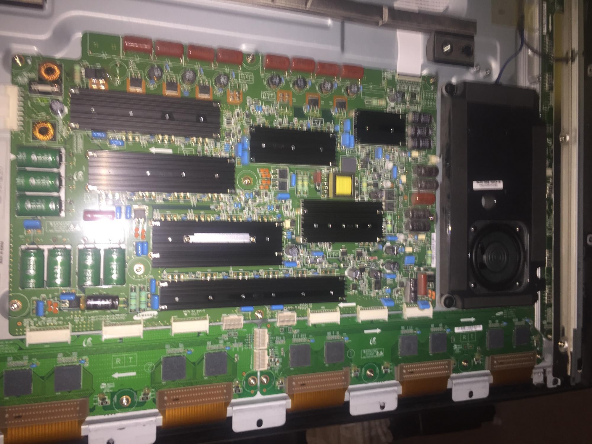

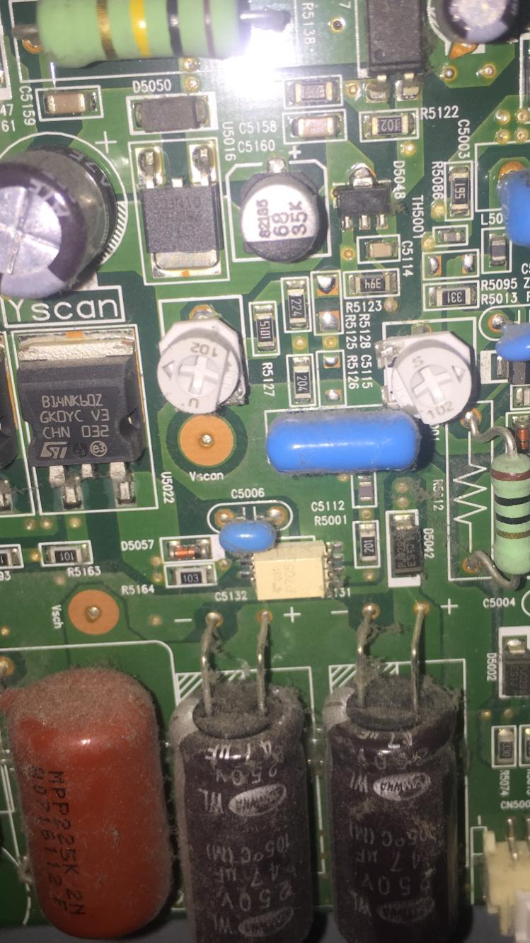

                            Some pics of the YSUS I hope will help.
                            The Vscan and its corresponding est point are obvious. The test point sits directly below it, and as noted above, I’ve already adjusted it to no great effect. So, I set it back on its original -200 setting.
                            The other test point I could find is labeled Vsch. It reads -040. I’m not sure which pot it’s connected to, if either of the remaining two, because I decided just now to twist both slightly to figure out which one registered on the multimeter while holding the probe on the Vsch test point and neither pot registered. Strange.
                            The pot that is farthest to the left on the board has no test point near it, so I don’t know what that one is. Doesn’t appear to be labeled in any way. Although, I suppose its trace could run over to the Vsch test point.
                            Does anyone have clarity on these locations, and if turning the two that aren’t Vscan is safe to do or not?
                              #54
                              Vsch is Vsc+150V
                              so e.g. -200V Vsc gives you -50V Vsch.
                              It is the HIGH-buffer voltage drive signal.
                              Your pictures are too blurry to be usable, try daylight without flash.
                                Ahhhh. I see now. The h = high. Thanks for clarifying, Tom.
                                Should I then try to get this Vsch to reach -50 to make it a mathematical match for the -200 Vsc?
                                Given the fact that I now have the Vs turned up to about 218 - 220v to get rid of most of the pink, is the Vsch now better off at -50 or should I leave it at -40 and bring the Vsc down from -200 to -190?
                                Sorry about the blurry pics today. Was in a bit of a hurry this morning.
