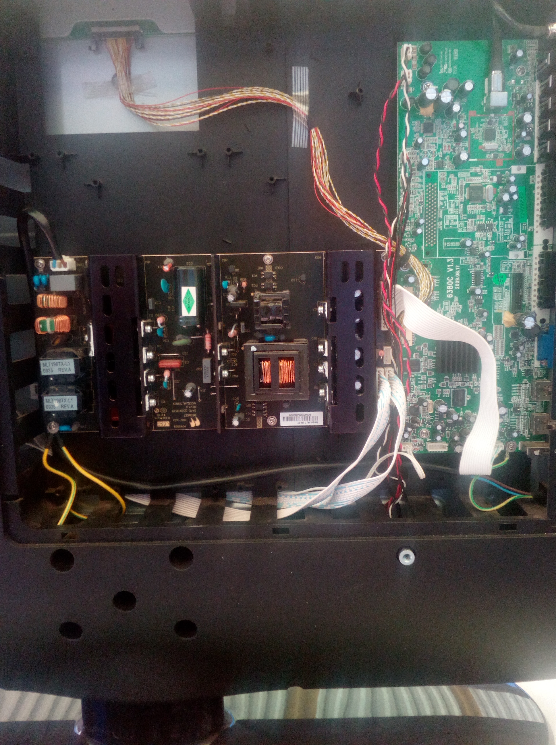

Got this set some months back in a disassembled state and "picture problem". Just got to a it now so reassembled all again - it is a nuisance type set with inverter and tcon on main body and PSU with main inset in back panel. All went OK so fired it up but as I don't have normal broadcast TV had to use satellite box input. To my surprise set went well with a good picture which I monitored for around 40 mins then left it going just checking every now and then. After about 90 mins on the picture suddenly started to solarise and that got worse and worse as bad as I've seen. Turned set off waited 10 seconds and switched back on to find no solarization but jerky bits (image retention?) in parts of picture here and there. Very unusual but must be tcon , surely ???
