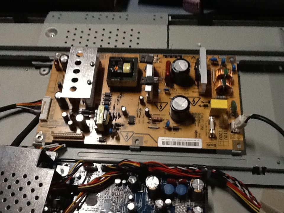

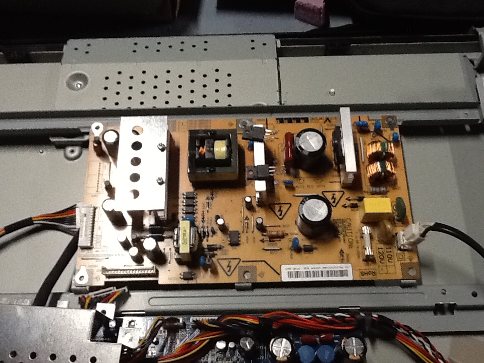

            The tv would try to power on, but took several reboots to come on, until it stopped working all together. None of the caps look bad. Should I be testing their Resistance?
            In the pictures I have removed the components I was calling voltage regulators and laid them on top of their place.

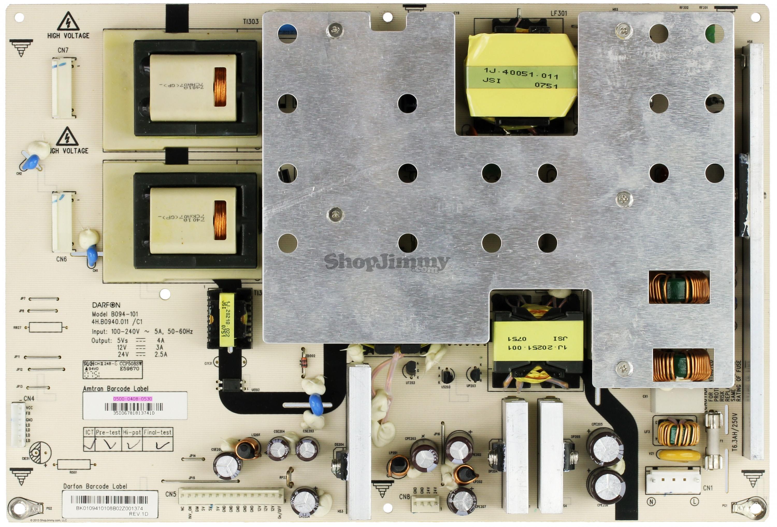

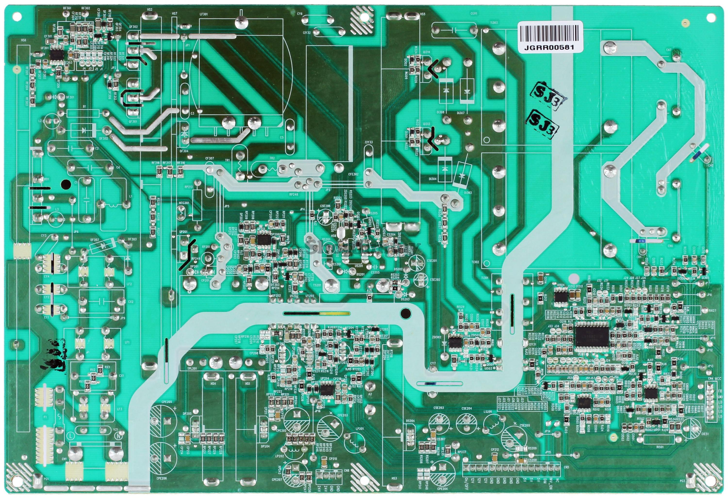

              BTW, in that Video, those devices on that Vizio power supply/Inverter board (Vizio 0500-0408-0530 Power Supply / Backlight Inverter) Tampatec is calling Regulators are actually common Cathode dual rectifier diodes, NOT regulators. I.E. video at 5:19 he shows checking the middle pin of the device for 5V on what he calls regulator (which is not) because TO-220 +5V regulator middle pin is GND! middle pin of the Common Cathode dual rectifier is Cathode, and the designator for that device is DS204 (D = Diode) for the 5V power supply. Same for the 12V and the 24V that are called as regulators are actually Rectifier diodes (DP204, DP205). I wish he makes the follow-up by adding the correction.
              Be careful when using YouTube as a guide, you may get the wrong info.
              BTW, the correct name for the two long boards on the left and the right as shown in the video are Balancer board.
              Pictures provided by shojimmy.

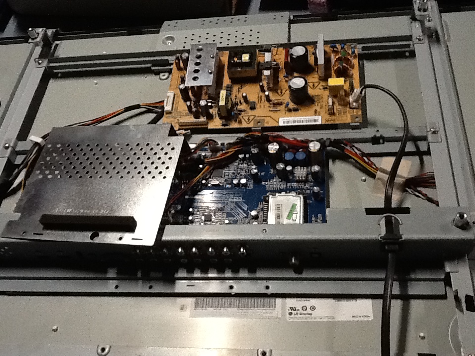

                Some pics
                Toshiba
                Model number: 37av52u
                Last edited by Mattmoosh2000; 04-08-2018, 06:24 PM. Reason: Having trouble adding photos

                      Re: Are 5v regulators for tvs interchangeable?
                      So what is the exact problem with the TV? No standby Voltage, no 12V/24V when TV is turned on? Etc.
                      https://www.badcaps.net/forum/attach...0&d=1523233197
                      Those two devices are the power MOSFET for driving the large transformer that produce 12V and 24V.
                      I cannot read the numbers as printed on the barcode sticker to know the P/N of that power supply board.
                      I suggest you to read the basic troubleshooting TV first to get basic understanding how typical LCD TV works, knowing the basic will help you narrowing down the problem.
