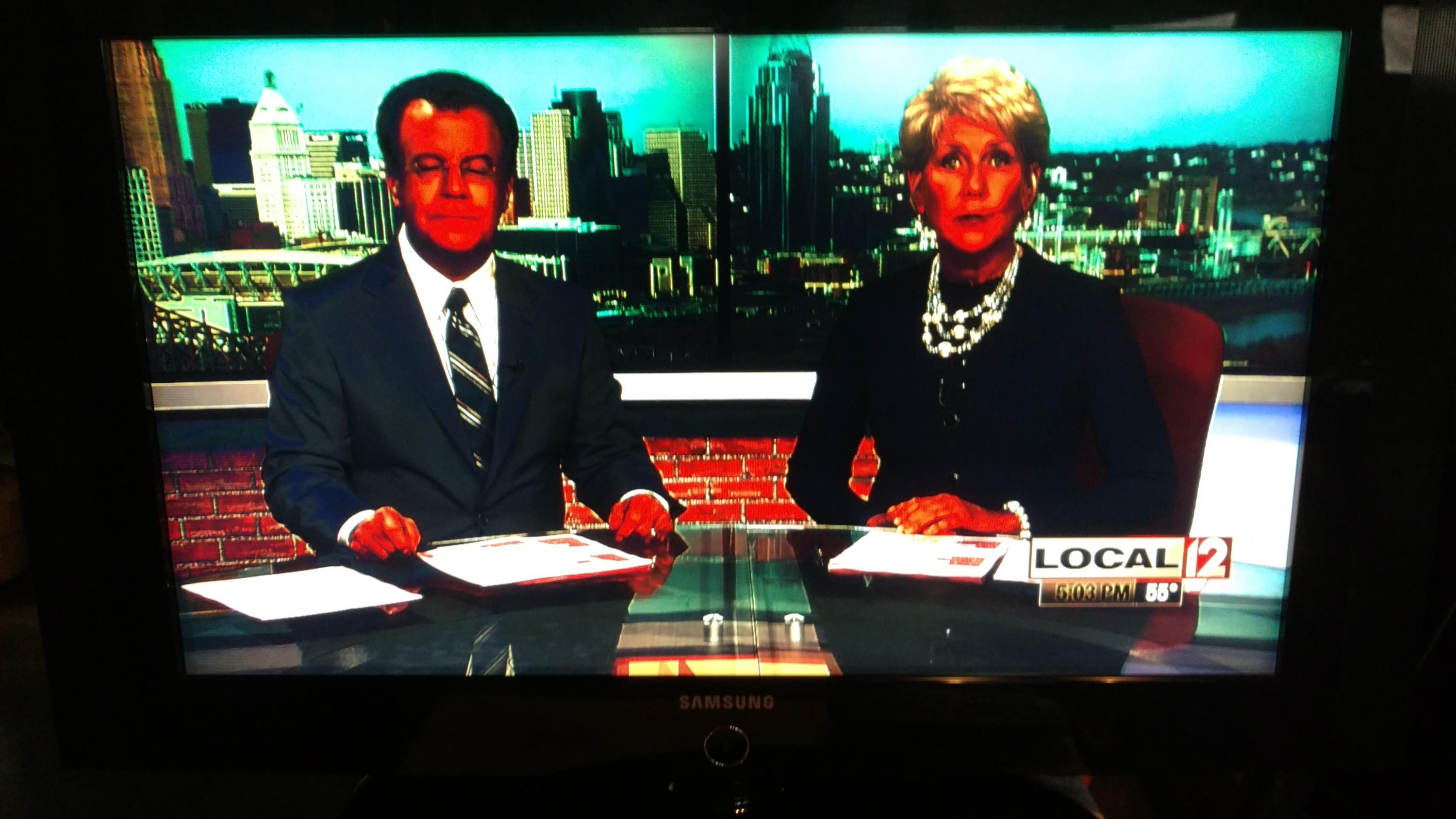

Have a samsung LN32a300 with a dark smeared over tinted picture, don't believe its backlit related. Anybody seen this on a LCD set or have any ideas ??
					ln32a300 dark picture
 Re: ln32a300 dark picture
 That is bad GAMMA Voltage reference issue on the T-CON board, more likely the GAMMA IC P/N AS15 or AS19.
 Please up load the good clear pictures of the T-CON board, there should be GAMMA Voltage test points on that T-CON board.Never stop learning

 IC on the bottom left, what is the P/N as printed on top, AS15?Never stop learning
 http://www.badcaps.net/forum/showthread.php?t=24809Comment
 AS15-G, that is common failure on T-CON board, there are many many threads about this IC.Never stop learning

 You can verify the VGMA Voltages first if you want, I cannot see the test points in your pictures.
 Ah, your pictures came back up!
 https://www.badcaps.net/forum/attach...1&d=1522205818
 I see GM1 ~ GM14 for the GAMMA Voltage test points.Last edited by budm; 03-27-2018, 09:45 PM.Never stop learning

 TCON voltages with no video input are
 GM1 = 13.05
 GM2 = 10.43
 GM3 = 9.69
 GM4 = 9.05
 GM5 = 8.6
 GM6 = 7.49
 GM7 = 7.1
 GM8 = 6.66
 GM9 = 6.21
 GM10 = 5.05
 GM11 = 4.7
 GM12 = 5.06
 GM13 = 3.03
 GM14 = 5.2
 Vref = 13.3, VCM = 5.88, VDA = 13.74, SDA = 3.3Comment
 Bad #12 and #14. See the pattern?Never stop learning
