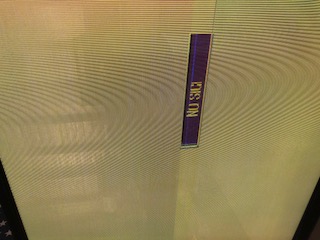

Hi I have a 60pv450 with a messed up picture. I have attached a picture of the screen. It has a yellow back ground.sound works. I have verified the voltages on the power supply. The control card is flashing 3 fast and 1 slow flashes. Any help would be greatly appreciated.

It's hard to tell anything with the picture being small. Is half the NO SIGNAL text missing and what is the screen like with a picture being displayed?Willing to help but I'm no expert. -

Try unplugging the ldvs cable that goes from the mainboard to the control board. On the control board there 2 copper holes marked r51 and r52. Put a piece of wire in each hole and then plug the tv back in. See if you get clear test patterns, red,blue,checker board,ect. If you do, the mainboard is bad.Comment
