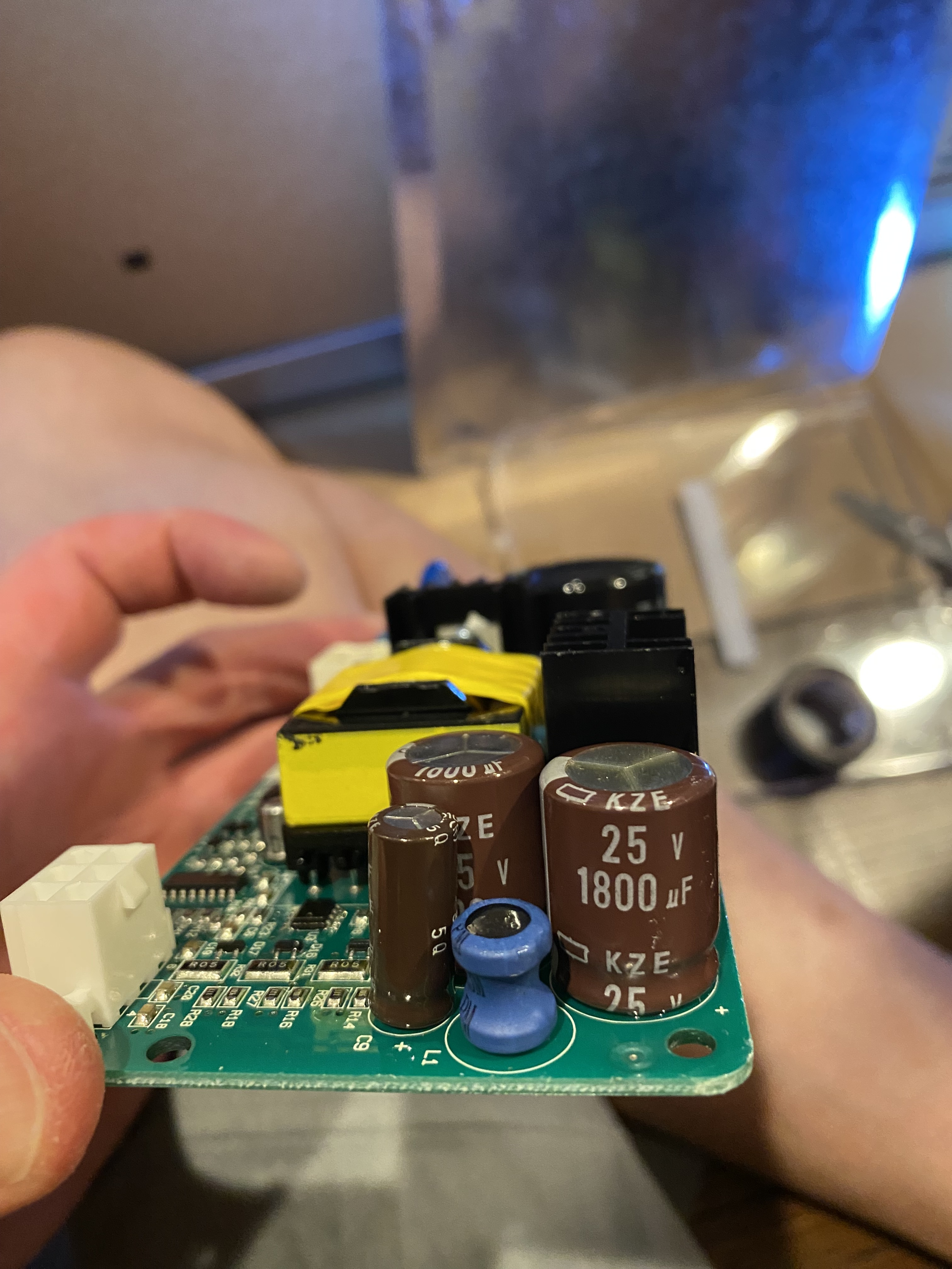

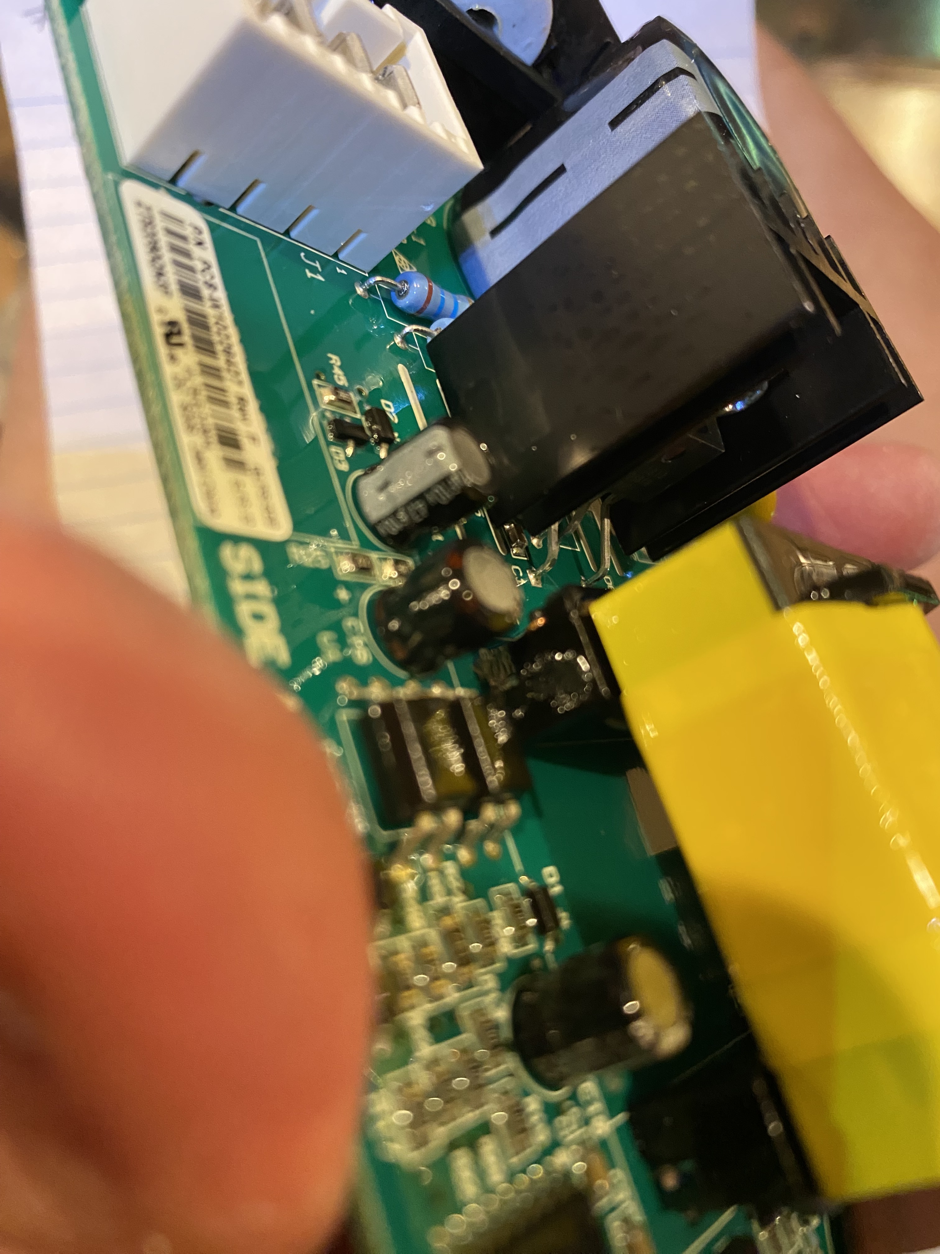

                sam_sam_sam.... Thanks for this suggestion.. I am actually thinking that the power supply board might be causing the issue to some extend too. It is actually on a separate board next to this one... (see this link on ebay... Board is basically this model. ) I think one 10uF Cap on this board looks a bit suspect... Maybe I should just try to reCAP the power supply board too. What do you think??

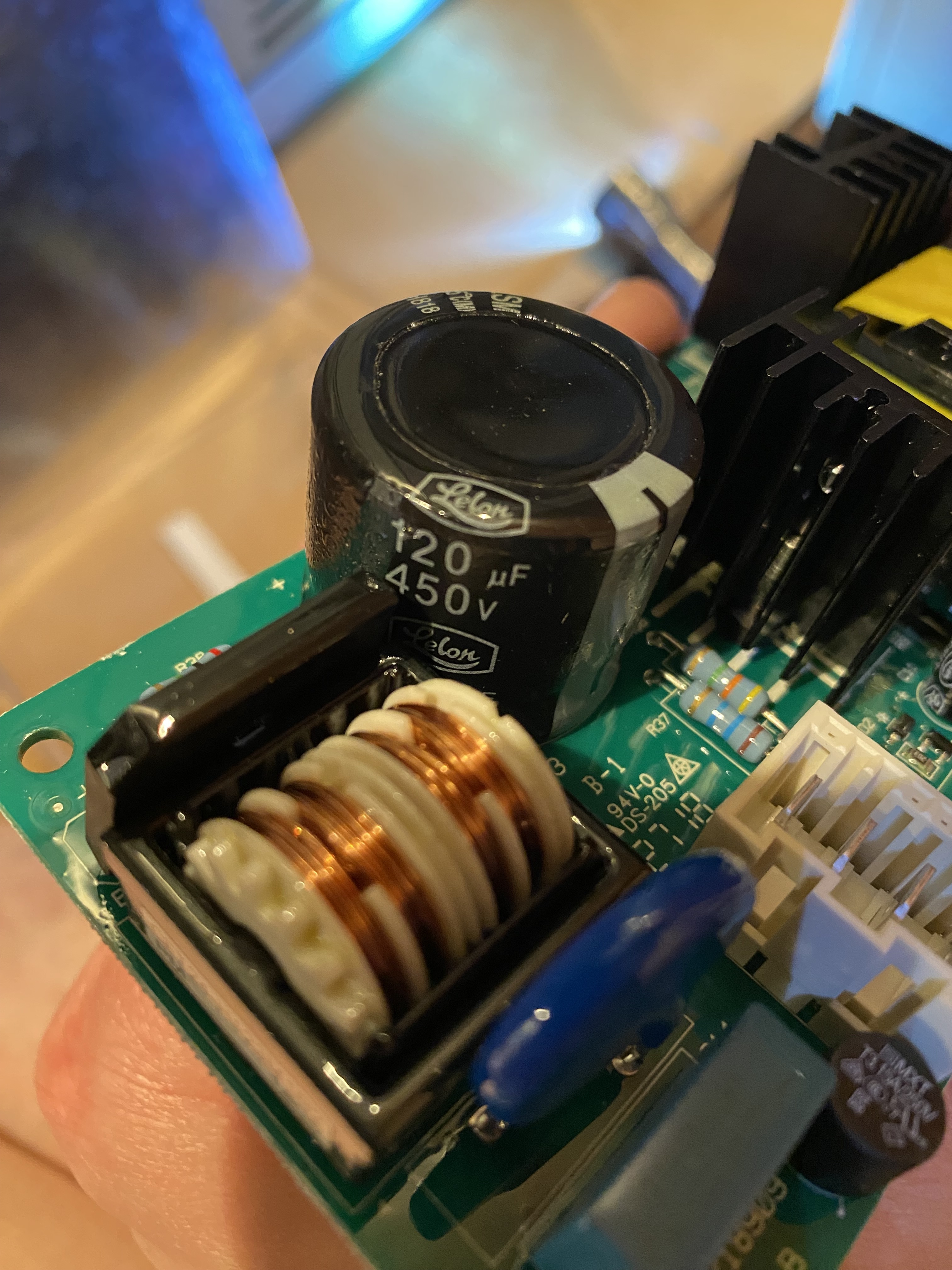

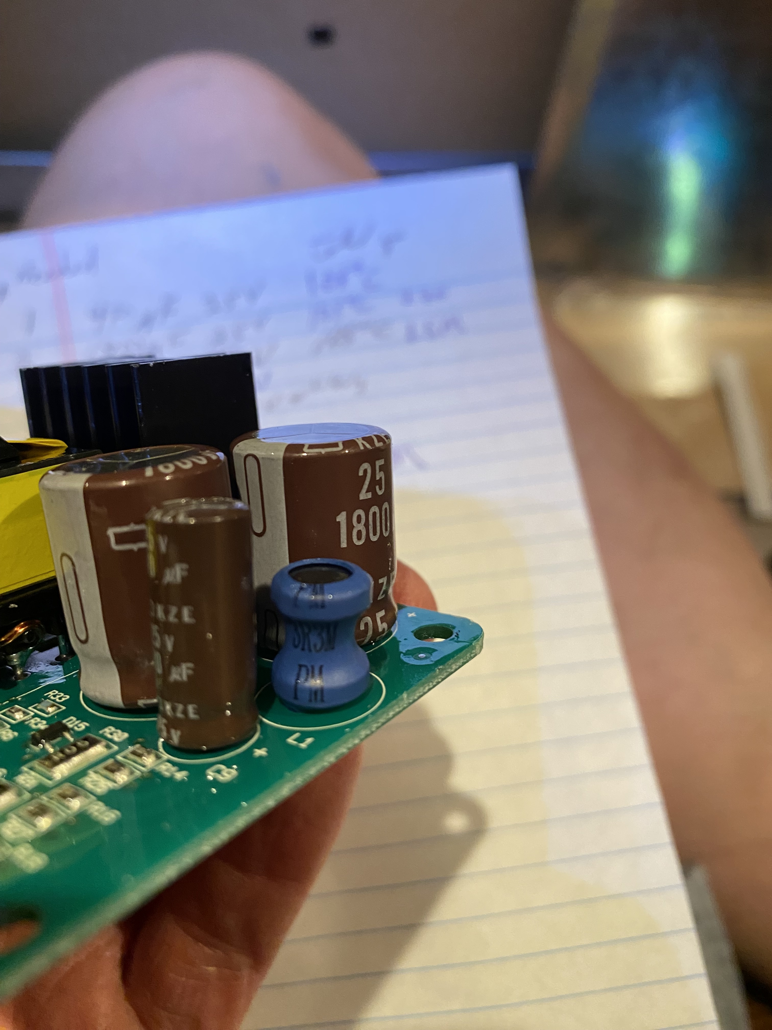

ID:	3169653 Here are a few picture of my power control board.. I don't think it looks in as bad shape as that one on ebay... That said, I think it is probably worthwhile to just replace the 7 caps on the board. Would you agree?

                        I highly recommend that you use a magnifying glass to see the fine cracks around the pin soldering joints to the board or if see flux around the pins or around the pin holes to solder traces if you see either one remove the solder and redo them
                        You need to look at pin connectors on this board for bad-rings around that look like the solder separation from the pins to board because or gaps between the pins and solder joints to the board Whirlpool has had some very serious issues with this in the past I have repaired a few there board in the past

                          Take a picture of the bottom of the board so I can see the soldering joints and the traces
                          What is the part number of the device that is mounted on the heat sink
                          Because iI think I see the switching power supply regulator because if I see it right it has 5 or 6 pins
                          By the way the capacitors that KZE or KY are a very good series in caps I would not necessarily replace them at this point but if there is a capacitor near the switching power supply regulator I would definitely recommend changing it especially if the UF value is less than 100uf it might be 10uf, 22uf, 33uf, 47uf
