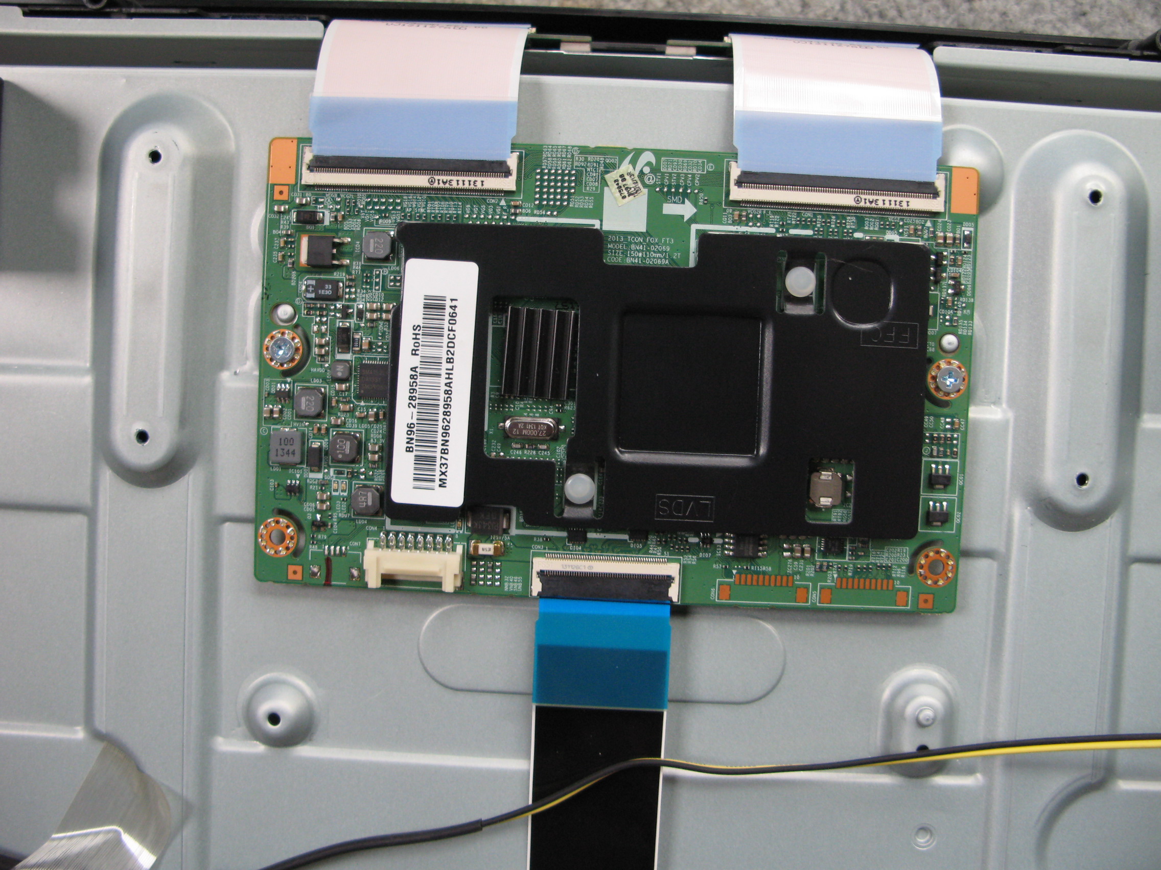

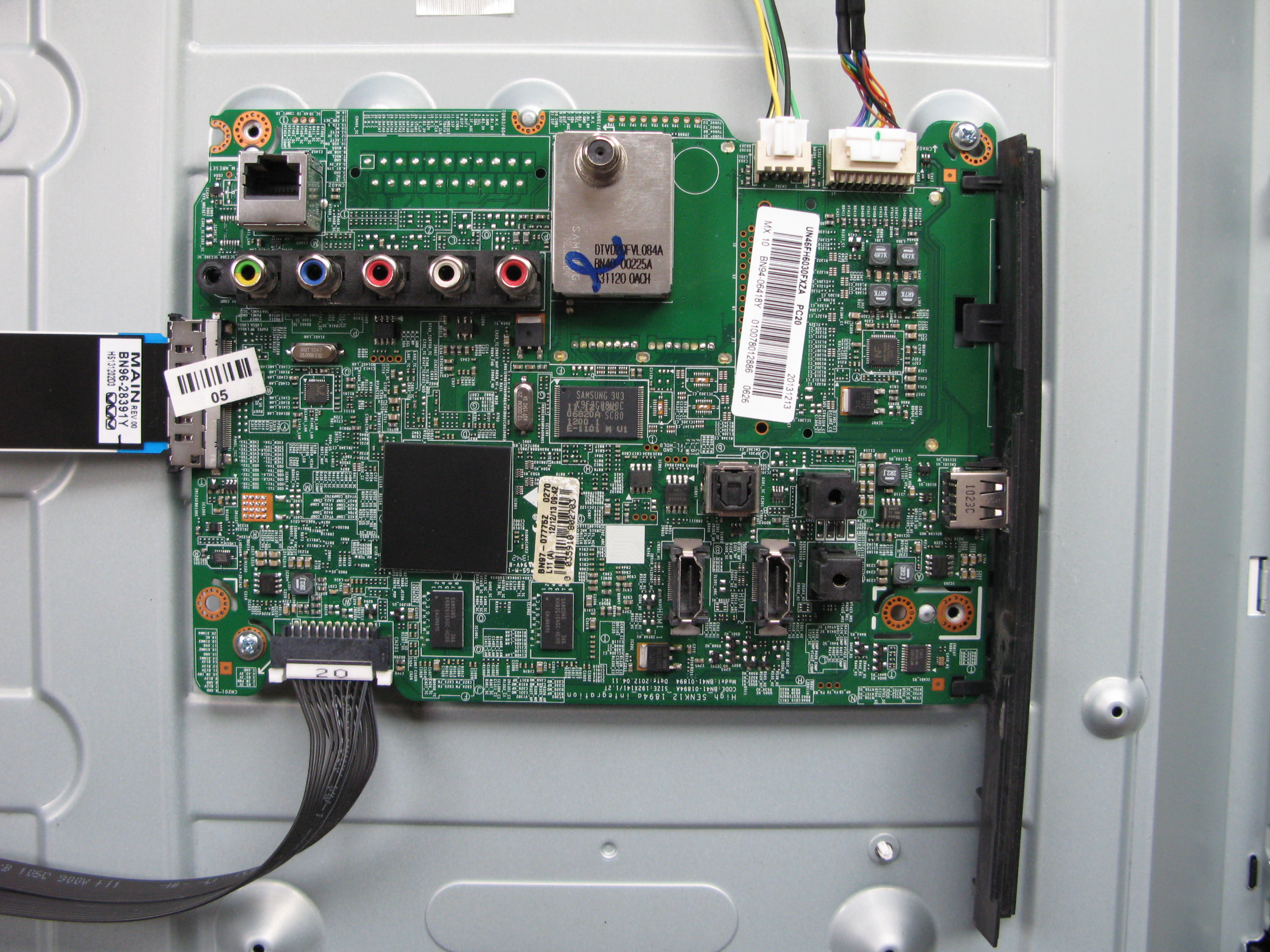

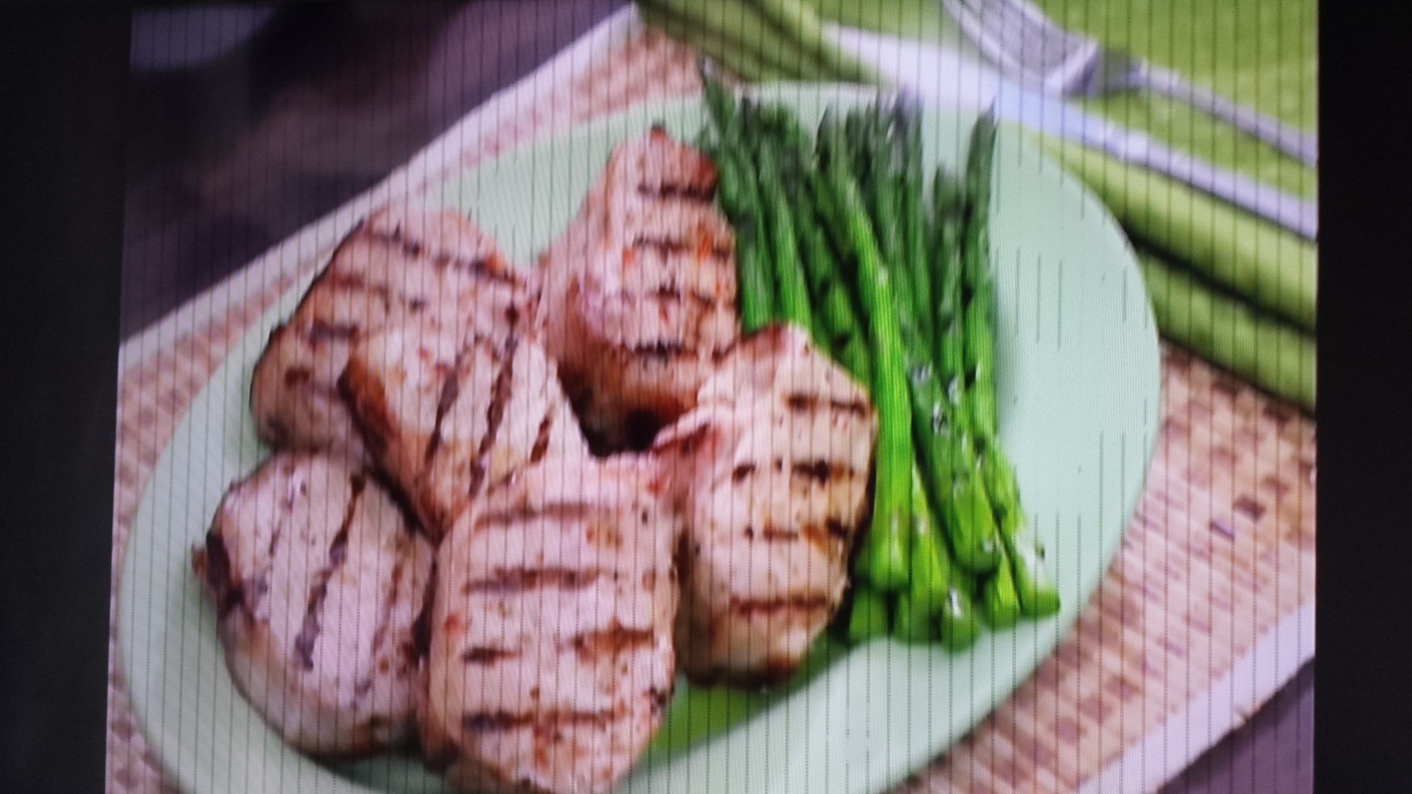

    My neighbor asked me to look at this problem. I thought it might be a BGA problem, but I get no change when pressing on the circuits with that attachment on the main board, and on the T-Con.
    The problem doesn't seem to appear on images without movement, such as a DVD or setup menu. The lines appear on both antenna and HDMI inputs.
    Does anyone have a suggestion on what I can look at next?

    Try re-seating the t-con connector, with tv unplugged first

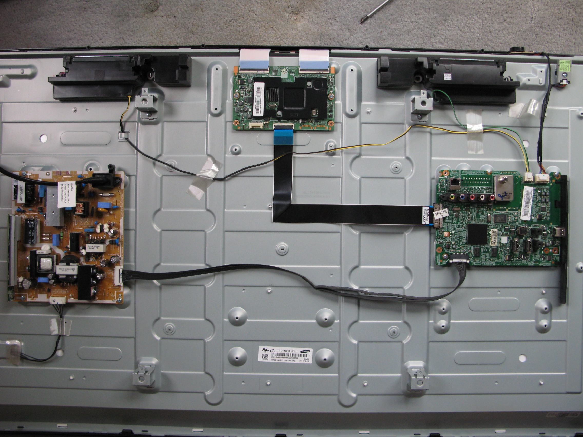

      Thanks for the suggestion, but there was no change after I removed the ribbon cables, wiped them with an alcohol swab, and reconnected.
      I also pulled the heat sink off the T-CON, to see if pressing on the BGA mounted chip under there would cause any change, but it didn't.

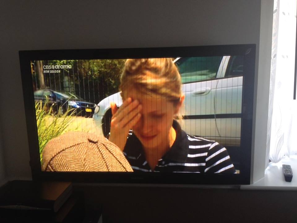

        There is old thread from Oct 2014 showing the similar problem, the fix was new T-CON per OP. I downloaded this picture from the thread years ago.

              The T-Con board was the problem.
