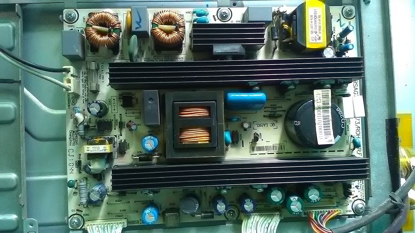

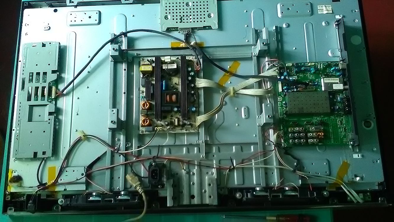

        @budm:
        https://www.4shared.com/photo/u0dklj...22_104018.html
        https://www.4shared.com/photo/d6Gwuq...22_104052.html
        https://www.4shared.com/photo/kTpG1R...22_104105.html
        https://www.4shared.com/photo/7zdHK4...22_104117.html

          So your power board is 'RASG7.820.1673', right? I cannot see it from the pictures.
          Not 'RASG&.820.1673'.
          Are there label for each pin of the connector? They may have label on the bottom side of the board so we do need the pictures of the bottom side of the board too, the more details you give us the better we can help you since we do not have the TV in front of us to look at.

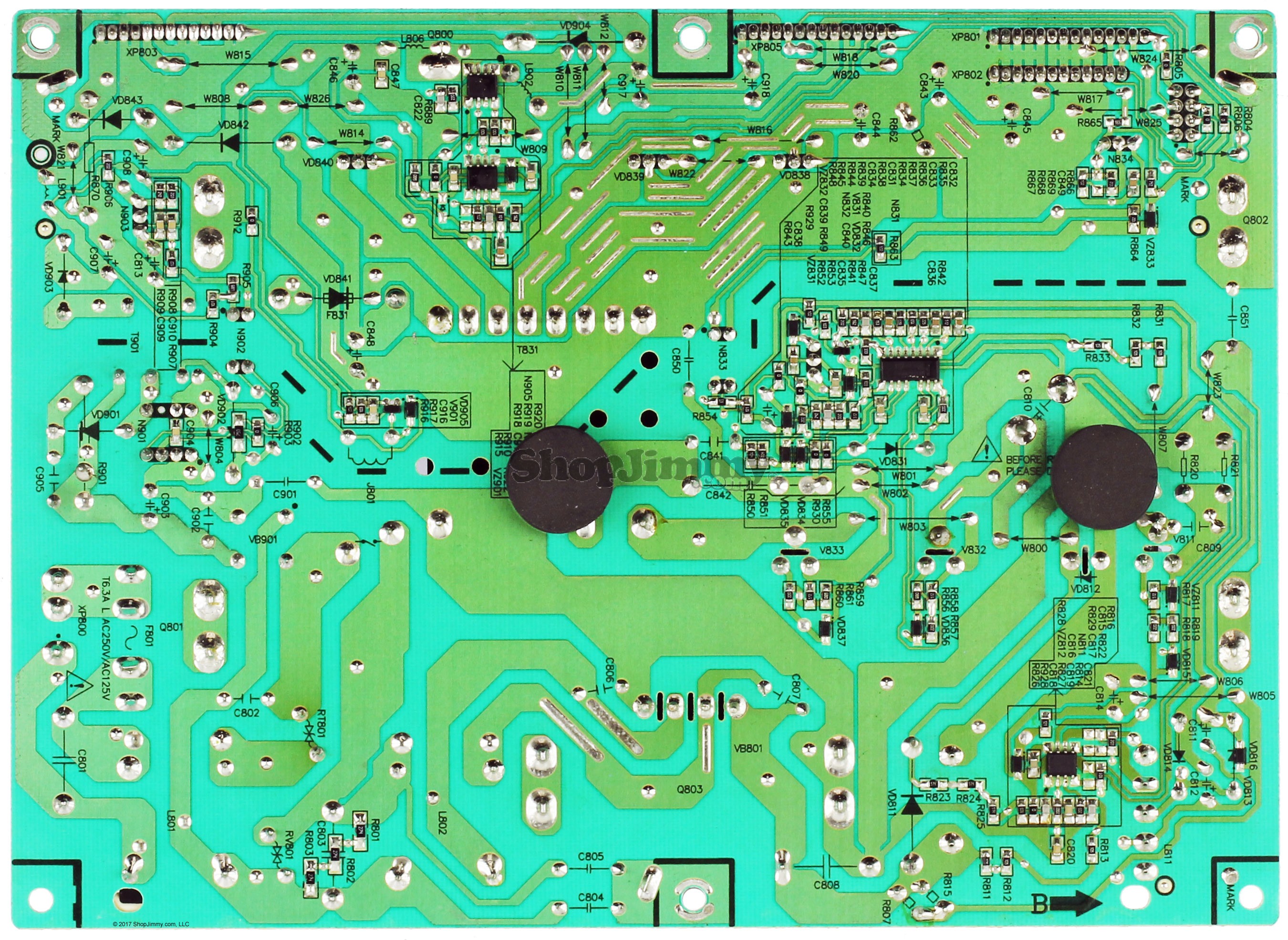

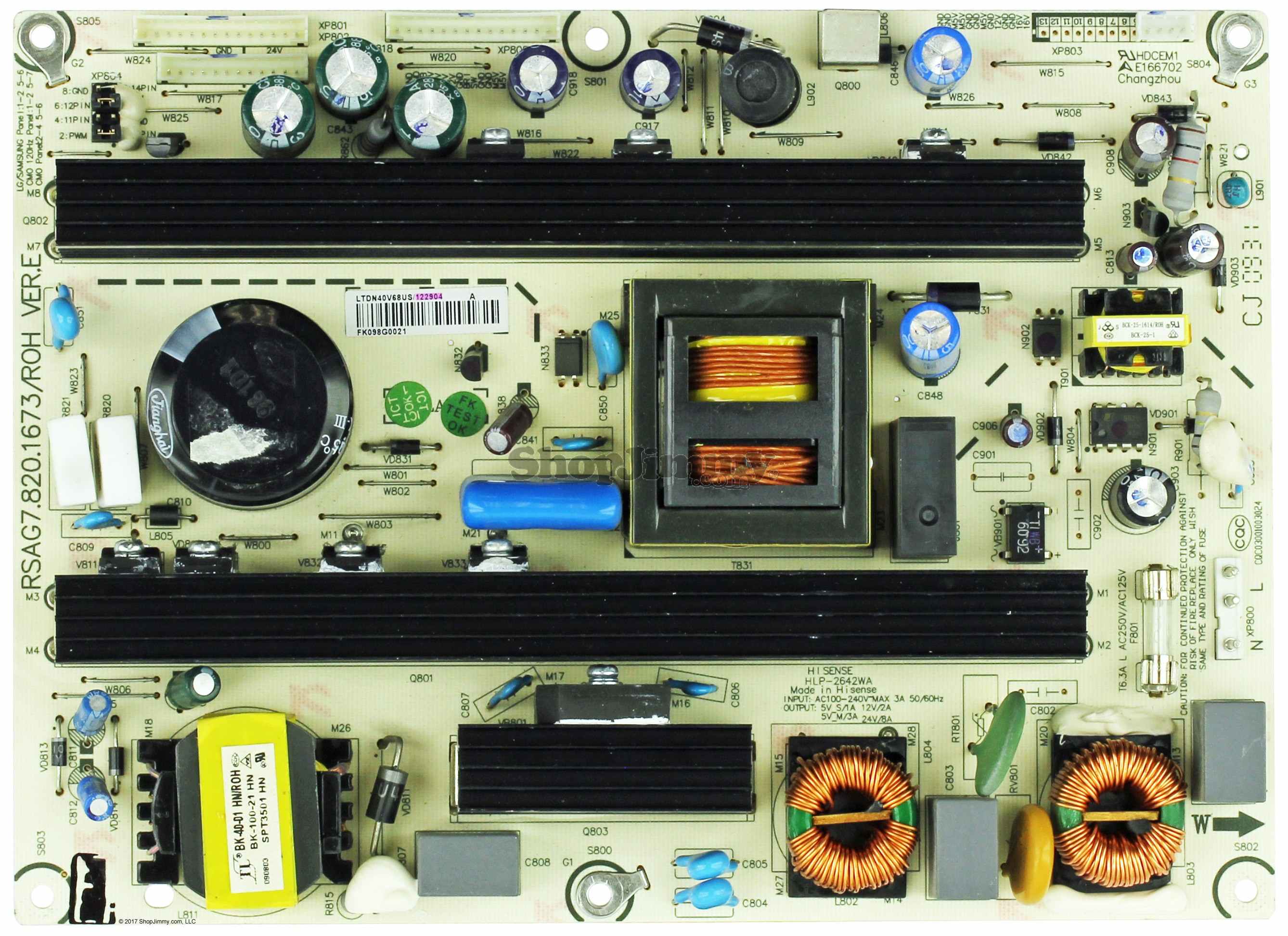

            This looks to be your power supply board:
            http://www.shopjimmy.com/dynex-122904-power-supply.htm#
            Dynex 122904 (RSAG7.820.1673/ROH, 122906) Power Supply Unit
            If it is then I may be able to use the pictures from shopjimmy.
            Pictures provided by shopjimmy.
            I cannot read all the pin names on your board or SJ board so you need to provide us those names.
            BTW, it looks like SJ board is not the exact match, connector XP803 is not the same as yours.
            The SJ board only has switched 16V on XP803 .

              Yes..that's correct. 1673..it's just typo-error on rsag7
              Pics
              https://www.4shared.com/photo/GiJgS-...2_1128241.html
              https://www.4shared.com/photo/MFTyyD...2_1128541.html
              https://www.4shared.com/photo/6G0DsZ...2_1129201.html
              https://www.4shared.com/photo/wf4a1z...22_112920.html

                hmmnn.
                SJ has ver E, mine was ver F

                  Update.
                  Lift STB pin, voltage becomes 5v( 2.5v when connected.) and Standby LED remains On now(normal standby).
                  STB voltage is always on. No response from POWER "touch" button.
                    Re: LCD42V88P Manual/Schematic
                    STB pin is the control signal pin, it is the same as PS-ON, in your case this will turn on the power relay (right next to C848) so the switched 24V , 16V, etc, will run. 2.5V = Main power supply ON, <1V = Main power supply OFF.
                    5V_S is the 5V Standby power supply to run the main board and it must be working otherwise you will not have 2.5V at the STB (PS-ON) pin to turn on the power supply. Verify that you do have 5V at 5V_S pins.
                    So do you hear the power relay click sound when power switch is activated?
