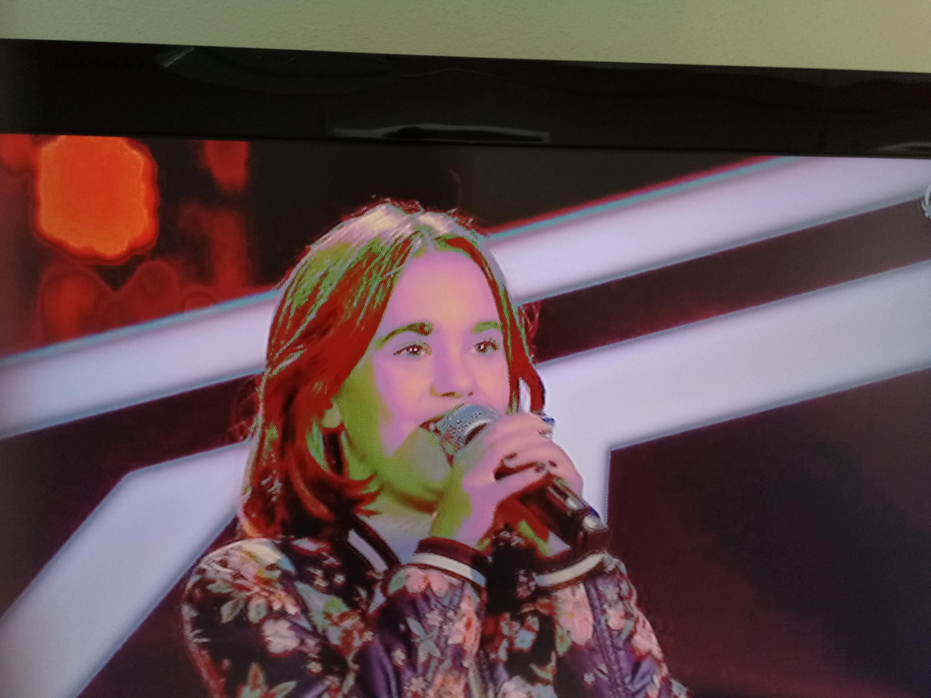

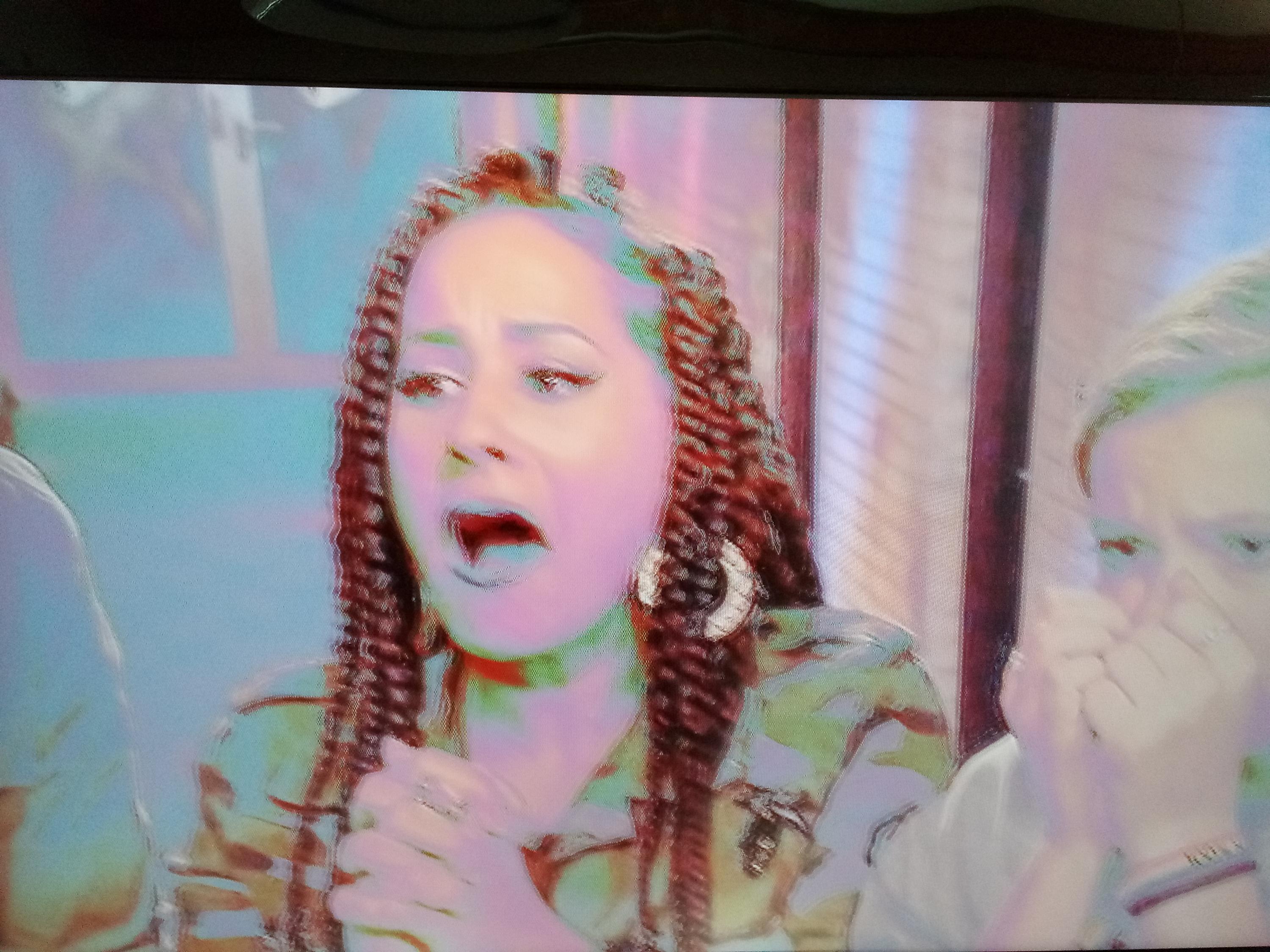

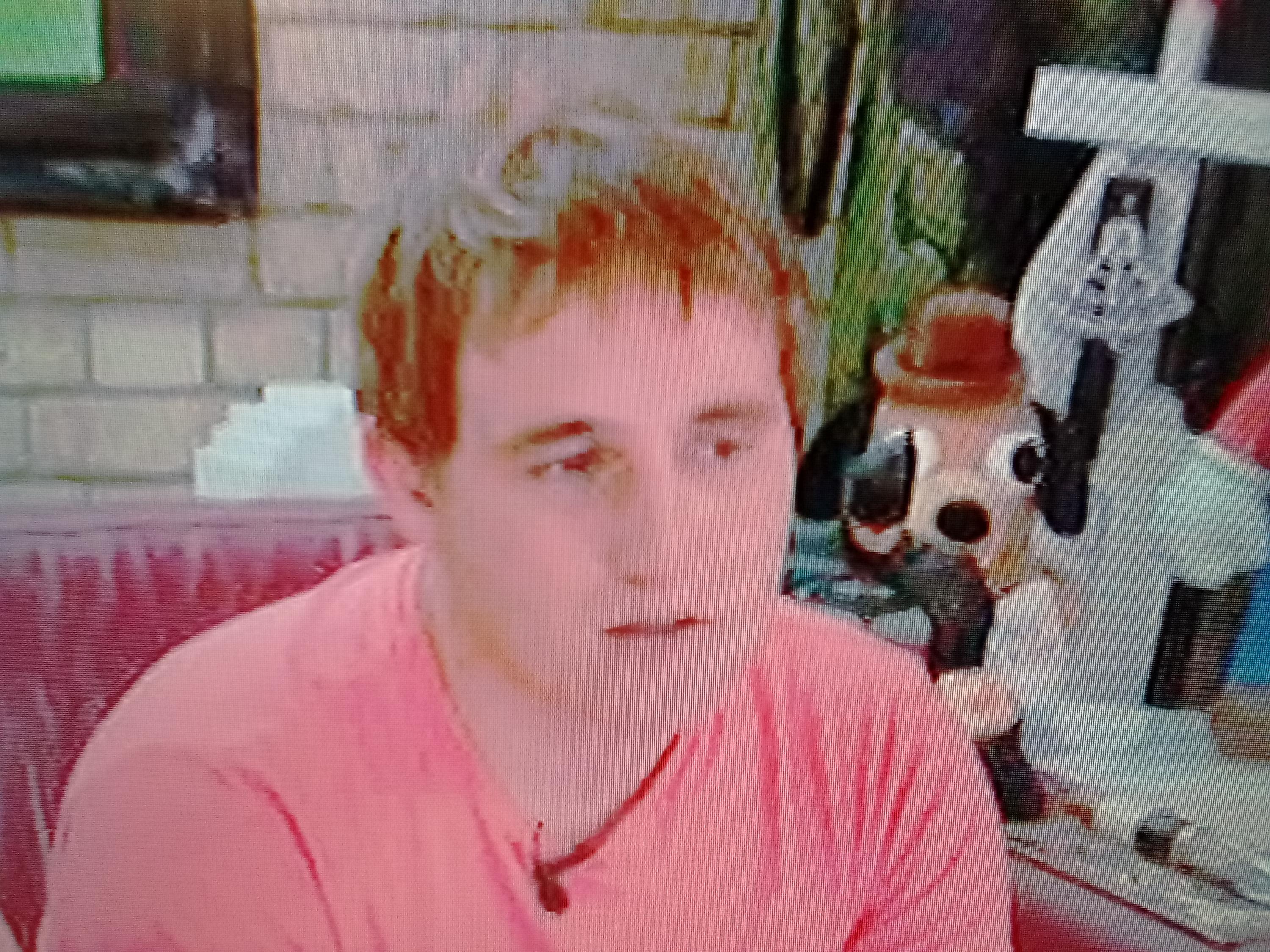

    I got this TV for free, and would like to use it, although it's only HD ready.
    However, I have no clue what problem it has -it saomething like polarisation, pixelisation, colour shade problem, blur, but at the same time isn't.
    Will try to upload pics.

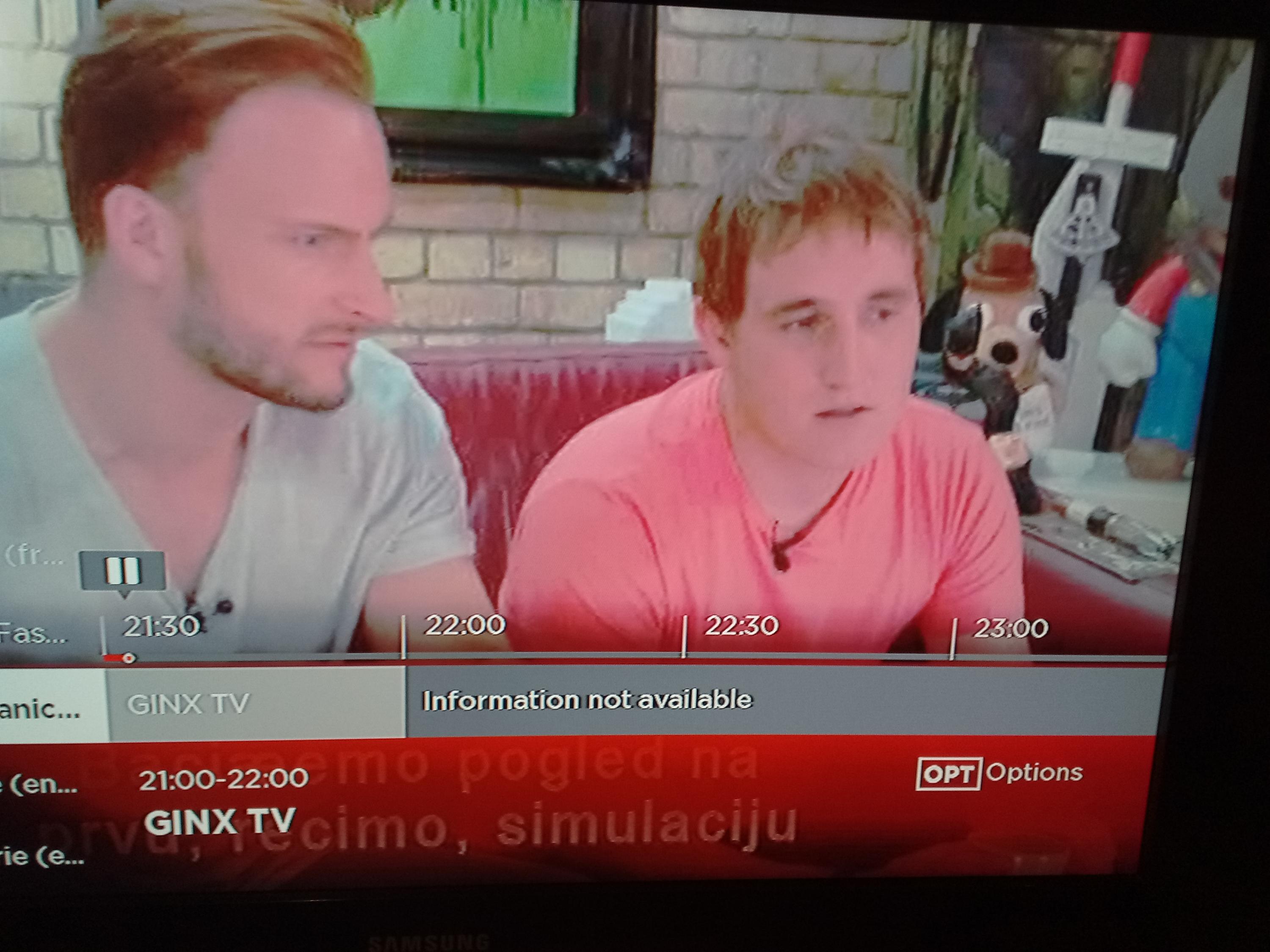

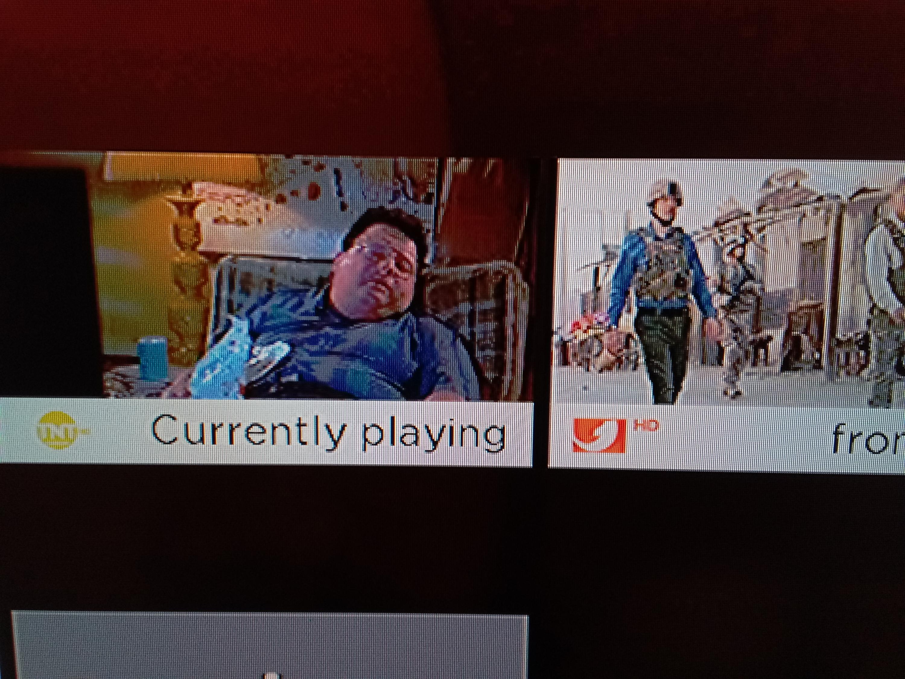

    Also, I just can't say if menu looks good or is just as bad, as menu is just white letters, and no coloured pictures.
    I got impression that it's worse when TV is cold, though.
    Any suggestions on how to determine what's wrong? PS looks pretty decent, and voltages too.
