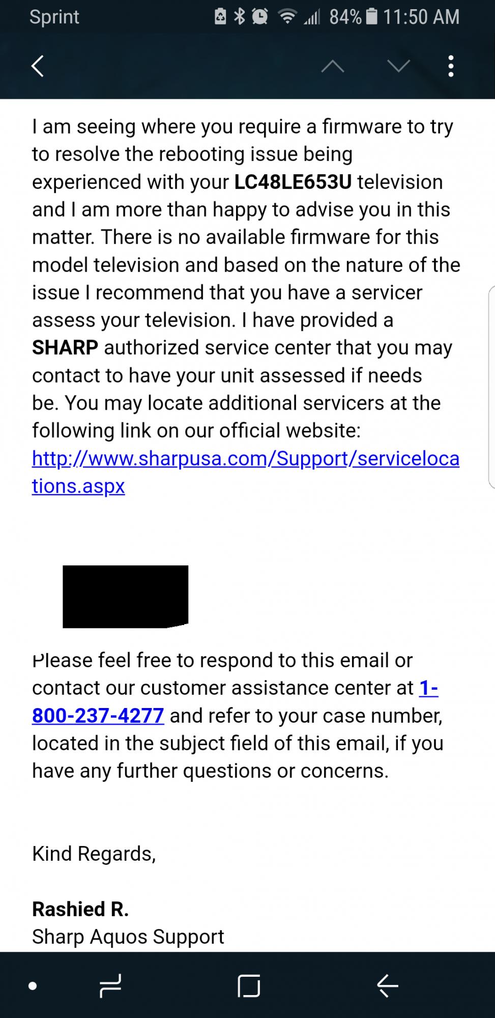

    Contacting sharp for firmware was a joke as there's no firmware update available on their website for this model.
    Uses a Samsung panel and nothing inside that TV is actually made by sharp I believe this is TCL Chinese offshoot model. Made in 2016. Mainboard is Amtran.
    The guy from Sharp Tech Support emailed me back and said that there is no firmware update available in wants to know why I'm trying to update the firmware as if I'm not authorized lol. Any who I decided to update the firmware for the 55" version as that was avaliable, LC-55le653u. That model uses an AUO panel so I figured my options were either it's gonna work or it's gonna brick...

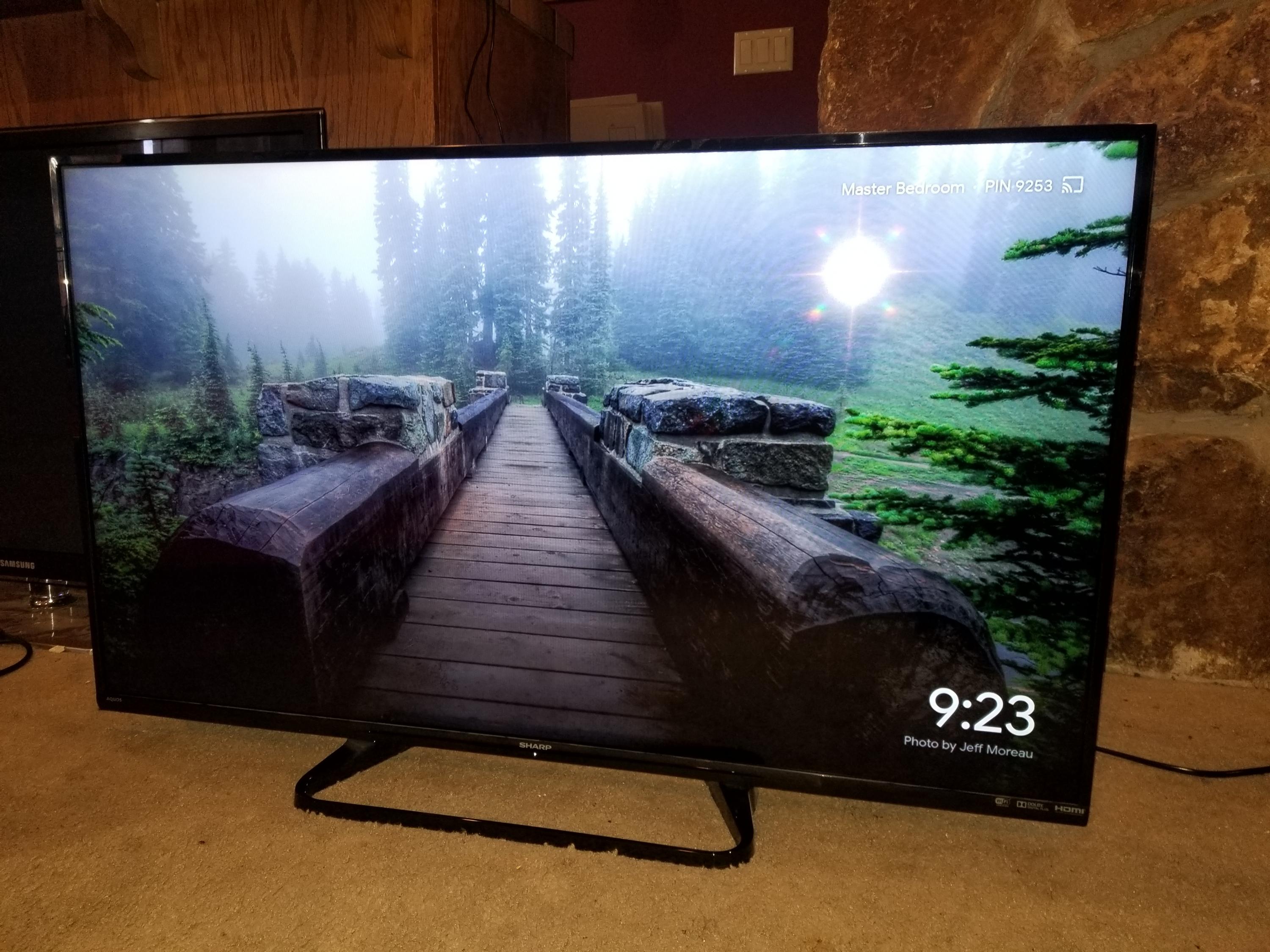

    Well it worked.
    Procedure is, unplug TV, download firmware and unzip to USB stick, insert USB stick, plug TV and in let it sit do not press power. The white indicator will start flashing rapidly and then slowly and then the TV will automatically come on with problem solved.

            Re: Sharp LC-48LE653u reboot fix
            The email I got from Sharp... lol

              :-( they probably meant that there was NO NEW firmware available to address issues after manufacturing.... but I wish the manufacturer would acknowledge and provide ways to readily reload existing firmware loads as opposed to just "updates" as firmware can get corrupted.
