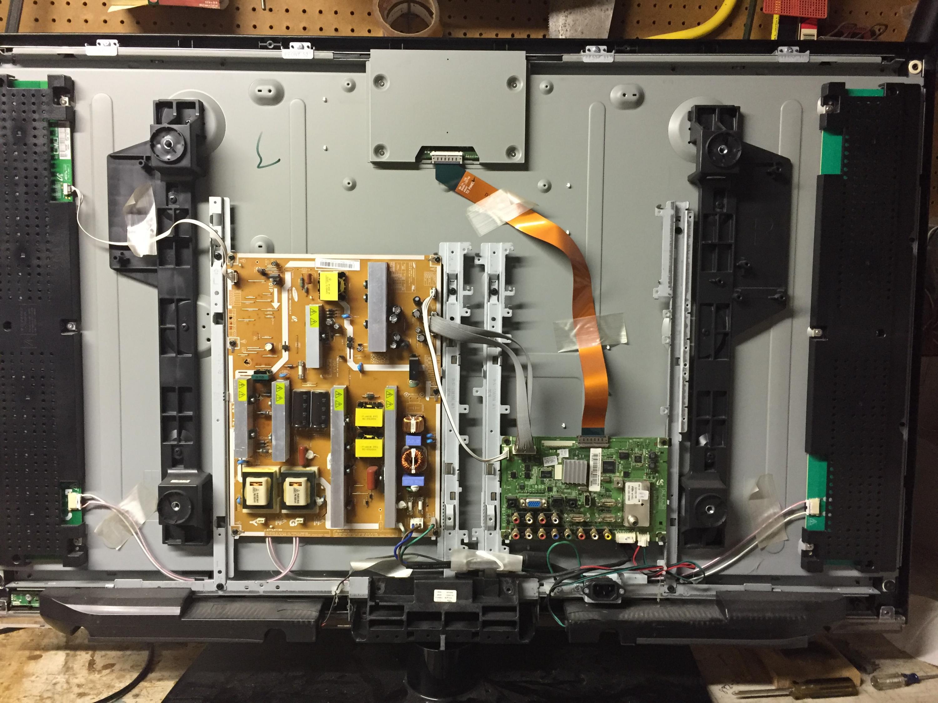

    You need to upload good clear pictures of the whole backside of the TV showing all the boards.
    Power supply board P/N is BN44-?????
    Did you see the backlights come on for seconds?
    Do you have meter to be able to test the Voltages?

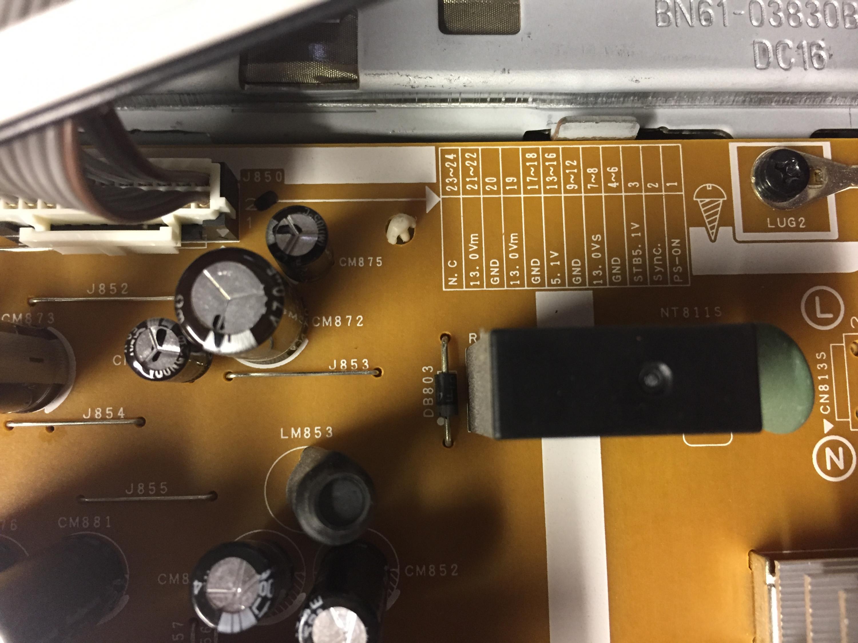

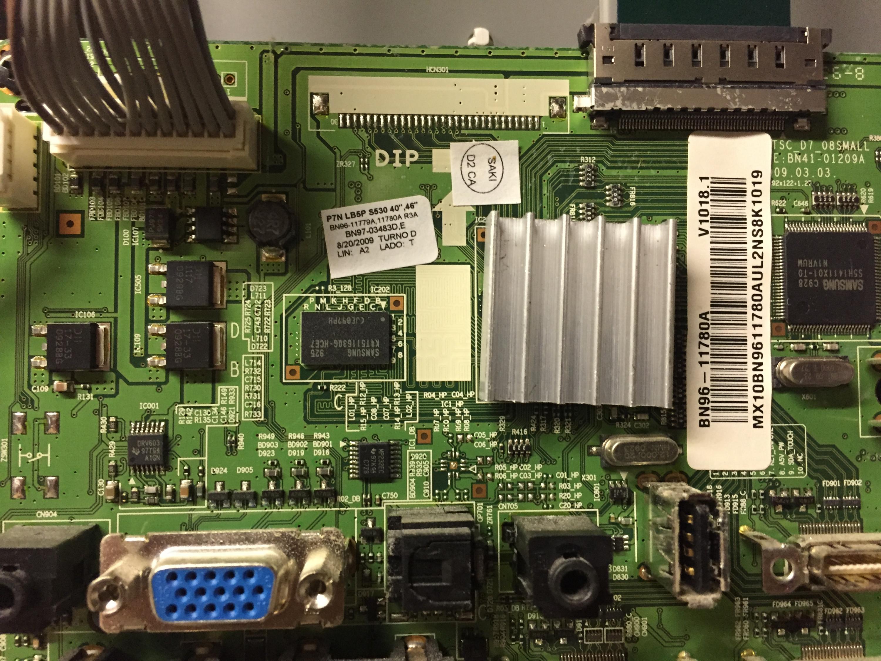

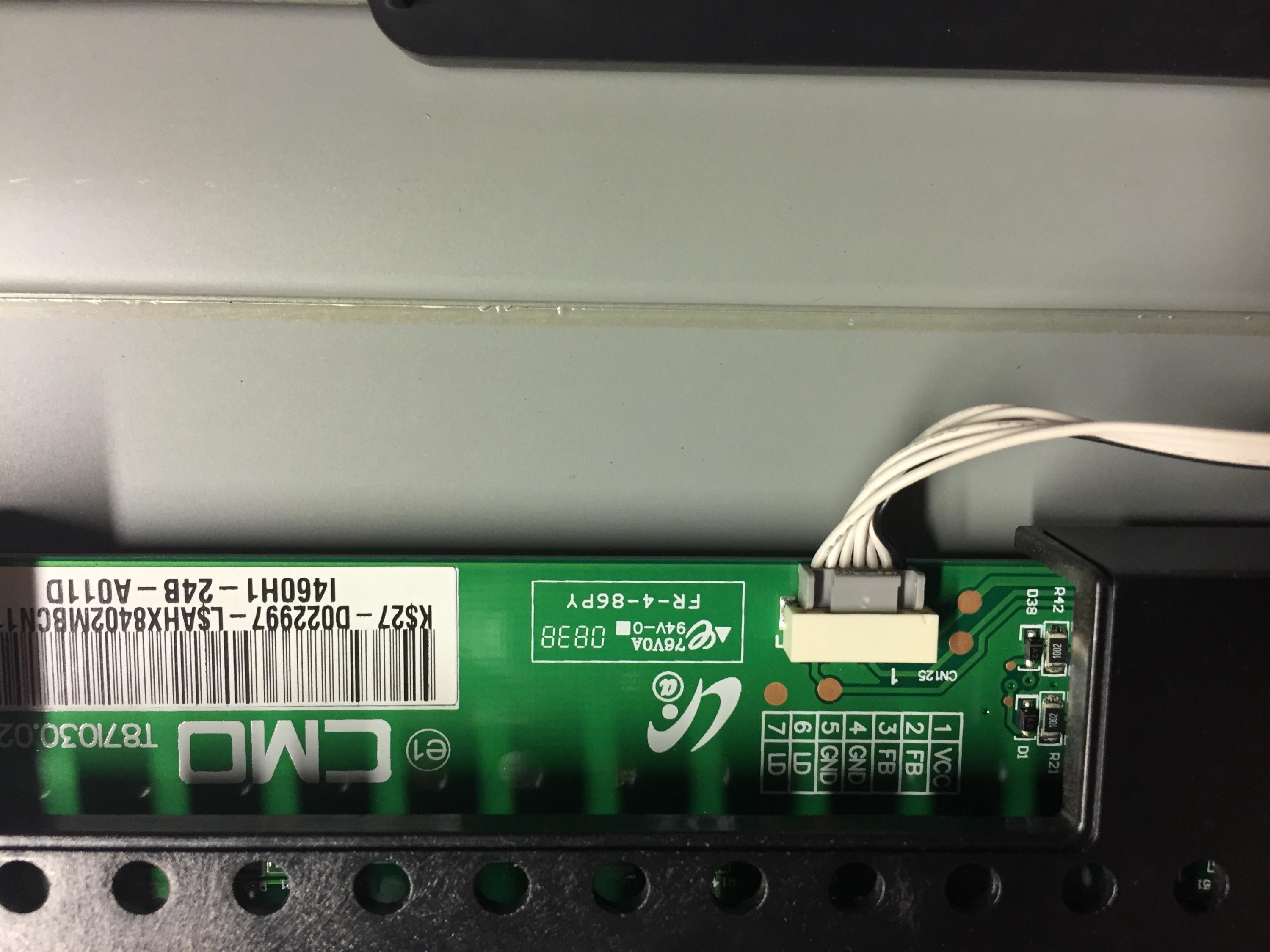

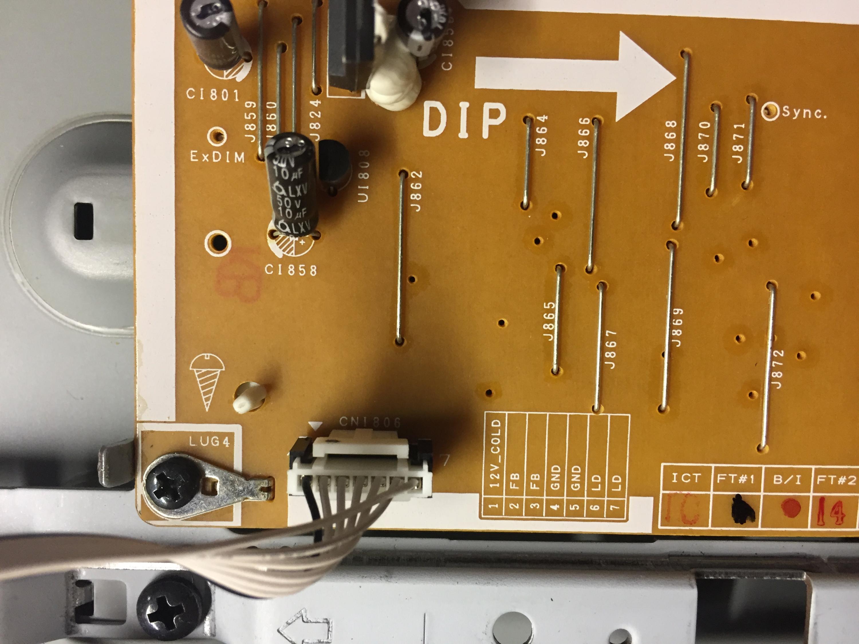

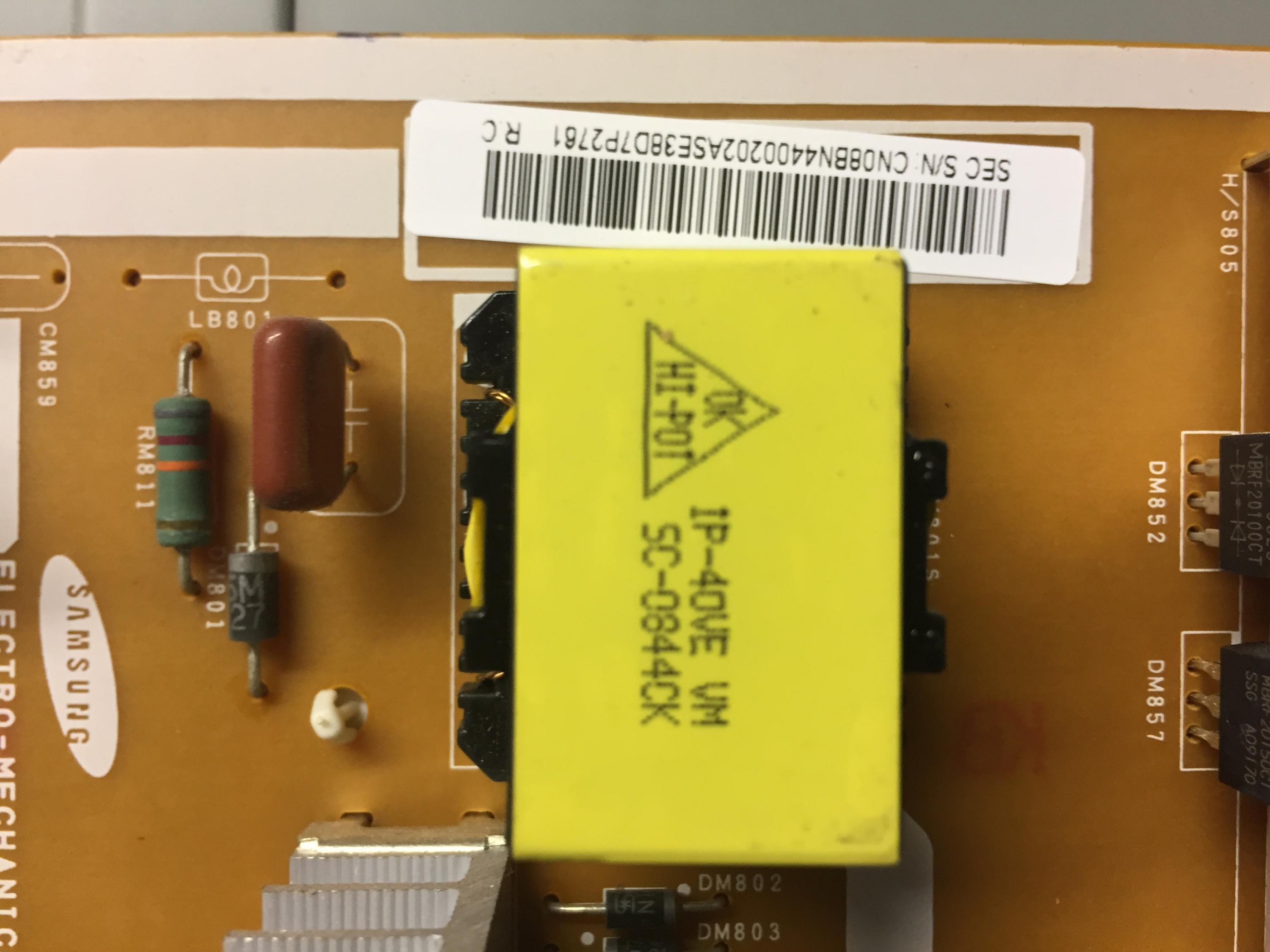

          Sorry I didn't upload pics earlier. Here's what I got. Forgive me if I got some of the nomenclature wrong. I plan to check voltage later this afternoon.

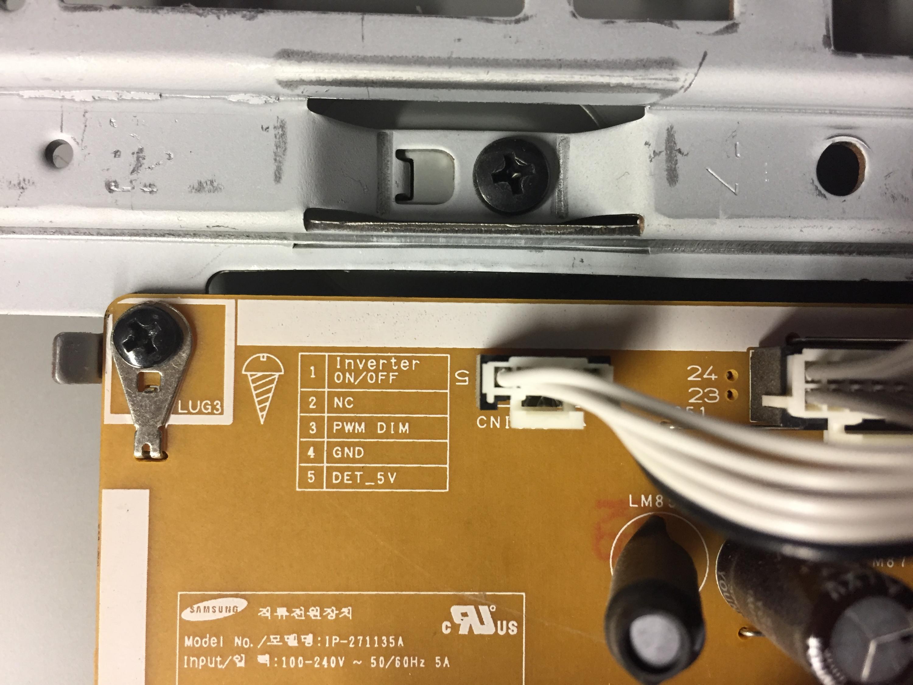

            There's no backlight flicker. I have a multimeter, but don't know with certainty which points to check on the DC side of the board. I can read the schematic where the main board plugs into the power board, and where the power board sends to the backlight inverter. For instance the 5th pin says det_5v on the "form main board" photo. I assume that pin should read 5v dc. I'm not so sure which pins to test on the others.

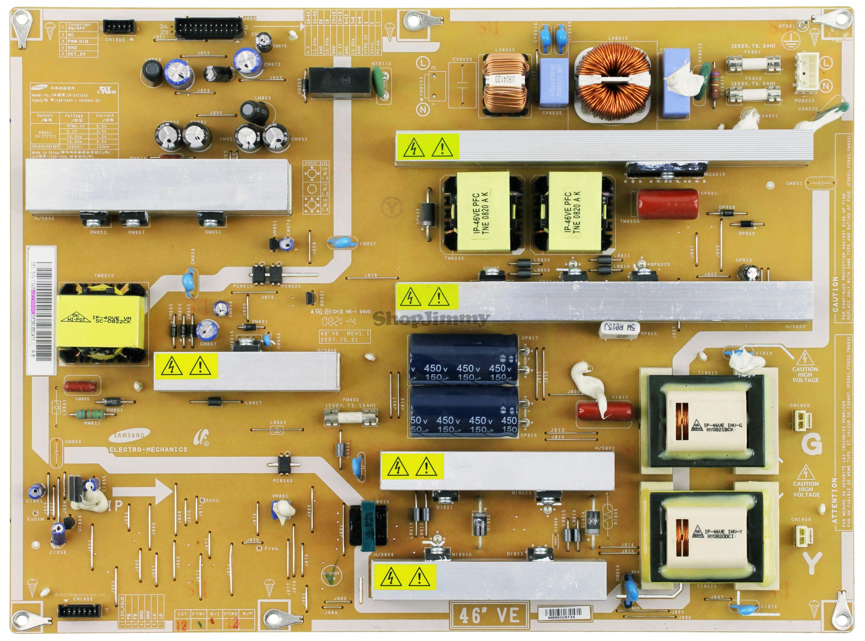

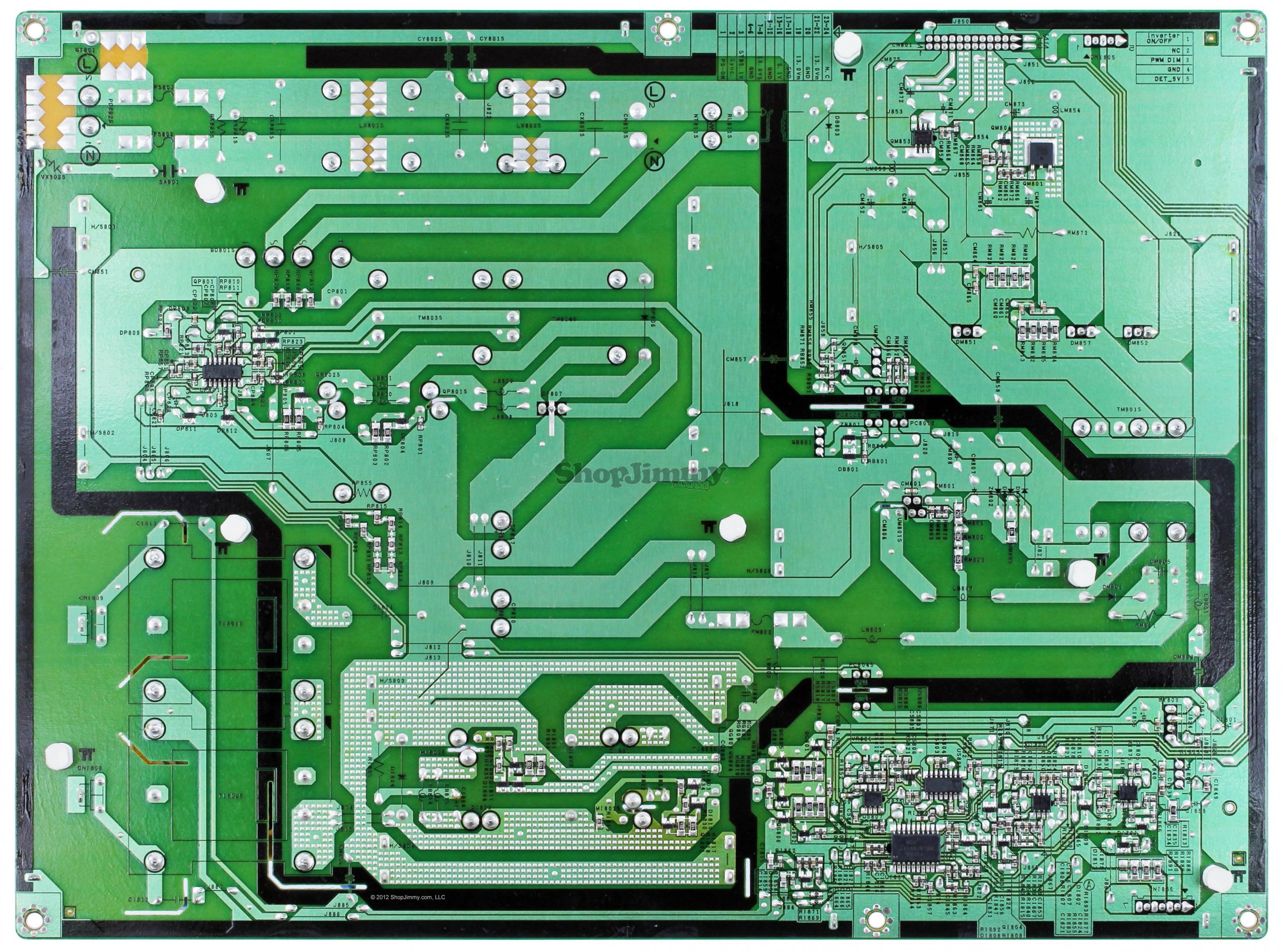

                Power supply-inverter combo board:
                BN44-00202A
                It does not have pull-up resistors for the self test function.
                So lets see if we have PFC Boosted Voltage to run the inverter circuit or not, you need to set your DC Volt meter to the scale that can read Voltage over 400VDC, make sure to set the meter to DC V mode.
                1) TV not connected to the outlet.
                2) Check the resistance of the FUSE FM802, it should show less about 1 Ohm (that will depend on your meter probes resistance), if it does show about 1 Ohm then go to steps below.
                3) You will be making DC Voltage measurement in the HOT DEADLY side of the circuit so you should at least plug the TV into the GFCI AC outlet.
                4) Do not let your hands or your body touch anything on that power supply board.
                5) Turn on the TV and then put the red probe of the meter to the Positive leg of cap CP810, Black probe on the Negative leg of the cap CP810.
                6) Report the readings.

                  CP810 read 172v.
                  I had continuity at the fuse, but I don't think my probes measure resistance that low.

                      Re: Samsung LN46B530P7N no picture
                      OK so if the Voltage on the filter caps do not go up to around 380VDC, that means the PFC section is not working and since you do hear the chime up sound it means the power supply board is getting the PS-ON to turn on the power supply for the amplifiers to run.
                      More in-depth troubleshooting will be required, the backlights inverter circuits needs that boosted Voltage to work.

                            You can try heating up the power supply board then power it up to see if it is OK or not, at this point, yes, you do have power supply problem due to no boosted Voltage.
                            It can be as simple as the filter cap for feeding the VCC to run the PFC IC, that is why I indicated that it will require more in-depth troubleshooting to get down to the faulty components.
