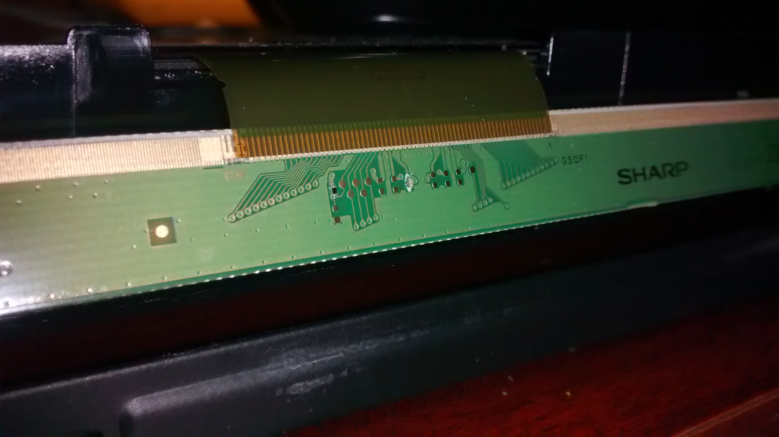

    Please someone tell me that this TV is not scrap.
    Picture works great but turns off after a few seconds. Backlight stays on, sound stays on.
    Replaced T-con, same problem. Apparently TCON shuts down it's output due to overcurrent/fault detection.

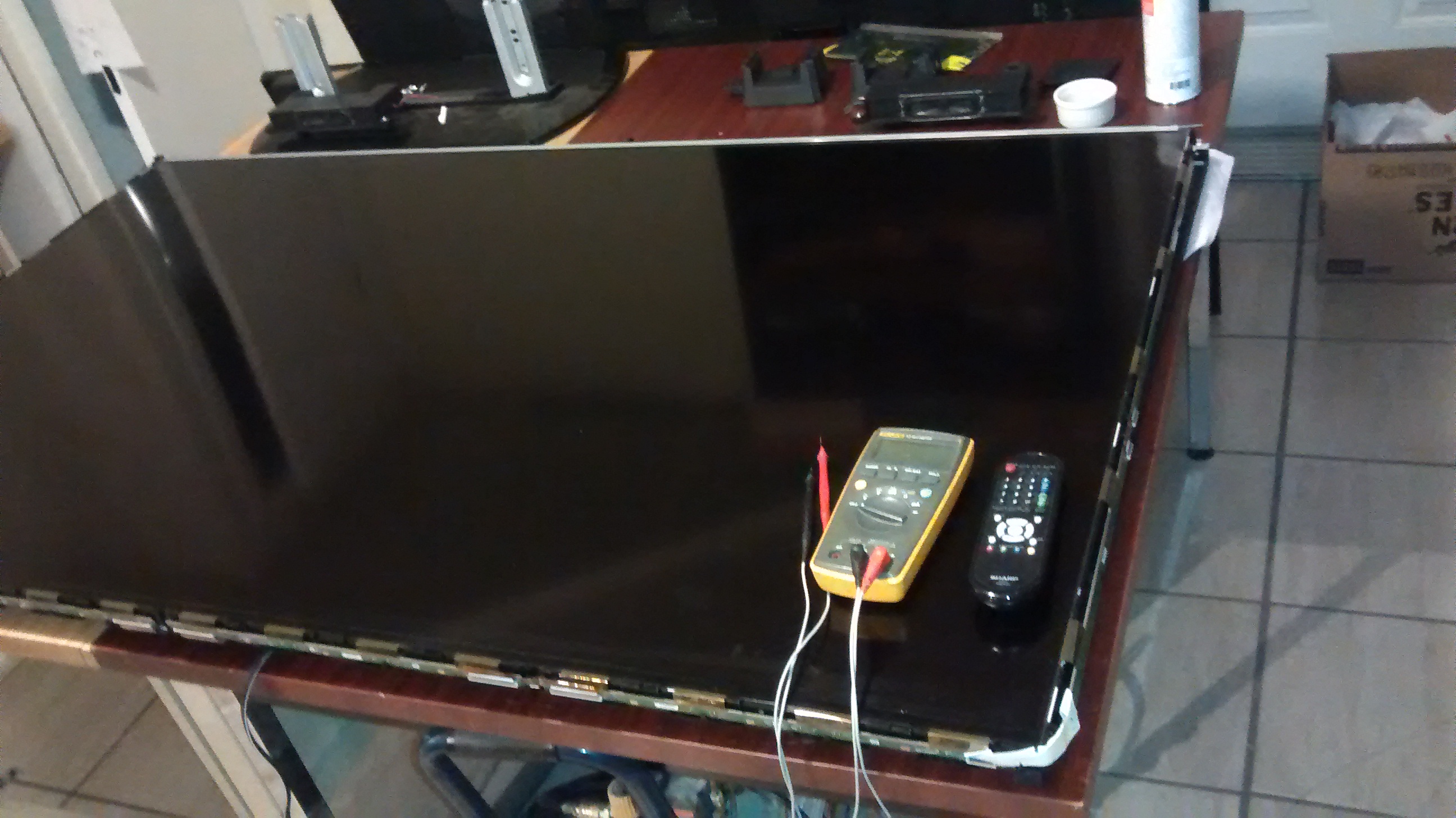

    Removed front bezel to get access to the tab bonds / COFs. Sure enough, to the right there are two, the first and third from the bottom that heat between 50 deg C and up to 100 deg C within a matter of seconds. All the bottom COF stay at about 40 deg C, all COF on the left side stay at about 25 deg C.
    The voltage on the little ceramic cap right next to the overheating COF is 5.9V.
    Did anybody have this problem and find a solution or remedy? Maybe lowering some voltage that comes from the TCON/modify the circuit ect?
    Why does it have an awesome picture while it's working? Why does it not always overheat to the same temperature?
    I know chances a very slim to repair this but it's really a shame to scrap that TV.

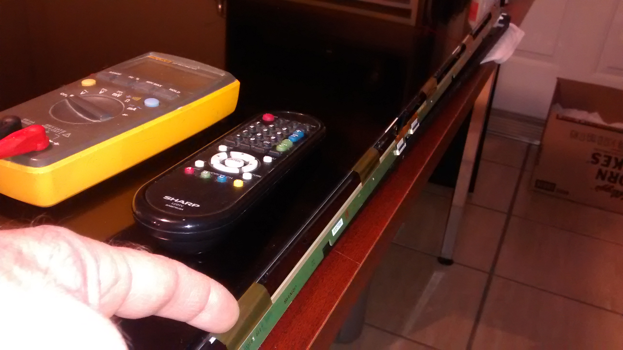

    IF you are good at soldering, you might try swapping out the bad smd capacitors. You can compare voltages along with resistance values with others on the board to see if this is indeed the issue. Finally, IF the operation is not successful, you can try the "last chance save" of just removing the tabs on the failing side. Lots of posts dealing with this type of save. The set will operate "near design" with a very watchable picture. A 70in tv that I saved over 2.5 years ago is still operating fine in this mode. NOTE: the tab removal can not be reverse so it is the "last straw operation"... so exhaust all other avenues before taking this last step.

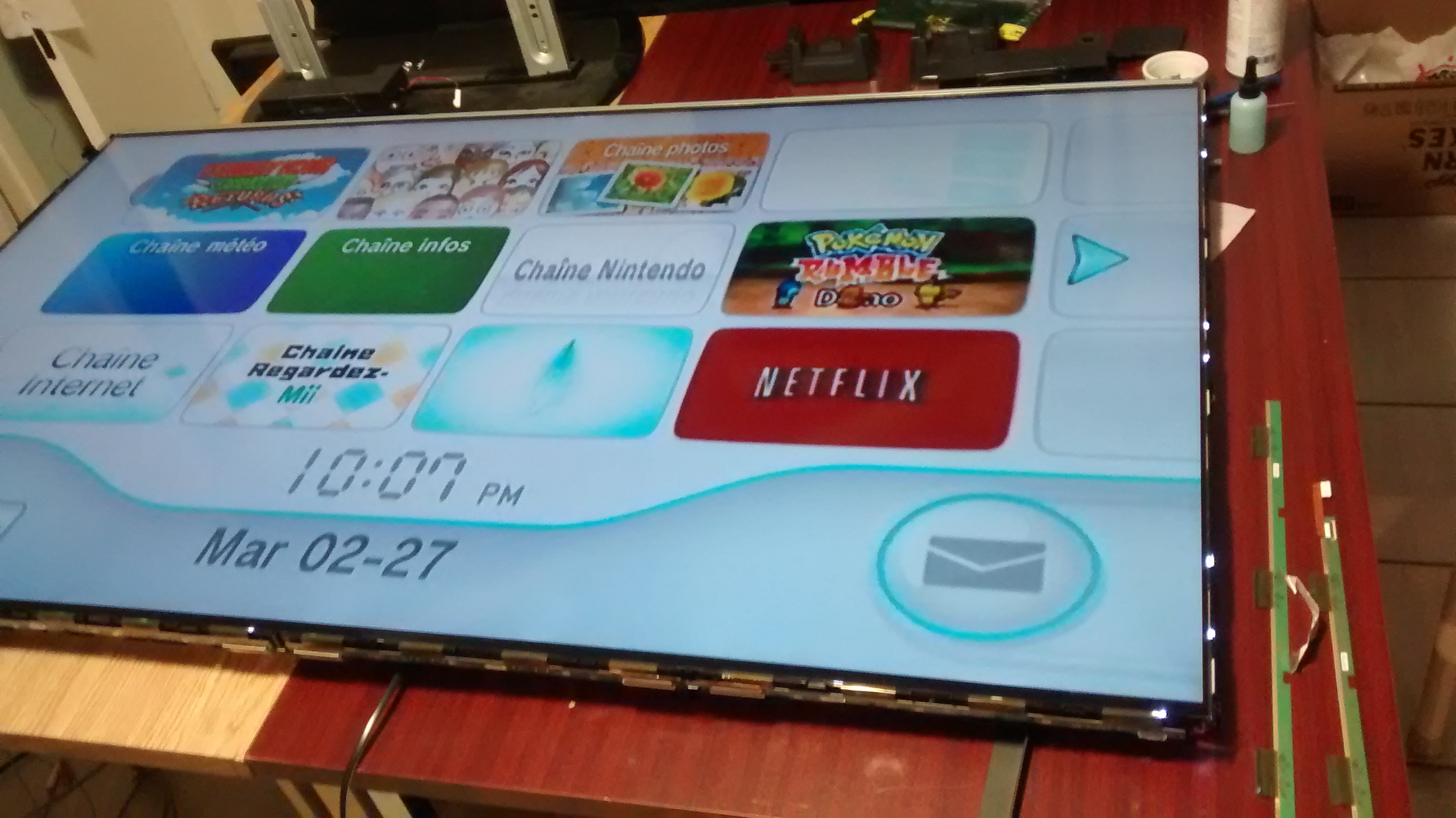

          WOW!!!
          I can confirm this worked!
          I don't know for how long but this is incredible, remove defective parts and it works again, like you cut out a cancer.
          If all repairs were like this!! Like, ok, TV doesn't turn on, remove the PSU, hahaha.
          Now if I don't break anything when reassembling I'll have a really nice TV, can't really sell it in good faith...
          If it doesn't hold up I'll update this thread
