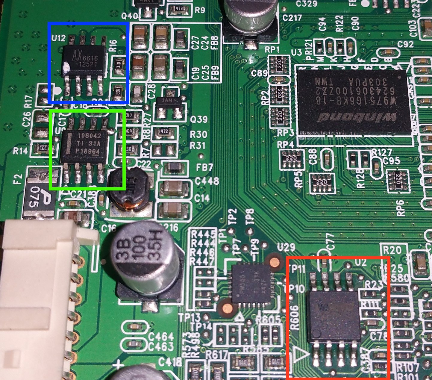

    Need to swap out an EEPROM on this Toshiba Main Board, but am not sure which one it is..
    Referring to attached pic..
    My first thought was the WINBOND chip (RED)...
    But I know that often times the EEPROM is dabbed with a little paint mark (BLUE)...
    Any assistance would be appreciated..

    From photo,only U2,marked in red,can't see what is marked but if you say is winbond could be.
    U9 (green) is some DC-DC converter
    U12 (blue) is regulator http://www.axelite.com.tw/Doc/Binary...e-e6094e523b41

      That's what I thought.. Many thanx...
