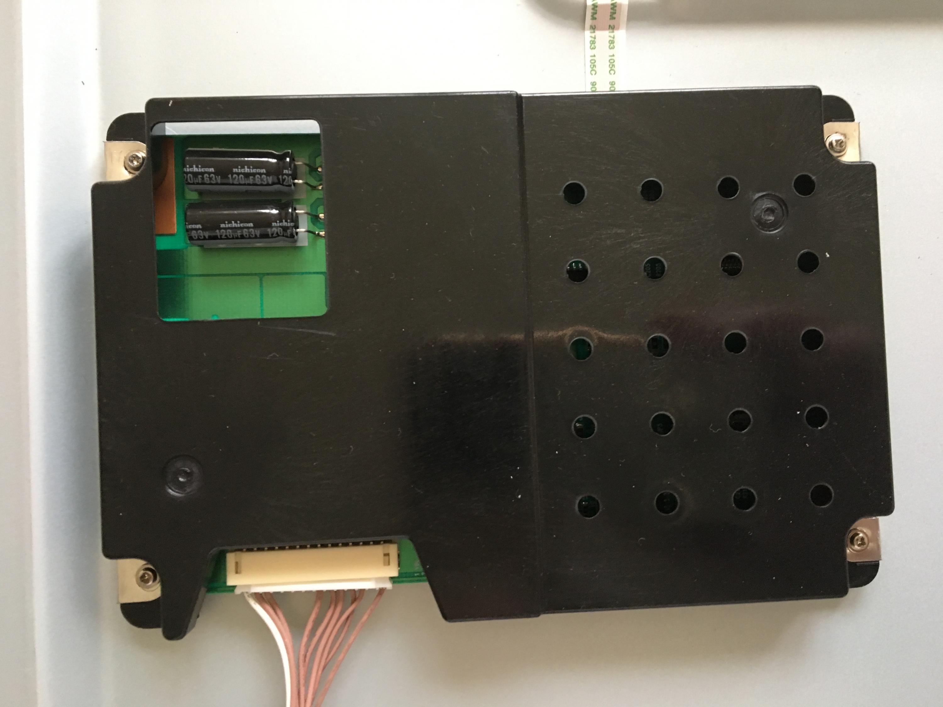

    Hi got another one for you guys that has me stumped now
    Not my tv looking at it for a mate from work
    TV powers on backlights come on but no picture, he tells me it has sound but I have not heard any sound

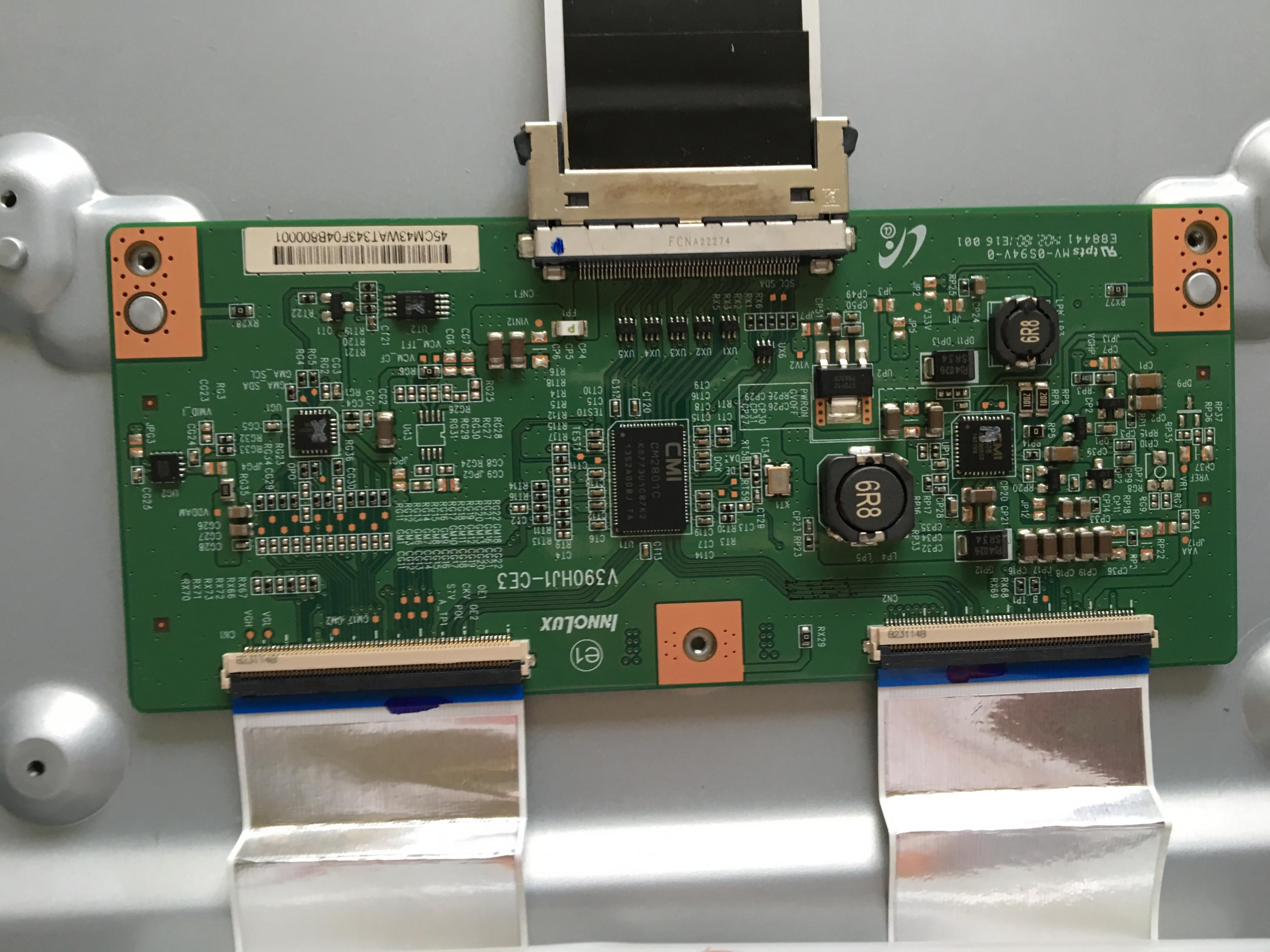

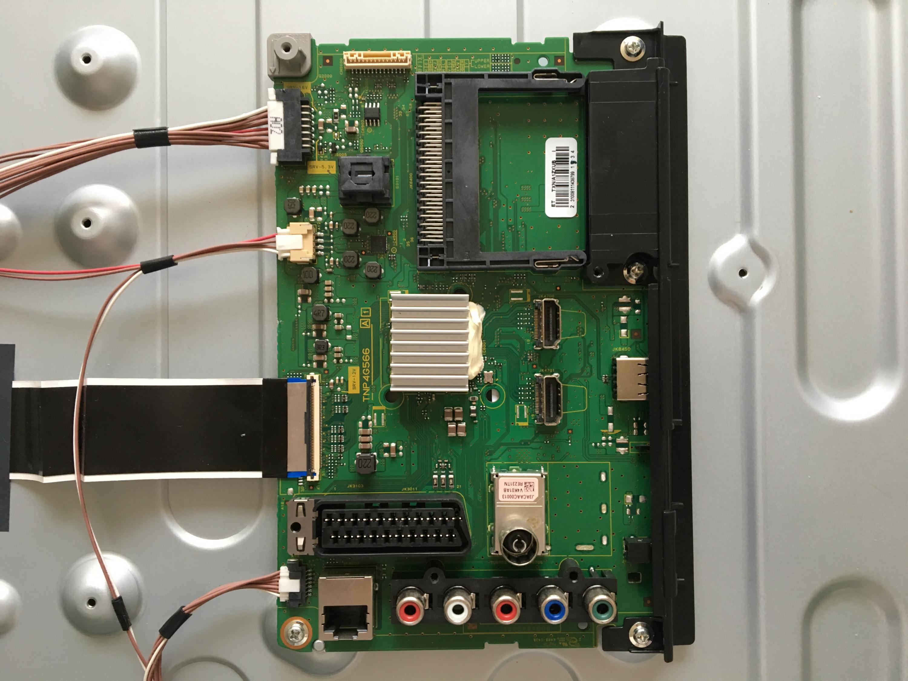

    My first thought was a mainboard problem, replaced the mainboard with a used board but still no picture
    Moved on to Tcon board and replaced that, still no picture,

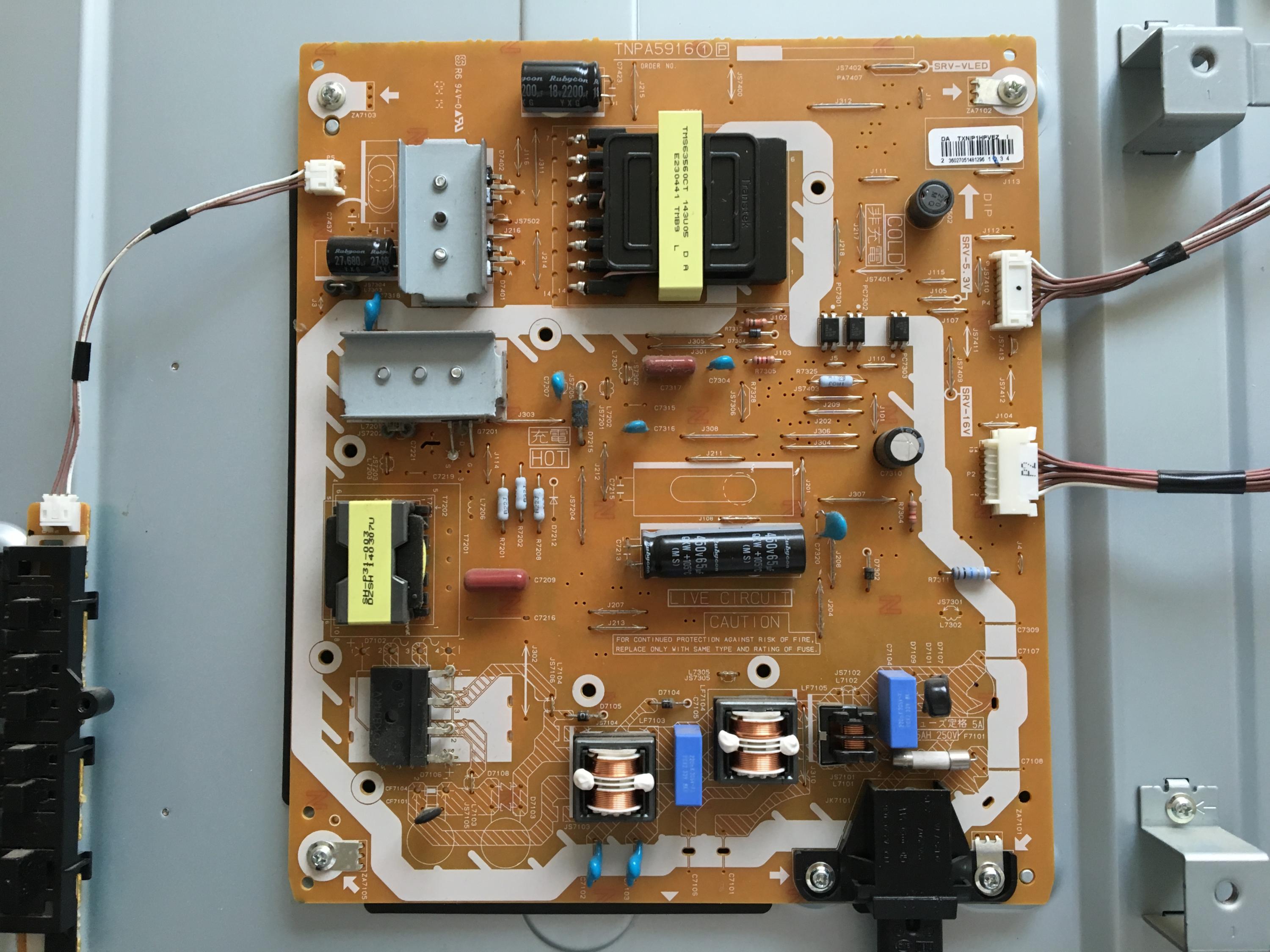

    I do have 12v at the white tcon board fuse
    Now I am stumped any ideas out there please where to look next

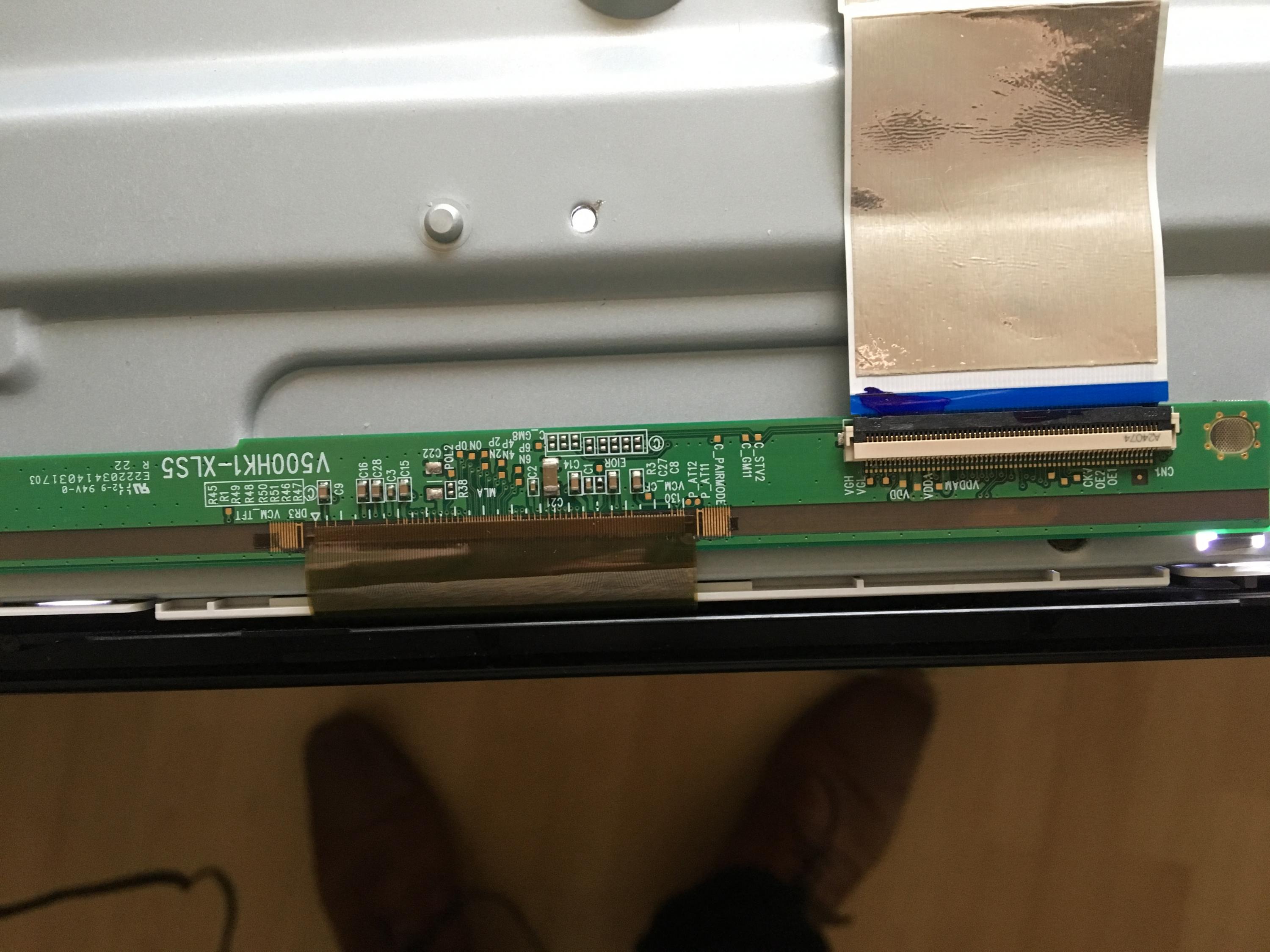

    Just before posting this I removed one ribbon at a time from the tcon to panel
    first ribbon off right hand side as looking down on the board gave me Half a picture
    second ribbon removed made no difference no picture on other half
  • diif
    • Feb 2014
    • 6978
    • England
    Re: Panasonic TX-50A400B No picture Backlights on
    Only half a picture suggests either a COF has failed or if you are lucky a capacitor is short. You should be able to get to it by removing the metal guard that covers it if the design is like the 50" Panasonic I did last night.

      just refitted original mainboard so now has replacement tcon and same backights on no picture, removing ribbons gives same results one ribbon removed {right} gives half picture, left ribbon removed no change no picture at all but backlights still on
      maybe a faulty panel

          Shouldn't need the panel stripping down, just 5 or 6 screws hold each cover on.

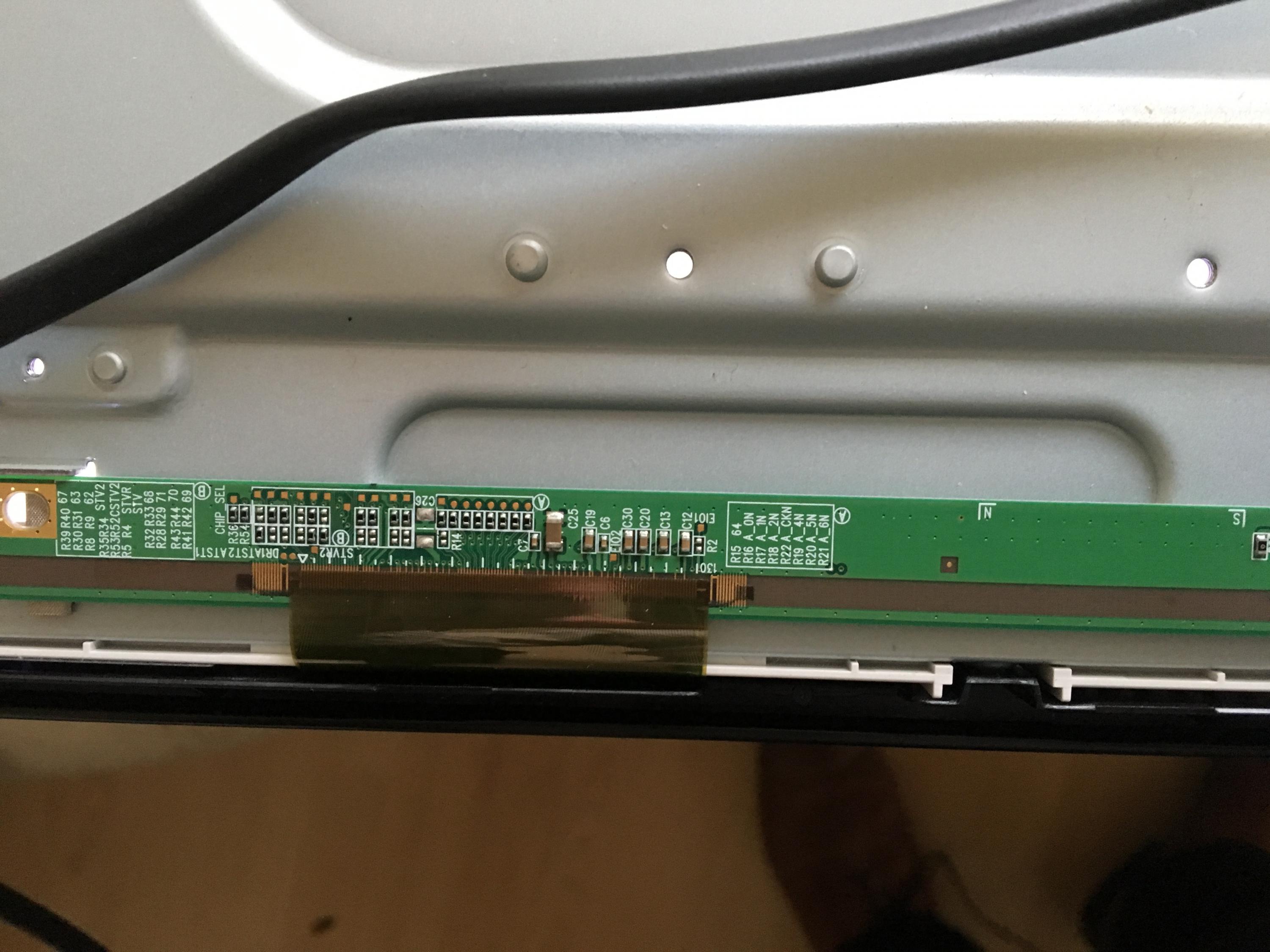

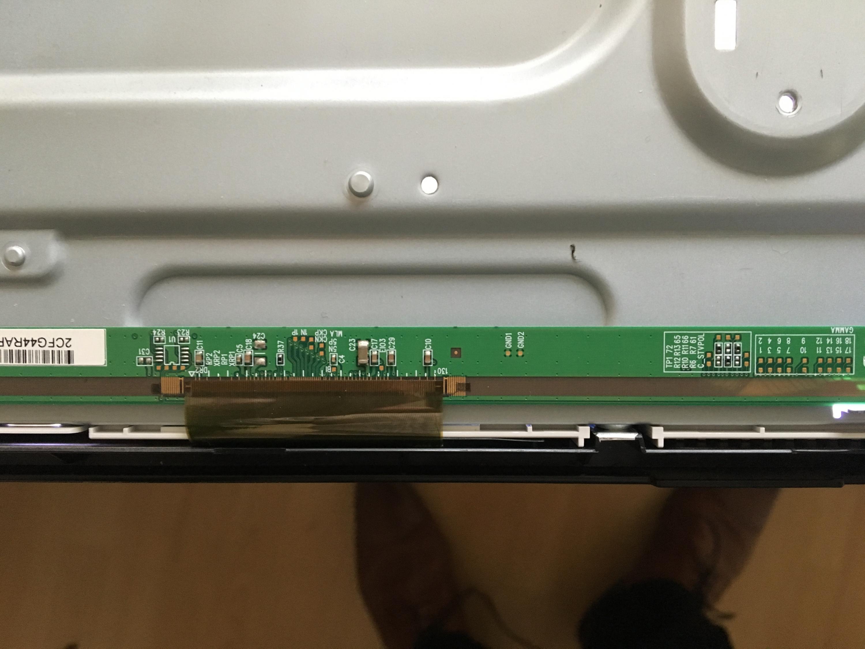

            just got the covers off these panel driver boards, can not see anything obvious wrong
            • diif
              • Feb 2014
              • 6978
              • England
              What about testing the caps for shorts. It's rare to see caps that small burnt. It's the side that has no picture you need to test.

                  The way I test for shorts is put my multimeter into diode mode. Then the red lead on ground then probe with the black. A short is about 0v non short .5v

                    ok just spent some time checking caps on the driver board everything seems ok

                      That suggests a faulty COF then, unless there's anything else on that board that could be faulty.
