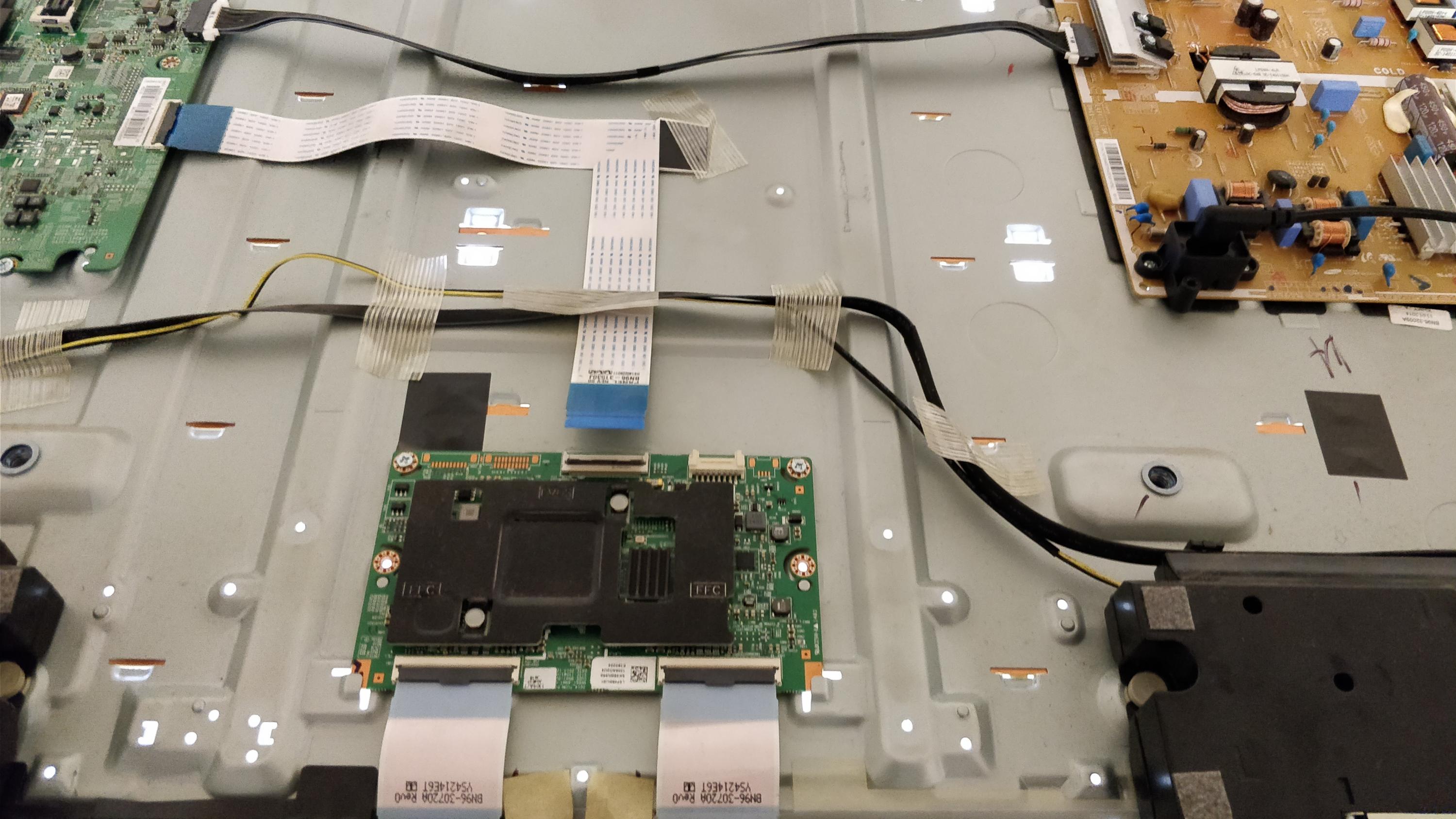

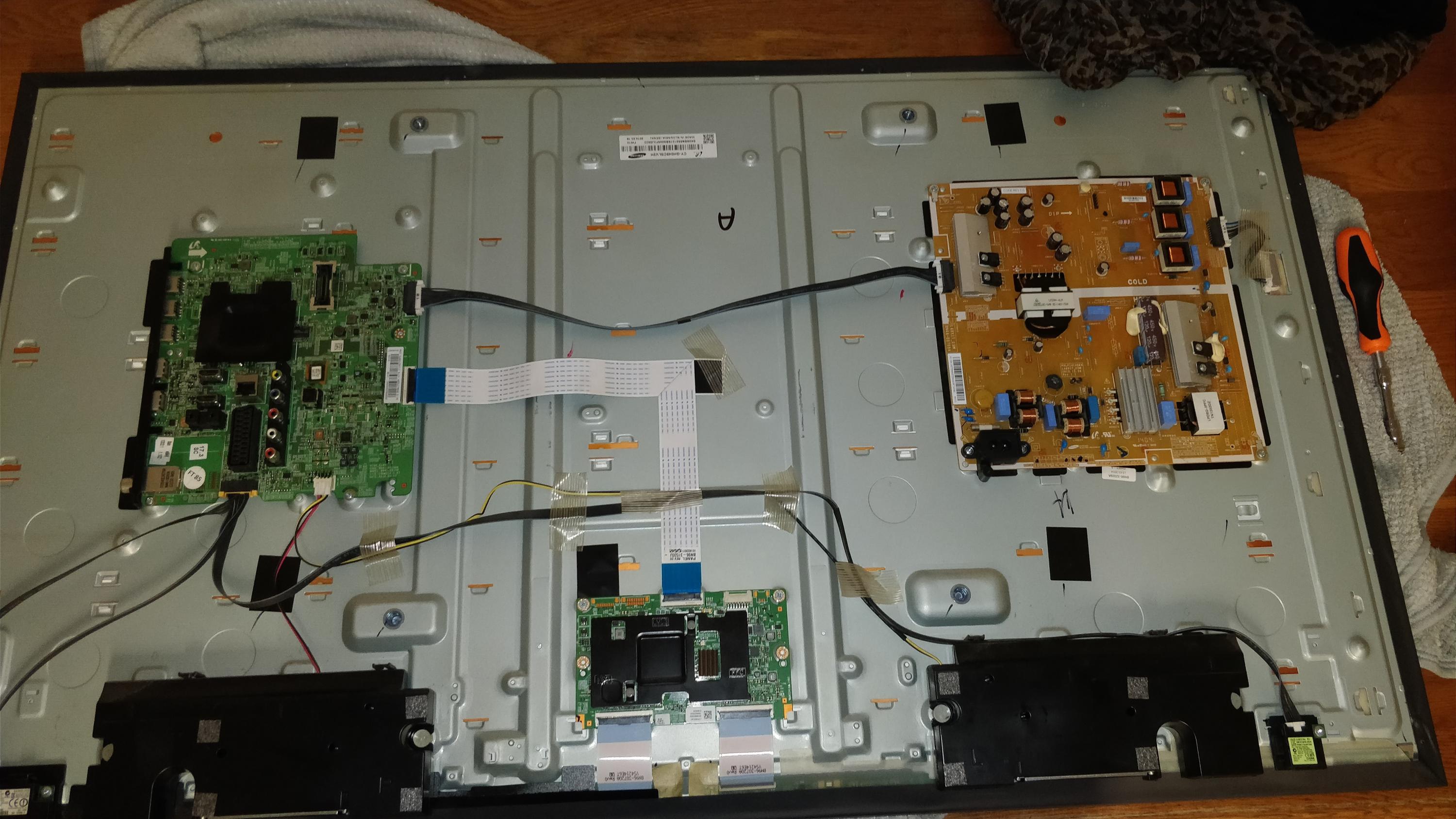

    Can we at least get some pictures of the whole backside of the TV showing all the board so we can see what we are dealing with?

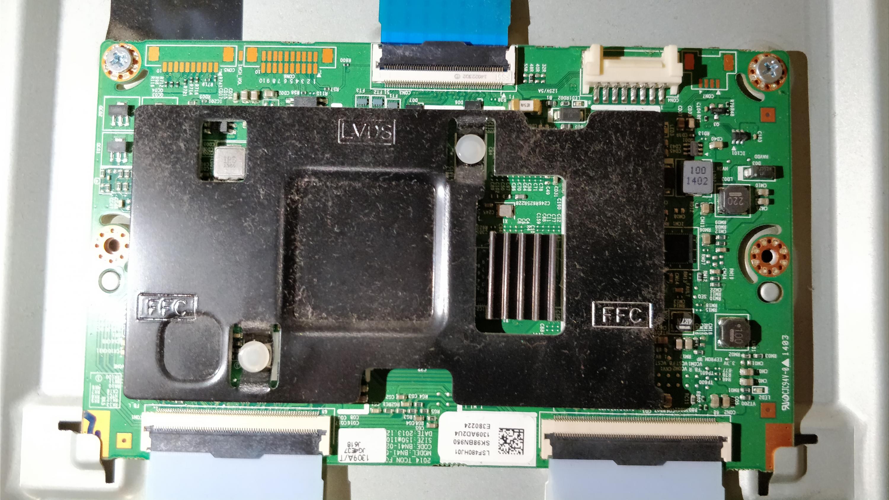

      I do happen to have one picture however, it is a picture of the T-Con module.

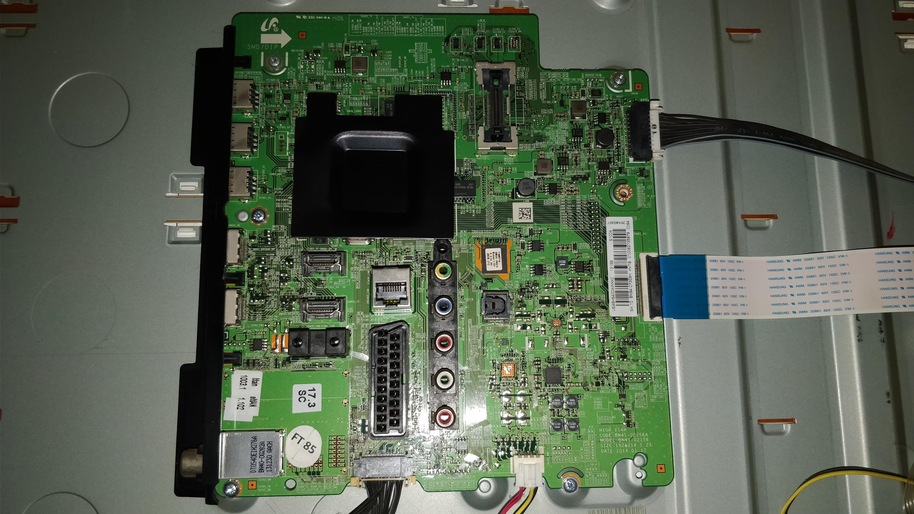

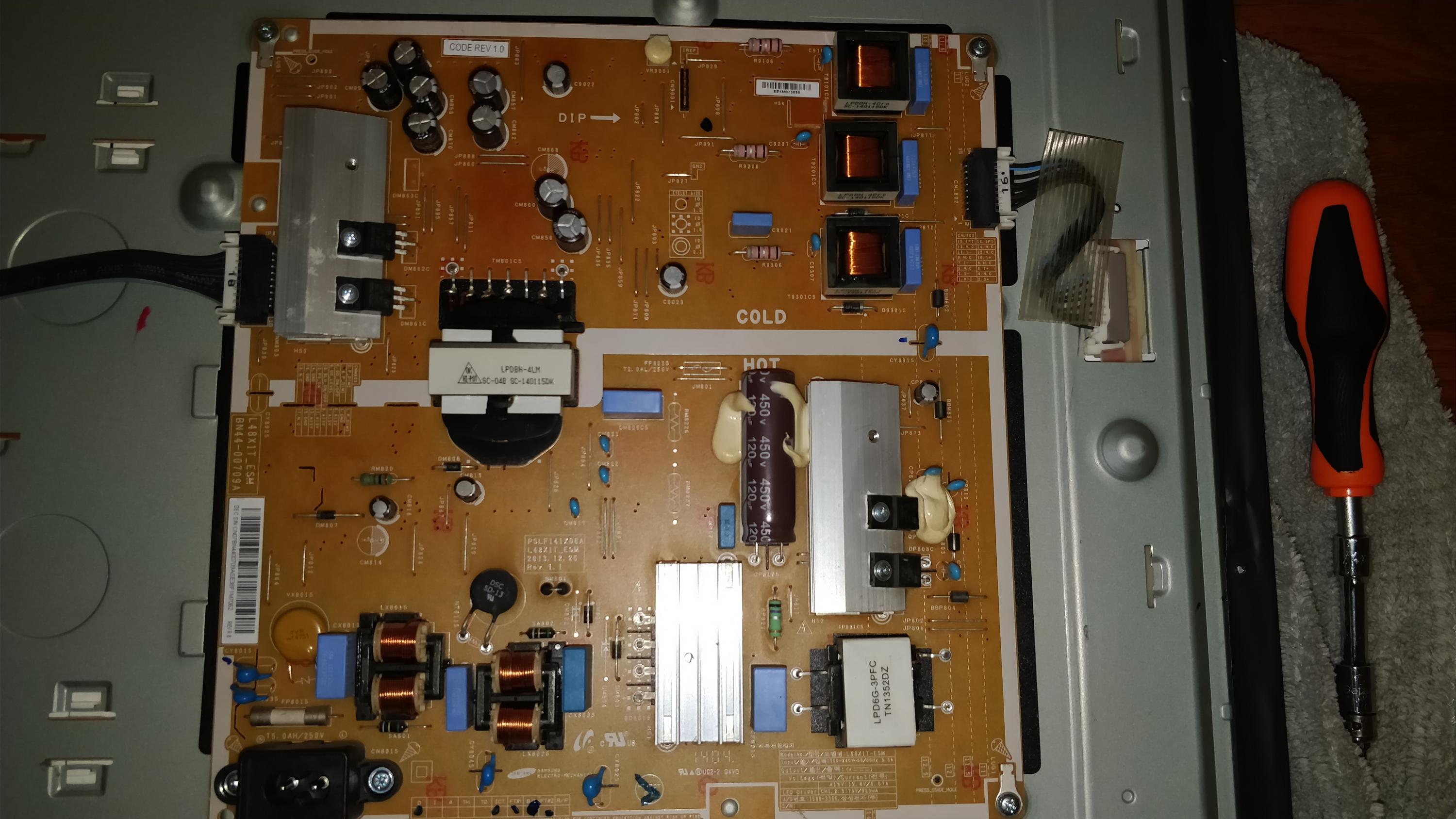

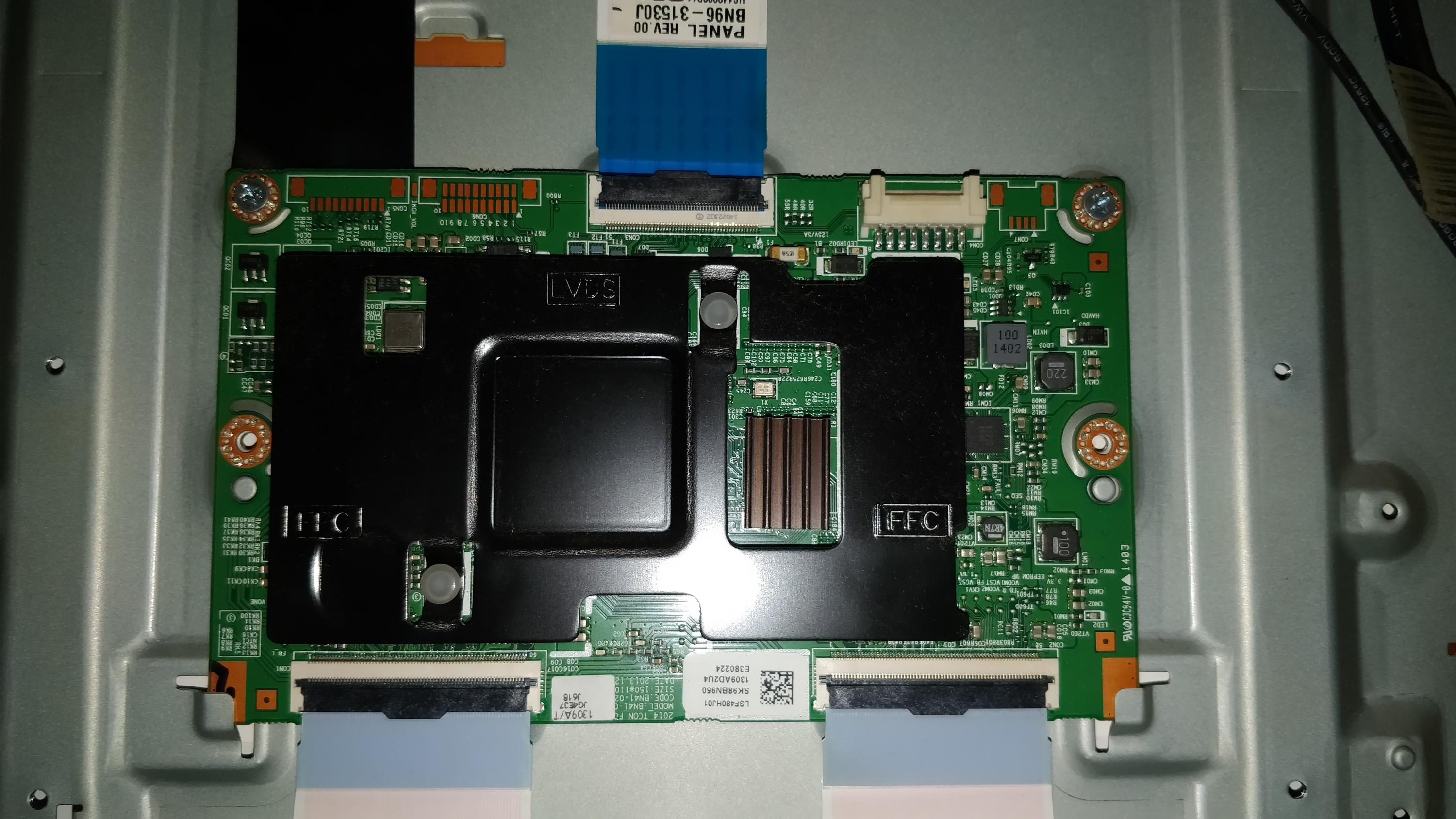

          I took the pictures today.
          The first image shows the whole backside of the TV. The following three pictures are the three individual boards. And the last picture answers your question:
          So the power supply and backlights/backlights circuit are OK.
          If you disconnect the cable from T-CON to the main board, do you get backlights to come on?
          The answer is YES. The backlights do come on when the T-CON board is disconnected from the main board. Do you happen to know what this means?

              If the backlights come on with the main board disconnected on Samsung tvs, then the main board is suspect. You should check if the BL-ON signal is coming from the main board and also check the rest of the voltages on that connector.

                Maybe check tcon fuse, see if you have voltage on each side.
