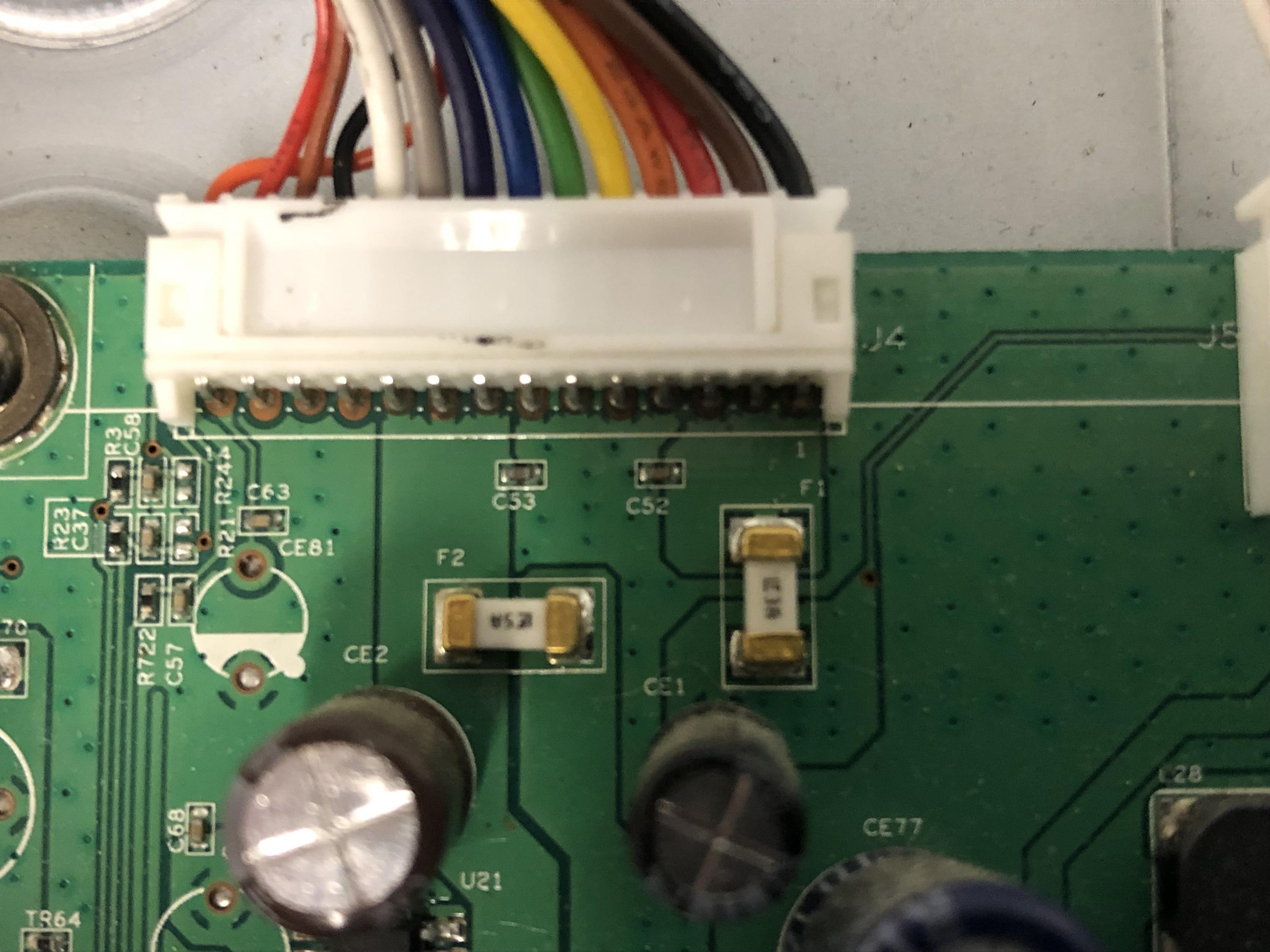

                    I also have a Vizio e420vo that is dead. It is my brothers tv and was working fine until he messed with the circuit the tv was connected to while hooking up a ceiling fan. I don't know what he did, but he blew the breaker. when he fixed the fan wiring, the tv would not turn on. I looked at the boards and there is not obvious signs of anything being cooked. The main fuse on the power supply is good and I get 5v on the 3 pins that say 5v on the header that goes to the main board. I did followed BUDM's suggestion by connecting 3 1k resistors to the connector that goes to the main board to the backlight, ps on and I on off and the backlight lit up. Does that mean the power board is good? I have read about the eeprom possibly fixing the problem, but the vizio logo does not light up orange when the tv is plugged in. Do you think the eeprom will fix my set? Thank you in advance for any help.

                        nomoresonys - There are no buttons on the TV. I was probing around on the main board. There are what I think are 2 fuses by the connector coming from the power board. I get continuity at F2 but not at F1. How can I safely jump this to test it? If this is my problem, where can I get a replacement?

                          They are little Fuse brand, available everywhere, ie: digikey F2583CT-ND https://www.digikey.com/product-deta...83CT-ND/813061
                          I would check for a shorted component on the main board side of the fuse

                              I'm not really sure how to do that. Any guidance is greatly appreciated.

                                Here's a little light reading that might help you out: https://sciencing.com/short-circuit-board-7818140.html
