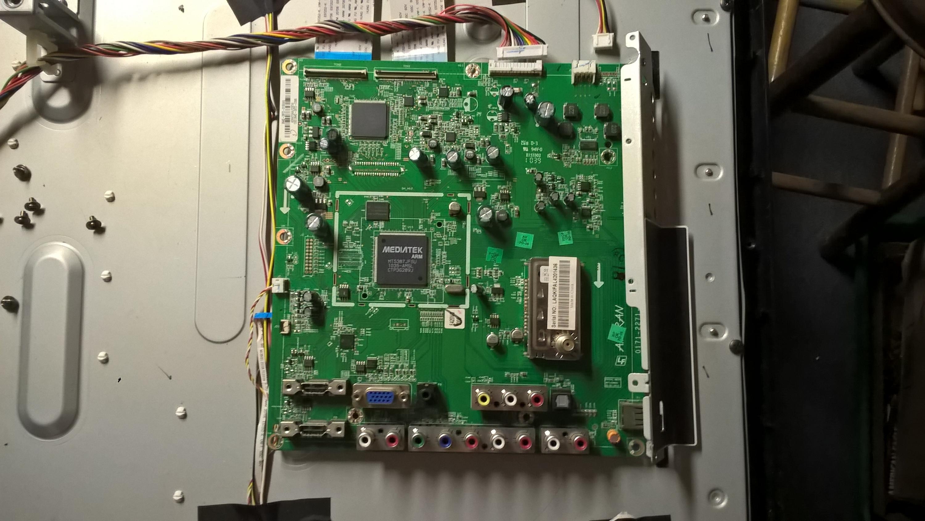

    vizio dead set

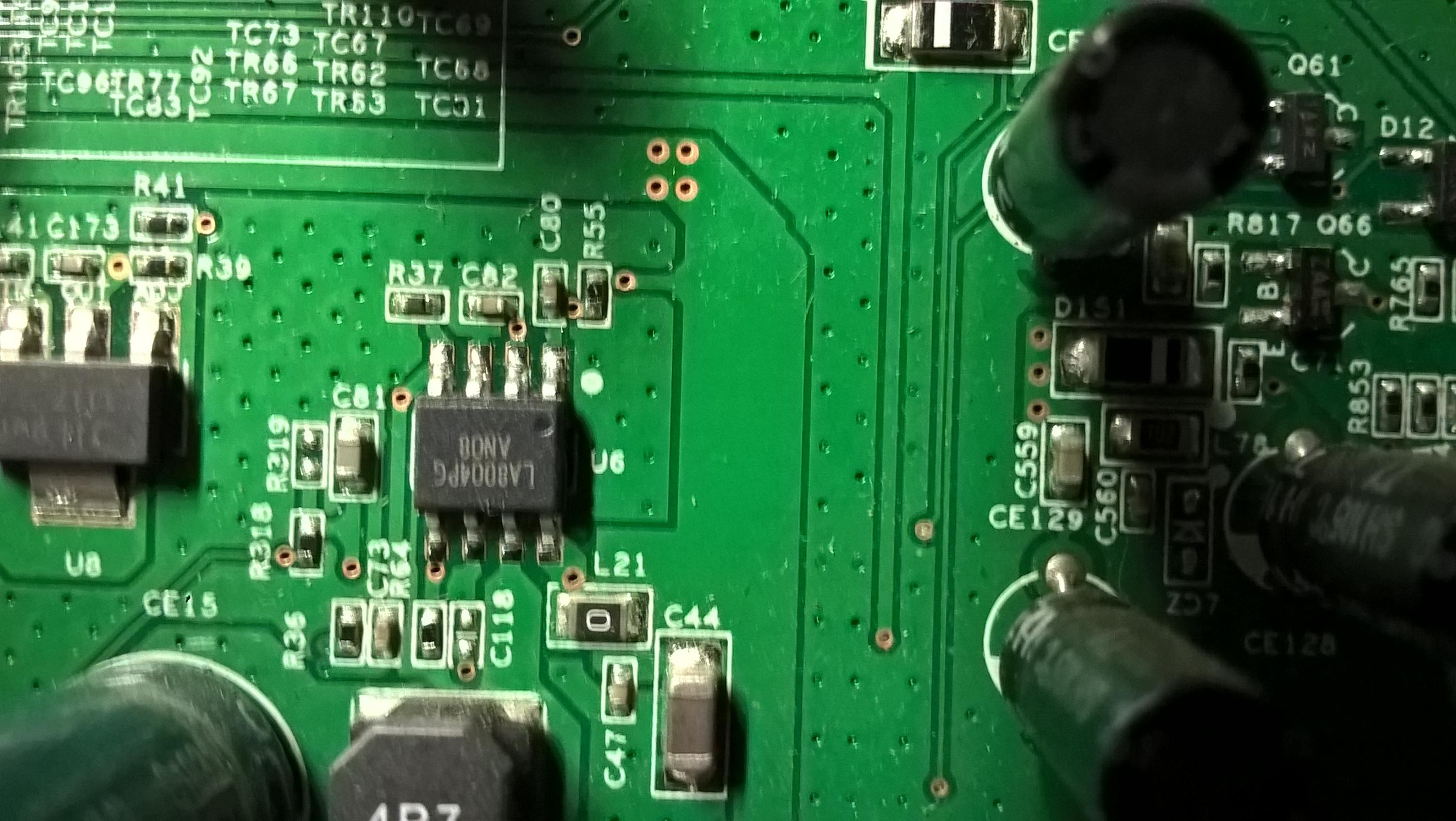

    Kinda new to this so bare with me. This is a vizio E420V0. Completely dead,no power light,nothing. On the main board,"3642-0972-0150(41)" the 3v nano fuse is blown. From the fuse through a cap goes to u6 a IC or eeprom.not sure what it is. If I'm doing this correct with meter in diode mode. From pin one to last pin"straight across" It shows shorted. Thinking this is what I need to replace. I can't find it. The part number is LA8004PG AN08. I'm I on the right track.

        I believe that ic is similar to a ap3435, pin 1 (Vcc) can be connected to pin 8 (Vin), It is a step down converter from 2.7v to 5.5v input to 1.2 volts output on pin 7, check if pin 1,8 or7 are shorted to ground (pin3 & 6)

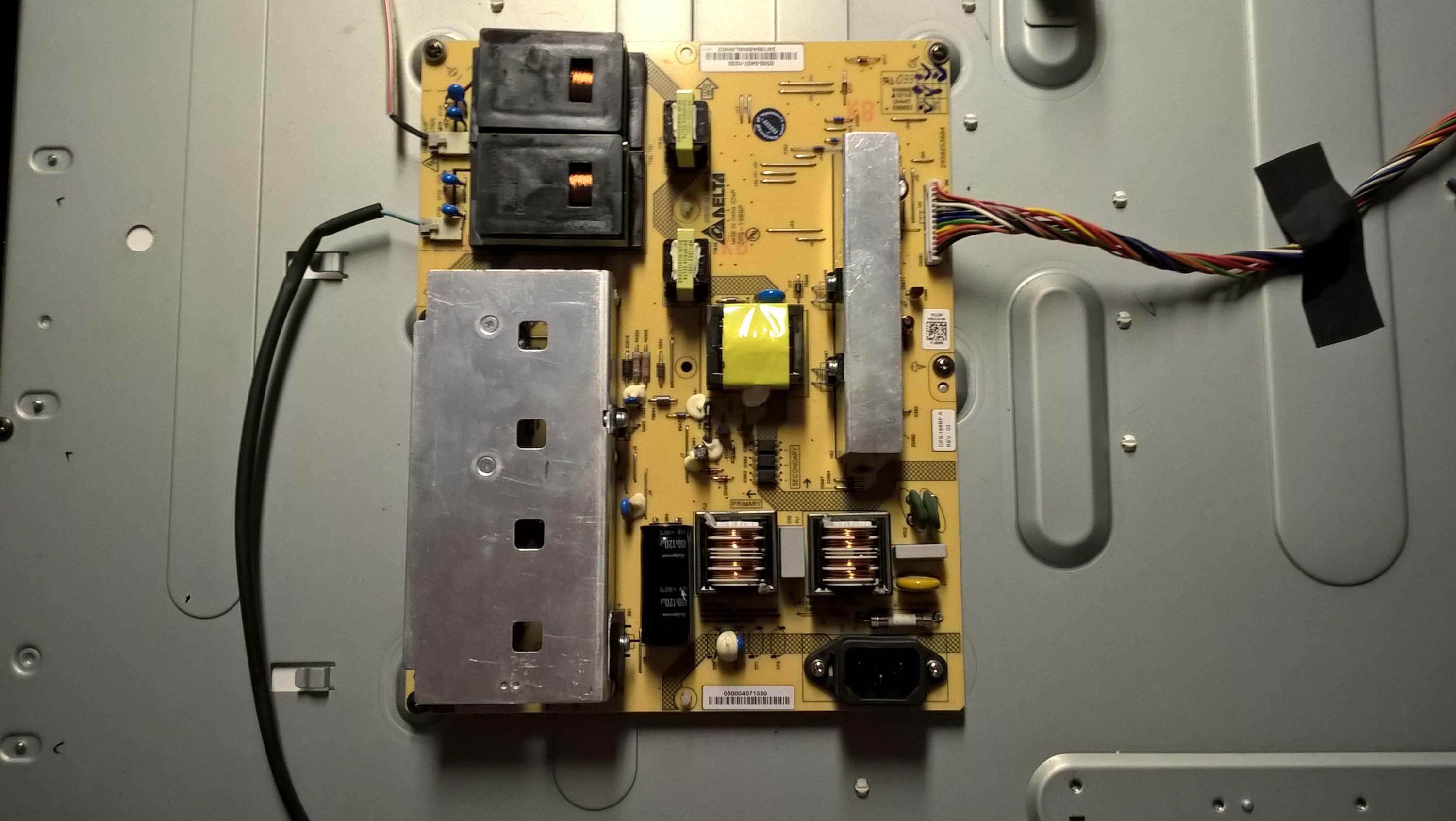

          Main board:
          http://assets.shopjimmy.com/media/ca...0150-top_5.jpg
          Power supply board:
          http://assets.shopjimmy.com/media/ca...1030-top_4.jpg
          The two fuses on the main board:
          F1 is for the 5V STBY, that 5VSTBY is fed to many circuits on the main board so shorts circuits can be any where that the 5VSTBY is connected to.
          F2 is for switched 12V.

              All voltages are good on power board. Is u6 an IC ? No voltage on any pin just as I suspect because fuse blown.

                  Yes u6 is an ic, it is a stepdown converter (post#4) What voltages do you have on its pins? Does it get hot to the touch?

                    Re: vizio dead set
                    Does not get hot or warm.pin 1-5.07 pin2- is all over the place,but slowly goes to 0 pin 3 and 4 - .796 pin 5- 1.6 pin 6- .9 pin 7- 1.850 pin 8-5.14
                    • R_J
                      • Jun 2012
                      • 9627
                      Re: vizio dead set
                      Because I am going by a different ic part number "ap3435" I can't be certain about what the exact output voltage on pin 7 should be, but it seems to be fine.
                      Pin 2 has no connection
                      pin 3 and 6 should be ground
                      See page 15 of the pdf
