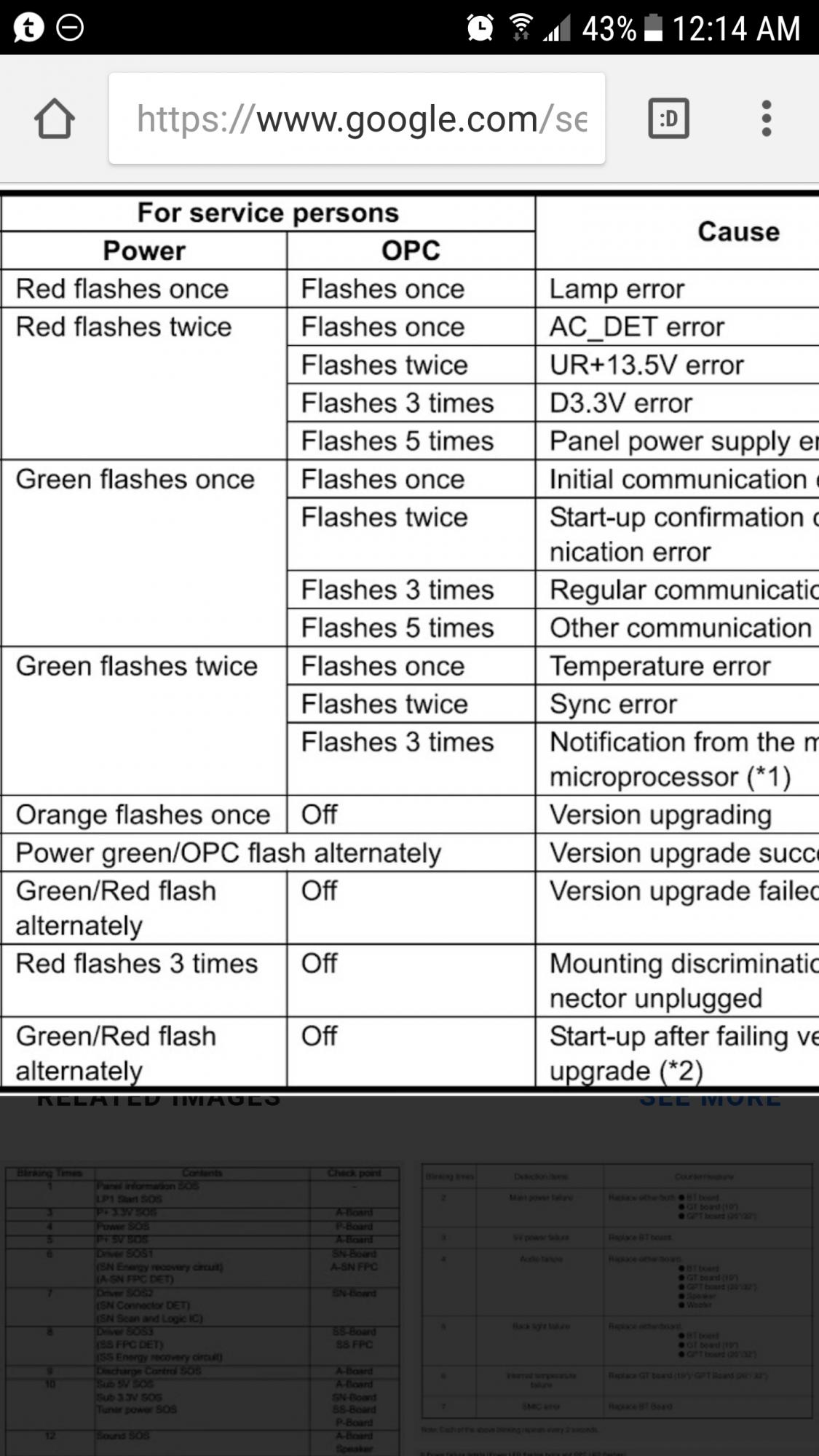

          Attached is another code chart. My code seems to be an Initial communication error. I can't find a code chartspecific to my model. Should I pick up a main board?

            Re: Sharp LC-60E79U - 2 Green, 1 blink - 1 Green 1 blink
            DET_15V error
            Flashes once
            H: On
            L: Off
            DET_15V (34pin) error (L). UR13V is not applied.
            If error is detected during operation, error standby is activated by
            polling.
            I believe this is my error code. Does the PS generate the 15V or does the main?
            I assume the PS, I'll go through the wiring and schematics and see what I find.

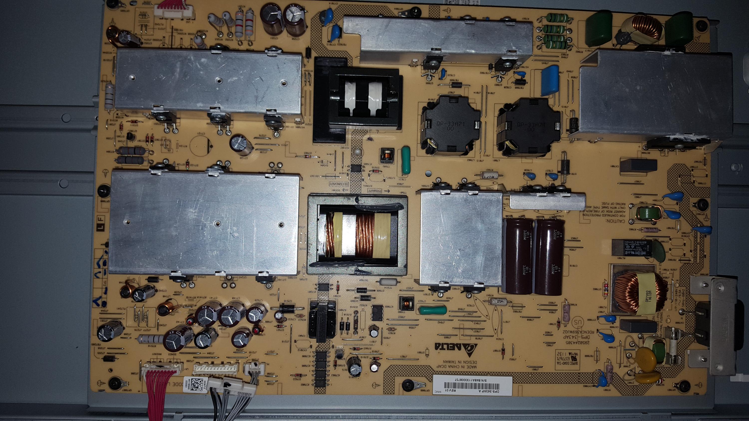

                          What is your power supply board P/N? I can see that it is made by DELTA but I cannot read the P/N on the board.
                          Is this the one:
                          Sharp RDENCA369WJQZ (DPS-343AP A, 2950244303) Power Supply Unit.
                          http://www.shopjimmy.com/sharp-rdenc...upply-unit.htm

                                Sometimes, a little closer inspection goes a long way.
                                I took the PS off the panel and looked it over. I found a blown part.
                                Now, does anyone know what value is supposed to be there? I assume it was a smt cap.
                                I repaired an old Panasonic plasma PS with a small electrolytic cap a few years ago that is still in service. So, I assume that little cap is causing my loss of AC_DET voltage.

                                  Well, I could not find a schematic with the cap value. The service manual only had the one for the main, key, and IR boards. So, I found an old board and borrowed an smt cap from that. The TV has been working great for 2 hours.
                                  Until something else cooks, I want to thank you folks on here for helping me. Your knowledge and time are greatly appreciated!!
