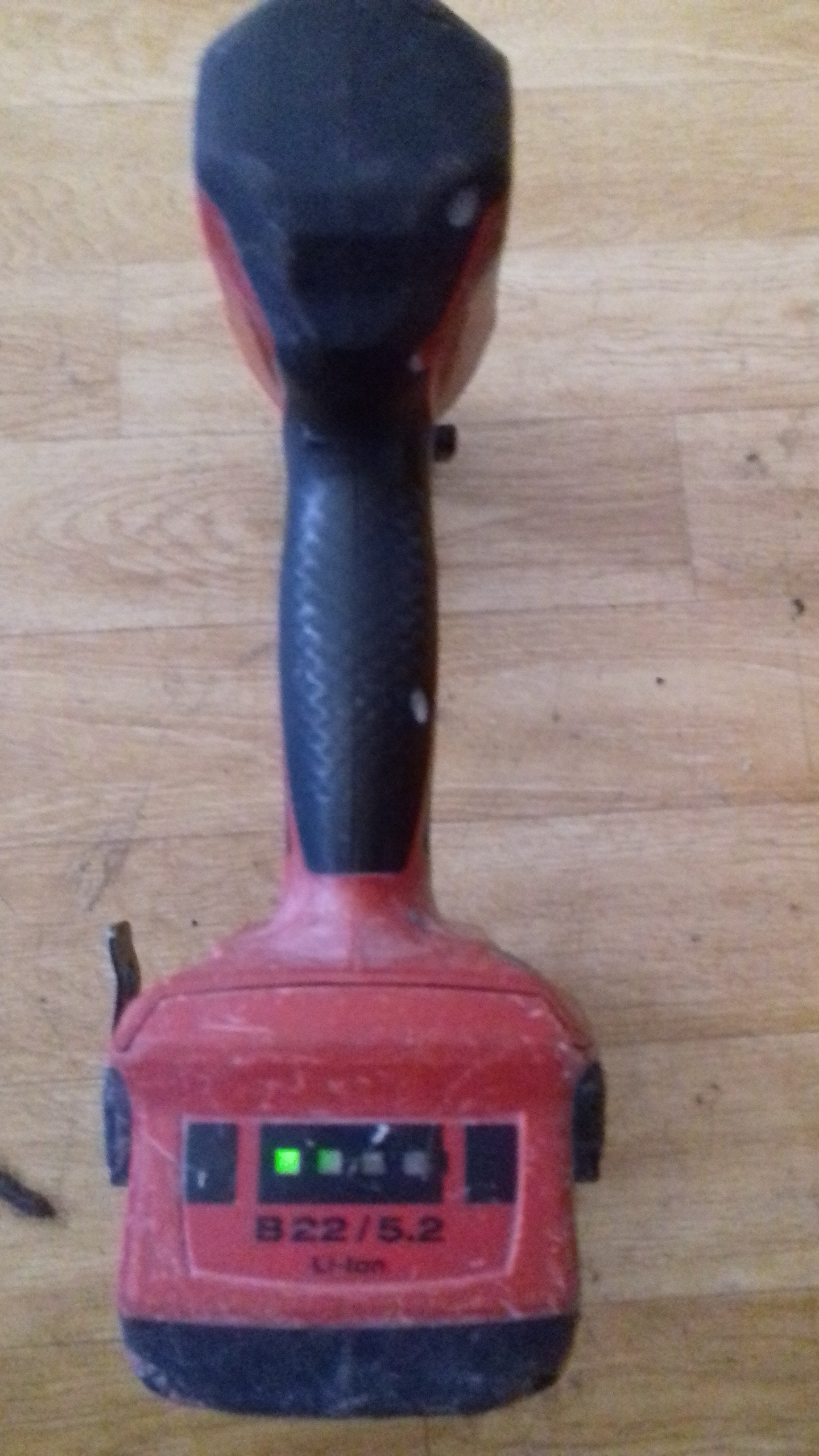

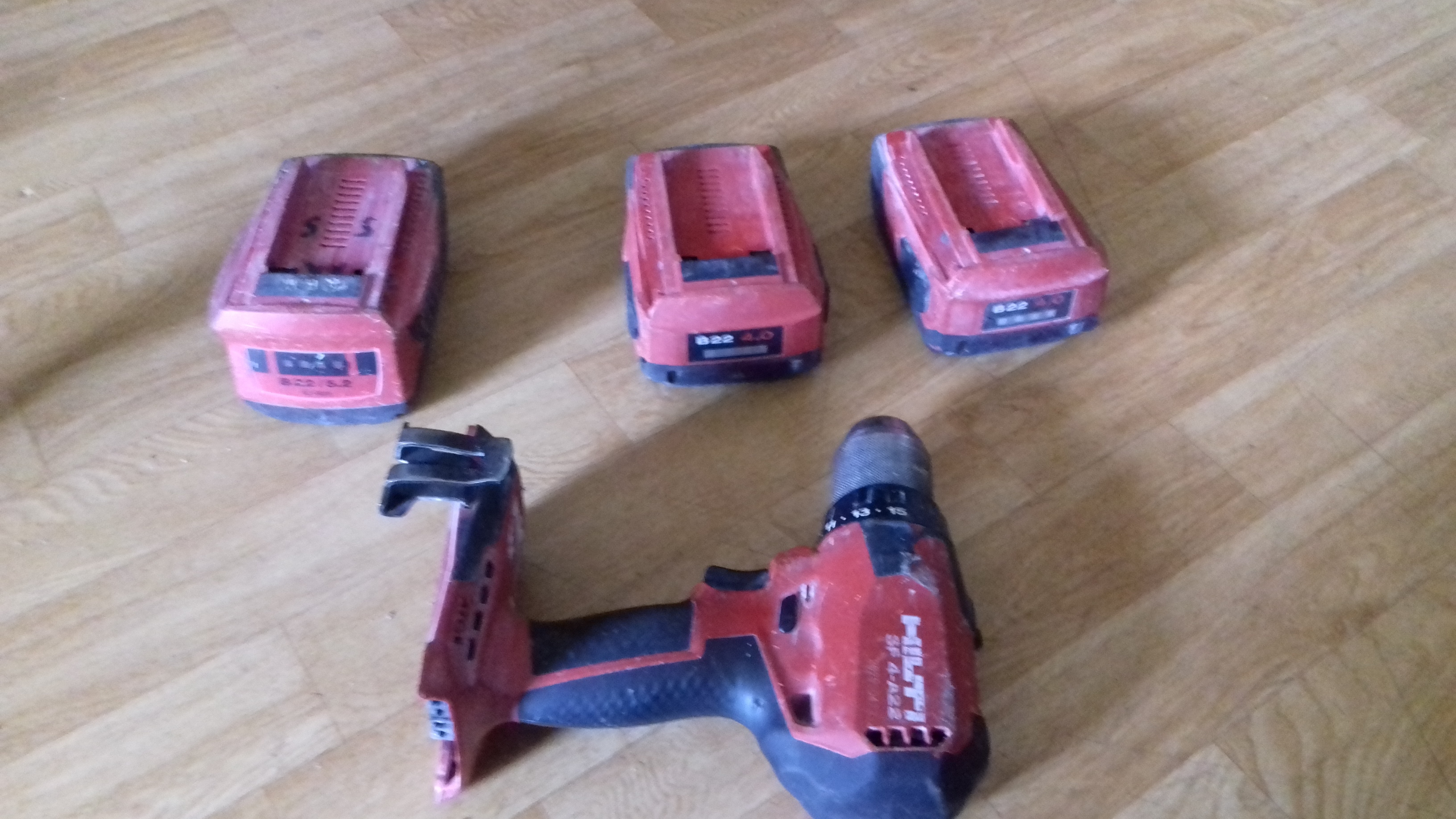

    Hilti Battery B22 4.0 blink green but not responding
    The HILTI CPC battery flashes green but no tool starts or works. when testing the battery has 19.2v what could be the problem with them because I have three similar ones but there is nothing written on them all the patches are removed in the first B22 /4.0 with 19.2v the second one B22 /5.2 with 21.8v the third B22 /4.0 with18.3v are all three destroyed ? a bit difficult to believe have also tried other Hilti tools the same thing if someone who can help very grateful

            Have opened the battery, there are 6 cell and one through encapsulated BMS that you can not do anything on that cells are quite unbalanced, 3 cell with 3.2v the others are at 2.7v ,2.4v and 2.5v it is a bit strange that they are so low, I don't think it is enough to balance them except have to see what is not right
              • 31007
              thats just an effect of age/lots of cycles.
              the board is not really a BMS, it's more of a protection/anti-fire device.
              try charging all the cells to the same level individually using jump-wires and maybe a tp4057 based charge module if you dont have something clever like a B6

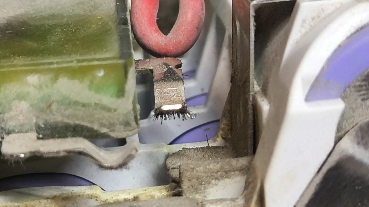

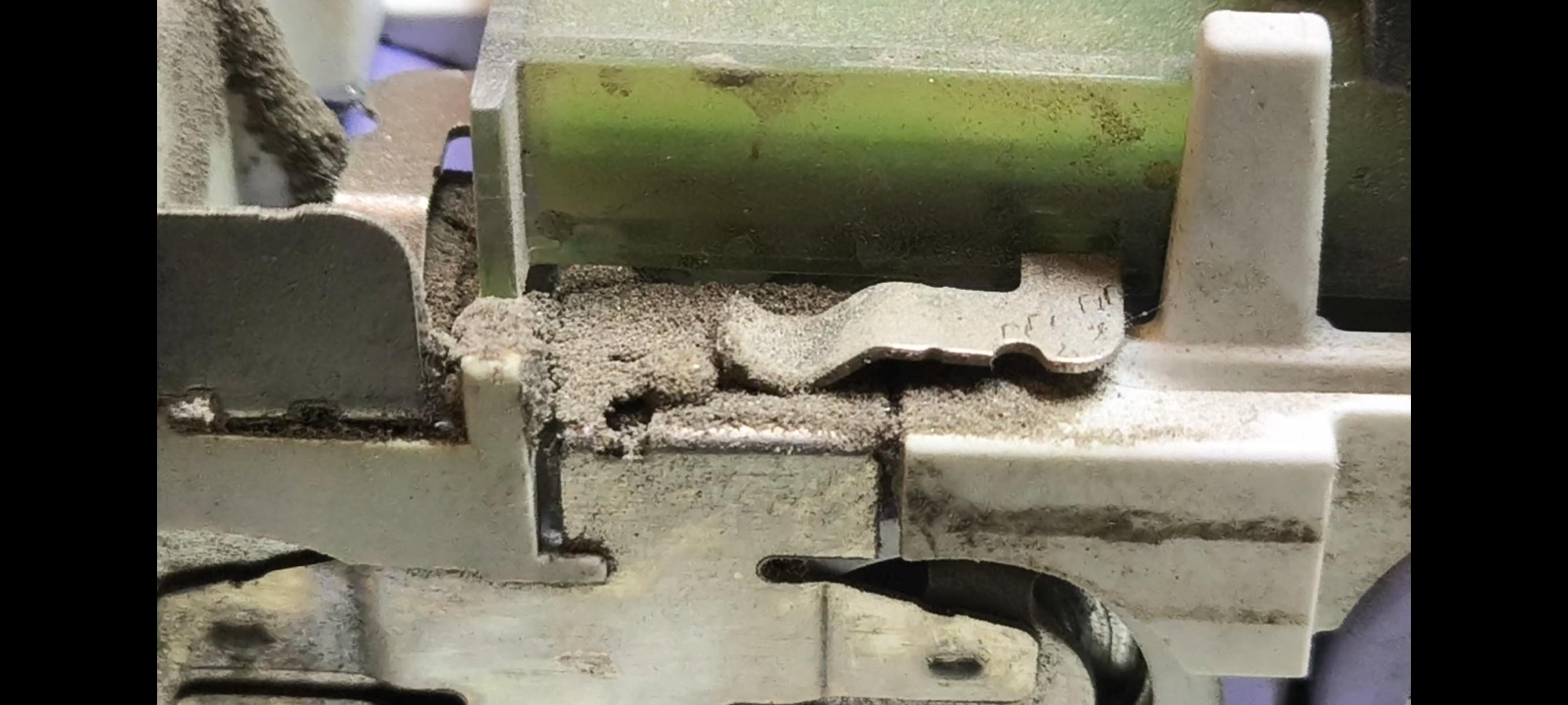

                      Originally posted by bohaboha
                      The HILTI CPC battery flashes green but no tool starts or works. .....
                      ... a bit difficult to believe have also tried other Hilti tools the same thing if someone who can help very grateful
                      The first thing you need to do is open the battery case.🙂
                      Then check the voltage on all cells. If they are not equal to each other, then rebalance with some device (such as imax) or manually on each cell to a single voltage.
                      Then you need to disconnect the protection board and clean the contacts that connect it to the cells. I would advise then, when reattaching the board, either solder these contacts or weld them with spot welding.
                      After that comes the most important point. Most likely, you will have one LED on the indicator blinking the same way as before, and native charging will not charge the battery.
                      Next (don't be surprised) You need to wet your finger and touch it in such a way that it connects the positive contact at the battery outlet and the contact to the right of it.
                      After that, the indicator will start showing the voltage to which the battery is charged. I talked about it (though in Russian) in this video:
                      https://youtu.be/TVYLEUM5D6w?t=10m51s
