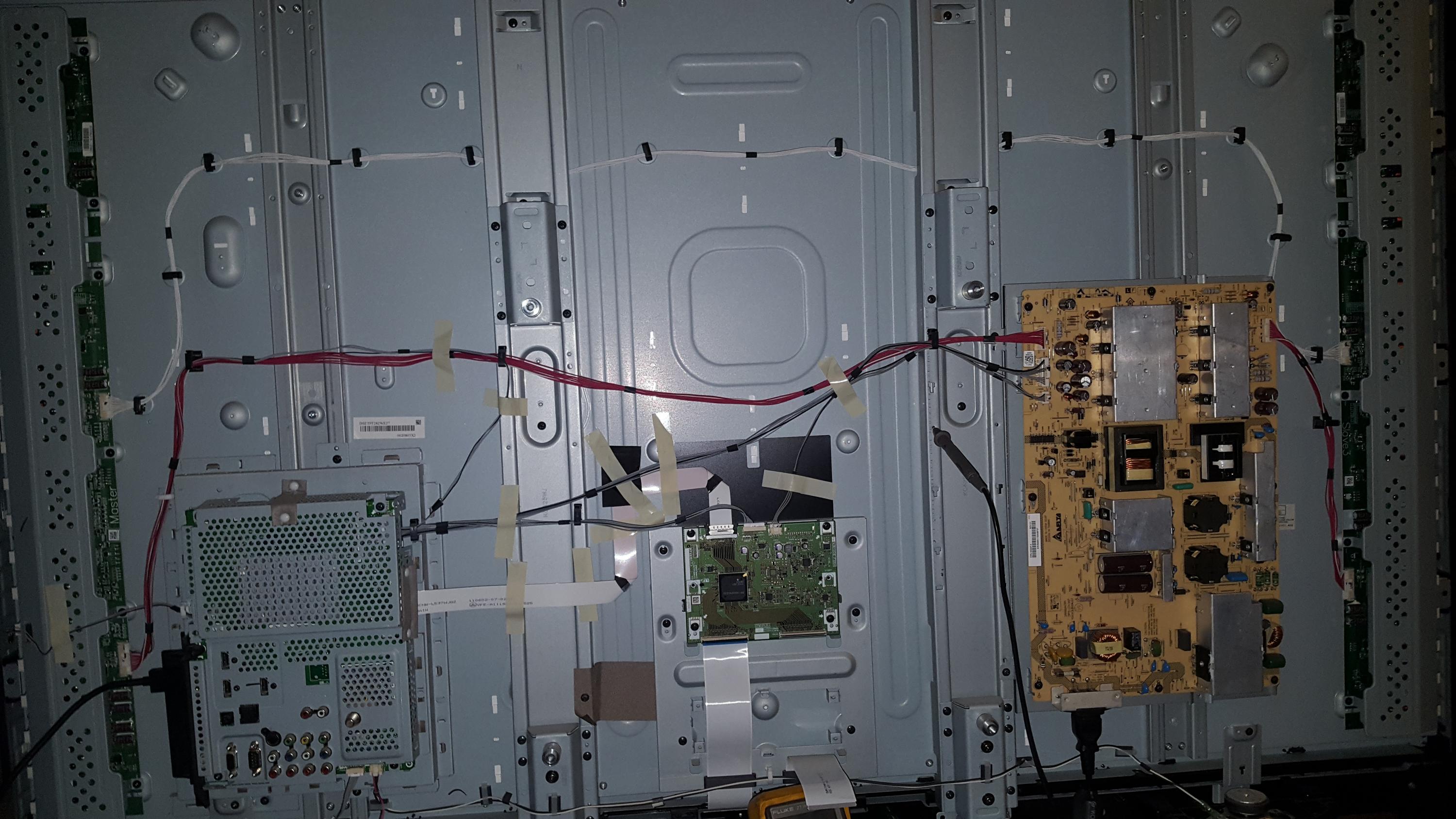

              • SolderMaster
                • Dec 2013
                • 53
                Re: Sharp LC-60E79U - 2 Green, 1 blink - 1 Green 1 blink
                Added photos
                    ok.... not sure if it helped... but maybe. I understand the first picture of the three as I can see that the right side (from the front) has been disconnected and the picture on the left is "good" because it is getting signal. I don't understand what the second picture is as it shows a complete picture, does the set now work properly?
                    Further, how are you starting the set up at this point.... just power up button or are you using the "force sequence"? If I understand your testing, you have an issue with the right side (from the front).... when you disconnect it, the set is happy to run. When you disconnect the left side and try to run only with the "troubled side", the set gets "angry" :-) The might be an issue along the bottom on the right side ... the edge boards.... people tend to try to wash the screen but liquid gets down the front and ends up on those boards causing problems. Have you looked at those area for contamination?
                    Further when you have the set working with one side disconnected (ie. right), you should check some of the voltages on the bottom edge boards (if possible) or at some point on the tcon especially around the 15v "stuff".... which I think gets delivers towards the edge boards. It might be that the right edge board has an issue (marginal capacitor or otherwise) dragging down the 15v.
                        The photos are when I powered it up after work. The tv sat overnight with no AC. After I plugged AC in, I hit power button...tv boots up fine, which is the full screen photo. Half screen photo is after I unplugged left side tcon cable. The TV died after the first test so I couldn't do the right side.
                        TV powered up normally after AC in, no forced start.
                        Once the tv goes to fault mode, it won't power back on. The relay on the PS clicks on and off.

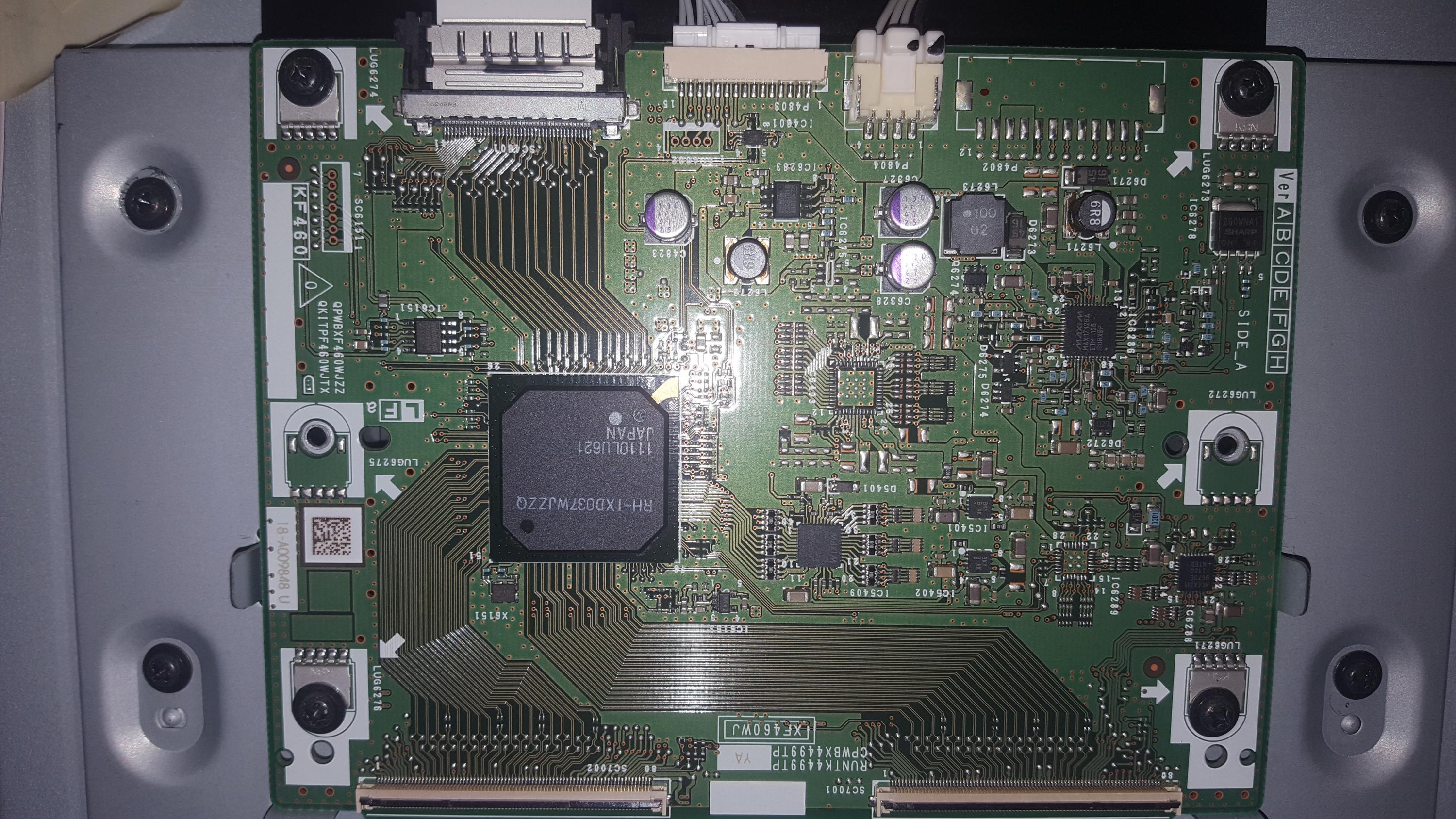

                                  I would say the panel is pulling too much current from the tcon however it doesn't look like it has any shorts.
                                  Can you post a picture of the tcon board?
                                  • SolderMaster
                                    • Dec 2013
                                    • 53
                                    Yes, Sir.
