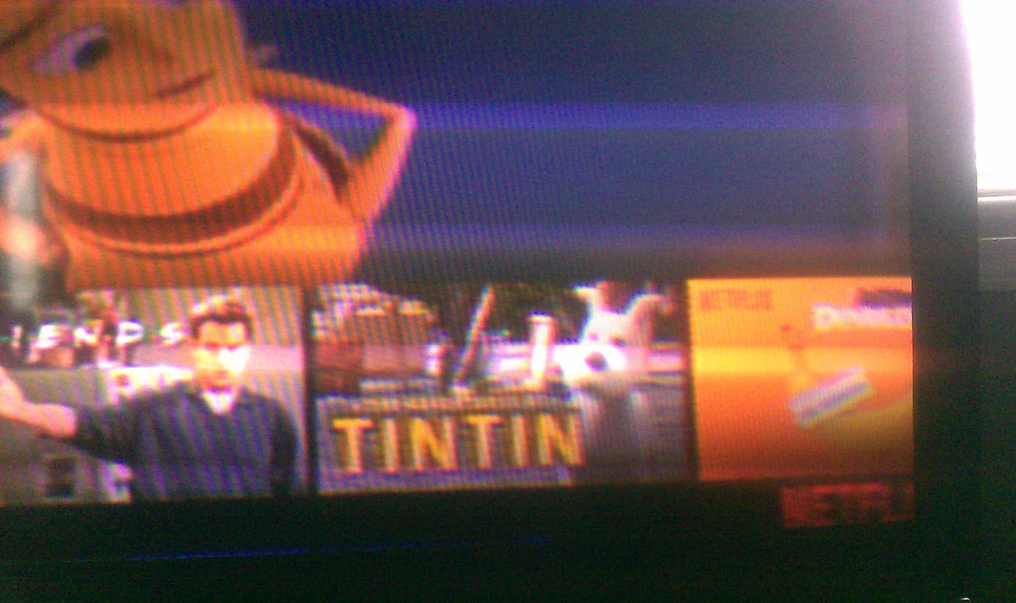

                          The lines are actually more vertical but do go on odd angles sometimes....they are about 5-7mm wide and spaced equally about the same...i took some pics will post....
                          • shelby5041
                            • Feb 2009
                            • 1505
                            • united states of america usa
                            Re: Samsung hd rear projection tv crt subtle wavy lines on displa
                            Here is an image from my tv....the horizontal distortion is due to camera
                            The vertical ones are real....looks much worse in the pic but it shows you what it looks like
                            • freakaftr8
                              • Oct 2012
                              • 3743
                              Looks like rf or chroma issues. Probably an out of spec capacitor for the crystal oscillator.

                                  That is most likely a bad cap in one of the low voltage regulators, It could be from one of the voltages derived from the flyback or it could be from the switching power supply.
                                  It can't be rf issues if you are not using the tuner input. If the color 3.58 osc was off at all you would have no color, if the frequency was off the tint would be out a mile.
                                  The color osc. is phase locked to the video.

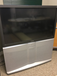

                                      Here is a photo of tv
