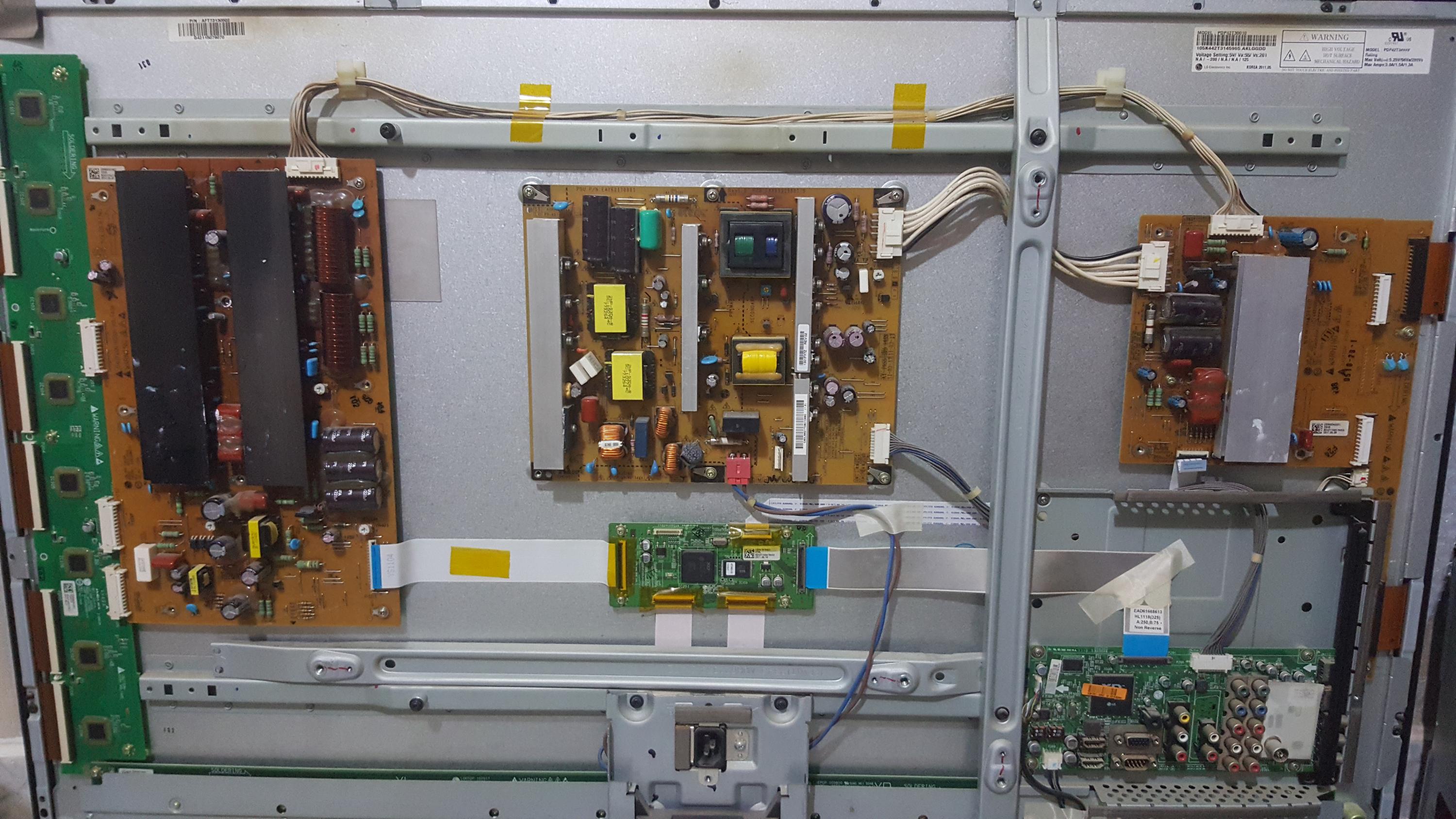

Lg 42PJ350 no Picture
    Re: Lg 42PJ350 no Picture
    That doesn't seem bad. Also I recall that the logic board does not use 15V it just uses wiring harnesses to pass it thru to Z-sustain.
      you are correct on this - 15V passes thru to Zsus - gad design. assume my EBAY Ysus is bad - not supplying 15V
        or Z-sus has short/overload to 15V, worth checking maybe with an external PSU...
          originally got tv that wouldn't turn on, clicks and then shut down. I assumed bad Ysus. bought EBAY Ysus - set now comes on with no display - all voltages good from PSB. why can't I disconnect Zsus ? then check 15V. if good, Zsus is shorting it. if still bad - Ysus not generating proper 15V.
              just got new EBAY logic bd - let u know as soon as I install it. do u have all PSB voltages except 15V on ySUS bd ? my set stays on but no display (15V missing to Zsus bd). I believe logic bd commands Ysus bd to turn on 15V to Zsus bd. yours sounds like Zsus bd bad causing Ysus Igbts to blow - check your Zsus bd diode
              installed new logic bd - same issue. plasma stays on - all voltages are present from PSB but NO 15V to Zsus bd. I must have bad Ysus board. does anyone have schematic of Ysus bd ??
                All my voltages are ok except 15V.

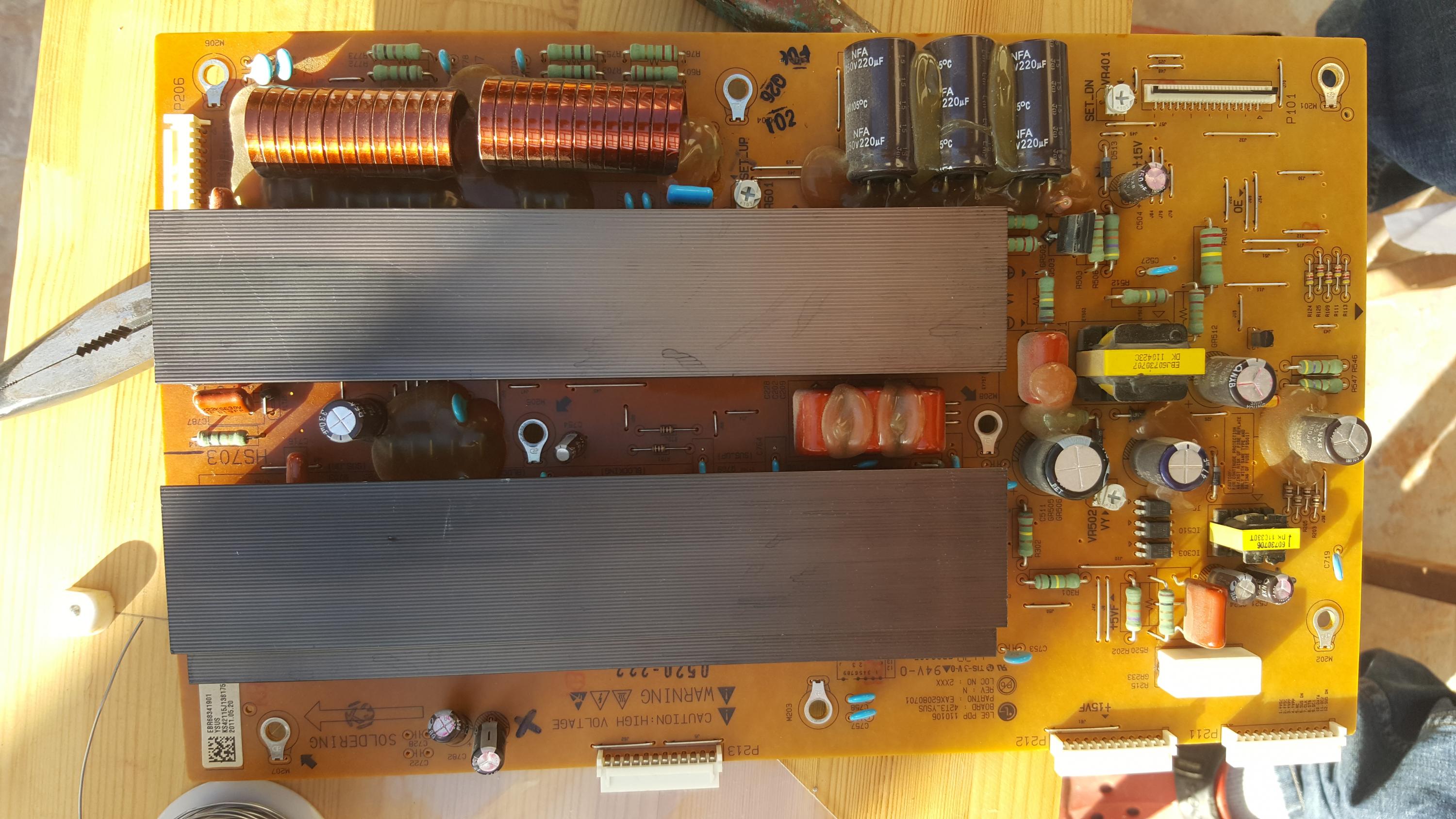

                  Test all your IGBTs on YSUS board and the dual diodes. That was my problem with the ysus.

                                #35
                                From what I can tell the 15 volt line is generated on the Ysus board it is then routed to the logic board and then goes through the logic board to the Zsus board. the logic board does not use the 15 volt line whatsoever - 15v is just routed thru logic bd. This is why I was asking for Ysus schematic. I'm assuming your TV is not displaying anything just like mine. I have another Ysus board which I will repair and try and let you know what happens.
                                    just tested my ysus board. coudn't find anywhere 15V.
                                    The maximum I am getting is 4.3V.

                                      #38
                                      yes - exactly same as mine - thats why i posted on this thread. post a pic of your Ysus. u should have a label on the board - 15V. this is what goes thru logic bd to enable Zsus bd

                                        #39
                                        Some place it say 15V and some place it's 15VF. Why?
                                        I am getting 4.3V.

                                          #40
                                          check that 15V again - watch it as u turn set on. is it going to 18V then slowly goin down to 4.1V ? thats what mine is doing - when it first goes to 18V - there is a slight buzzing noise (no display) and then it fades away as 15V goes to 4,1V
