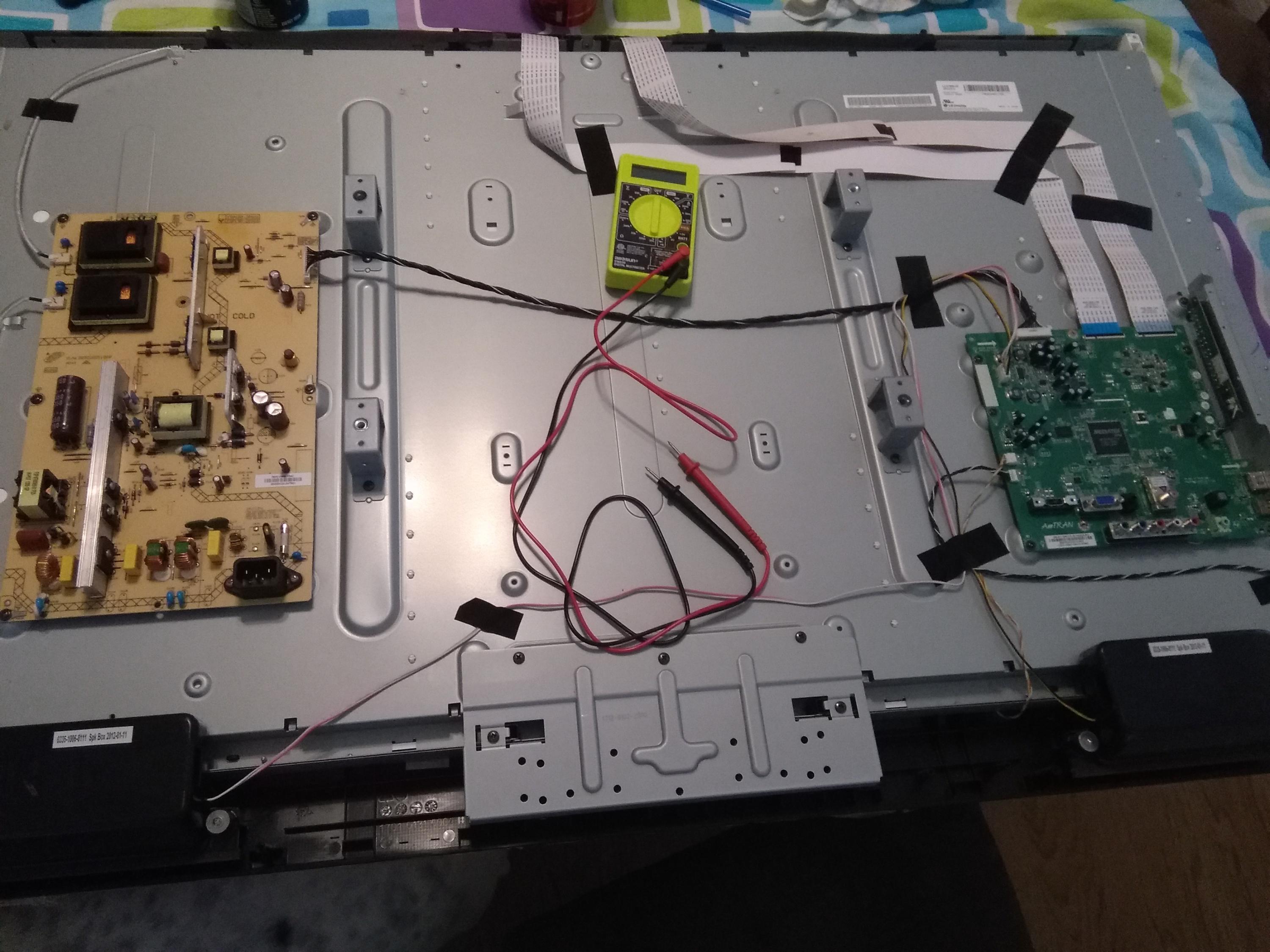

    Hello all and happy New Year, I recently acquired this TV from a friend who stated "it's dead". I have had some success in the past restoring so I figured I would give this a go. I'm not an experienced electrician but I am comfortable using a meter and repairing pcb's. My lack of experience translates into difficulty diagnosing which is why I'm here.
    Upon attempted startup the set does nothing but a very short and very faint one time logo flash if even that. Preliminary testing yields the following results.

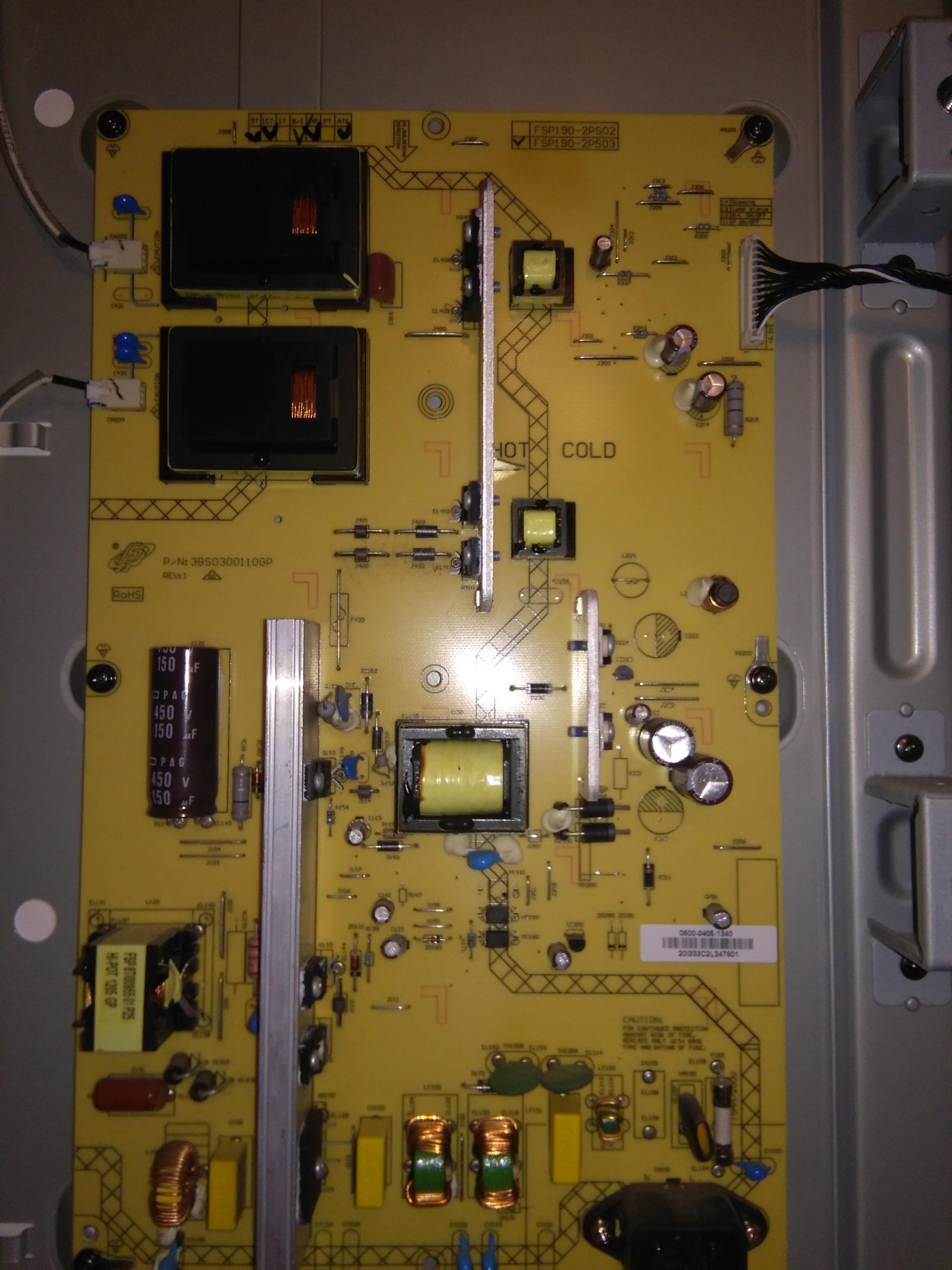

    Power board fuse = good
    No bloated or leaking caps
    Main cap 168v

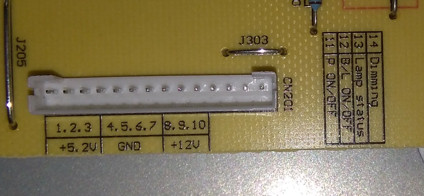

    Pins with main board disconnected
    1 - 5.2v = 5.3
    2 - " "
    3 - " "
    4 - gnd
    5 - " "
    6 - " "
    7 - " "
    8 - 12v = 0
    9 - 12v = 0
    10 -12v = 0
    11 - p on/off = 0
    12 - blo/off = 0
    13 - lamp status = 0
    14 - dimming = 0
    Main board connected yields
    Pins 1 through 3 = voltage rapidly fluctuating from 0 to 2.3v
    Pins 4 through 14 = 0
    Can hear a small tick from power board every 1-2 seconds from area to the right of main cap
    Please advise as to what I can do to determine if this is a power or main board problem. Thanks in advance

    With main board disconnected you can jumper pin 1 to pin 11&12. You should then get your 12vdc and should get backlights. I suspect problem with main board if your standby voltage is fluctuating when connected. Check also your main cap when jumped. It should read around 390vdc

            You can also try this:
            Unplug the power to the power supply board, then use hair dryer to heat up the start-up/running caps C160, C161 for about a minute then power up the board with all the cables connected to see if the Standby Voltage will be steady or not.

                Ok jumped pins 1, 11, 12 and have backlights. At this point all voltages across cn201 are correct and stable. Main cap cap value is 383v.

                  Tested and results are the same. Voltages fluctuating rapidly 0-3v
                    Re: Vizio E471VLE Dead

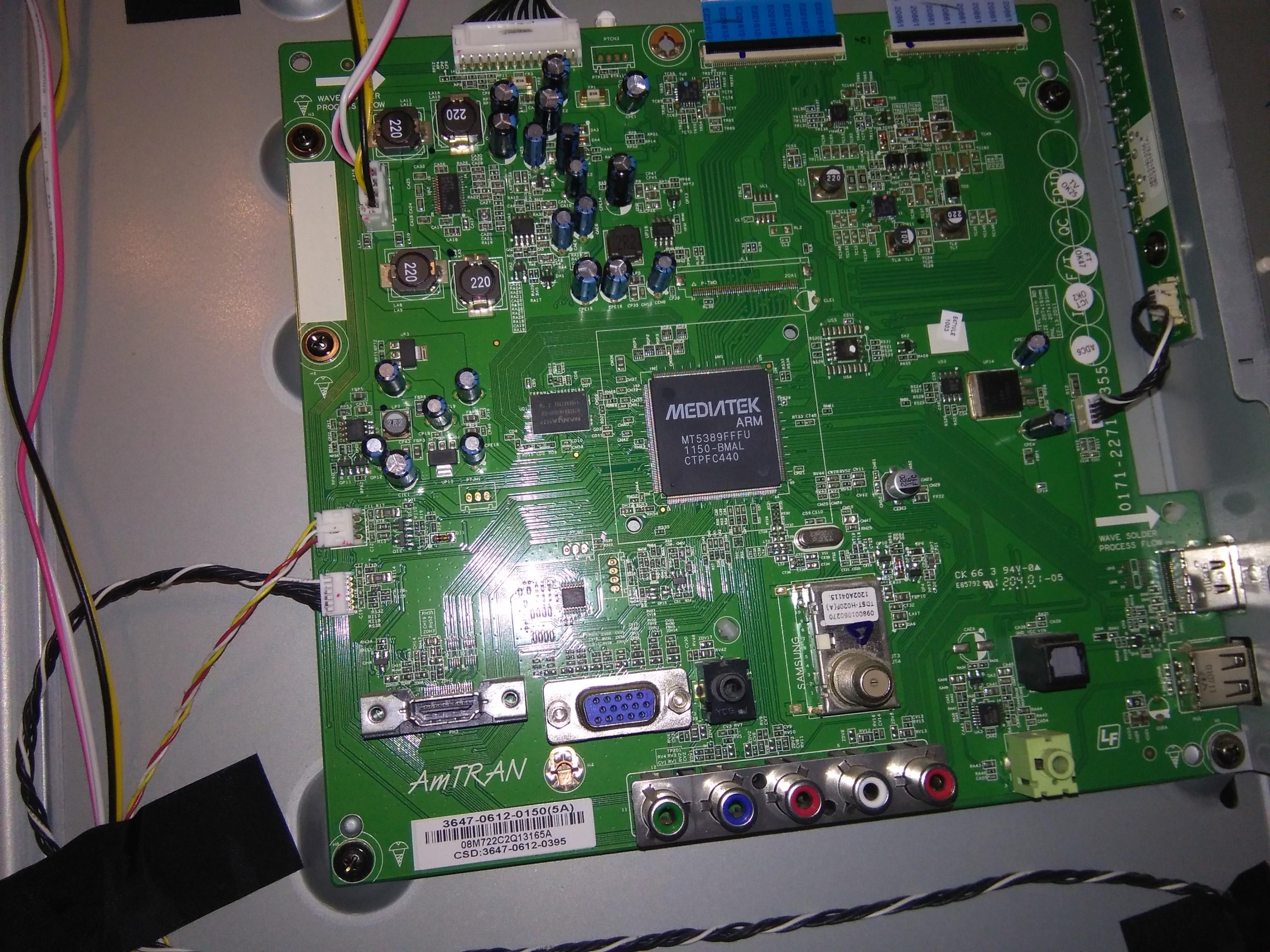

                    So where do I go from here ? Do these results indicate a main board failure ?
                      I would say you have bad regulator or something on main board loading down standby voltage

                        I am having trouble finding the original and revised main board available for purchase. Is it feasible determine exactly what's malfunctioning on the board or is this a scrap ?
                          Try disconnecting the IR board from the main board to see if the STBY will be steady.

                              Same result. Does this pinpoint the main board as the issue ? Is there any way to determine what component on the board is failing ? Looks like servicing the board might be the only hope as I cannot find a replacement.
                                At this point, something on the main board is drawing too much current so the STBY 5V goes into shutdown/restart cycle.
                                May be check the resistance between GND and the 5VSTBY pin with all the board connected to see if it may show really low resistance or not.
