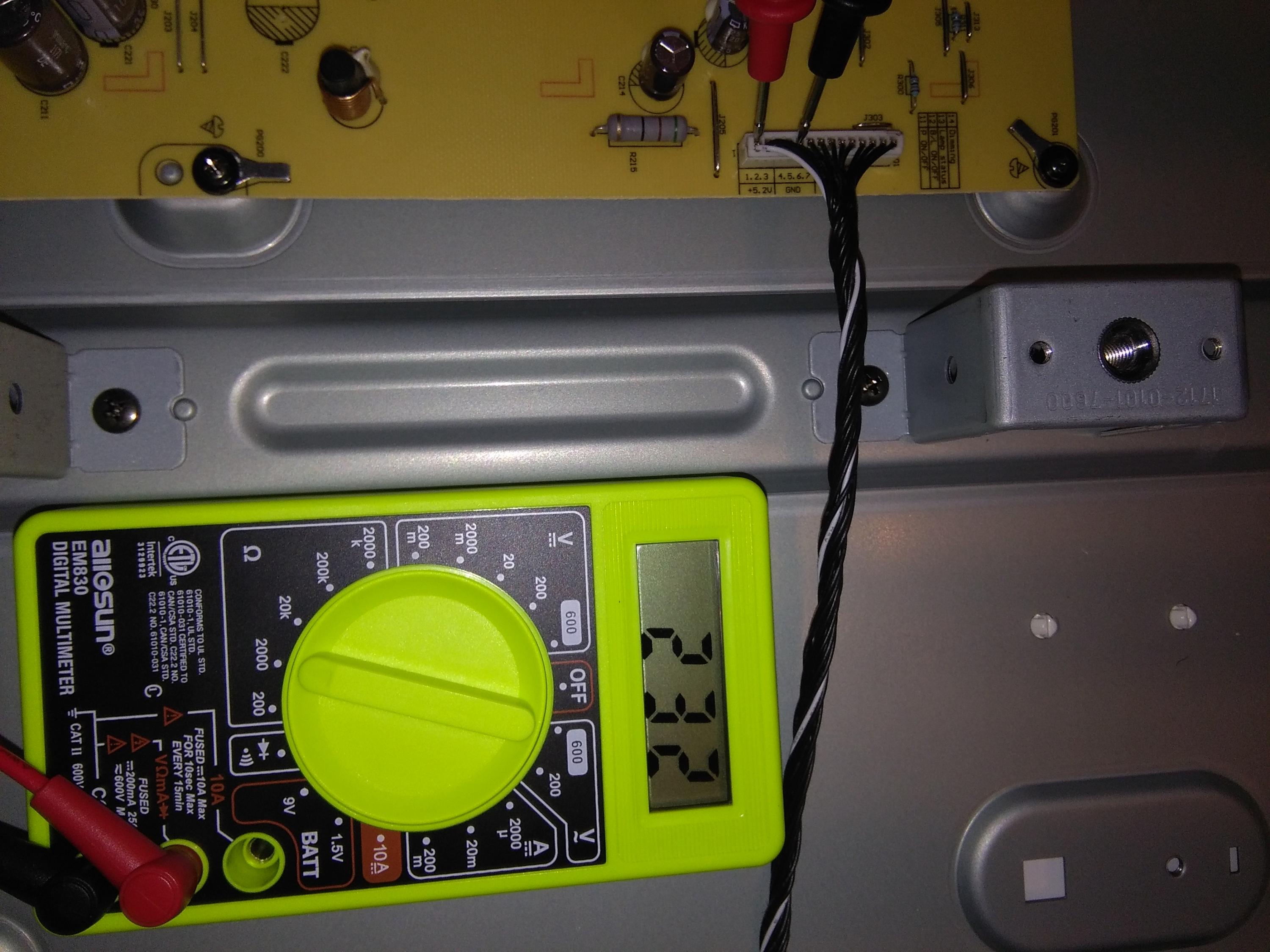

    Re: Vizio E471VLE Dead
    Originally posted by budm
    At this point, something on the main board is drawing too much current so the STBY 5V goes into shutdown/restart cycle.
    May be check the resistance between GND and the 5VSTBY pin with all the board connected to see if it may show really low resistance or not.
    Please see attached
    • Roush2fast
      • Jan 2017
      • 49
      Does the relating resistance indicate anything conclusive ? Seems pretty straight forward to me from a logical perspective that it's the main board when standby voltage fluctuates when the board is connected and when disconnected I have consistent and accurate voltages.
      I was talking to a buddy of mine last night and he said something to the effect of checking smp low voltage ic or low voltage regulator . Either of these make sense to you experienced individuals ?
