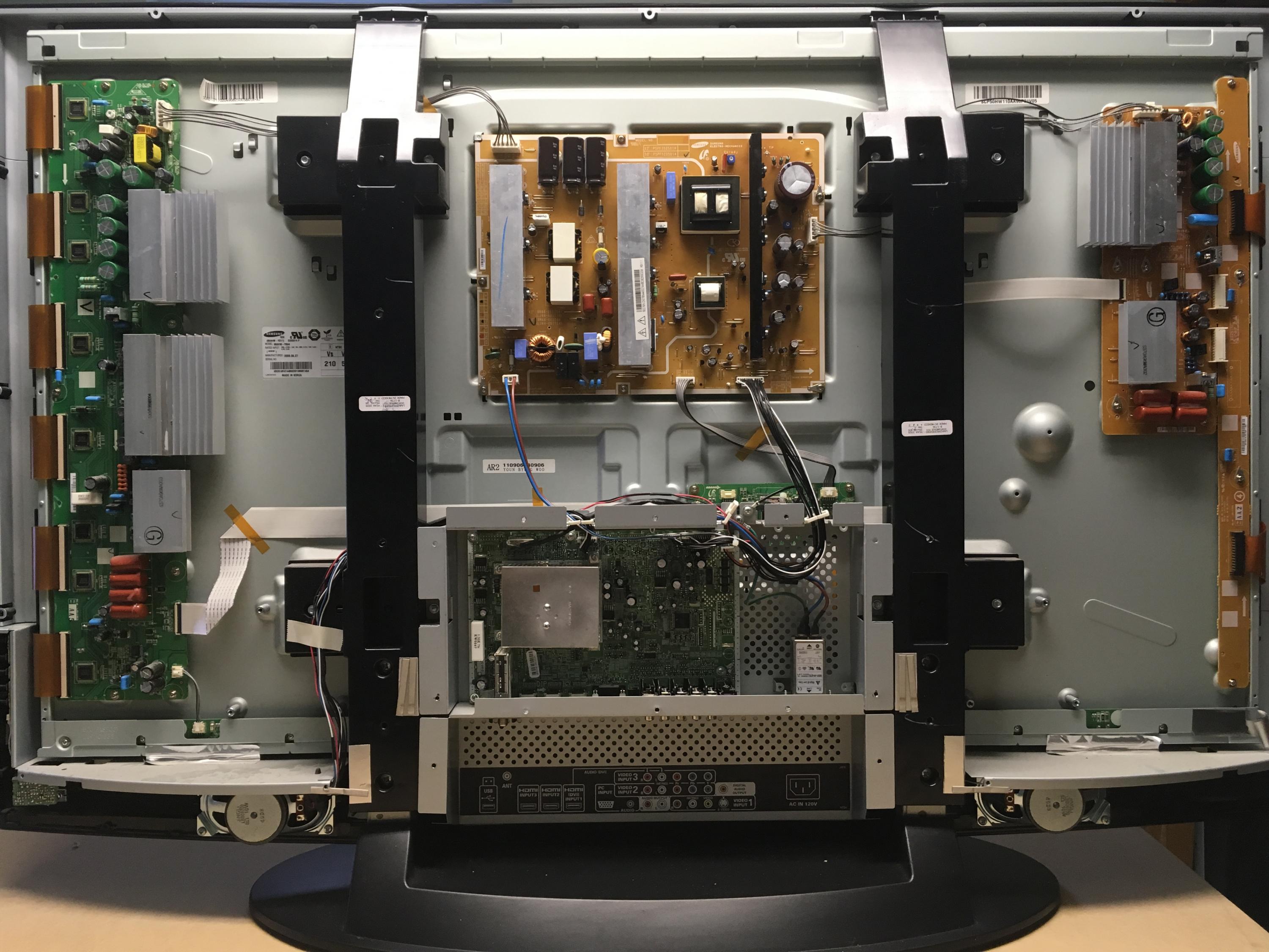

    With everything connected when you press power button relay clicks, the green light comes for about 3-4 seconds, relay clicks light goes away, in one second tries again, clicks, green light comes for 3-4 seconds, clicks, light goes away.

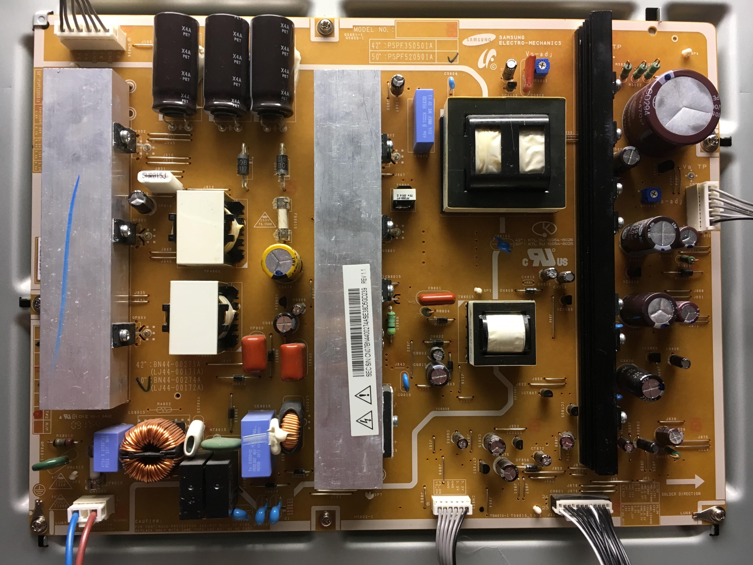

    At this moment on the PSU BN44-00274A:

    Visual check gives no burned elements. All fuses are good.
    I found a service manual and the procedure of eliminating Main Signal Board. I did that with no luck meaning TV is not generating internal patterns without the Main Signal Board attached. So here during this test relay clicks ones (stays on) and in my understanding the PSU must be on. On three big capacitors CP801, CP802, CP803 I only got 158.2V across them. On the DX807 - 5.285V; on DX806 - 27V(must be 15V I guess), DS801 - 0.2V (must be Va with is 55V), DS825 - 0V (must be Vs wich is 210V).

    Does PS-ON Voltage change state when power switch is toggled on and off?
    Power supply board is SAMSUNG BN44-00274A.
    Most SAMSUNG Plasma power supply uses active low for PS-ON, MEANING <1V = ON, >2V = OFF.
    Please upload the service manual.

      Re: Sanyo DP50749 not switching on
      PS_ON does change it's value to low 0.022Vdc for those 3-4 seconds.
        If you cannot generate test pattern. Most likely power supply. Repair kits available
