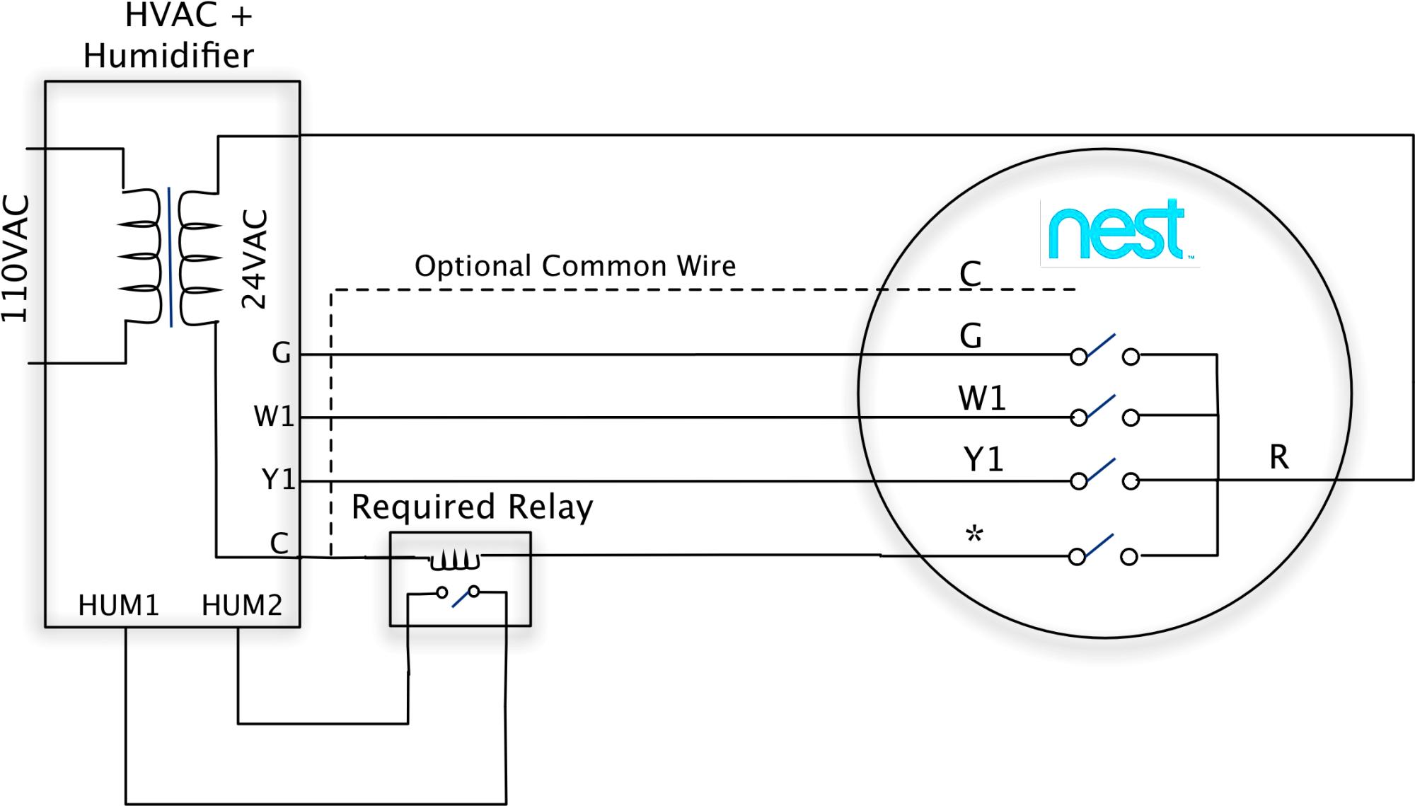

    So Basically the way I understand things, Please correct me if I am wrong, is the Red Wire is 24 Volts DC. The White is for Heat. The Green is for Fan Blower. If the Yellow was involved it would be for the Central Air.
    If there was a C wire its a Common 24 Volts Continual. (For Items such as the Nest Thermostat charging etc).
    So In the Nest (Phone app) setup it pushes (Forces) the user to Buy their Nest Thermostat C Wire Adapter.
    This Actual Nest C Wire Adapter appears to be nothing more than a box with connectors while many other competitors are using a 24 DC Transformer which just replaces the C Wire. The Competitors boxes can be for more than just Thermostats.
    If during the Setup you say that you have this Adapter it will let you progress thru the steps and the Thermostat/the furnace seems to function fine. If you do not say you have the adapter it tells you its incompatible. I temporary said I did have the Adapter as I had already mounted the optional back thermostat mount plate and the base plate to the wall and proceeded to completion.
    The thermostat does display N260 Error on occastion which means no Common Wire Detected.
    My question I guess is the Common Wire is also a 24 Volt source, the way I understand things. Why not just split (Jumper) the Red Wire to the Common Connection on the Thermostat? This would create a parallel connection of 24 Volts.
    It appears that the Nest C Wire Adapter is doing something similar as there is no additional transformer.
    The only thing I can think of is the Amperage may not be there but many of the 24 Volt Non Google /Nest Adapters are only .2 amps to a max I have seen of .5 amp at 24 Volts. The .5 amp one handles more than The Nest Thermostat (EcoBee and Honeywell) as well as other Household 24 volt needs.

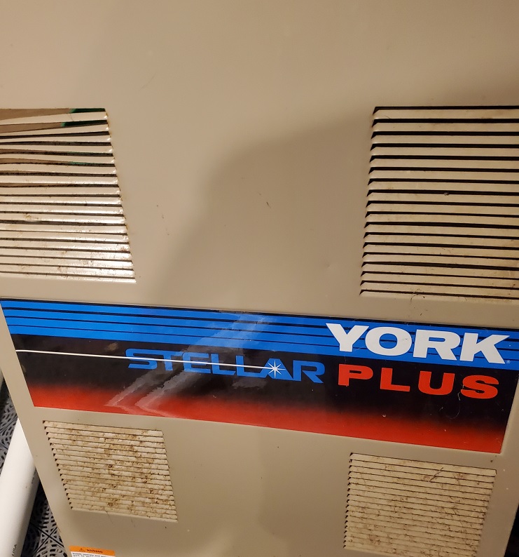

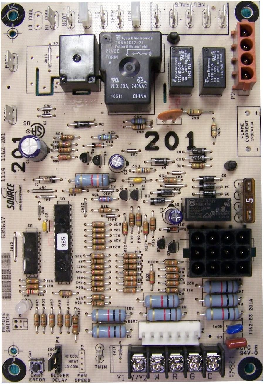

        What model is the furnace? There's a York Stellar, Stellar Plus. For a pic of the control board.
        The control board will have a C terminal, I would use the Y wire (wrongly) for running C to the Nest. Or get the C wire adapter module.

          I believe it is Stellar Plus. All of them are High Efficiency 97% if I remember correctly.

            From York control board pics, "C" it's on the terminal strip at the end. If instead you have all spade terminals, it's labelled there too.
            Common problem is cold solder joints on furnace control boards, so try to be gentle with it, and don't forget to shut off power when going in.

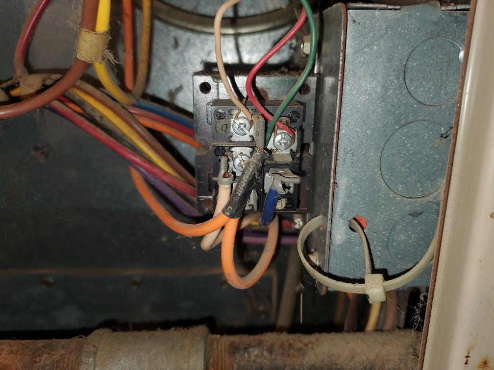

              We got it today when I was at my boys.
              Basically we found that there was a C wire. Its kind not as apparent then the other wires. I have included a picture.
              After installing it with the Wire and hooking it to the thermostat the N260 error and the no charging notification went away.
              I should add its the lower right one (blue).
              Thanks everyone for the help,
              Chris
