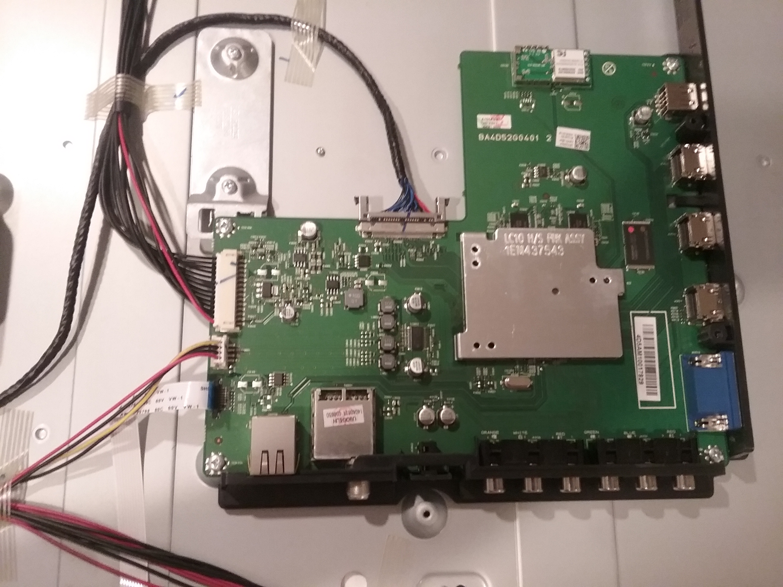

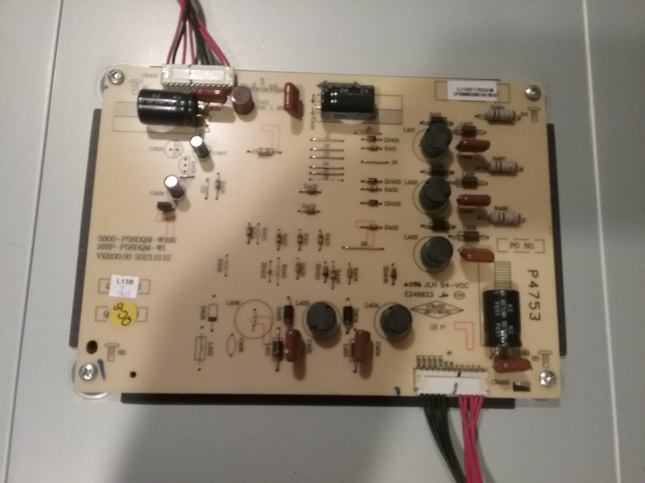

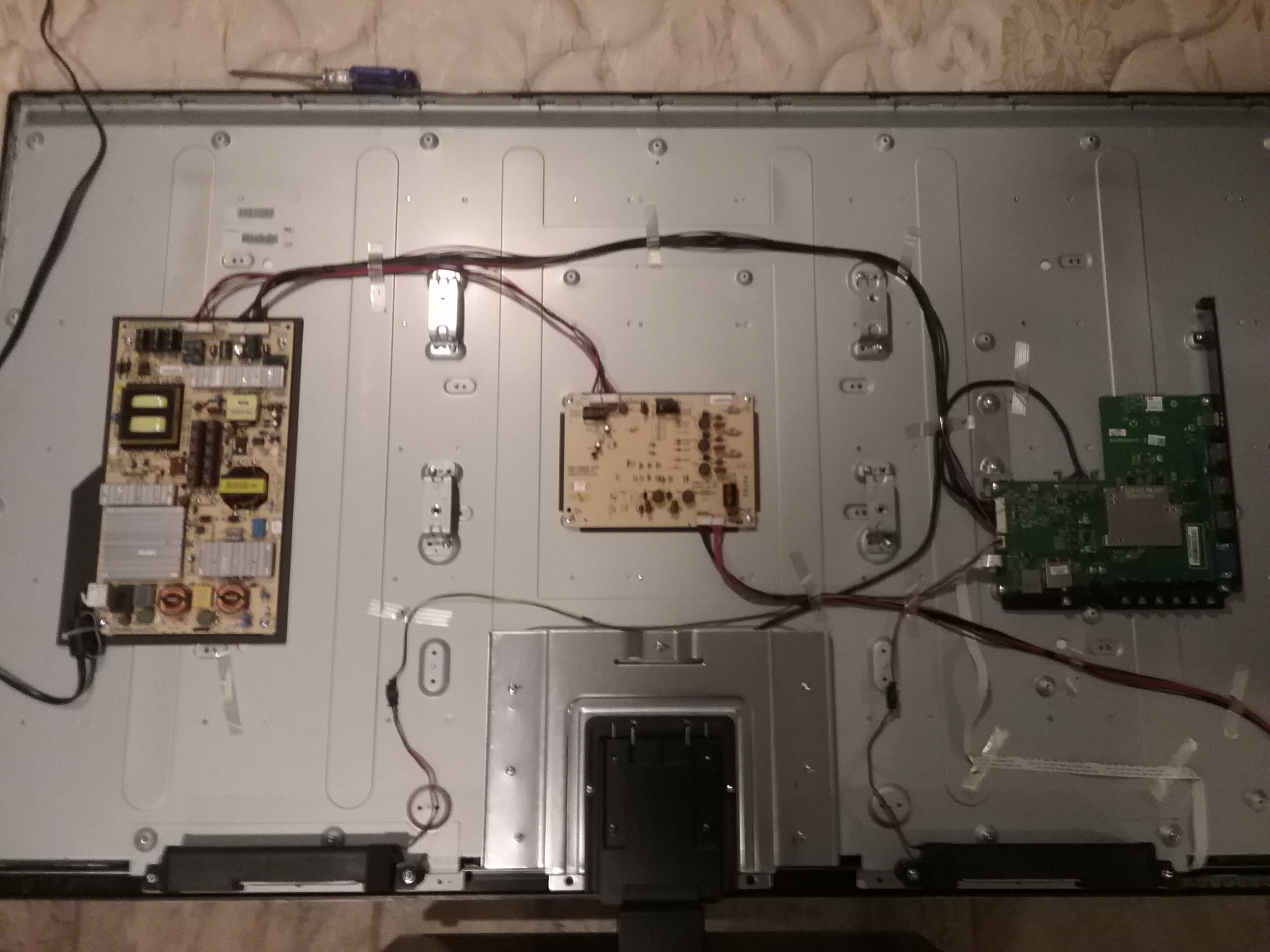

    I have Philips TV model # 58pfl4609/f7. I got it for free (not working of course) and I am trying to trouble shoot the issue. The TV has three boards and if with your help, I could diagnose which board is faulty, I would most likely replace the whole board. So far, the symptoms are:
    1. No power at all, no standby light, no flashing lights, backlight doesn't turn on.
    2. Standby voltage on the power supply is at exactly 5V
    3. No other pins (12,24V) show any voltage
    4. Pressing Power button does nothing
    Could somebody help me out figure out which board is shot by providing info on what to check next?

    Re: Philips 58pfl4609/f7 TV not working
    Without any further testing, this would point to the main board. I can't read the pins on the connector going from the power supply to the main board but it would be smart to check the PS-ON pin as the power button is pressed. If you have no or little voltage on that pin, then the main board is almost certainly the culprit. Make sure if you order one that you get an exact match. Usually there is an identifier on the white sticker that shows the board version. Don't order by the model number alone as there may be multiple types.

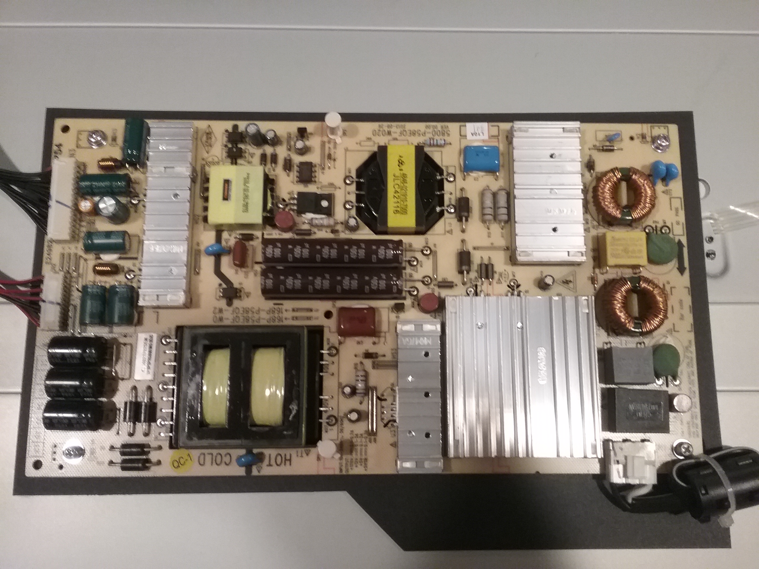

      I have the following pins on the PS board:
      Smaller connector:
      175V
      175V
      NC
      GND
      NC
      SP
      NC
      ADJ
      ENA
      Bigger connector:
      12V
      12V
      GND
      GND
      12V
      5V
      GND
      5V SB
      GND
      STB
      GND
      ADJ
      ENA
      I do not have PS-ON pin or I do not know where to find it.

                You say their standby voltage you have a SB5V and an STB pin. Test each pin in its current state and post the findings.
                Also what's the voltage at the primary capacitors on hot side of power supply when in standby?

                  Sorry for a delay in responding. Here are the measurements:
                  SB5V - 5V
                  STB - 0V (no reading)
                  Capacitors - 168V (those are the big long capacitors on the PS board)

                        Have you checked the small round (red) fuses F2,F3, on the power supply board, I see shopjimmy has a repair kit for this board, maybe check the fuse resistors like R48 & R15, they should read very low and not open.
                        Yes it looks like STB is power supply on

                            Nothing on the 17.5V when I press the power button. The round red fuses read 0.1 Ohm on all three of them (F1, F2, F3). R48 and R15 resistors look good too. Could it be the power board? The replacement main board was pulled from a working TV with broken screen so unless it got damaged during shipping, it should be working. I have also noticed that some of the wires go from the main board to the power board thru the LED board. Anything to check on that board?

                              I dont have specs on this power supply but if mainboard was not the issue, there's a possibility that mainboard is trying to bend the turn on command bit the power supply has a problem with turning on.
                              While pressing the power button no you get any voltage change at STB?

                                    remove cn3 going to the main board, then jump +5vsb to stb, that should turn on the power supply if its working, it looks like it has a series resitor (R71) so no external resistor is needed
                                    R77 goes from that line (after r71) to ground holding Q8 base low in standby condition
