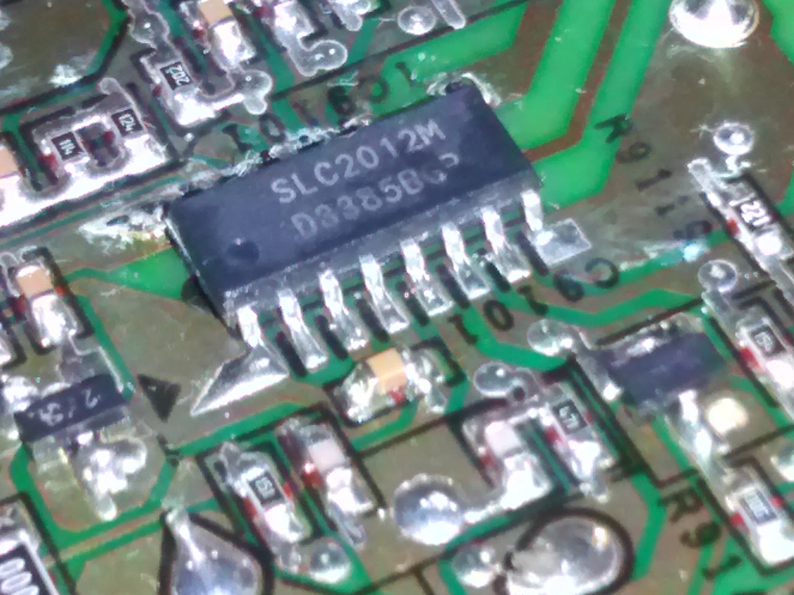

    ok i was able to clean the IC with 90% isopropyl, a bit of toilet paper and some elbow grease.
    IC9101 markings:
    SLC2012M
    D3385BGP
    i can find it on ebay
    https://www.ebay.com/itm/SLC2012M-Pa...QAAOSwi4lae~ay
    but i cant seem to find the datasheet
    i find a datasheet for SLC2012 but it doesnt seem right and doesnt tell much

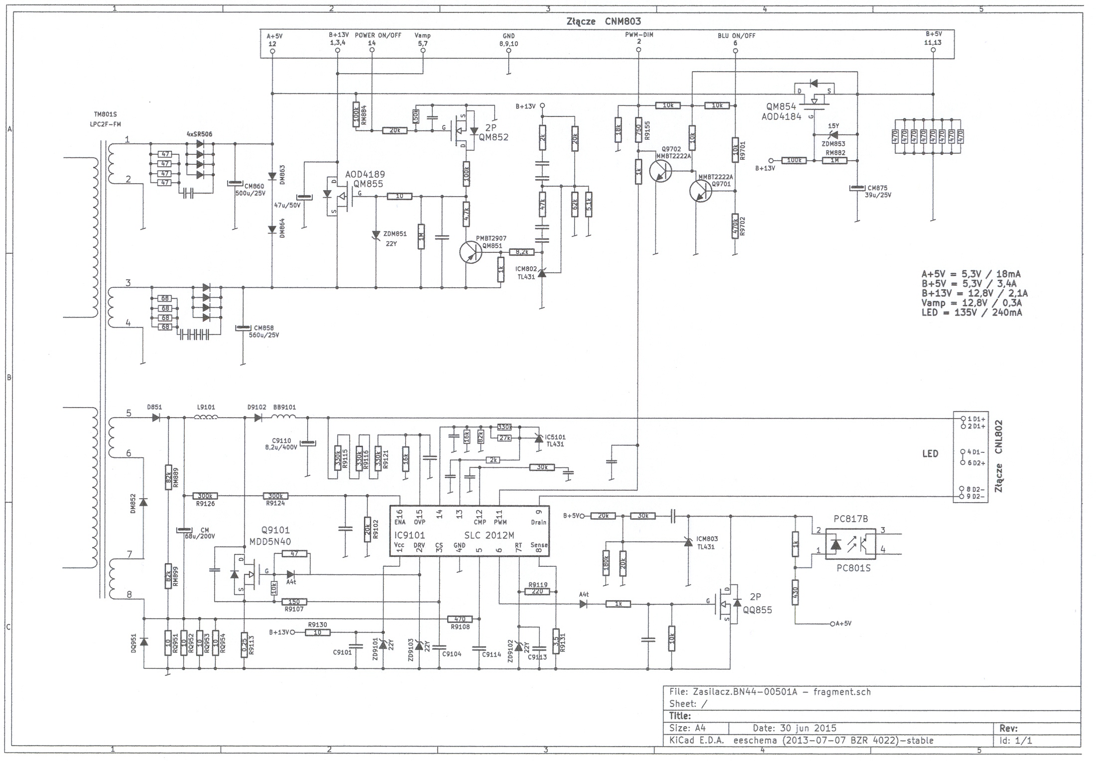

      Re: Samsung UN46ES6150F starts power cycling after 2 hours of use from a cold start
      This is the schematic of how SLC2012M is used in Samsung TV. i M NOT 100% sure how accurate the SCH is.
        thank you that is very close to my board which is BN44-00502A. how did you find this? and what does SCH mean?
          SCH = Schematic
          I found that a while back while searching for the 'SLC2012M schematic'.
