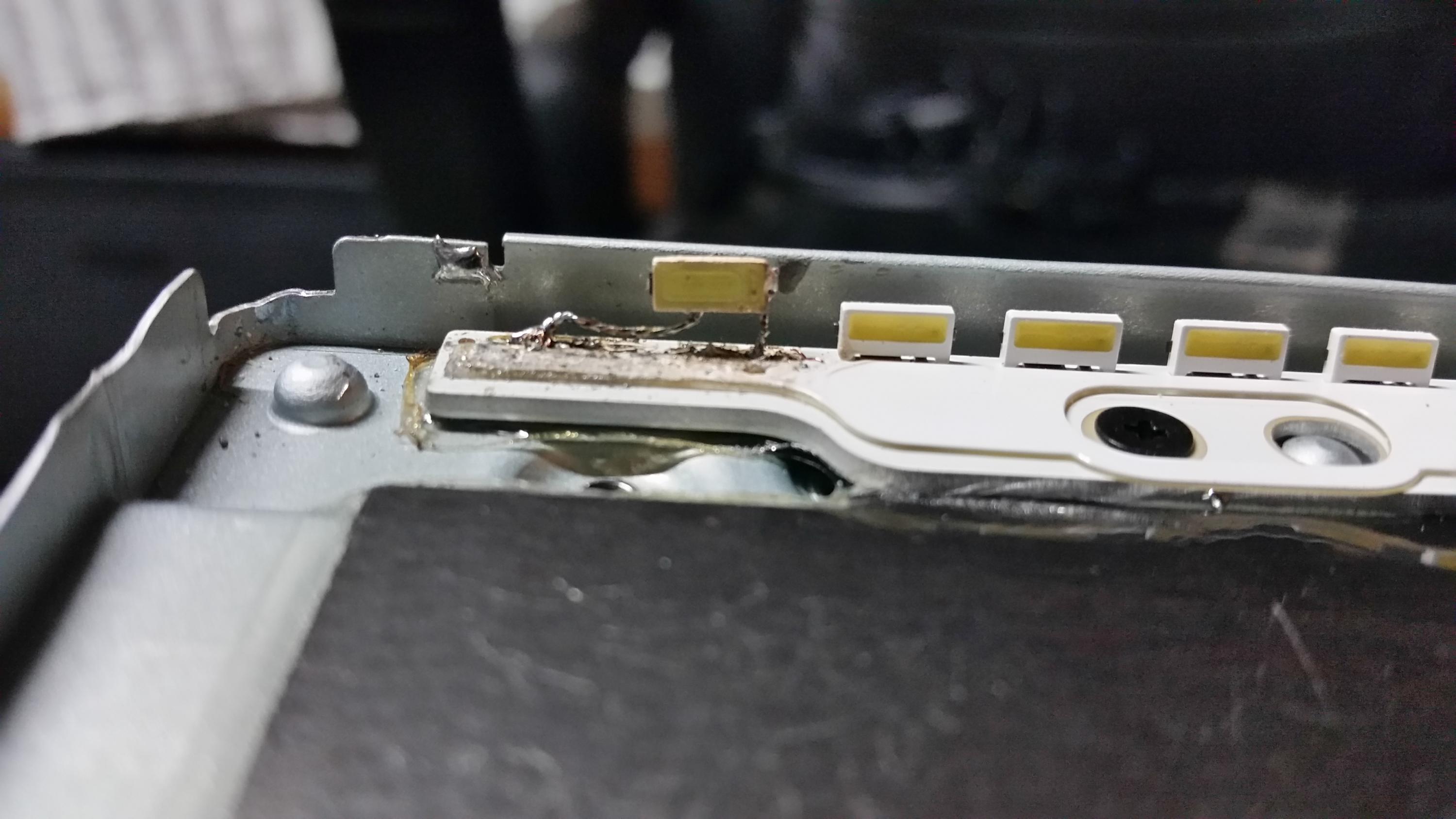

    ugh so its still power cycling, AND the backlights are broken again. its just too hard to solder these back in, the way theyre set up. theres nothing stopping them from getting flexed off. dumbest design ever. the other ones are flat against a metal plate, way less chance of breaking off.
    anyway i got the panel apart again and im thinking of just replacing those 2 failed LED's with a resistor to complete the circuit. what resistor do i have to use to replace 2 LED's.
    if the LED's are 2.7v each i need a 5.4v drop before connecting back to the cathode return. what is the formula to figure out what resistor i need?
    i feel like i should know this already but i guess i havent done it. ive replaced LED's with other LED's but never given up and just done the resistor thing.. or am i supposed to use a diode?

      Re: Samsung UN46ES6150F starts power cycling after 2 hours of use from a cold start
      No. Don't use suction cups. Ever. A high chance of damage. Really no need on a 46" anyway.
      I use a fingernail in the middle of the screen to flick the screen up to vertical them I can hold it in both corners to move and store upright. I wear latex gloves so as not to have to worry about fingerprints.
      I use a hotplate to replace LEDS not a soldering iron, far easier and neater.
      It's a diode you replace it with not a resistor.
        You need 5 diodes in series to get the Vf of about 3V (White LED WITH 300mA of current will have Vf just above 3V. Those diodes will get quite hot.
          there really isnt room for 10 diodes in series to be soldered in there...
          and dont diodes come in different sizes and shapes and different vf's?
            Yes, but the energy has to go somwhere. The ones that have the best vf also emit light.
              That is why you should replace the LED instead of using the Diodes.
                i think i will just replace these 2 leds with other LEDS that lay flat
                  ok so i ended up replacing the 2 LED's with one that has a vf of 6v. i soldered a bit of braided copper wire to each pad on the LED, then soldered it to the strip, skipping one set of pads, but connecting the circuit. it aint pretty but it works! hopefully it will survive.
                  i probably could have done this with the orginal LEDS that broke off, but it would have been harder to solder them without bridging. plus i beat them up so bad trying to do it surface mount style, that i kinda dont trust em.
                  i think ill slip some tape underneath that wire so it cant come down and touch pads
                    Man! they sure use poor thermal management by using just the big solder pad of the LED to transfer the heat to the PCB, they should have heatsink to transfer the heat away from the LEDs. They are made to fail for sure.
                      this is without a doubt the worst edge lit led design ever. theyd have to really try to make something more likely to fail than this. but ill cross my fingers for now. the tv is on and running.. looks great! all LED's are on
                      ..but i suspect ill see it going into power cycling mode in a few hours :/
                      at least it wont be because of the backlights!

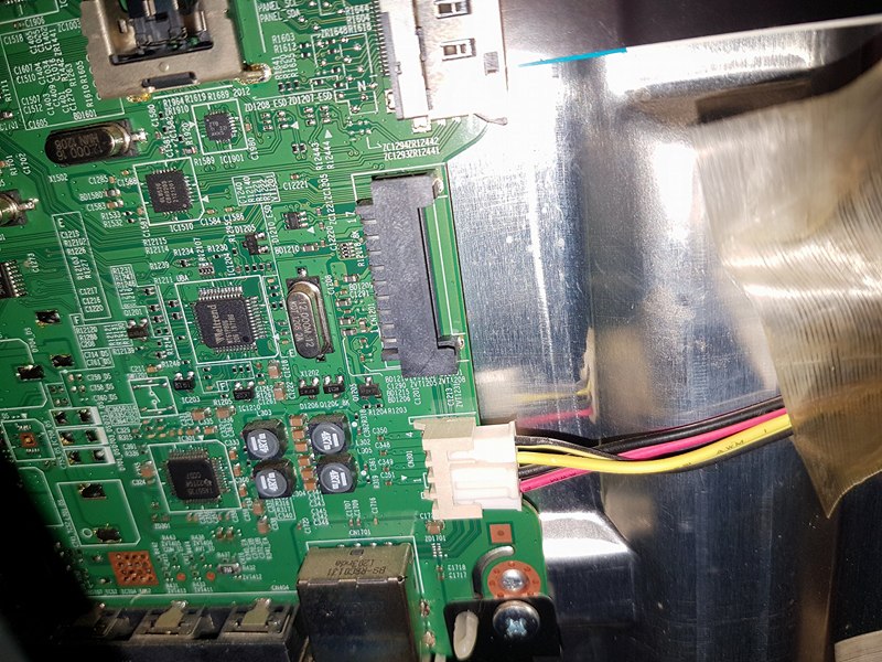

                          i bought a un46es7500f version of this tv yesterday and 4 pairs of glasses for it for 25 bux, has exactly the same problem yours does, person i bought it off of had it 6 months and broke several times on them, had the main/power/wifi board replaced under warrenty, never fixed the problem so they basically put the tv away and never used it
                          i took it home plugged it in, worked perfect for an hour then started randomly rebooting, been researching and havent been able to find anywhere that narrowed it down to one thing but i did find a youtube video today of a guy had the same problem and he said to unplug the 2nd ribbon cable from the bottom on the main board, i assume it has something to do with the wifi/bluetooth because tv doesnt pick up wireless now and my 3d glasses wont connect to tv(those might be something im doing wrong, hadn't tried to connect them till now) but the tv has been working flawlessly now for 3 hours
                          attached a pic of the plug i undone
                          • triplefour
                            • May 2014
                            • 1747
                            #33
                            thanks for the input. but my tv does it even with the mb disconnected from the PSU so im fairly sure i have a fault somewhere on the PSU but it takes hours to build up

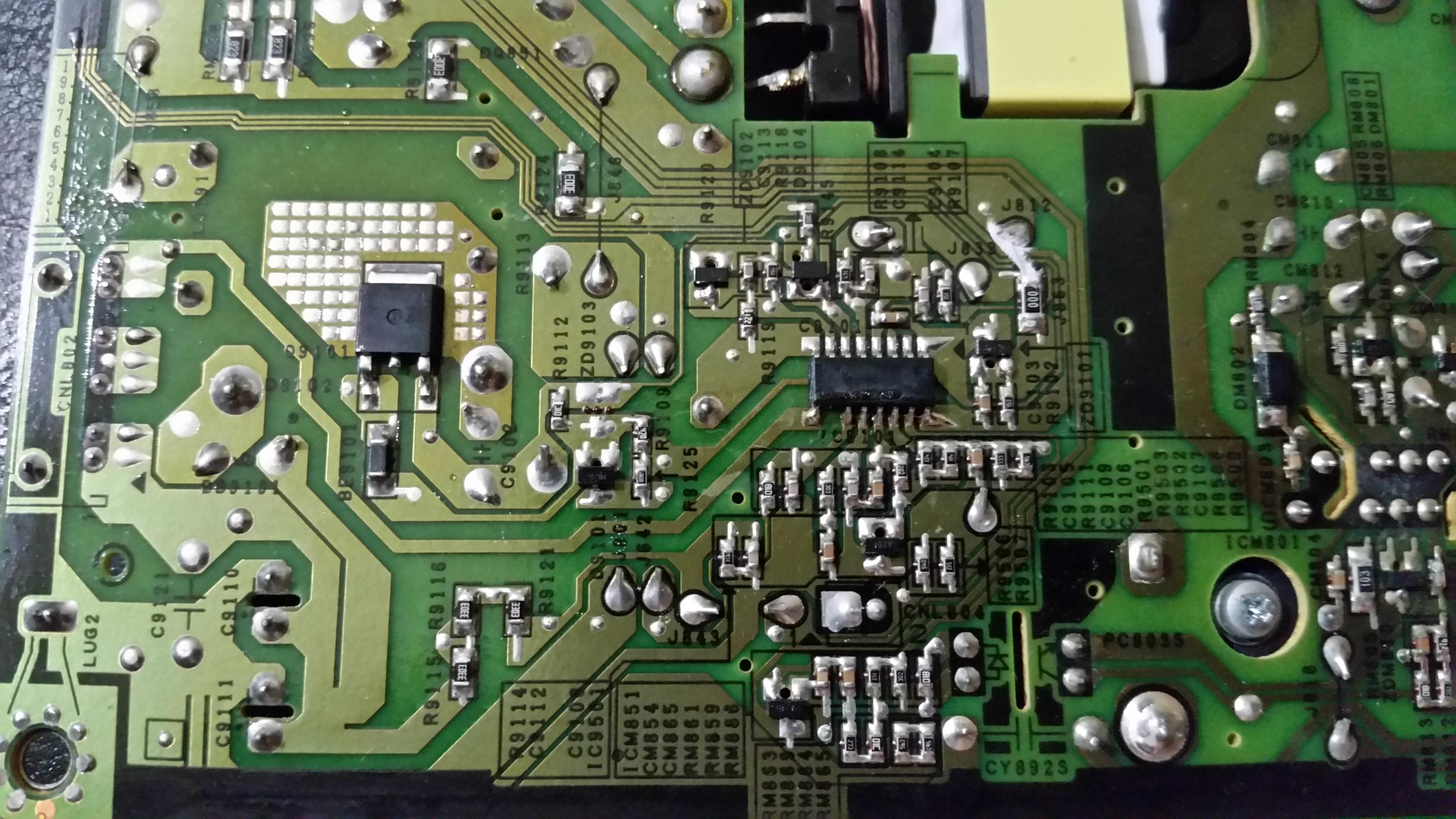

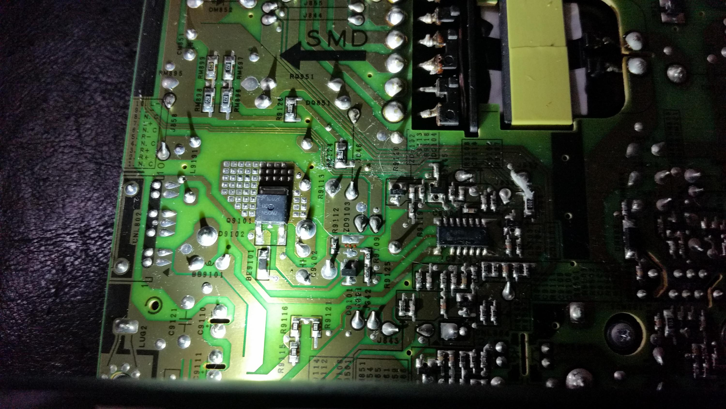

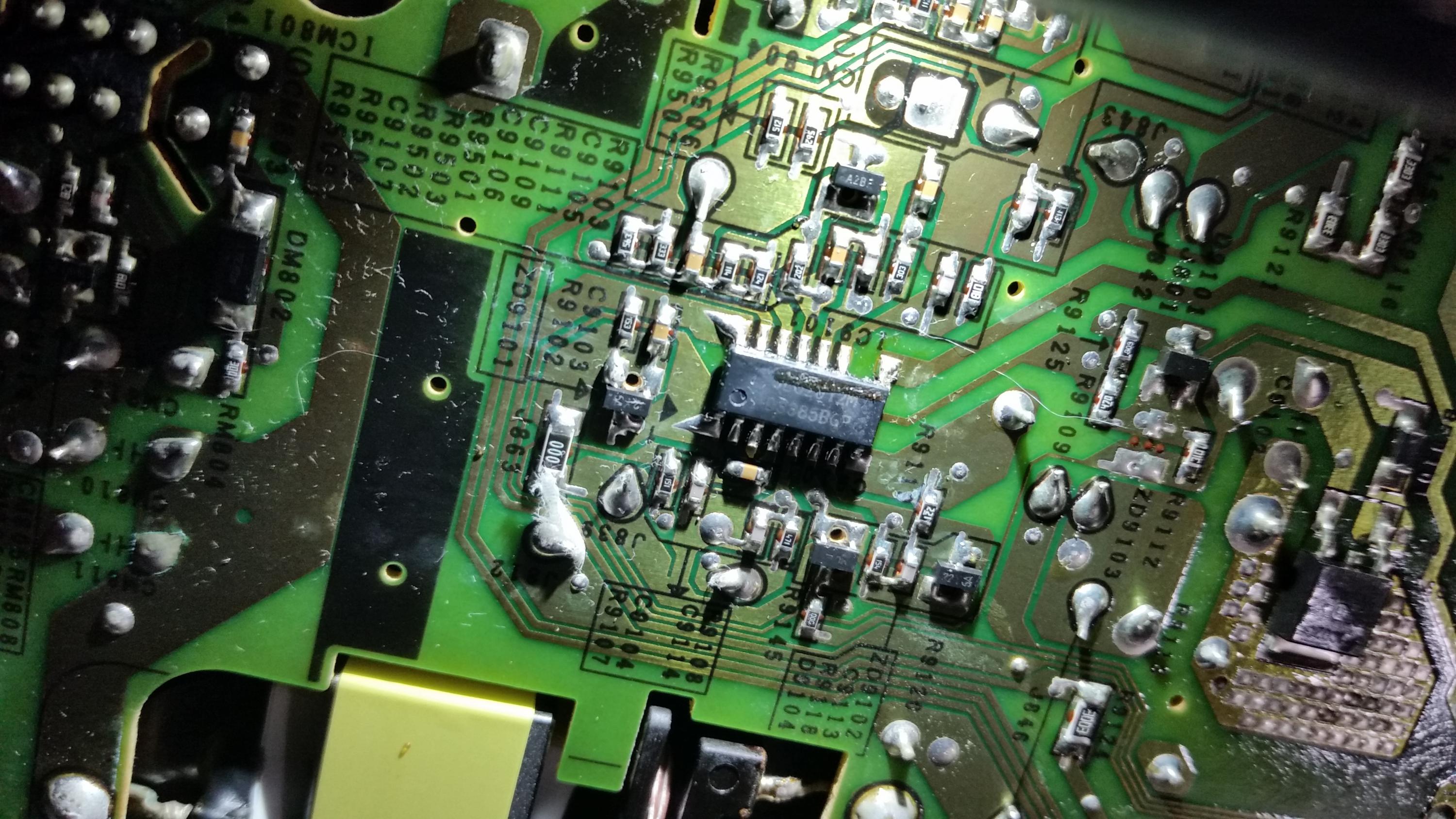

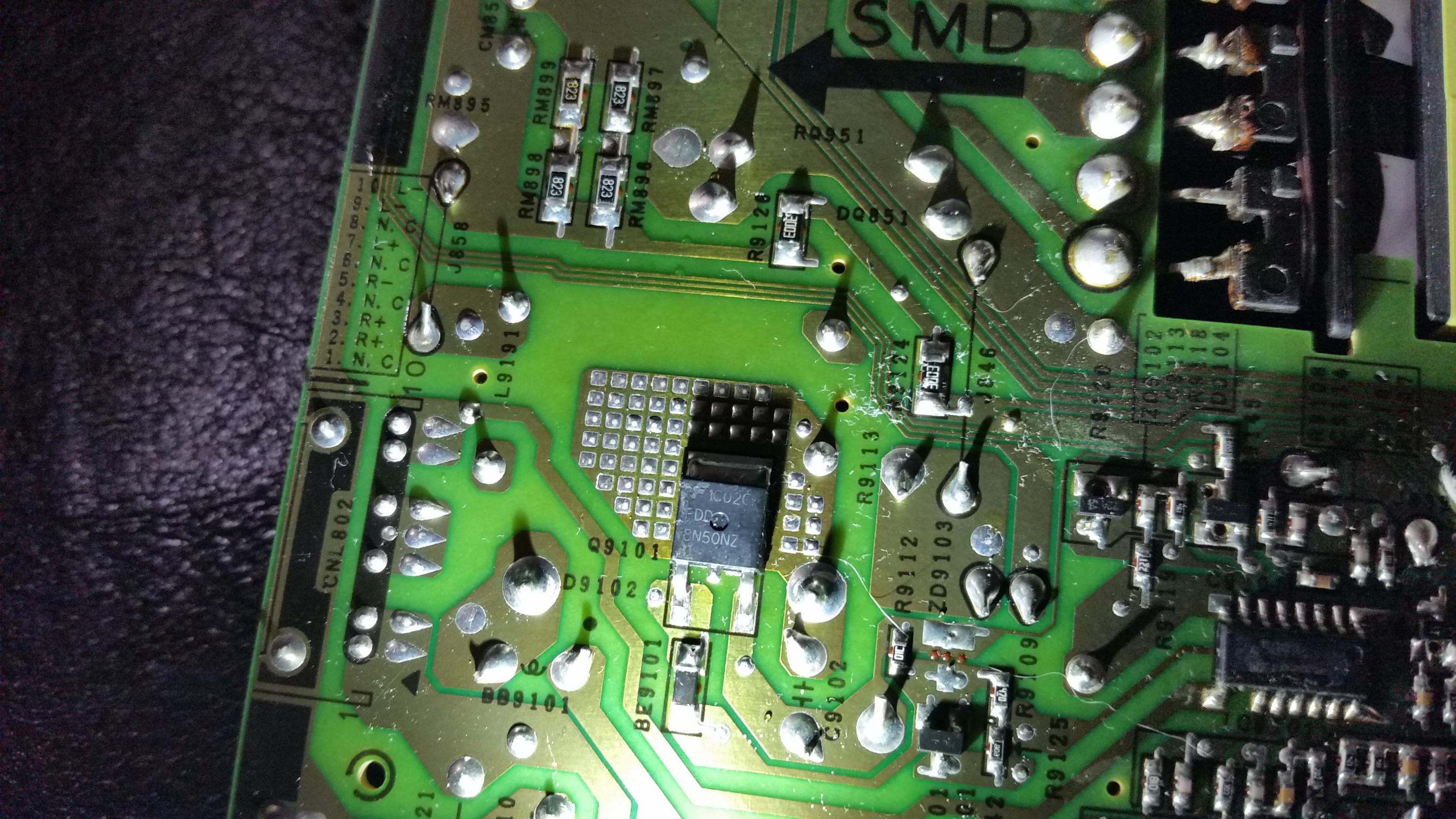

                                  i cant find my freeze spray right now but here's some pics of the only IC i could find, and a couple of other things that have numbers on them. super hard to read
                                  especially the IC, it has some kind of glue on it or something
                                  Don't fear the repair...
                                  • freakaftr8
                                    • Oct 2012
                                    • 3743
                                    #37
                                    Yeah that's the LED controller IC. I had the 40 inch version of this TV that had a very similar issue except it was flickering the backlight always upon start up or disconnecting the main board. I replaced that IC and it fixed the problem.
