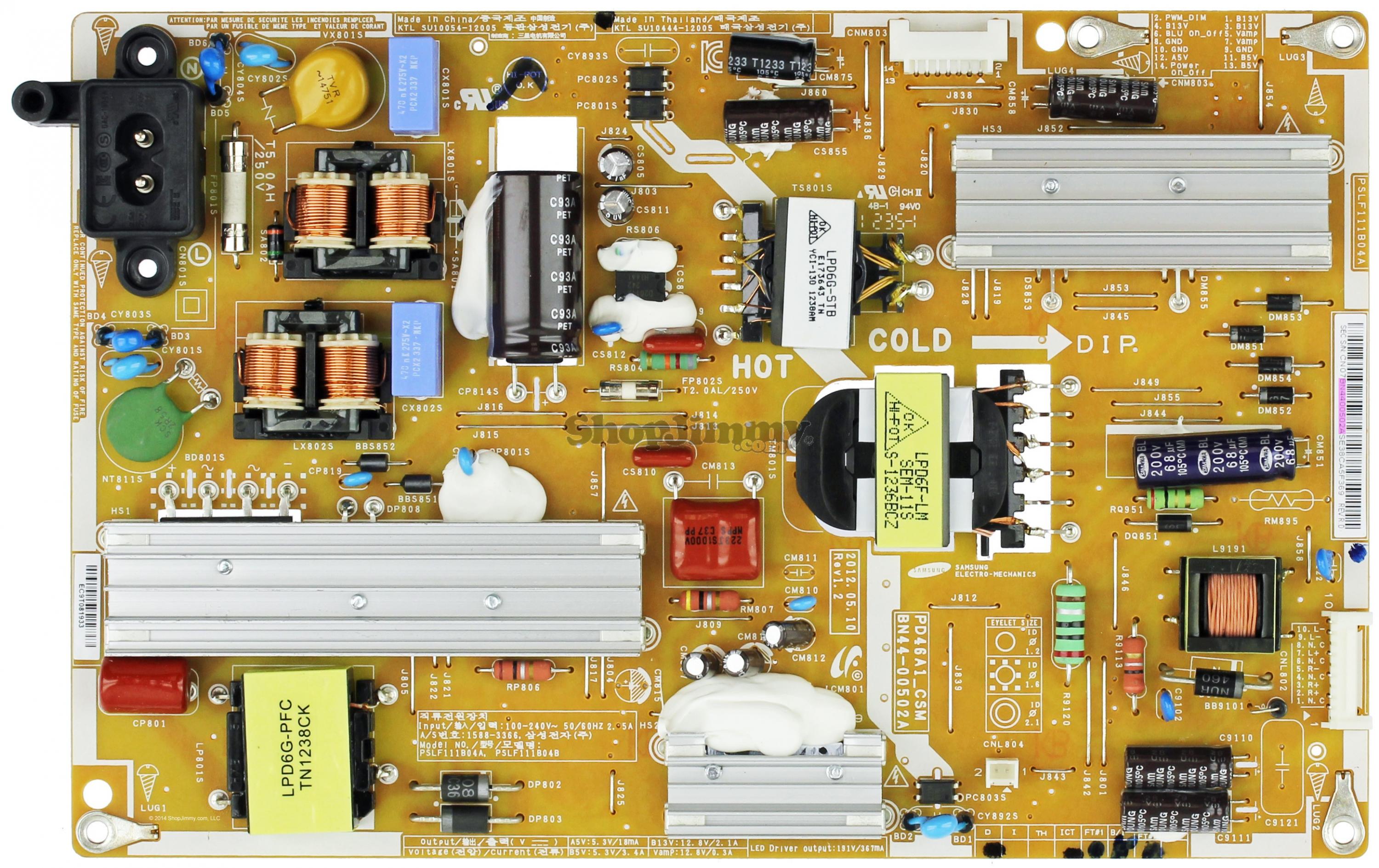

                Re: Samsung UN46ES6150F starts power cycling after 2 hours of use from a cold start
                TS801S and the next one below it, you can see the through hole rivets on the legs, I use flux and add just regular solder to the joints.
                Any through hole rivets I will re-solder.

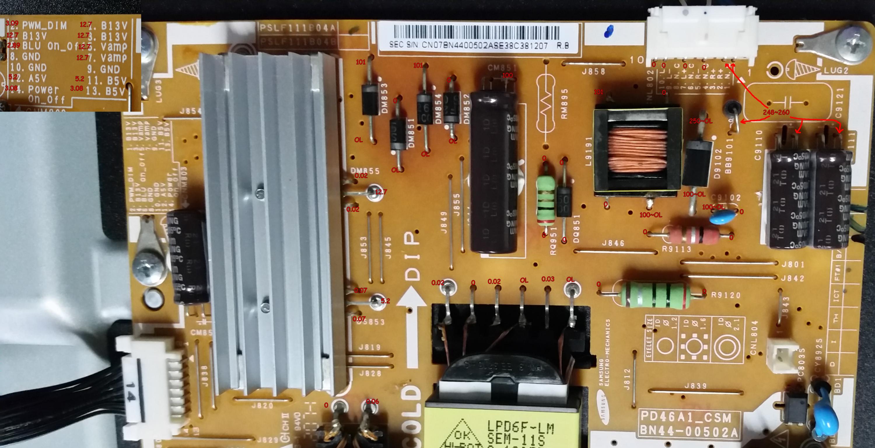

                          in the meantime here's the cold side voltages im getting.
                          wherever you see ~ means its fluctuating between those 2 values.
                          wherever u see OL, i had my meter set on 600VDC range...
                            ok i repeated my measurements and did like you said, checking each pin for what it does right when you plug in the tv, and none of the measurements change. still getting all zeroes except the fluctuating 248-260v on the right string (which when you're looking at the tv, is the left string)
