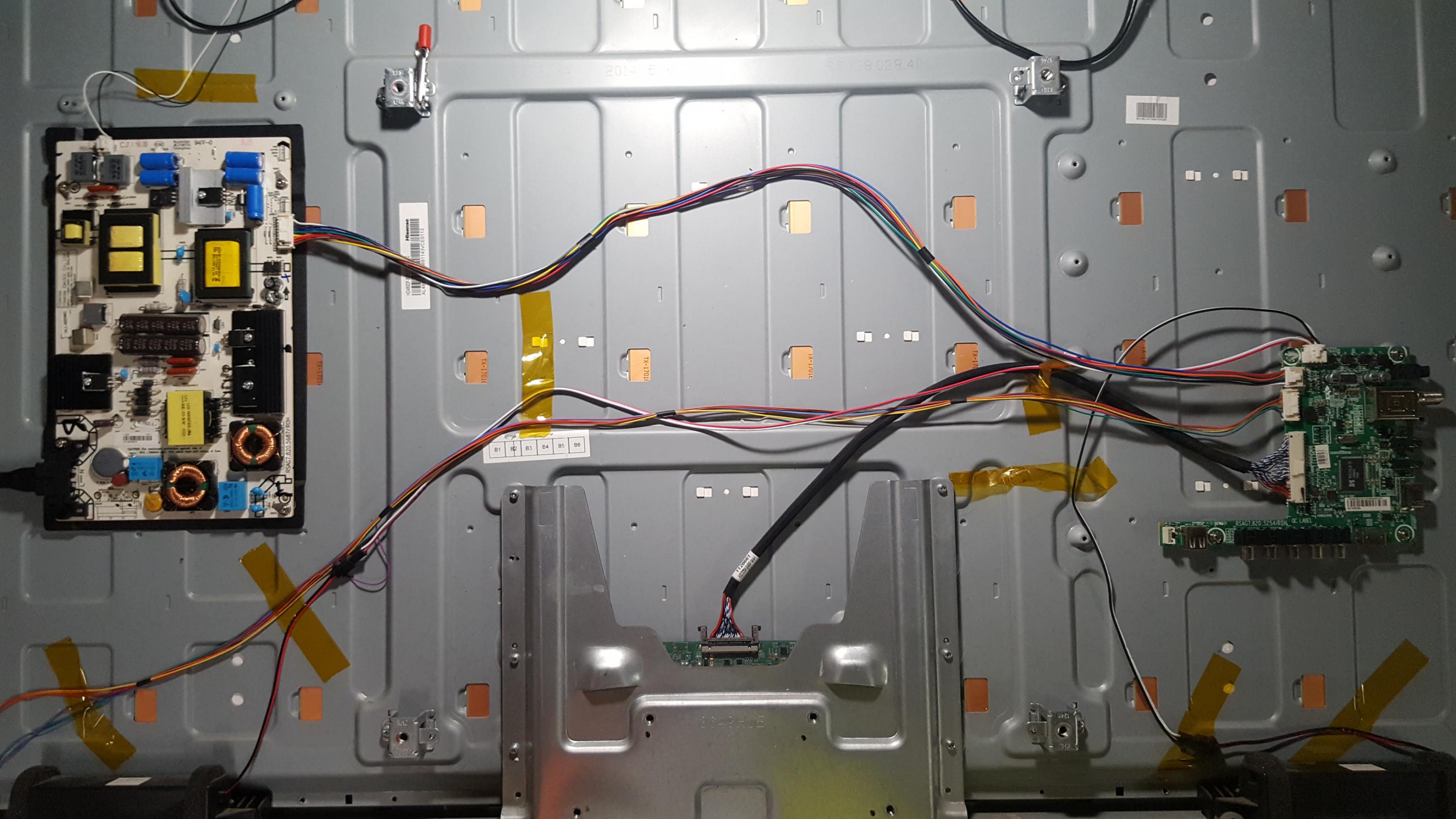

    I have a insignia ns-48d510na15 that the backlights will not come on. i have an led tester and the leds work and pull 163 volts. on the psu for led+ when powered on goes to 195 volts and within a second to less then 1 volt. the power led flashes 6 times which what i have found out is backligh problem. there are several listing on the psu to the logic board that i dont understand... connector label of pwm3 3de 3ds and sw .. the best i can tell my stb voltage is 3.5 volts with set on but its 53.3 with set off . what do i need to look at?
  • robert phelps
    • Dec 2016
    • 94
    • usa
    Re: insignia ns-48 no backlights
    also when you power the set on up close to the psu you can hear a small whine for a few seconds then it stops

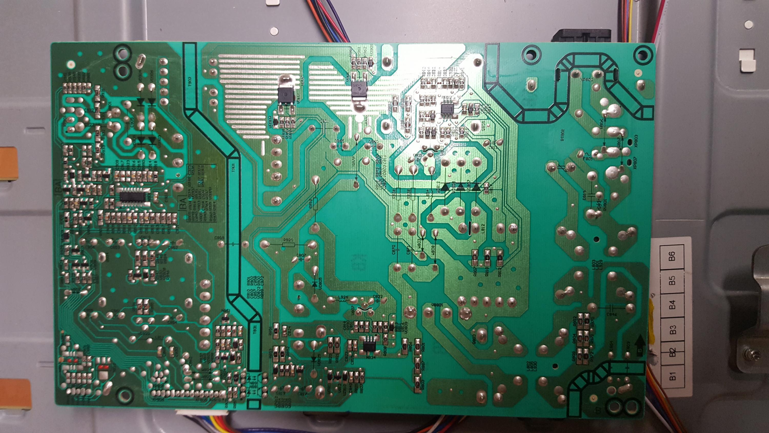

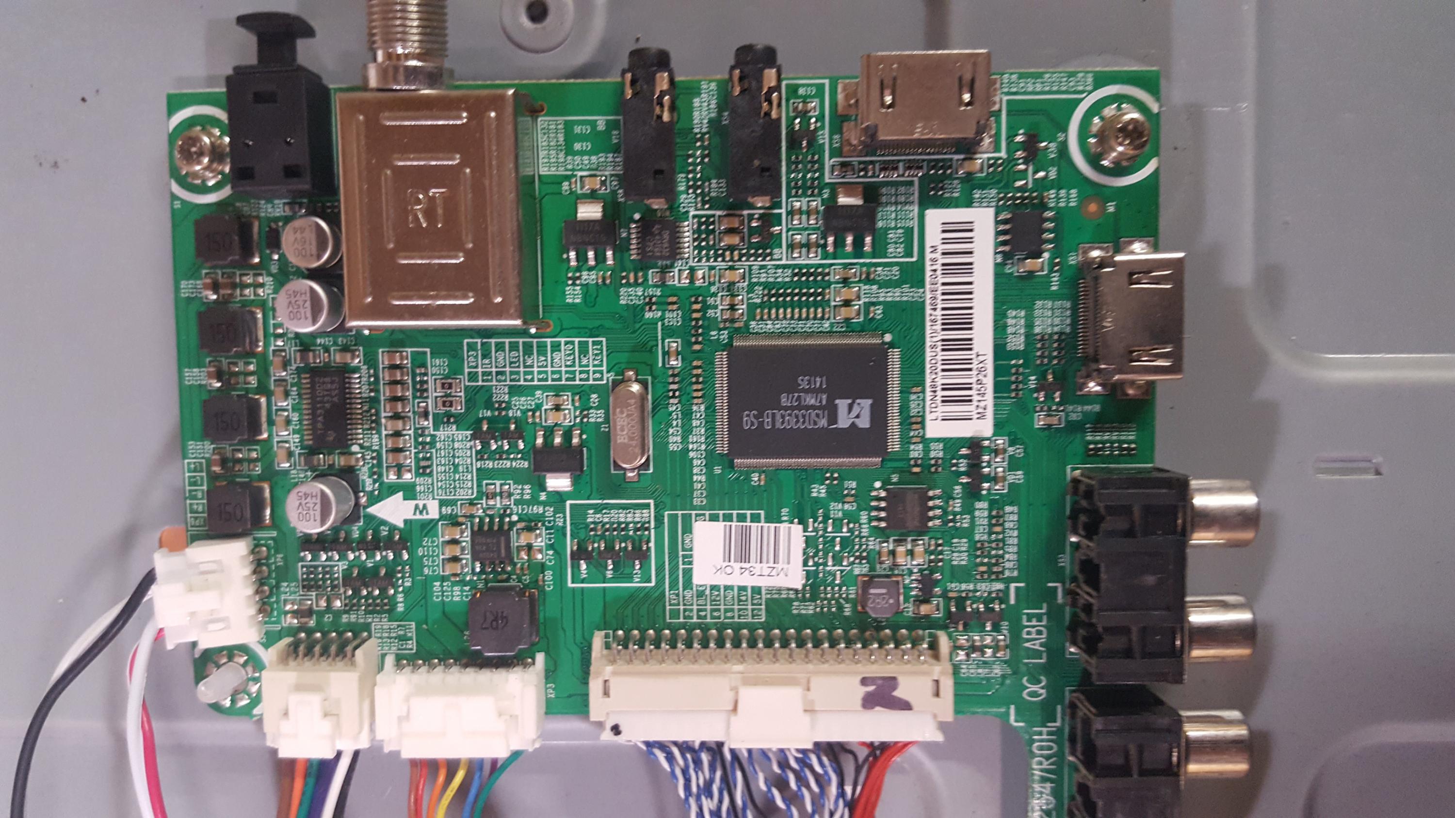

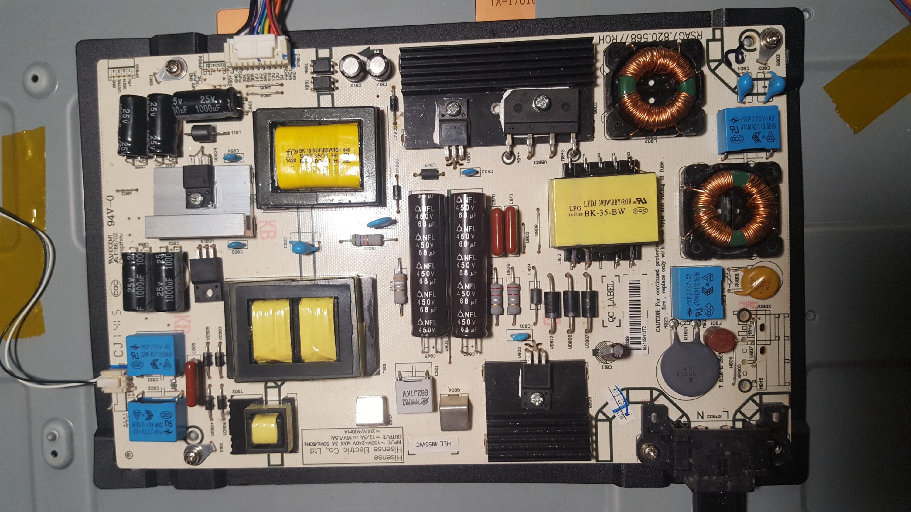

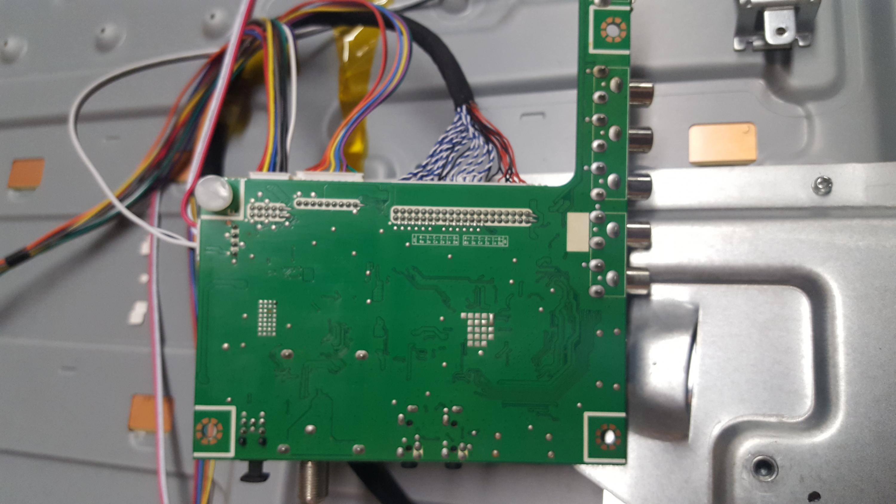

          Here are pic
            Need pictures the whole backside showing all the boards and how they are connected together.
            It only use one string of LED.
            LED connector in place and probe at the pins of the connector on the board, report the Voltage reading between chassis GND and the Black wire of the LED, Gnd and White wire of the LED, you muat leave the probes on the test point and then turn on the TV otherwise you may not catch how high the Voltage goes up to before it goes into shutdown.

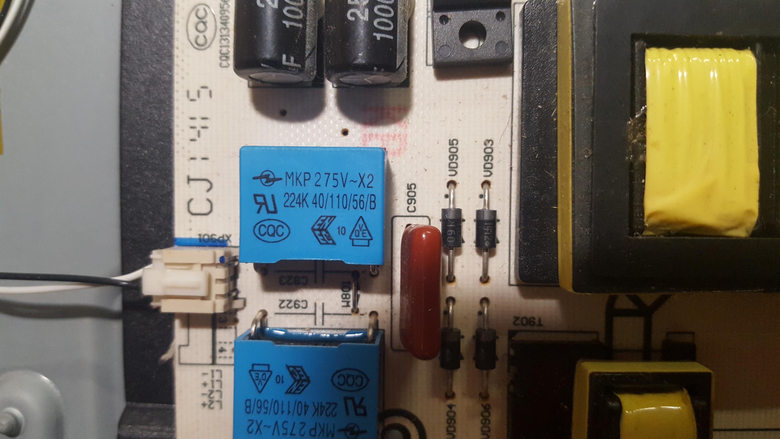

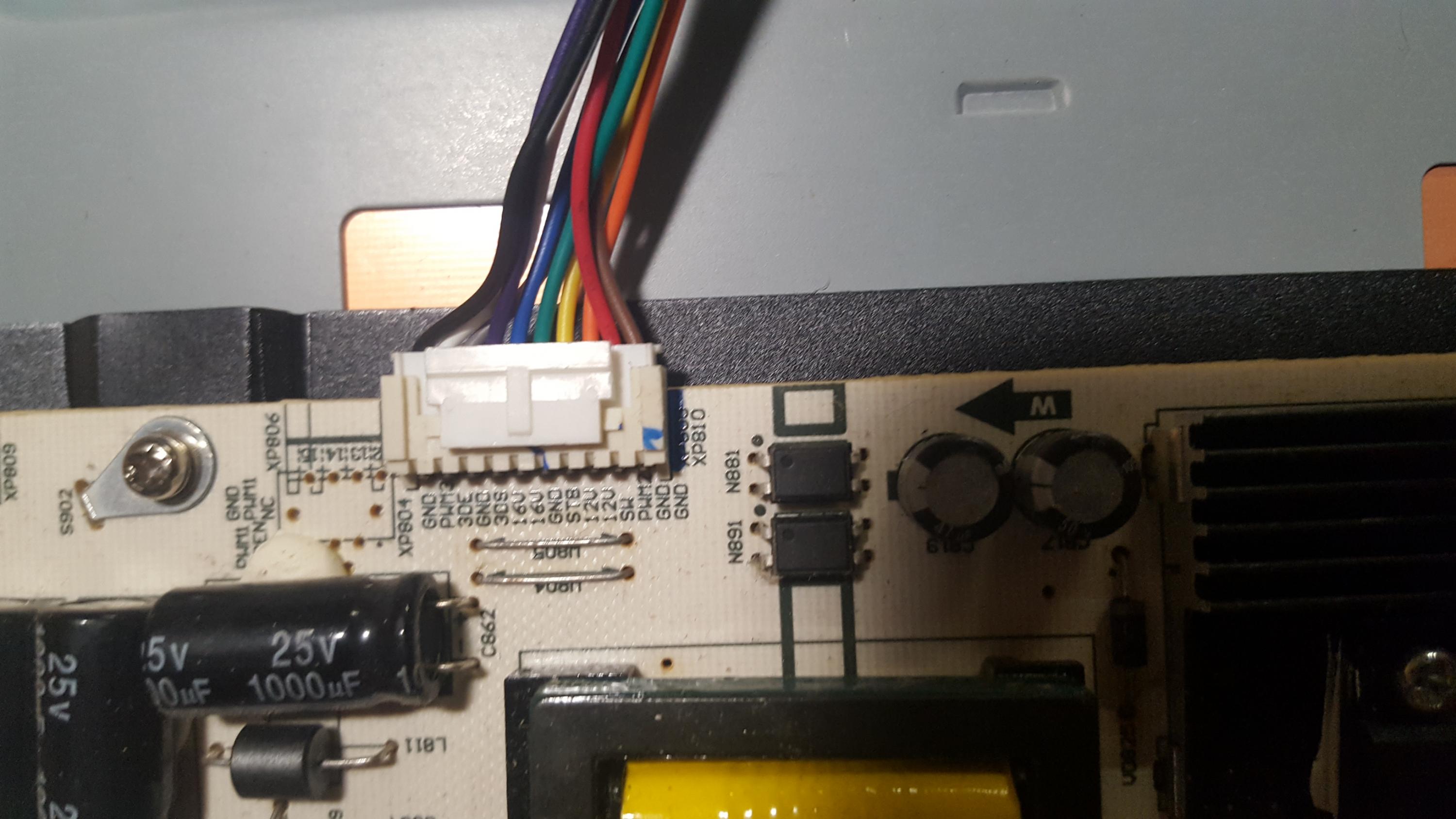

              Here are pics of underside of psu and logic boards. My first post stated that led+ goes up to 195 volts and then shuts down
                Please do the test as requested in post 6. You only report the feeding wire Voltage, you did not report the return wire Voltage with ref to the chassis GND.
                "LED connector in place and probe at the pins of the connector on the board, report the Voltage reading between chassis GND and the Black wire of the LED, Gnd and White wire of the LED, you must leave the probes on the test point and then turn on the TV otherwise you may not catch how high the Voltage goes up to before it goes into shutdown."
                  Black. Led+ goes to 195 and shuts down. White. L ed- .5 is all it shows. That's .5, these voltages are the same with and without the leds hooked up
                    Well, you have open circuit because the LED - only show 0.5V so the output went up to 195V due to no load, recheck the connection between the male pins of the LED connector on the power supply board all the way to the LED strip are OK.
                        I can use my led tester from the connector and all the leds light, I have checked each strip themselves and all is good. I can light up the leds by touching the pins on the psu at the connector for the leds, not bad cable or leds.
                          I do not know what to tell you, you 195V feeding into one wire of the LED string and the return wire only shows 0.5V, you also get 195V with or without LED connector in place. Measurement error or wrong DATA some where.

                          You have 195V across the whole set of the LED string but the string only need about 163V (it will be higher at 300mA) to light up at about 30~50mA of current so no way it will not even light for seconds. You have open circuit some where.
                          How many LEDs are there total?
                            There are 10 strips but I don'tremember how many was on each strip, thinking it was 6 leds per strip, so 60 total
                              I hooked up my led tester to the led leads, DVD player to hdmi and watched toy Story for 20 minutes on this set, what in the psu could be making it shut down the leds?
                                It will go into shutdown when over Voltage occurs (I.E. 195V) when there is no load, it also shutdown if over current is detected.
                                You can use 100 Ohms 2W resistor between GND and the LED - pin to see if the LED will come on at all.
