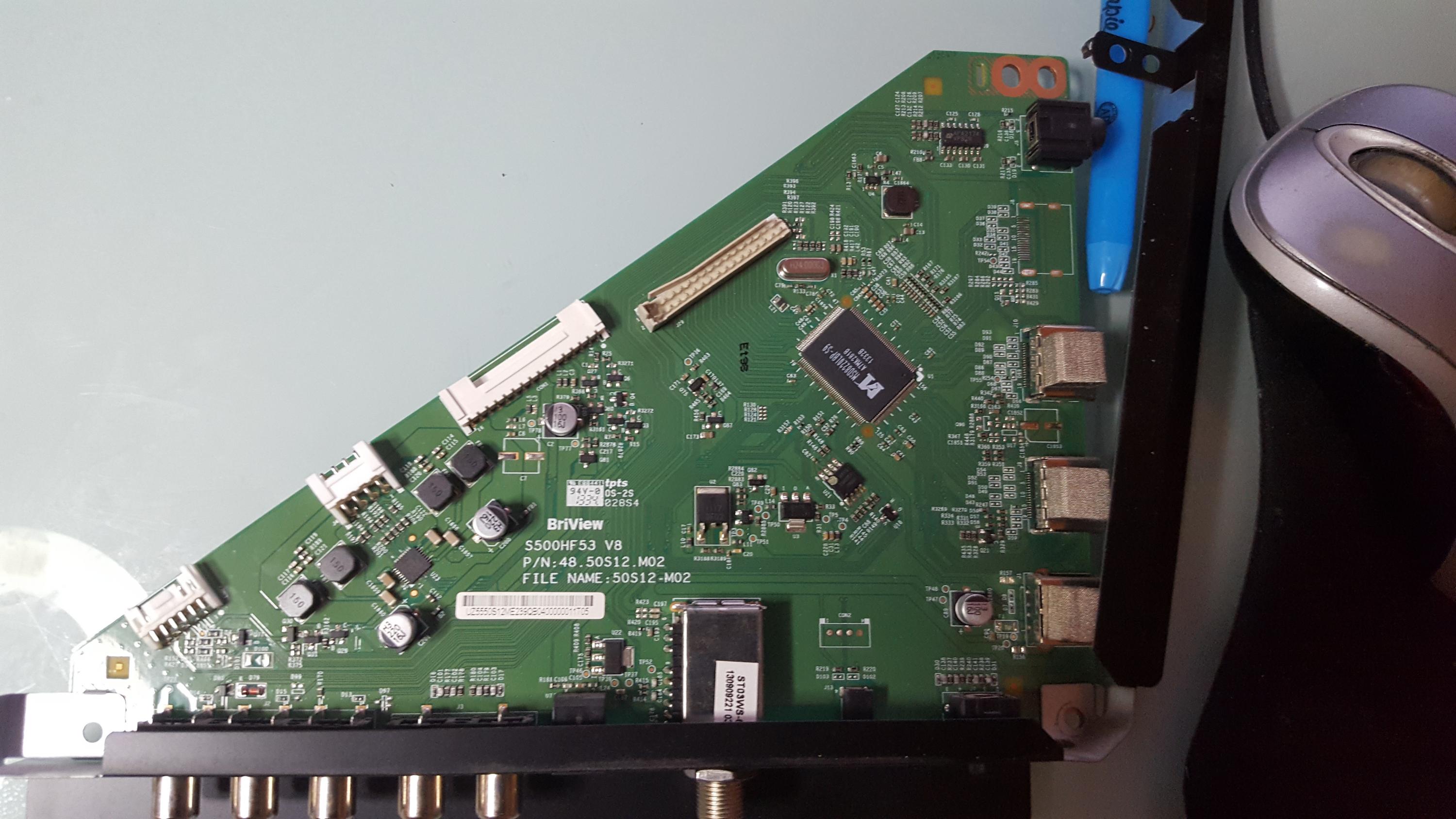

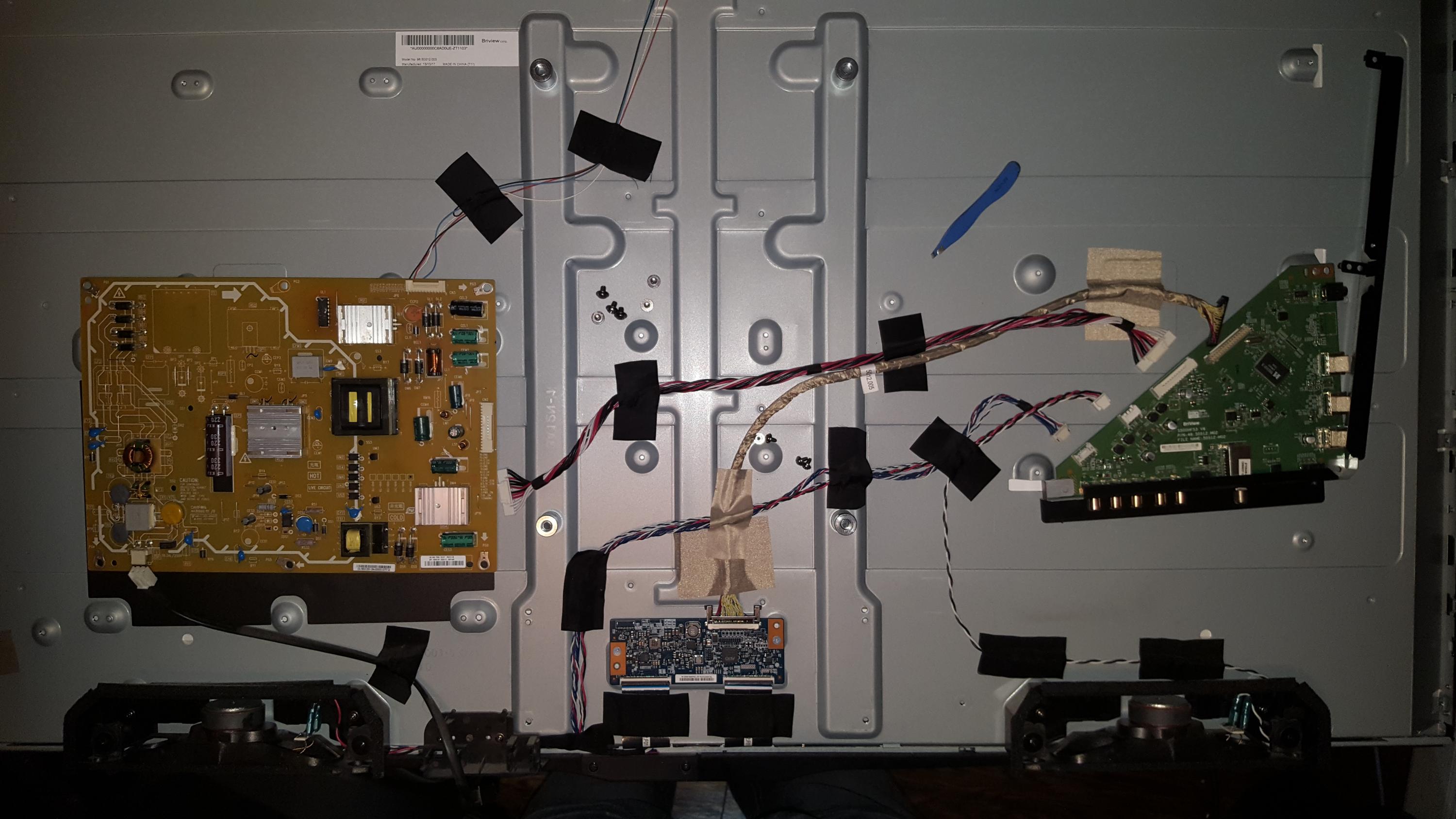

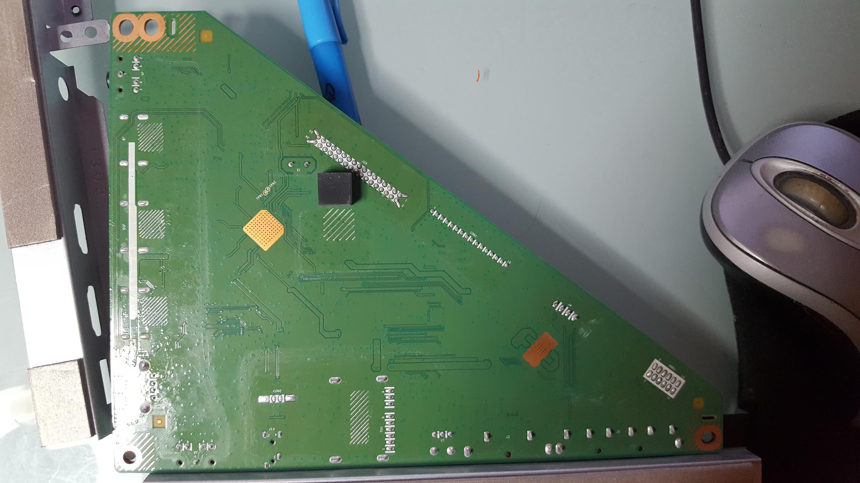

    We need good clear straight shot pictures of the top and bottom side of the boards and the whole backside of the TV showing all the boards.
      Re: insignia ns50d40 dead
      Ok so i had boards out for testing so i just placed on tv where they go. The pic showing the connector is just to show the pinout incase it didnt turn out good in the other pic.
      Btw i read ur troubleshooting guide. Very informative. My tv doesn't have 24v but i guess 2 x 12v =24v?
      If any better pics are needed or any specific area i can take alot more
      Thank u

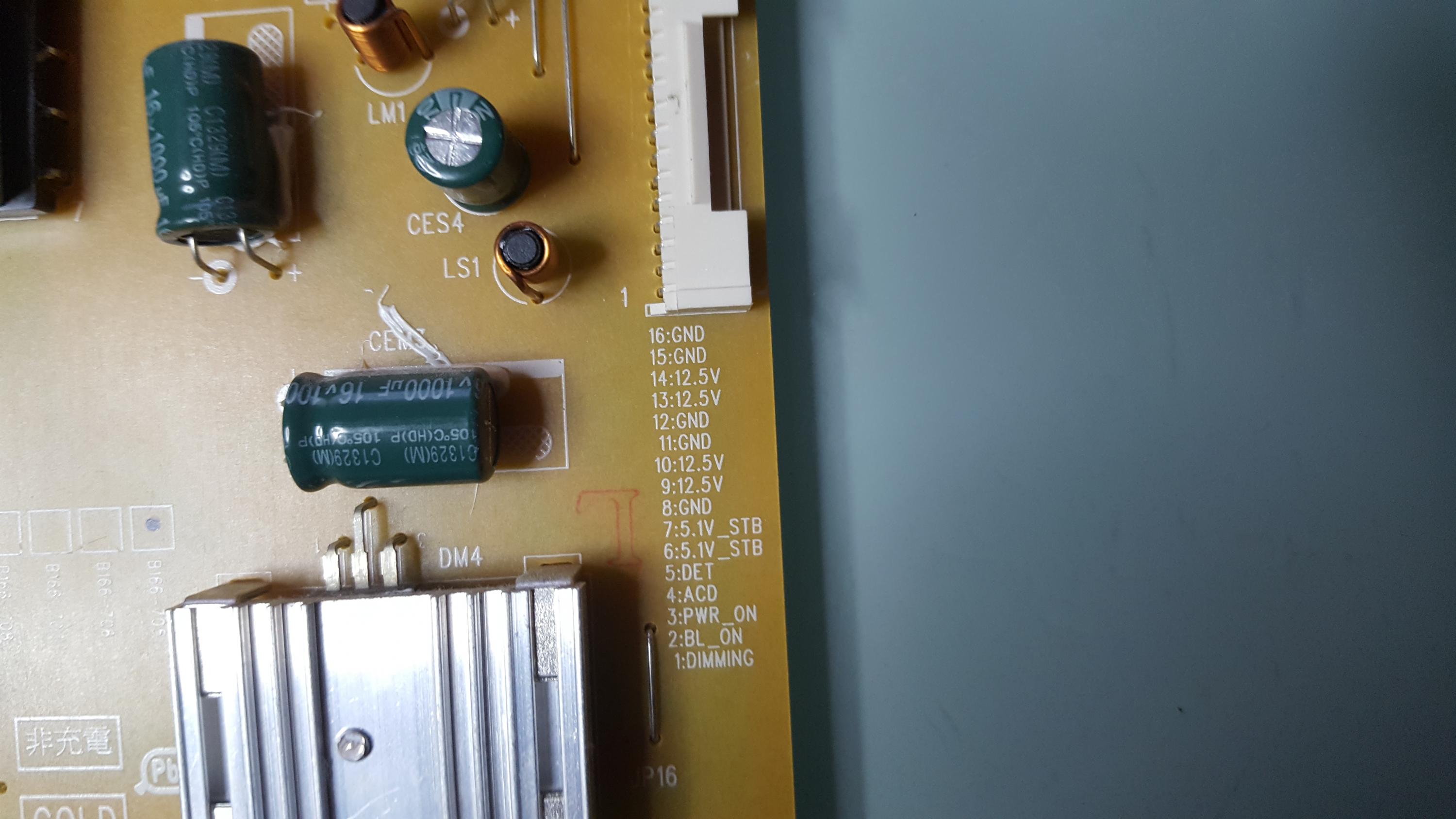

        does anybody know how the logic board triggers the power supply board to turn on the rest of the power suplly voltages? i have a pic of all the labels for the signals going from the power board to logic board
          https://www.badcaps.net/forum/attach...8&d=1512087801
          you need to post the DC Voltage readings of all those pins so we can see what it has and doesn't have when TV is OFF and when Power switch is activated.
          You must put down the pin name and follow by the Voltage reading for each pin so it will be easy for us to see the result.
          BTW, all the boards will have to be connected back in place.
          The power supply only has two power supplies: 5VSTBY and switched 12V.
          At this point I suspect the main board.

            my tv will not turn on, only a faint dim red led that was bright before. i tried pushing the power button none the less after i tested all the pins but no difference
            pin# voltage
            1 - 4.093v
            2 - 0.025v
            3 - 1.535v
            4 - 4.575v
            5 - 0v
            6 - 5.065v
            7 - 5.065v
            all the rest are 0v

                Where are the name of the pins that I request?
                  Sorry bout that, here goes:
                  1: DIMMING 4.093VOLTS
                  2: BL_ON 0.025VOLTS
                  3: PWR_ON 1.535VOLTS
                  4: ACD 4.575VOLTS
                  5: DET 0VOLTS
                  6:5.1V_STBY 5.065VOLTS
                  7:5.1V_STBY 5.065VOLTS
                  8:GND 0VOLTS
                  9:12.5 0VOLTS
                  10:12.5 0VOLTS
                  11:GND 0VOLTS
                  12:GND 0VOLTS
                  13:12.5 0VOLTS
                  14:12.5 0VOLTS
                  15:GND 0VOLTS
                  16:GND 0VOLTS
                    OK, so you do have PS-ON but the 12V does not come on.
                    The BL-ON is also not present so the backlights circuit will not come on.
                    You do have Dimming control signal.
                    So you have two problems: The main board is not sending the BL-ON, and the power supply is not putting out the switched 12V.
                    At this point you need to get the 12V power supply working first so it will need in depth troubleshooting down to component level, it is not going to be easy due to no schematic available.

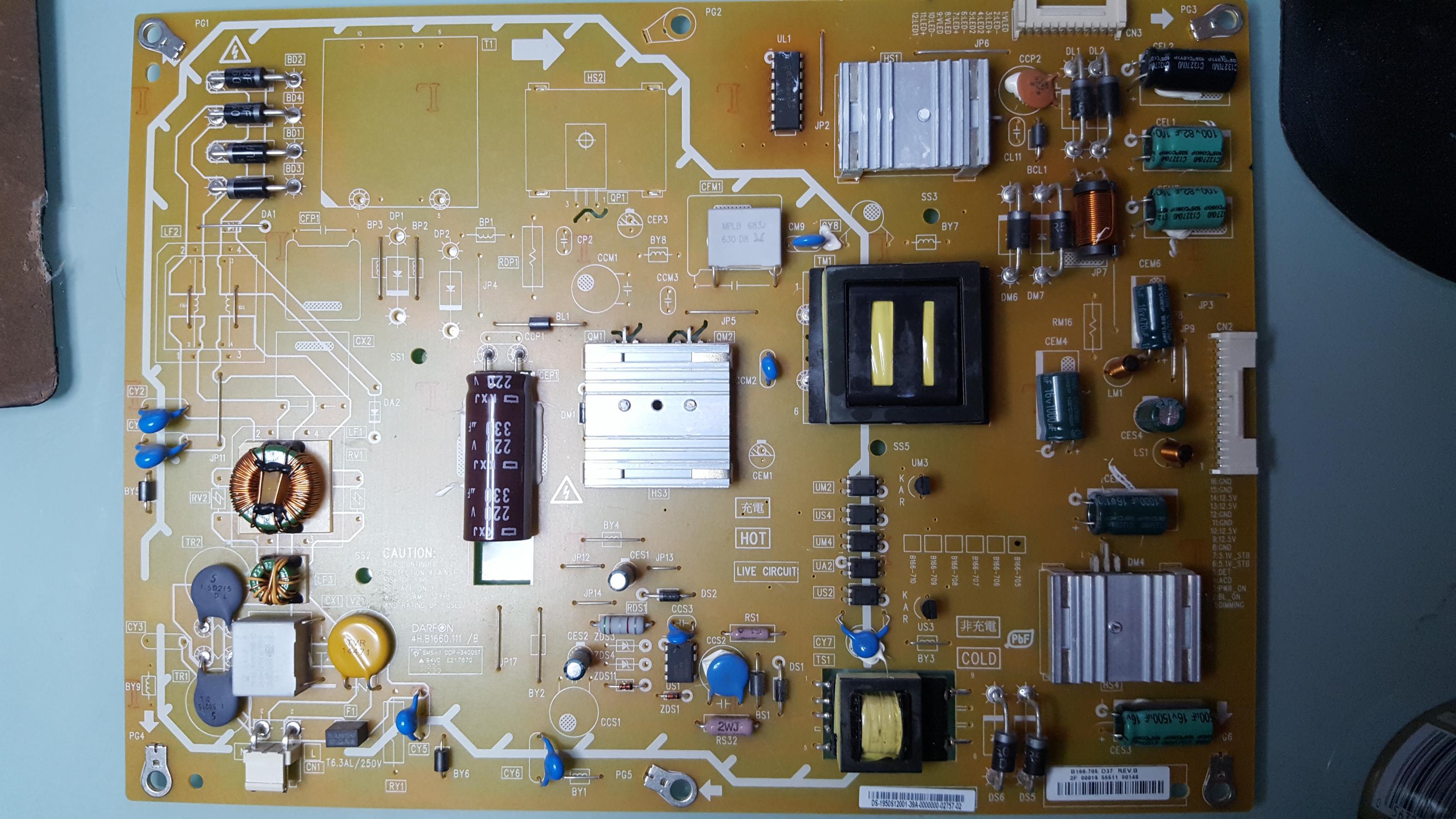

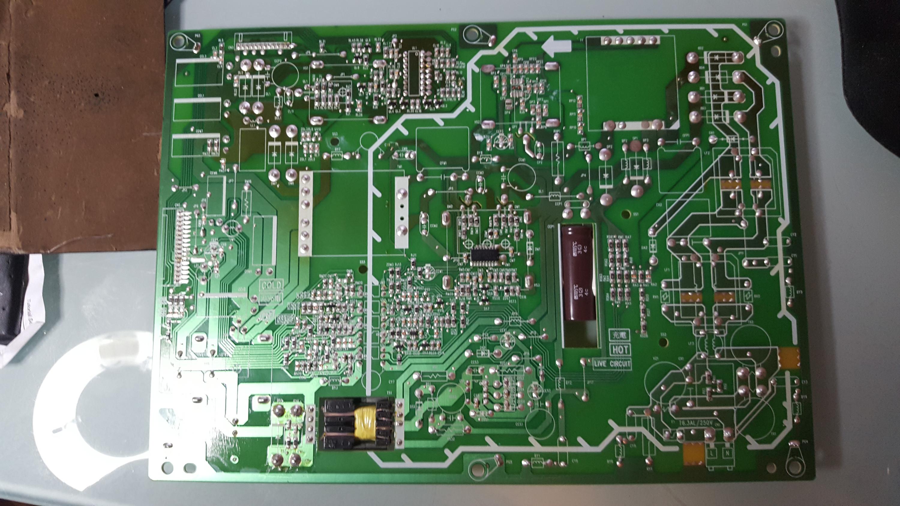

                                    I need straight shot high res. pictures of the whole top and bottom side of the power supply board.
                                      comming up in 2 mins. Ill get a better cam with less glare
