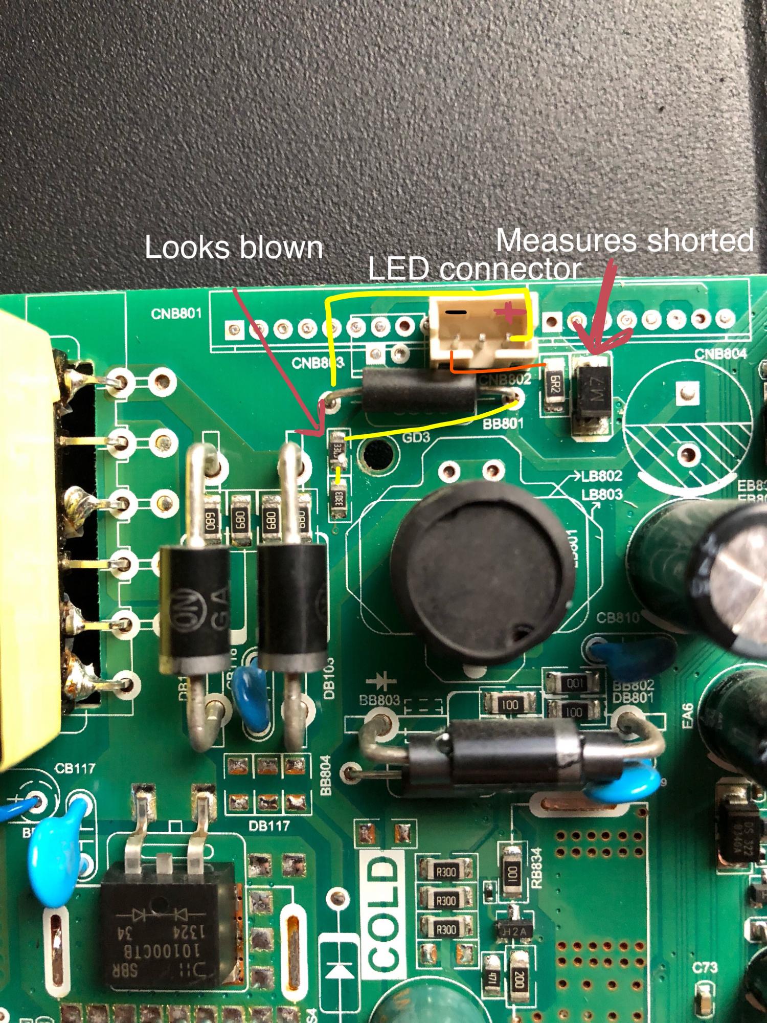

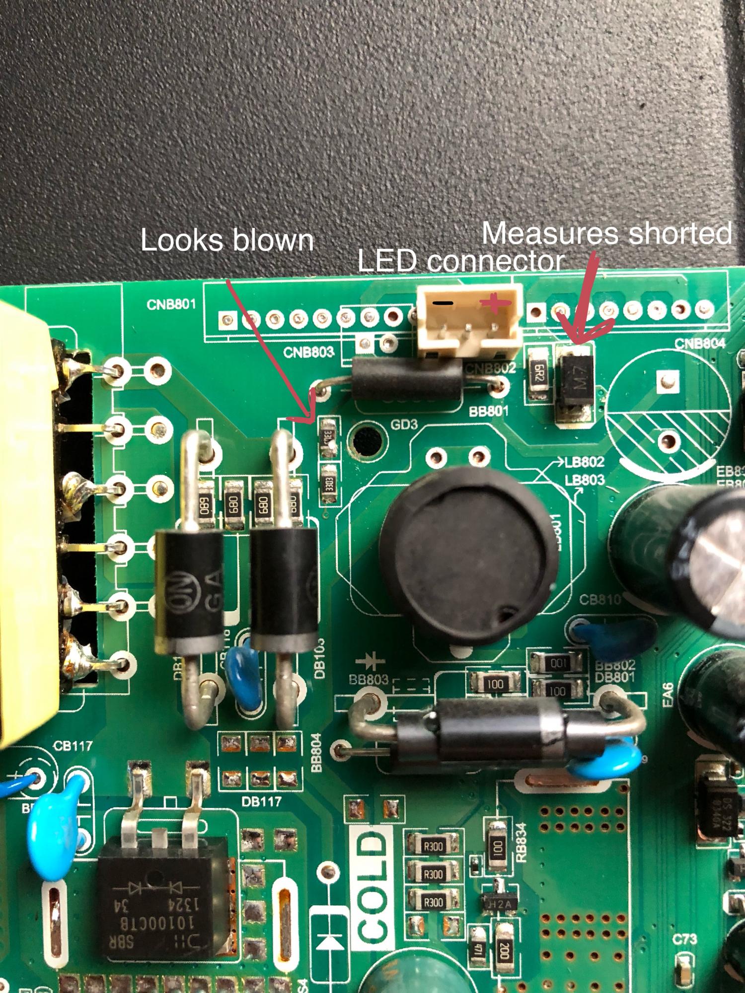

    Ocosmo E32 no backlight
    Tv powers up fine but no backlight.
    Opened it up thinking it might be an led issue but noticed a diode measures shorted and a resistor looks blown (see picture)
    Is there a way to determine if the LEDs shorted causing this without removing them from the panel?
    Should I just replace the parts and see what happens?
    If anyone has a schematic for this model that would help me trace back the circuit with the shorted diode

    Re: Ocosmo E32 no backlight
    I removed the diode and it was fine. I’m not sure if I’m just measuring across transformer legs in parallel.
    The resistor that looks blown open is bad.
    What should I check next
      That 6.2 Ohm resistor is connected in parallel with that Diode that is why it shows conduction in both direction when you tested that diode still on the board.
      What resistance do you get on each one of those two '3303' resistors?
      What dc Voltage on each pin of the LED connector when you first turn on the TV?
        One resistor reads 300k and the other 5Mohm
        I’ll do voltage tests tomorrow
        What would that 6.2ohms resistor be used for? Current sensing?
          May be or may be not, you need to trace out the Cathode return pin of the LED connector to see if it is directly connected to one end of that resistor or not, another end of that resistor should be connected directly to GND.
            Ok I drew out the routing
            The (yellow line) shows how the bad resistor is in series with the 330k next to it and the other end of the bad resistor connects to the ferrite bead? Which goes to the anode terminal of the led connector
            Cathode side (orange line) of led connector connects to the 6.2ohm resistor
              Taking voltage measurements. When it’s in standby I get 35v on the red anode side of led connector.
              When first power on voltage jumps to 124v then slowly decreases. Voltage at cathode of led connect remains at 0v the entire time
              Does this indicate led failure?
