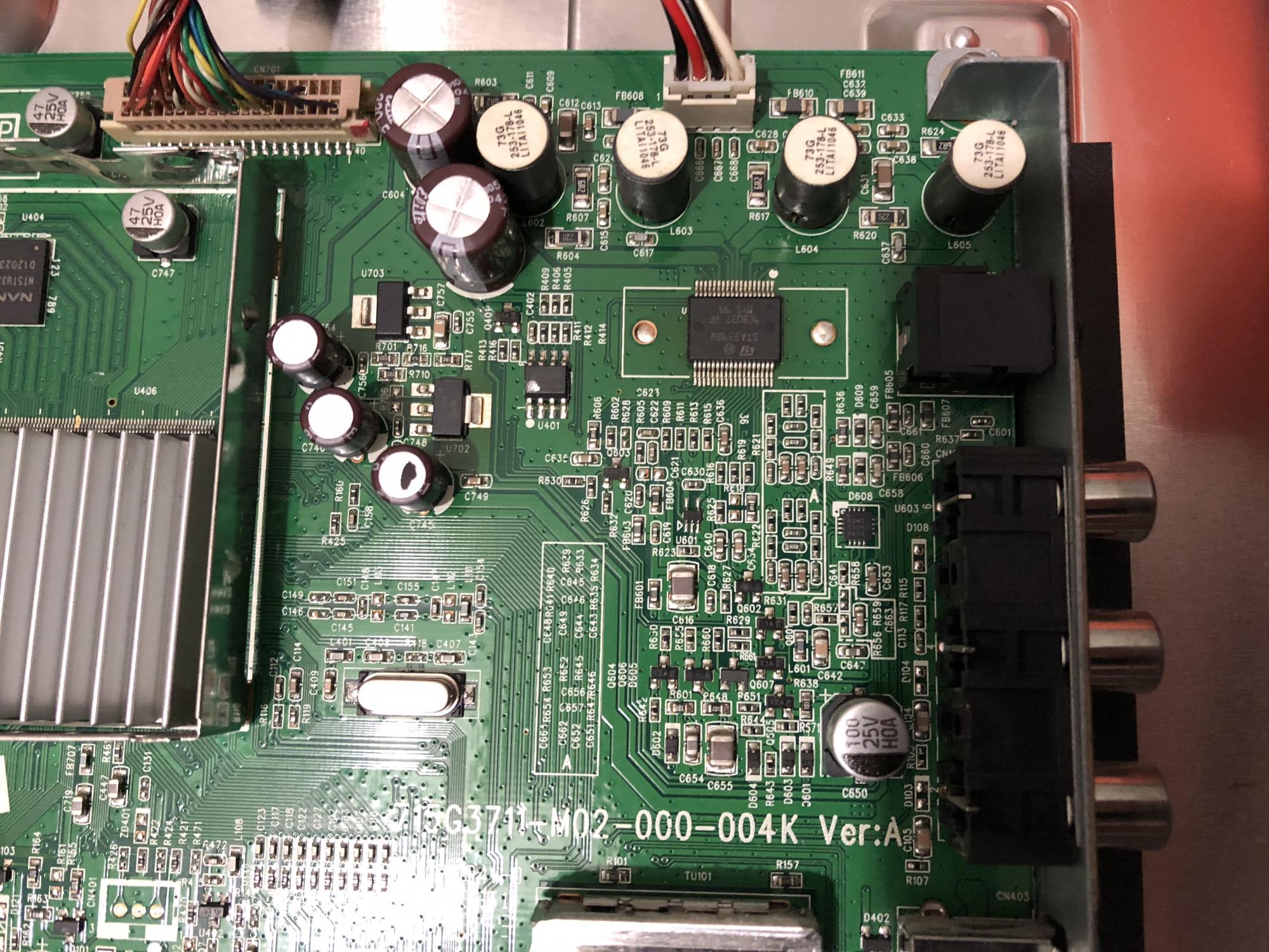

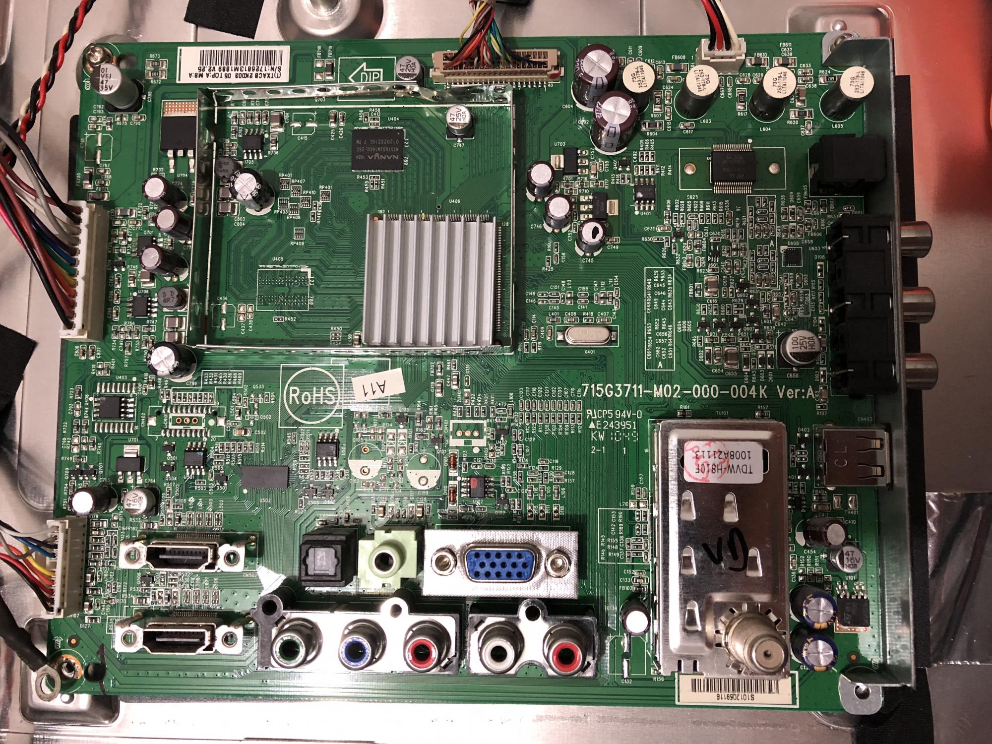

    There is no sound in any input. You can see volume go up/down in correlation to pressing volume buttons but there is no sound at all
    Speakers are 8 ohm and both measure that. The datasheet for the audio ic is:
    https://cdn.badcaps-static.com/pdfs/...739888a823.pdf
    I’m just not entirely sure what to look for when probing and the pins are really small and close together so might be difficult to do

    Re: Vizio M260VA - No Sound
    http://pdf1.alldatasheet.com/datashe.../STA339BW.html
    i can't help much, but it looks like pin 8 and 11 are your supply voltage pins.
    you can probe them at the vias just above each respective pin. you may have to scrape some of the masking off.

      I measure 25v on those pins

        So after a few probing around trying to get measurements the sound came back, went out, started crackling then would come back
        Thought maybe my probing temporarily fixed a micro crack in the solder. So I started tapping on the ic and the sound would come and go.
        Reflowed all the pins of the ic and it’s been running good for over an hour.
        Hopefully this helps someone else if they have similar experience
