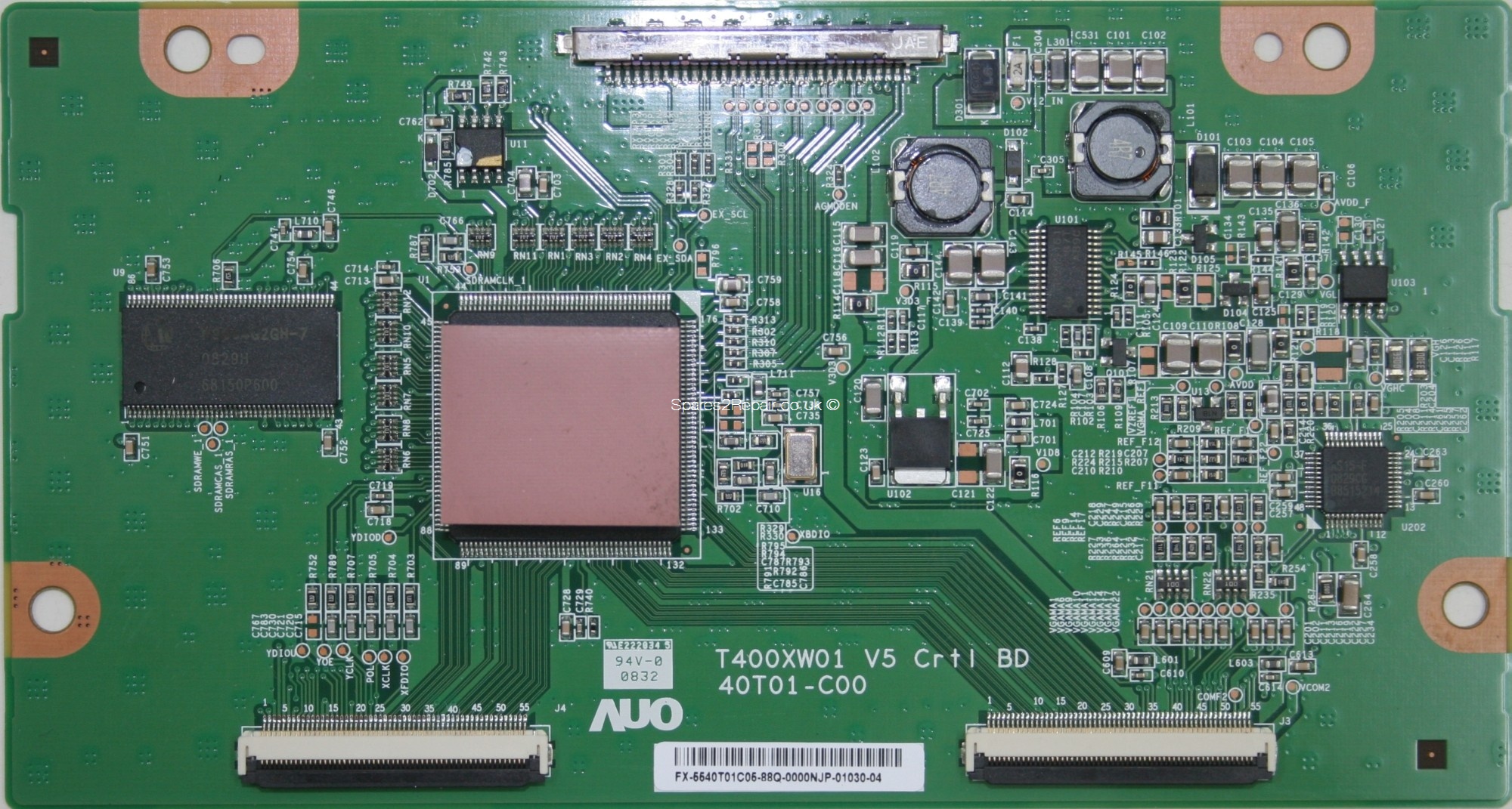

    hi guys
    just need to confirm if this Tcon board is faulty
    T400XW01 V5 40T01-C00
    VGamma 1 6.86V
    VGamma 6 7.28V
    VGamma 9 7.37V
    VGamma 10 7.55V
    VGamma 11 7.57V
    VGamma 12 6.63V
    VGamma 14 4.89V
    VGamma 17 4.16V
    VGamma 22 0.33V

    Why some gamma are missing?

      and a picture of the screen. I wonder if the problem is on the whole screen, or just an affected area. Usually a faulty Gamma IC just friggs around with the color, solarization etc.

        These are the only gamma voltages on the board I can find
        Image uploaded

          I was told the tv was losing colour and sometimes an image is stuck when the picture changes just like plasma burn in but at the moment I can't get the tv to show any faults

            check all the pins around the AS15-F. Clean the ribbon cables going to and coming from the TCon.

              also attach one ribbon from the t-con at a time and see if it has lag on 1 half only.
              more gamma readings would of been handy. who designs these boards, :P
              but your vgamma 1 is out of sequence, so you may still have an as chip issue.

                Have you changed already? AS-15 ? if not change it,many problems with gama with as15.

                  picture of the fault would be better but no fault no fix
                  the few voltages you have given dont look right noting the number 1 value
                  there are repair services for the AS15 gamma chip on ebay if you dont fancy doing it your self

                    "check all the pins around the AS15-F" it's risky to measure directly on the chip..
                    the missing gamma testpoints can be on the bottom side..

                      Check the negative voltage generator on the TCON.

                        If you cannot/don't have tools and skill to change the AS15 Chip on the T-CON Bd. You could probably get one on-line for a reasonable price. Replace the T-CON Bd.

                          update ## As15 chip replaced
                          Tv all working again luckily spotted some solarization and brightness issues so changed the chip
