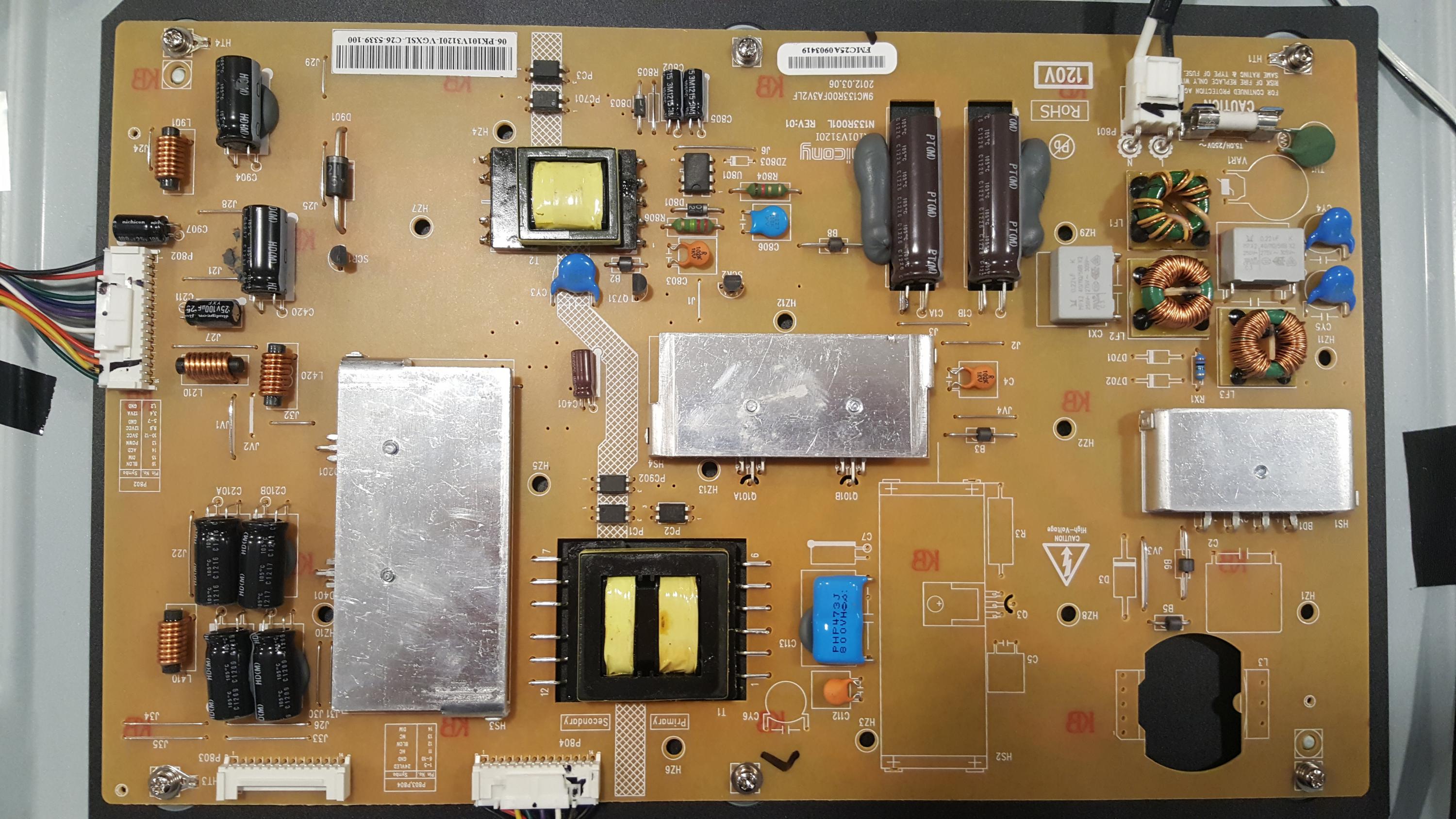

    Problem: Startup and operation are fine until about 5-15 minutes. Screen goes black but power remains (audio cuts as well). Power cycling restores the video until about 5-15 minutes.
    I was told that I should look for bad capacitors on the power board. I've identified no obviously bad capacitors, but I would like people's help.

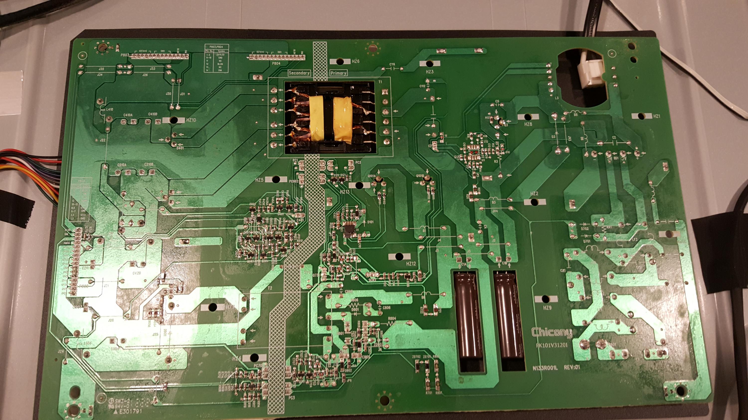

    Attached are some hi-res pictures I took of the power board, front and back.
    Thanks in advance

    We need high resolution, straight shot pictures of the boards.
    To me it sounds like you have a main board problem, not a PSU problem. On pic# 1 on the left there is this connector that goes to the main board. Turn the TV on and note down pin name and the DC voltage measured. Same thing again when the TV "acted up". Post that here.
    Just for reference: Only because a capacitor "looks" like new, it still can be bad. I just had a few examples of that last week. The best way to check the health of a capacitor is with an ESR meter.

        Also Need voltages from connector that goes from power supply board to main board. Will need pin#- PIN DESCRIPTION -Pin voltage in standby-Pin voltage when pushing power button and picture of connector on power supply board.
        Format:
        Pin# - Pin Description - Pin Voltage standby - Pin voltage power on
        1 - XXXXXXX - XXv - XXXv
        2 - XXXXXXX - XXXv - XXXv
        3 - XXXXXXX - XXXv - XXXv
        4 - etc.
        Also dcv across one of C1 main caps while tv is on

          Pin No. - Description (from Board) - DCV standby (V) - DCV On (V)
          1,2 - GND - 0.0000 - 0.0000
          3,4 - 12VA - 0.0300 - 11.842
          5-7 - GND - 0.0000 - 0.0000
          8,9 - 12VCC - 0.0300 - 11.842
          10-12 - 5VCC - 5.0000 - 5.0360
          13 - POWN - 0.0000 - 3.2975
          14 - ACD - 3.3620 - 3.361
          15 - DIM - 0.0082 - 0.2530
          16 - BLON - 0.0000 - 3.2851
          C1 while ON: 162.21V

            ":15 - DIM - 0.0082 - 0.2530" Recheck this dim control Voltage when the backlights are on, 0.25V is too low for the backlights to be on.

              First of all thanks for diving in. Secondly I think I may have shorted the power board after doing this...
              Before getting that reading, since the TV was upside down I went to check one of the C1 capacitors on the power board to see if the backlights were on. POP. The TV now refuses to turn. Some minimal burn on one of the C1 leads but the capacitor still holds 162DCV when plugged in.
              This just got more interesting. Where should I head to first so the TV can turn back on and we can get back to square one?
              Thanks in advance

                  you have to fix the PSU first.

                    Just a blown fuse.
                    The Dim pin reads .25 when the backlights are on. Any thoughts? Inverter circuit?

                      well... for shits and giggles, take the DIM pin off (so you don't backfeed), jump BLon to the DIM pin.

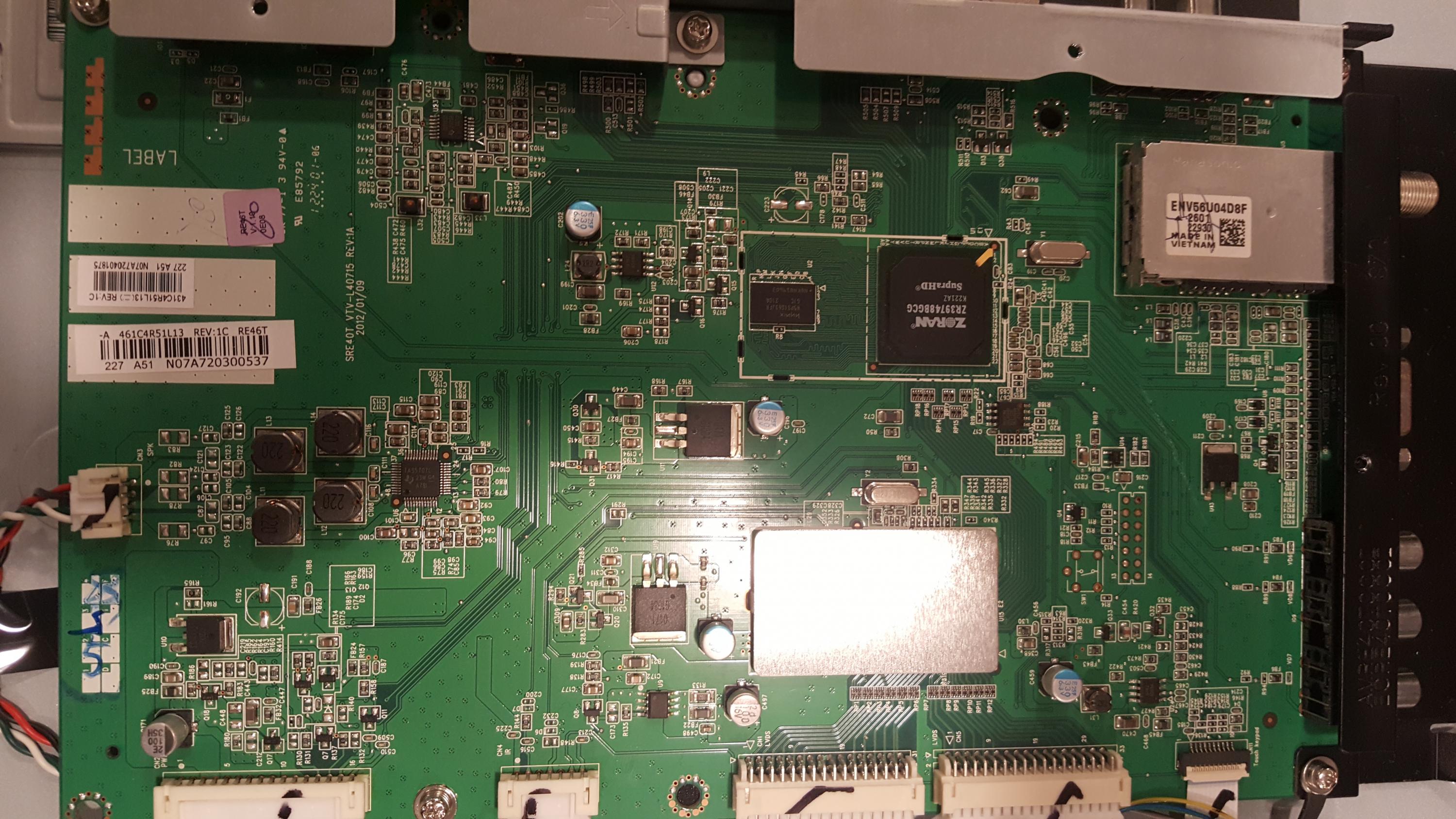

                        Thanks, I'll do that tomorrow after work. I've talked to a couple techs at the company I work at (I took the TV in and plopped it in the lab), they've seen the problem and conclude it's probably a logic board issue. They say it's likely not worth the effort getting it fixed, just buy a new board.
                        Unfortunately, I'm having trouble finding a replacement logic board for the 46xv540u. The boards that I find do not physically match the layout that I see on the TV.. (example: https://www.ebay.com/itm/Toshiba-46X...IAAOSwcUBYJfhV)
                        Where's a good place I can look for replacement boards?

                          You can try shopjimmy.com
