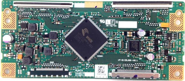

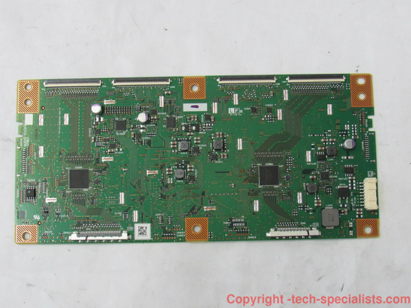

            Re: Vizio LED Panel Swap
            Looked at the TCON boards across both models - M70 has 4 connectors whereas D70 has 2 connectors. So the connectors would be different across both model's panels (different panels basically).
