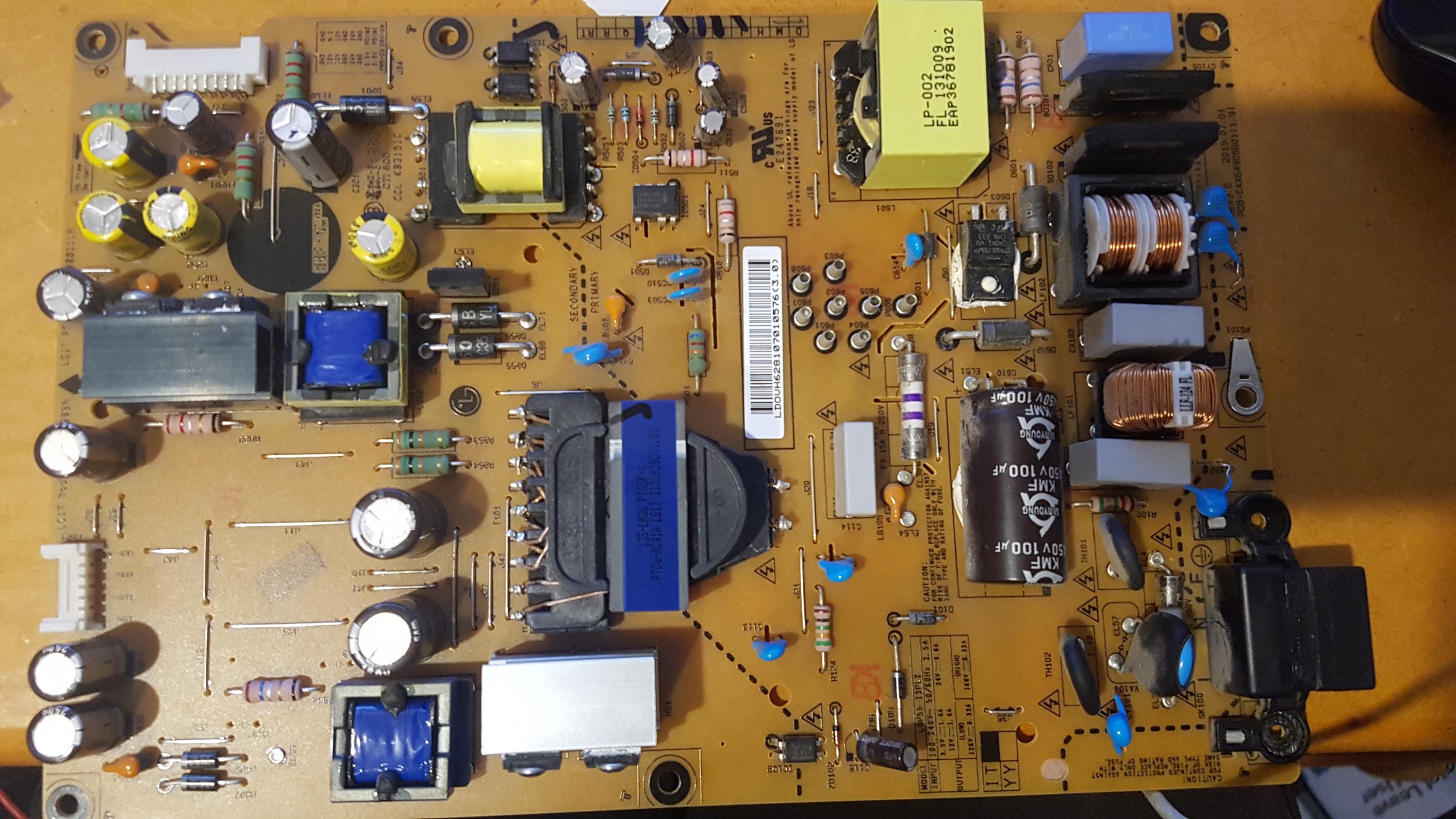

    Hi guys,
    I have an LG Power board EAX64905601 from a 55LA6230 LCD.
    Originally this had a backlight issue, where it would flash on for a second then no backlight.
    From a fair bit of research I found that it was likely to be the LED array that was the issue. (LED + voltages fine, no LED - voltage)
    I checked Connector P201 and all voltages were normal there, so I thought power supply was ok.

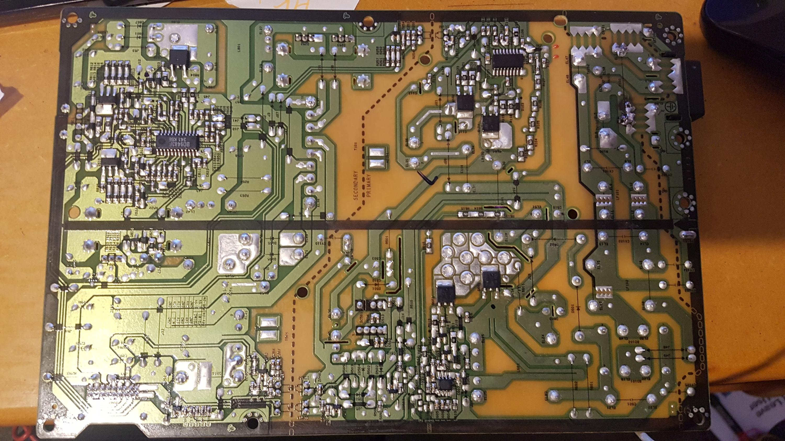

    After I stripped the TV down (took power supply board off to lay it face up to get LCD panel off) and did some investigating on the LEDs I wanted to see if they would light up, so I stood the TV up on its stand and re-installed the power supply board and connected it to the main board. (TCON not connected - no screen still). At this point there was nothing at all after turning it on.
    I checked the LED pins again - 0v. I checked P201, and there is no voltage on any pins there, including the 3.5V.
    Any suggestions on where to look next would be much appreciated. Perhaps I knocked something while taking it off?
    (there is a burn near F100, it looks as if this fuse has been replaced and that is from it being soldered - I got this TV used with a backlight issue, clearly it has had a problem before)

    The fuse F100 has been replaced and not soldered in very well. Have you check with your meter that it is not open circuit? Set off, meter set to ohm's and should read 0 with probes either side of it.
    I see there's a second fuse solder onto the board so do the same test on that too.
    If they both check out OK then with the set on, carefully measure the DC voltage across C610 with your meter probes on each leg. Capacitor is rated at 450V so measured voltage should be around 400V

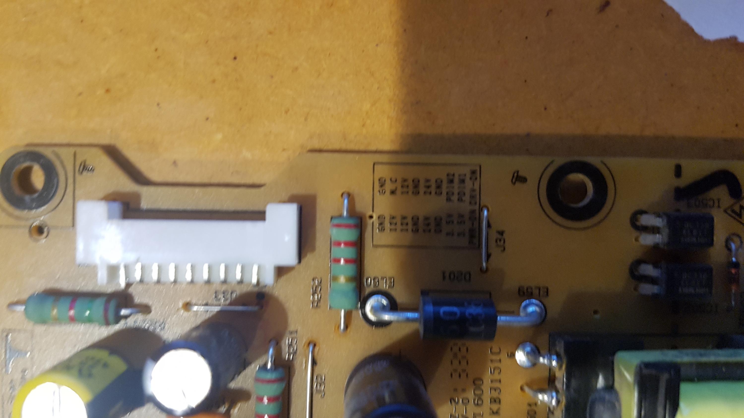

        I have tested the diodes with the multi meter. D255 and 256 seemed to have current both ways, but when snipped on one side out of the circuit they were fine.

                So the second fuse (F101?), the white body with purple stripes, right next to the main filter cap is OK?

                    That cannot be right, one end of that fuses is connected to the positive leg of the main filter cap which you indicated to have 365VDC between the two legs.
                    More likely you are using the wrong ground reference point for your meter, you are working in the hot side of the circuit so the negative leg of the main cap is the GND ref for the meter.
                    But the fuse is OK due to the fact that you are getting the same Voltage readings on both ends of the fuse.
                    You now need to look into the standby power section next.

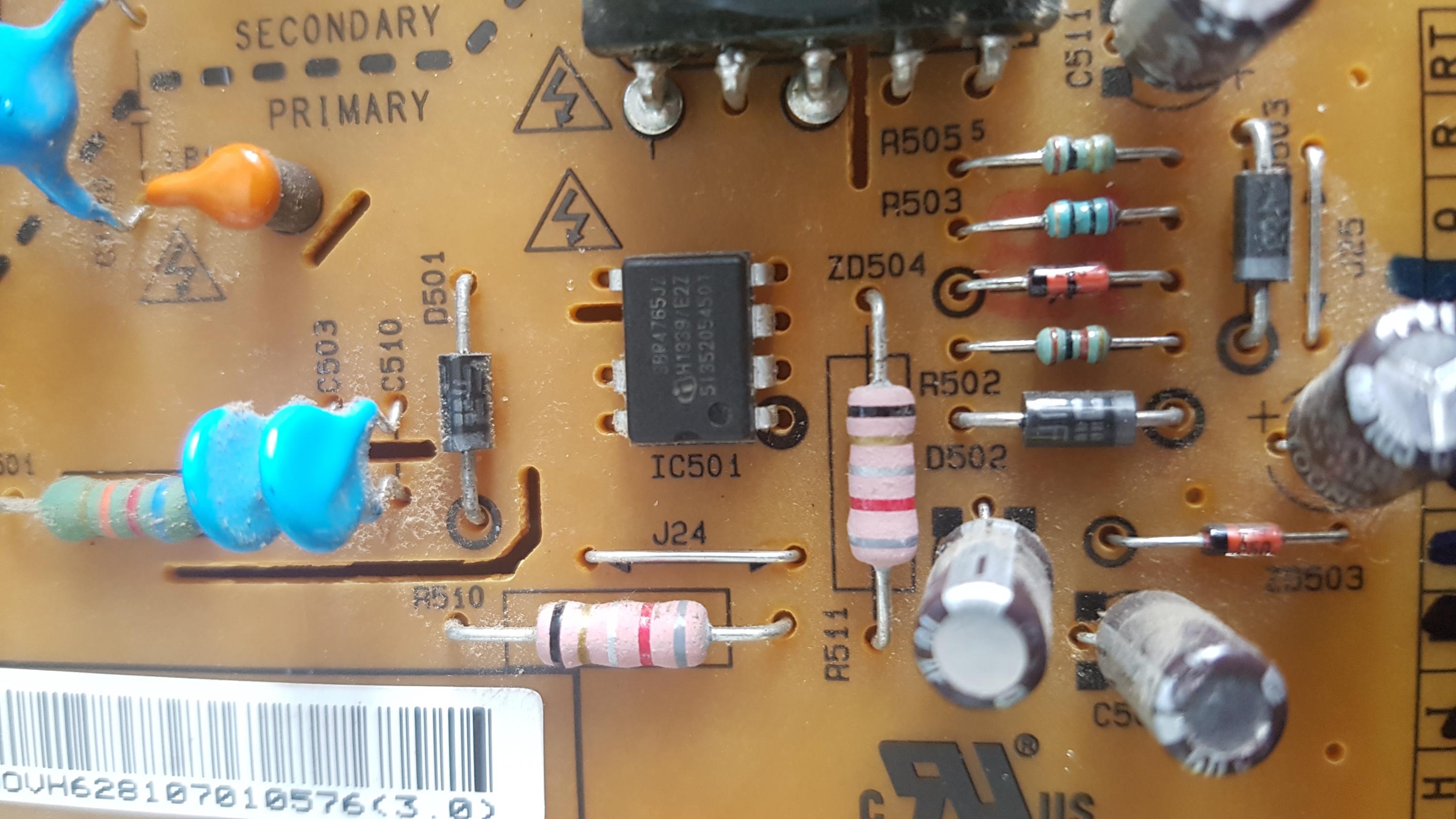

                    Need to get the P/N of that SMPS IC501 for the standby power supply, there are 3 small startup/running caps that need to be checked.
                    Also check 510, R511: they should read < 1 Ohms.

                        The number to use is ICE3BR4765JZ

                          I was getting some strange readings from my old DMM for the resistors so bought a new one, hence some of the readings are different to previous posts. I suspect one of the leads was no good on the old one and it affected the readings.
                          R510 ansd R511 both measure 0.8 ohms.
                          I have checked all of the diodes with no issues at all. They all have current flow one way, and none the other. The 3 on the secondary side that appeared to have current both ways. I took out of the circuit to test and they are ok.
                          Both fuses have been checked for continuity, as well as checking voltage on both sides with power applied.
                          C610 has 318 V across it (new multimeter reads different to previous), as does the fuse F101
                          All of the capacitors on the Primary side have been taken out of the circuit and tested for capacitance. They are all ok. (perhaps i should have just replaced them given i took them out anyway)
                          IC501: with power on and using the negative leg of the main cap as a ground ref:
                          Pin 1 = 0
                          Pin 2 = 0
                          Pin 3 = 0
                          Pin 4 = 0
                          Pin 5 = 318V
                          Pin 7 = 1.8v
                          Pin 8 = GND
                          From the datasheet for this, it looks like Pin 7 (VCC) should be between 10 and 25V. Would this be where the problem is?

                            No power applied to the board then check the resistance between VCC pin and the GND pin of that SMPS IC.

                                12 PINS? There are only 6 pins for that ICE IC501 for the standby power supply.

                                    But any how, the 340K Ohms is very high so that is not the problem.
                                    At this point if you look at the application circuit diagram, it can be that the IC has bad startup cell to kick start the IC, usually once the IC get the kick start Voltage from the Startup cell, then the running VCC will be generated by the AUX winding of the transformer.
                                    So I would check the filter cap on the VCC pin, the Optpcoupler, the rectifier in the cold side, or it can be bad IC itself.
