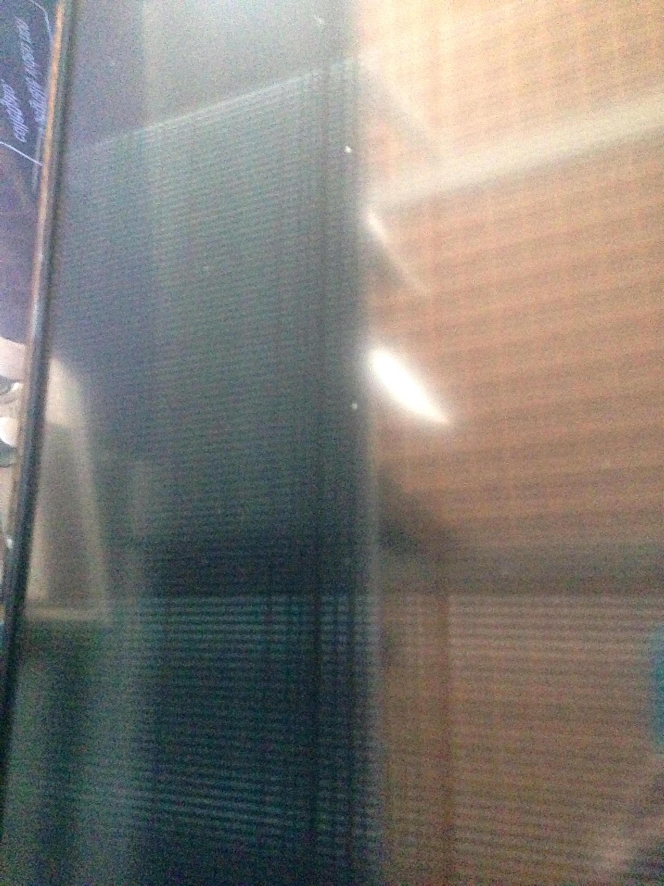

    i guess that it'a an easy question for you guys
    so the TV has no image but several thin horisontal lines (sorry for poor quality of picture). it doesn't show menu or change "image". sound ok
    i guess it's a T-Con board issue, just to be sure before buying one. Ribbons and cables are okay, tryed to clean them with rubber and alcohol. Thank you for help!

    T-CON Bds don't give horizontal lines when they fail. Your problem here is either a failing Main Bd of failed cables (Main Bd to T-CON Bd) Clean the cables with Isopropyl alcohol and make sure to re-seat them correctly.

      Tcon must be tested at least power supply tensions. No one can play at Bingo with only a partial picture..

        thanks for response! i have already cleaned the cables with no result. i'll try to replace them now.. hope it's not main board..
          i'll try it now. Thank you for response

            cables are ok, checked all pins. voltages arrive. found signs of overheating on the shield above the processor of t-con. quess i will try to change it

              Change the processor? Mmmh, i think rarely fails it..

                The T-CON processor usually gets a little hot. I don't think that is your problem, though.
