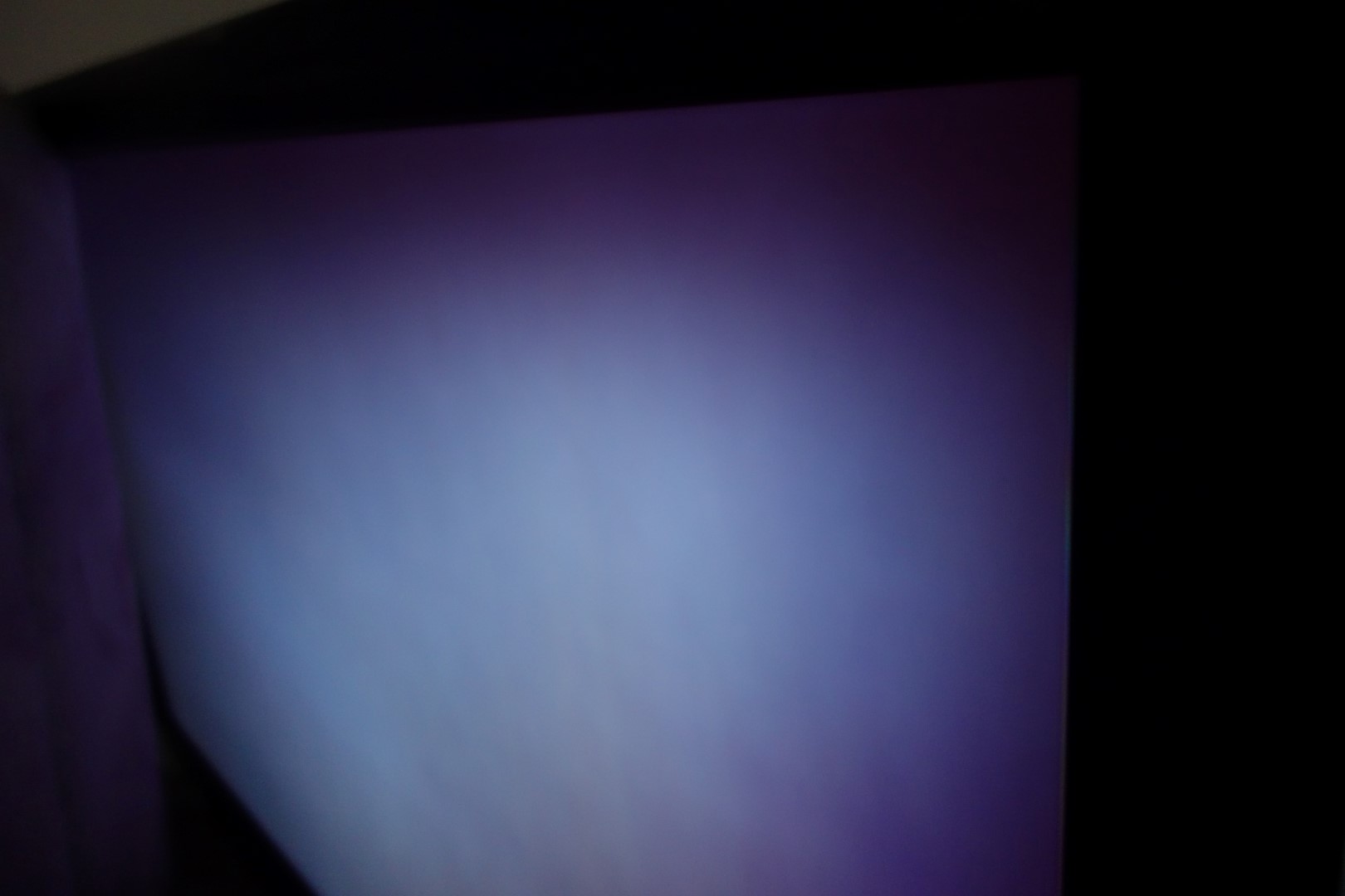

                  Checking the flash in a dark room shows mainly right and left edges lighting up more than the middle but not skewed to one side or the other.

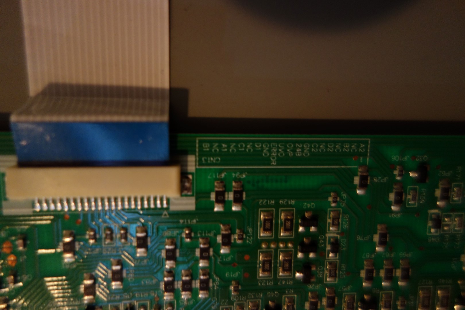

                      http://www.shopjimmy.com/philips-996...verter-kit.htm
                      I am having a hard time reading the labels for each pin of the inverter connectors.
                      Try looking to see the ERROR pin.

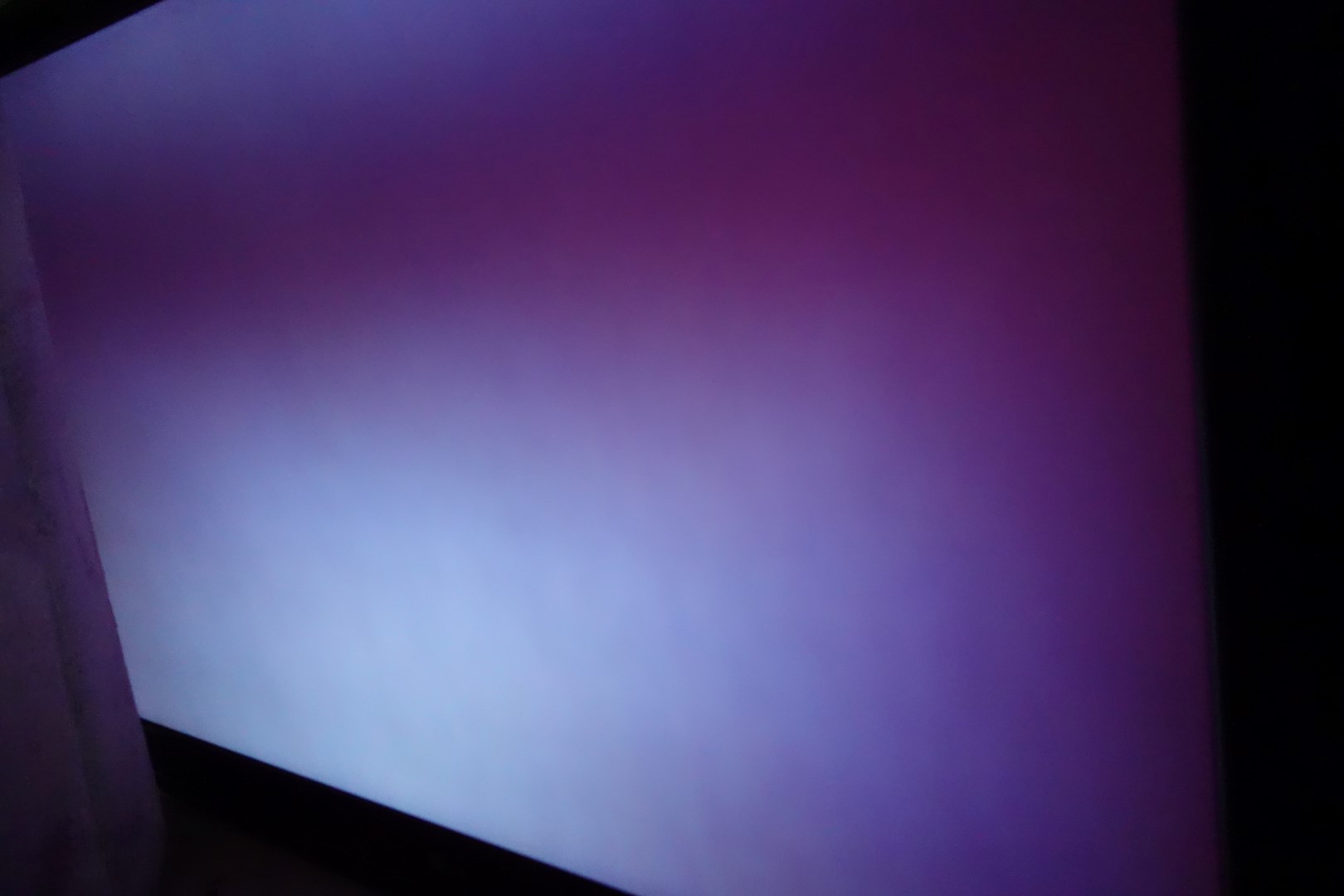

                        The screen doesn't display anything when the backlight cycles on. When it cycles off, the front red led flashes slowly.
                        The backlight does appear even. Will check for error pin next.

                            With the backlight on, the light does seem even with the naked eye but when I took a pic, it looks like there is a tube out which corresponds to the location of the blackened connector. If I take a picture from a higher angle, it is more even but think this is because of the diffuser.

                                        Googling shows it is a Chi-Mei panel with datasheet here http://www.datasheetspdf.com/PDF/V470H1-L03/842007/1
                                        "When inverter protective function is triggered, ERR will pull low"
                                        There are two ERROR signals - one on the flex connector from the slave and the second going to the PS board (measured 0V before=abnormal).
                                        I re-checked the ERR signal on the PS board connector from the inverter. The TV cycles from flashing front red LED and dim blue on mode. With both small flex connected and disconnected, the ERR signal is 3.3V in the on state and 0V in the off state which seems to point to the bulbs being ok.
