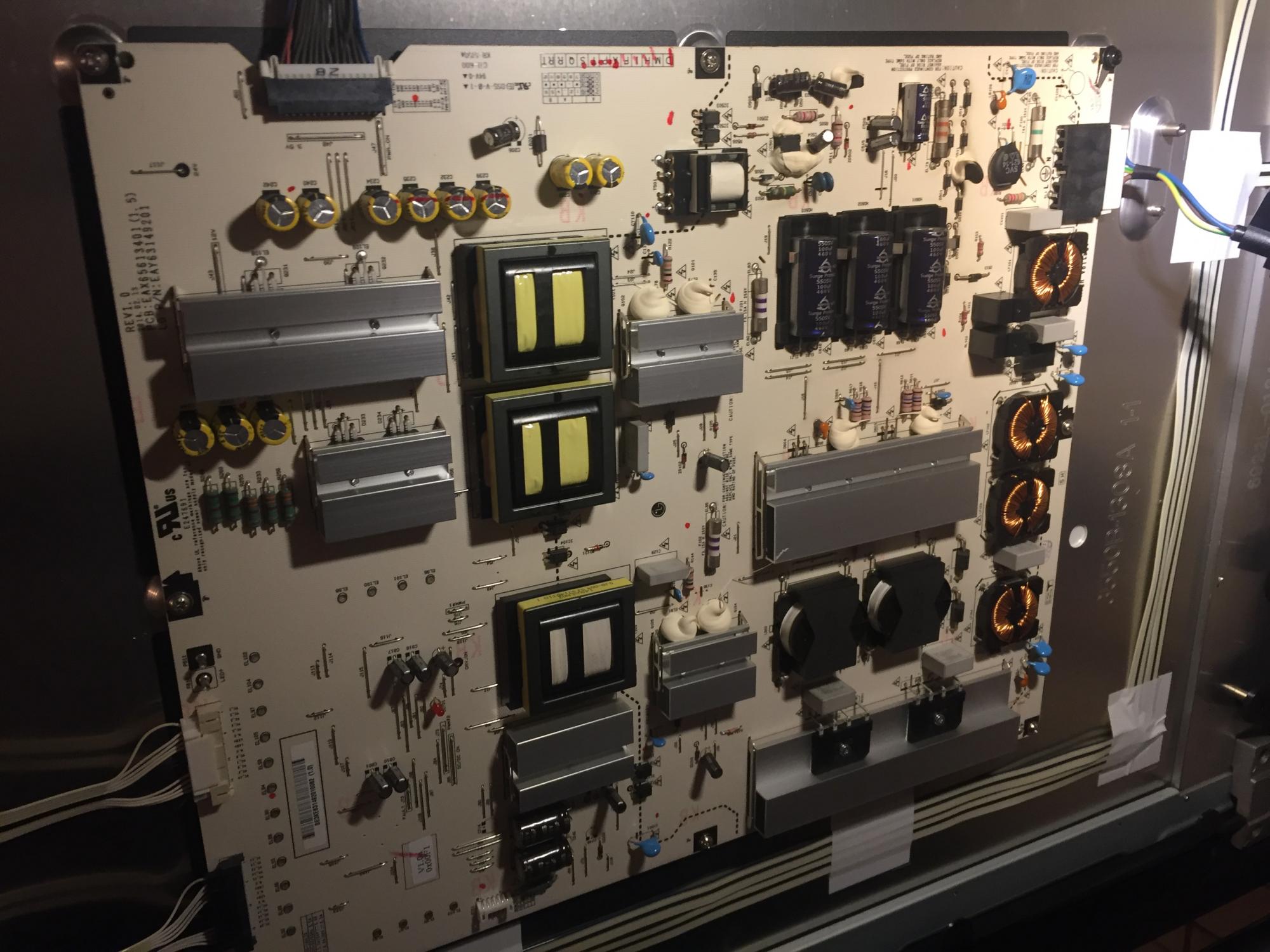

                                      Re: LG 79UB9800 heat problem
                                      Should I be concerned? let the tech change the condenser? anyways I've attached the power supply pic. , if it doesn't have resistors or maybe anything odd that can be seen (I know that's unlikely).
                                        The 450v capacitors can't be because them are not connected to ground, the cap before the bridge are low capacity, them aren't, to feel a current with the hand the metal must be at high potential, i think more than 40v, so only the 100v cap for the backlight can be, but them can discharge to the leds probably, so i think the voltage come from antenna or if is not connected i don't know... need schematic..
