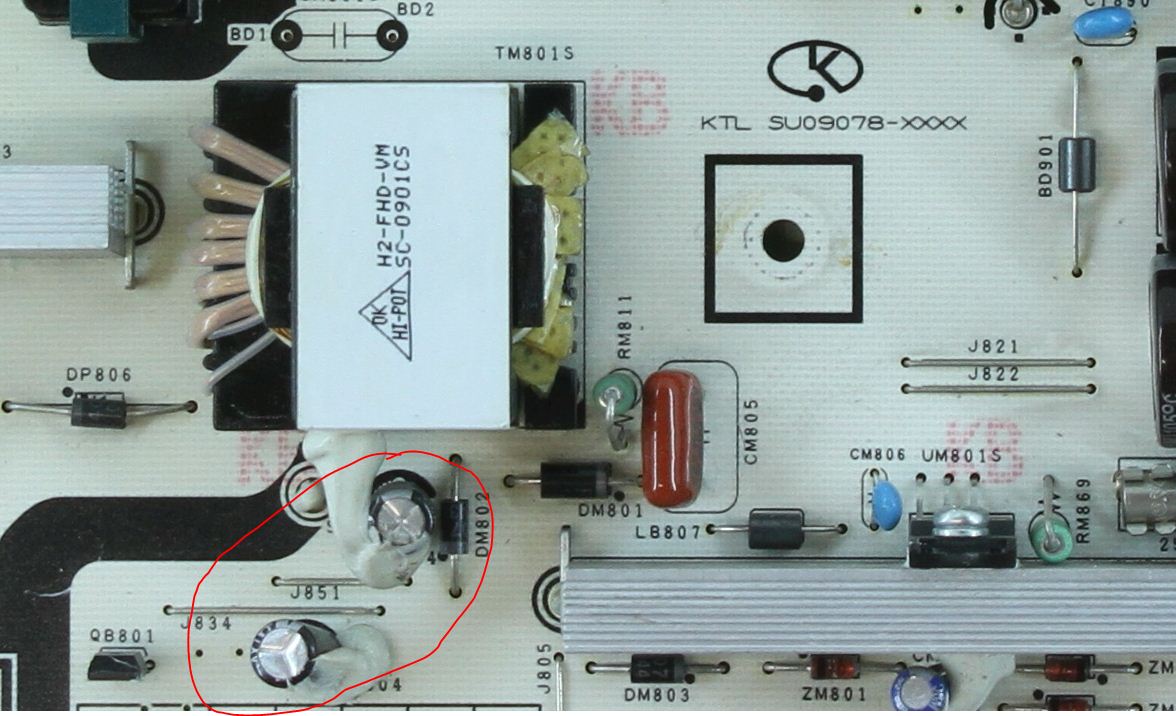

              Are you confident to measure the voltage accross these caps? You can attach the negative probe to the heatsink in the hot side and with the red probe try to touch the positive leg (if you can) of these capacitors.
              These caps are connected to the lines which feed the main driver of the nearby transformer. They must have a steady 9-15V.

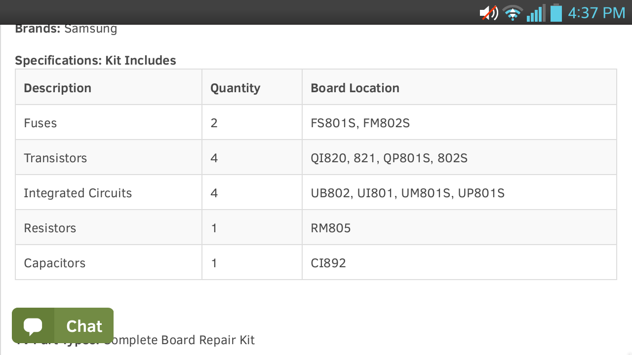

                They dont give the part numbers. We will have to do some research on a board we may have laying around.

                  This is what I bought and the power board seems to be working but just won't hold standby voltage. I'm comfortable testing anything senndogg, I'll be home in 15 minutes to give you the results
                  http://www.shopjimmy.com/samsung-bn4...repair-kit.htm

                      Senndogg I've pulled these caps and put them in a tester and they're good at least.
                      With TV functioning properly -
                      cb804 0v
                      Cm804 17.6v
                      In failed standby -
                      Cb804 0v
                      Cm804 4.4
                                part numbers are on the components and on the bags each component comes in for my kit? I dont believe its the shop jimmy kit though... I can post the part numbers after work if you still need them?
                                EDIT* I have this kit myself.. http://www.ebay.com/itm/Samsung-BN44...72.m2749.l2649
