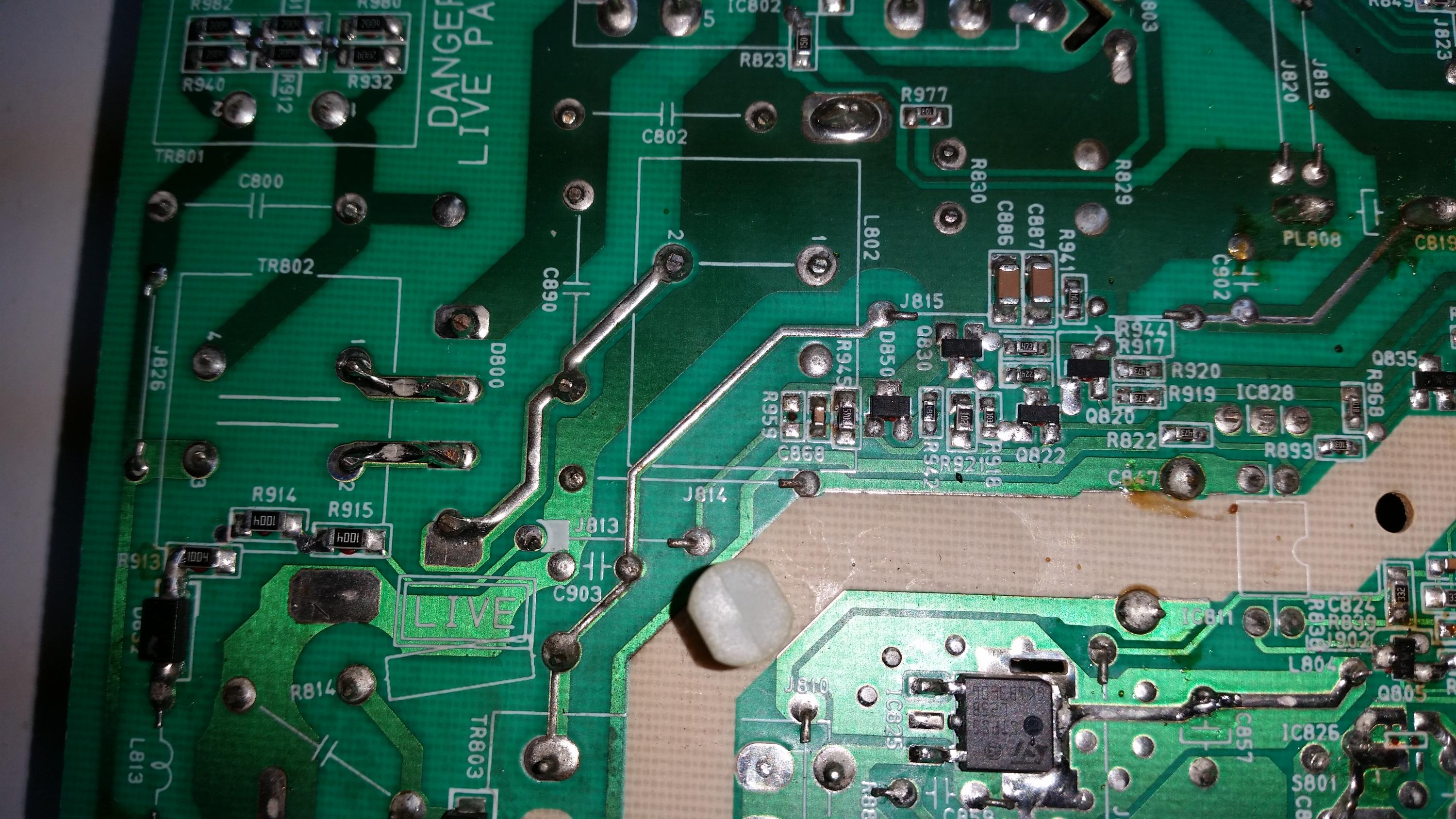

    Hi guys

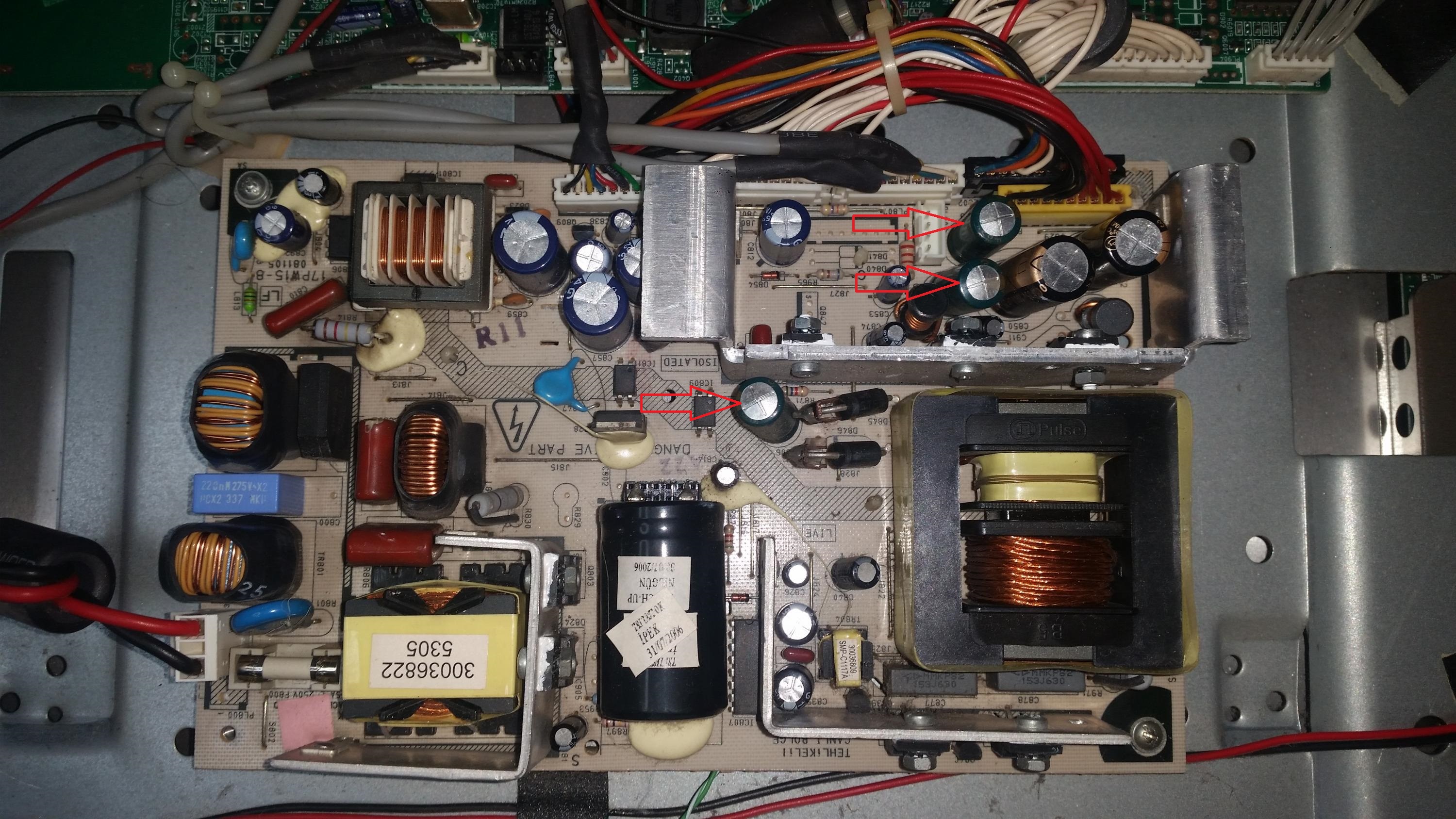

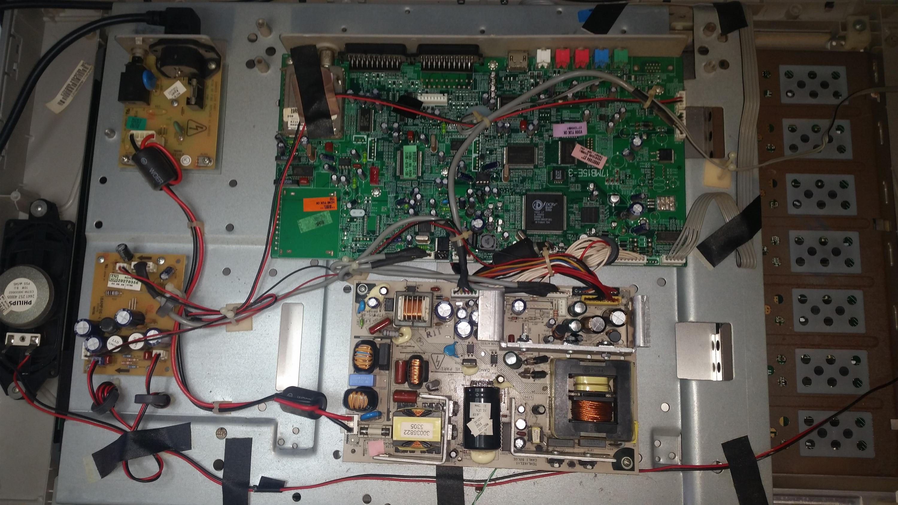

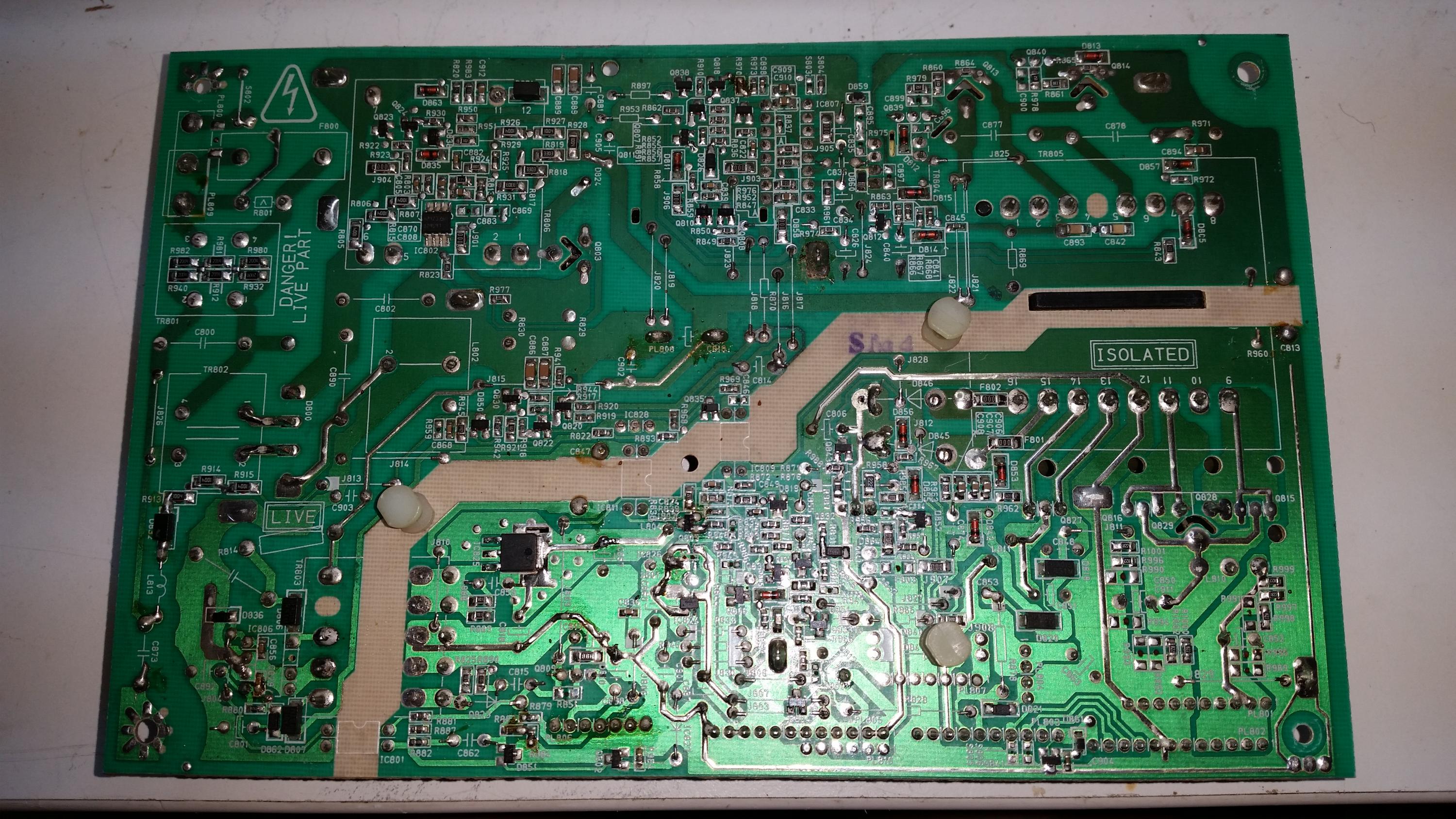

    Here's a brand I've not seen before, It is dead, no power at all.
    The 2.5A mains fuse on the PSU board had blown (vapourised/blackened inside) but the 3.15A mains fuse near the IEC power connector is fine.
    Had a poke round first with the Fluke - no obvious short circuits anywhere on power devices, rectifiers or PSU outputs. No distressed or visibly blown components other than teh 2.5A fuse
    I fitted a new fuse and powered up via a light bulb current limiter
    Nothing - dead - no power drawn (light bulb does not even flicker)
    However the main electrolytic is charging up to about 320V. It slowly discharges on power off (there are high value bleed resistors across it)

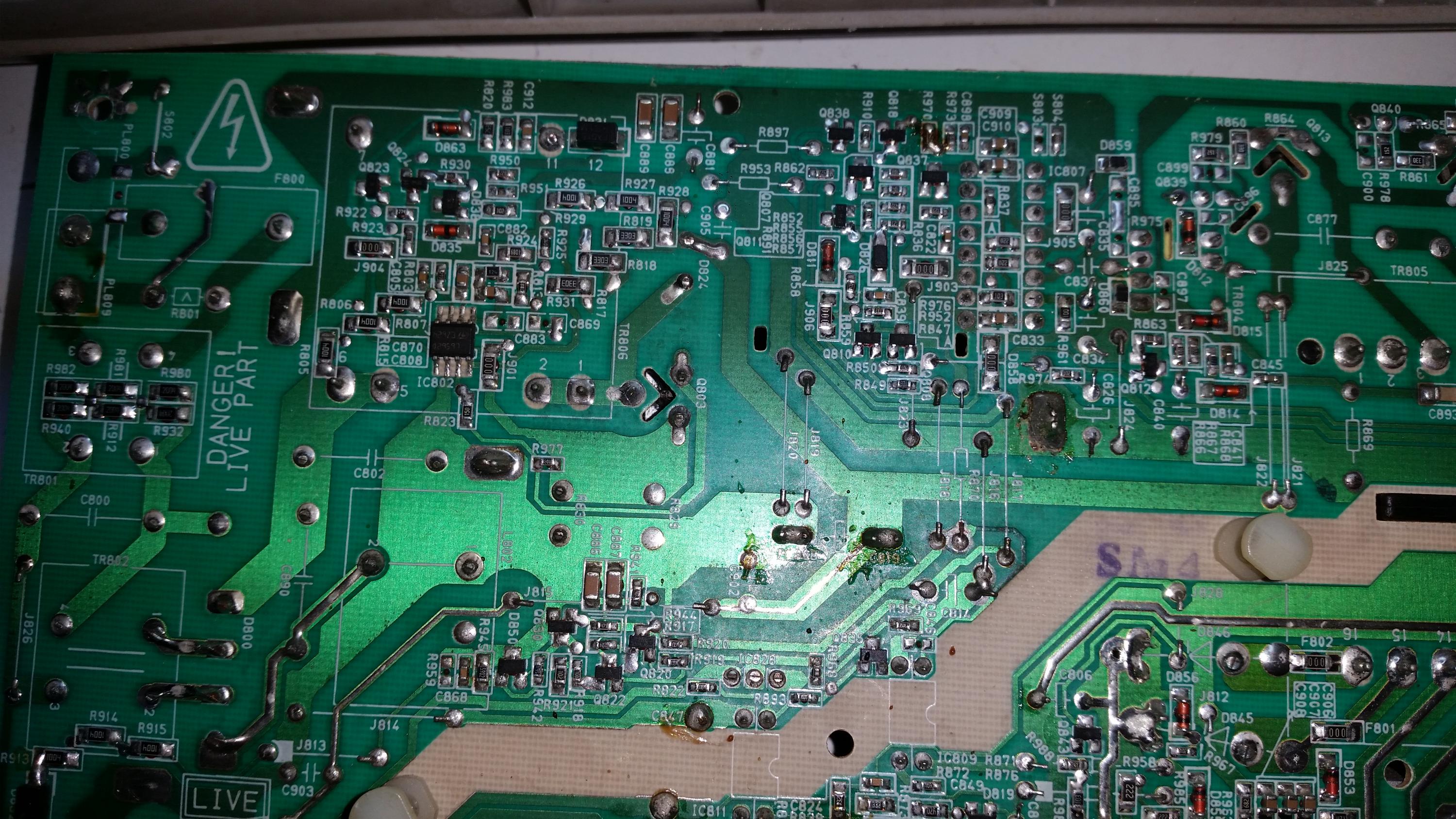

    Having had a look around the PSU it seems to have the following architecture/layout which has three main sections
    I added some pretty clear pics of each of these sections so the description should be easy to follow

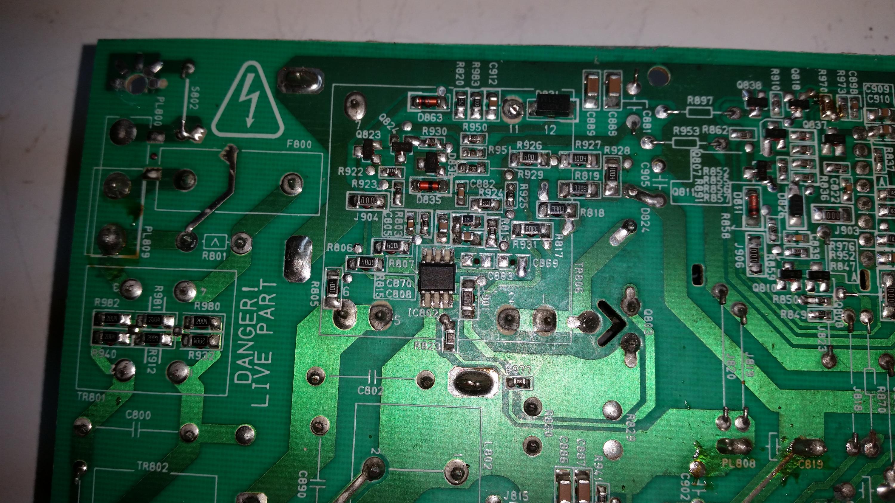

    There is a PFC section controlled by an LD6562D (IC802)
    The LD6562D has no Vcc supply on pin 8 so obviously it can't start up. The Vcc supply comes via a LM317 (IC828) - the LM317 input pin comes from the main electrolytic +ve and the adj pin is controlled via an opto-isolator. There is no voltage output from the LM317. My guess is it needs a signal from the isolated side of the PSU via the opto-isolator to turn on the power to the LD6562D and start up PFC but it's just a guess.
    The main SMPS is controlled by IC807 which is an SG3525A https://cdn.badcaps-static.com/pdfs/...7c28cd62f5.pdf
    Again the SG3525 has no Vcc power on Pin 15 so it can't start up. In this case pin 15 is connected via some low value resistors to what is probably the emitter of Q822. There also is an electrolytic from this pin to ground and it is not short. Q822 is part of a little circuit with three transistors and a diode D850. D850 gets power from the mains via D832 and 3x 1M0 resistors in series R913/R914/R915. I checked the circuit as far as D850 - the diodes and resistors all measure OK. Is this a 'startup' supply for the SG3525? I'm not sure. There is also another opto-isolator around here but I didn't trace out exactly how it connects.

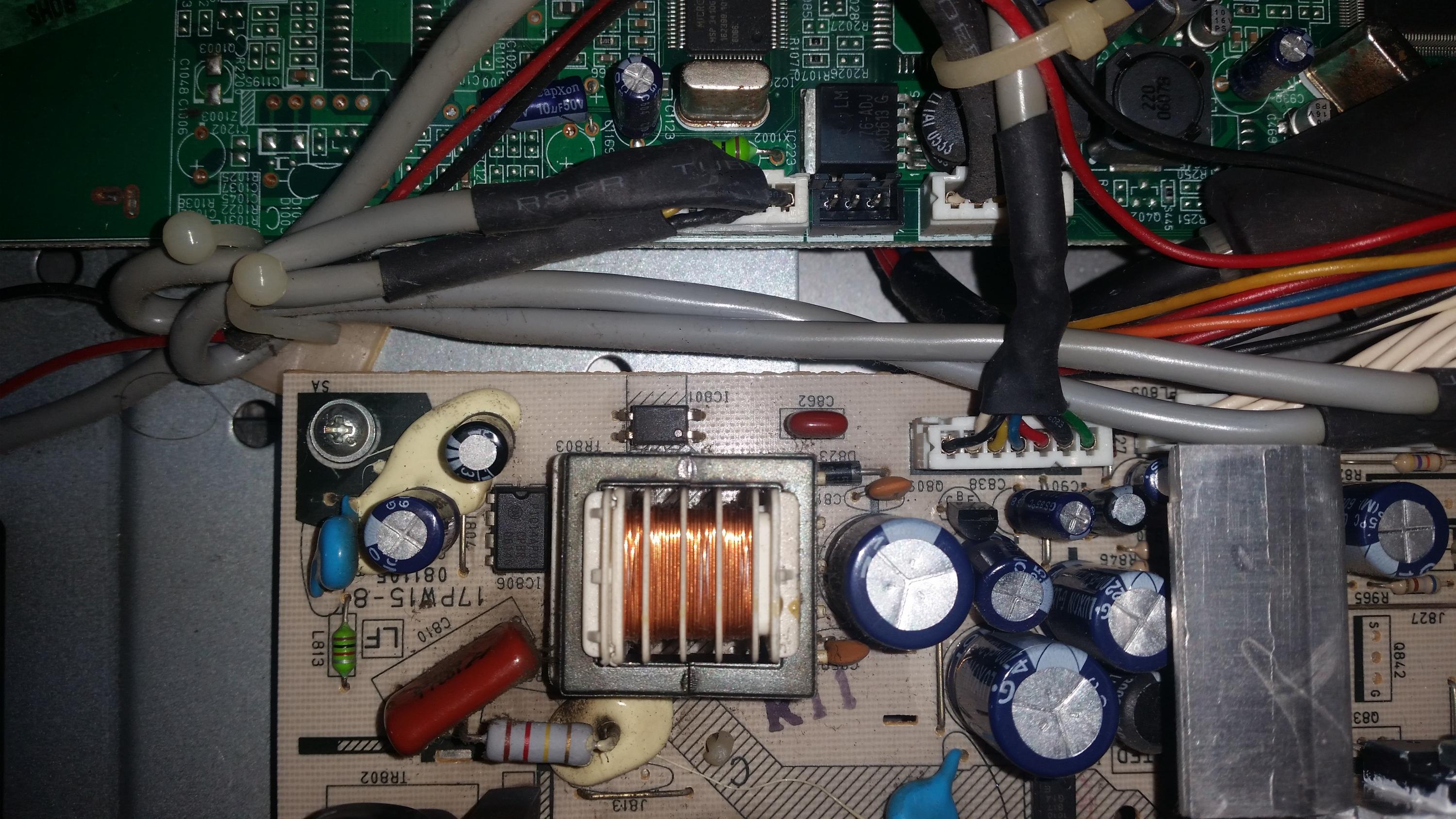

    Lastly there is a standby supply controlled by an NCP1014 (IC806).
    In this case there is no output voltage from the secondary of the standby supply which powers some part of the isolated side of the PSU. There is no voltage on Pin 1 of IC806 (Vcc) though there is voltage on pin 5 (Drain) as it goes direct to the +ve end of the main smoothing cap. As I understand the datasheet the NCP1014 should just 'work' and generates it's own Vcc from the high voltage on pin 5 drain). There is no short or low resistance from Pin 1 to ground - in fact it reads several megohm. There is yet another optoisolator on pin 4 IC806 controlled from the isolated side of the supply
    My best guess is either:
    The IC806 chip has failed (though the is no sign of visible distress) which means there is no standby voltage therefore the PFC and main section of the SMPS can't power up?
    Or alternatively there is some problem with what looks like it could be a startup supply for the SG3525A (R913/4/5, D850 and the three associated SMD transistors)?
    But I have no experience with this type power supply, it seems a bit over complex to me.
    Anyone have a schematic? (wouldn't that that nice!)
    Or someone have some experience of this or similar PSU designs and know at how the three sections are dependant on each other and in what order the three sections should power up?

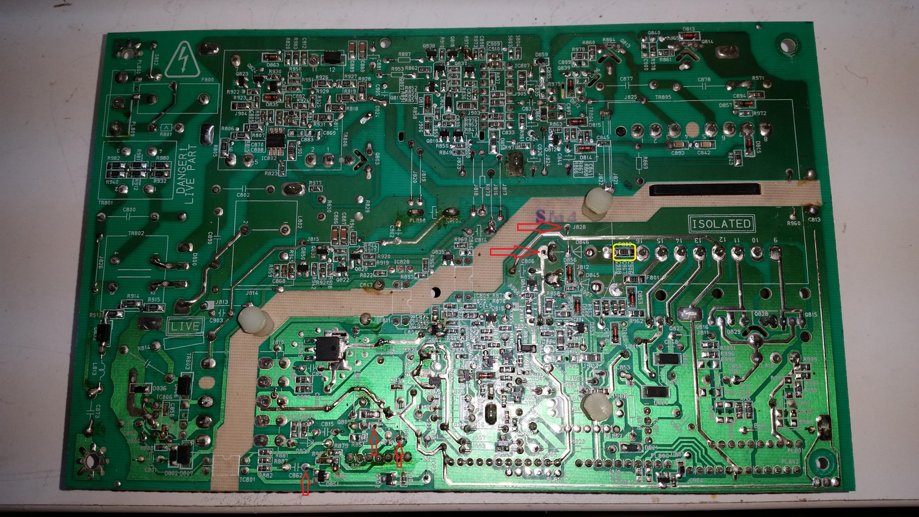

      This looks as though it's been worked on and the solder joints are in a poor state and need to be soldered again.
      The capacitors at the secondary output look as though they have started to vent, curved tops and need to be changed.
      Also check the fuse highlighted in the yellow box on bottom of power supply.
      Finally check the two 1nf 630V capacitors C842 & C893 in the above schematic for value and physical damage.
      However thinking about this, a fuse blows when it's overloaded so I would remove the blown fuse and measure the resistance between one side of the fuse holder and hot ground and then the other side of the fuse holder and hot ground.

        I checked the 630V caps and resoldered the joints (though they looked OK on the actual board). I did spot the bulging caps on the secondaries but as the PSU does not even try to starts up I don't think these are the initial problem, if you don't mind me saying, though they do need changing.
        Resistance from the 2.5A fuse to hot ground is over 3M0. Whatever overloaded/vaporised!! the fuse, there is no obvious short now on the hot side nor on the secondaries
        The attached schematic looks similar the PSU board I have but with some variations eg:
        IC806 is a TNY266, mine has a NCP1014
        IC802 is a IRF7314, mine has LD6562D which is quite a different device!
        IC807 is a SG2525A mine is a SG3525A
        I know the NCP1014 (IC806) isn't working (I have no STBY power) and I think the chip may be faulty as it has no Vcc on pin1 which is internally generated from the 400V rail and mine isn't doing that. Maybe the internal power MosFET in NCP1014 failed which is what blew the fuse amd now the NCP1014 is effectively open circuit hence no Vcc?
        I don't think I can get any further until I have STBY working.
        I'm just waiting on the owner to accept my quote. If he does I am tempted to connect my bench supply to the +3.3V STBY and + 12V_2 rails. The schematic shows 5V STBY is generated from 12V_2 by Q809 and my PSU seems to have much the same layout in this respect.
        Then I could see if the rest of the PSU will then run once I supply the STBY voltages externally.
        I only have a single rail bench supply here at the moment (my bigger dual variable + 5V lab supply is still in the UK due to weight) but it wouldn't be much effort to lash up a fixed 3.3V 1A regulator, with my bench supply set to 12V
        Can you see any problems with trying that? If it worked then I know the problem is with IC806 (NCP1014) or it's associated components
        Rich

          What DC voltage do you have across the legs of the largest capacitor (C819)? Did you check Q803 for short circuit?
          Still wondering why the fuse blew and blackened is a very high current short circuit normally.

            Most regulators have a maximum input voltage they can safely operate on and still regulate so you need to make certain that whatever 3V3, 1 Amp regulator you use will operate with a 12V supply if that was your thought.
              321V across C819
              Q803 is not short
              Yes that is what I had in mind - connect 0V to cold ground, 12V supply to cathode D823 and use a fixed regulator to give 3.3V supply to cathode IC825
              Hadn't thought about max Voltage input to 3.3V regulator but thanks for mentioning it. I have some KIA278R33 in my goodies box.
              http://pdf1.alldatasheet.com/datashe...KIA278R33.html
              Quite handy regulators really, 15V max Vin, 2A max Iout and 15W Ptot if I strap it to a heat sink. That should do the job I would think though I would have to check the current but I'll bet STBY load does not draw a lot.
              The intention being to see if the PSU will fire up (with a 100W bulb limiter just in case) once I have STBY power, thus narrowing down the fault to IC806 and associated components.
              If I had my dual bench supply it would be easier but I am used to improvising when I have to.

                OK the owner did decide to get this fixed
                I tried powering +3.3V STBY and 12V_2 from my bench supply
                The 3.3V STBY only draws 120mA so the 3.3V regulator worked fine without getting too hot
                I then looked around with my DVM and I do now have +12V_2, +3.3V STBY and +5V STBY but the PSU still does not want to power up, I get 320V across the main electrolytic but nothing is running in the PFC or main SMPS transformer sections.
                I had a look further and can see that VCC_3V3_ON coming out of IC824 is only reading 0.9V so something isn't right. It looks like Q806 needs to be off for VCC_3V3_ON to present, which means +5V needs to be present to turn on Q843
                I'm still not sure exactly in what sequence this SMPS is supposed to power up. Anyway I just spotted I can get a used working replacement PSU off ebay for less than £20 so I don't think it's worth spending any more of my time on this one, unless it is for 'educational purposes' if anyone else has some good ideas worth a try.

                  "I then looked around with my DVM and I do now have +12V_2, +3.3V STBY and +5V STBY but the PSU still does not want to power up, I get 320V across the main electrolytic but nothing is running in the PFC or main SMPS transformer sections." That is because the PFC IC gets the Voltage for the AUX winding of the STBY transformer power supply, since the STBY supply is not running right now then you need to inject the required Voltage for the PFC IC to run. The other SMPS IC also use the same Voltage from the AUX winding of STBY Transformer to run also.
                  If I were you I will fix the STBY power supply section first.

                    Thanks budm - I see that now. I spotted VF_MAIN was generated from the aux winding on STBY transformer to power the STBY power supply chip but I hadn't realised that VF_MAIN also generates VCC1 and VCC2 via the LM317 (IC828).
                    At least I think the LM317 is generating VCC1.... but the arrow is the other way round on the schematic??
                    But I cant' see anywhere else VCC1 is coming from, just that it supplies the main SMPS controller chip IC807 and VCC2 powers IC802 (which by the way on my power supply is a PFC control IC type LD6562D, not a IRF7314 dual FET as show in this schematic!)

                      VCC1 & VCC2 is the LM317T regulators output voltage generated by the regulators input voltage VF_Main and switched on by control signal On/Off
