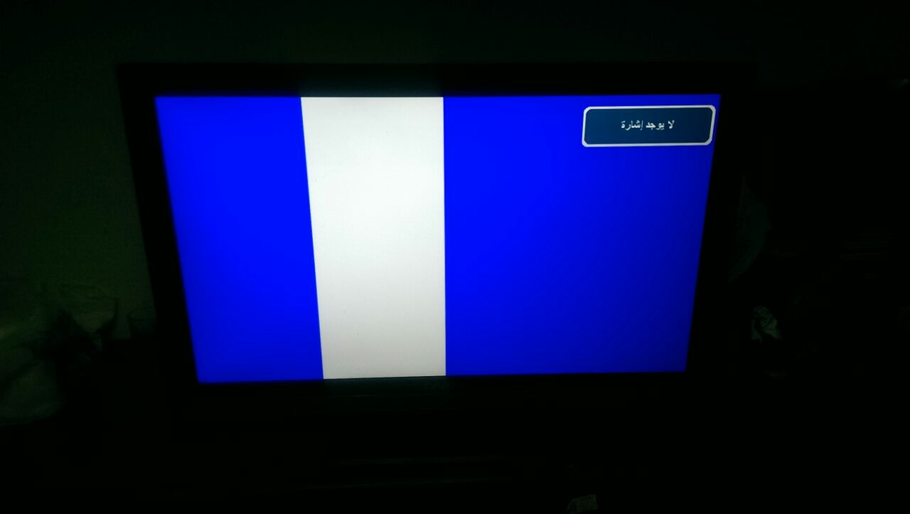

    Dear sir,
    i have TV LED 32 inch with Main board No: MST6M182VG-T9B
    the LCD has white rectangle i cleaned the TCON cables connected to the LED display but the problem persists

    Re: Tcl32d99
    Most likely bad panel.

      Re: Tcl32d99
      you need tab bonding machine to repair this fault.
