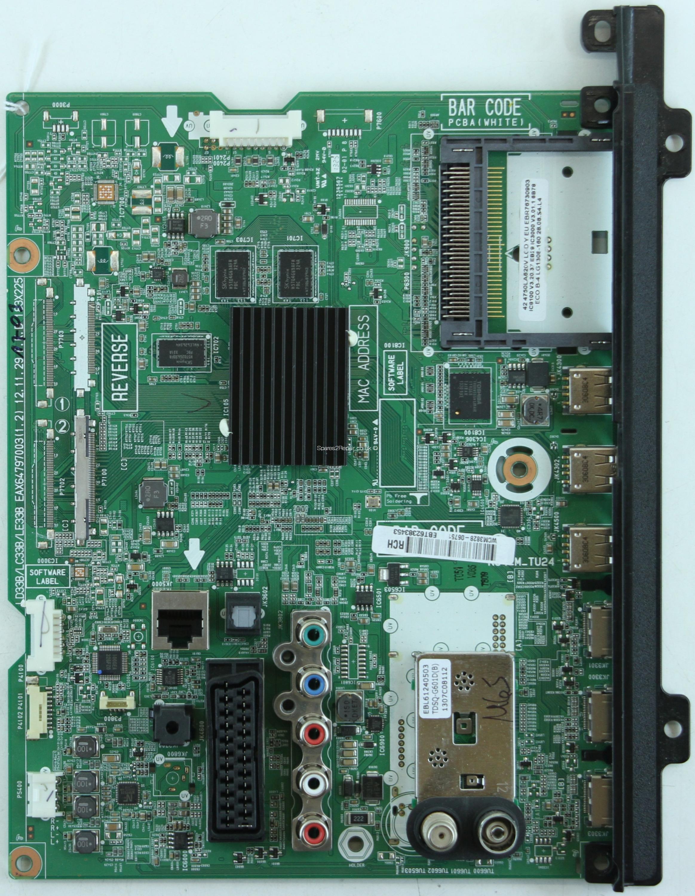

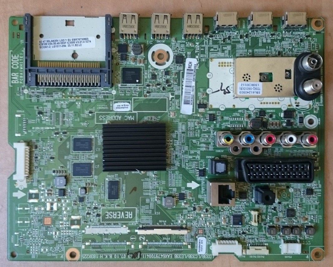

    Any LG experts out there who could advise me. How do you identify LG mainboards as a suitable replacement when the one for your set is not available.
    For example I was recently looking at an LG42LA620V-ZA with board details:-
    EBT62383453
    EBR76730903
    EAX64797004 (1.1) 13.07.10 B.K.H. 183X225
    LD33B/LC33B/LE33B
    However there were mainboards available for an LG 42LN578V board details:-
    EBT62383453
    EBR76730903
    EAX64797006 (1.2)
    And also for an Model LG 50LA620V board details:-
    EBT62383453
    EBR76730903
    EAX64797003(1.2)
    LD33B/LC33B/LE33B
    Do you go by EBT, EBR, EAX numbers or all must match?

    No expert, but.
    Here i believe go by EBT, EAX will be the board pcb but if it's laid out the same , move on. A quick search shows EBT62383453 fitted to 42 - 50 " models (LG LA620V )
    The EBR numbers are showing the same .
    Obviously some aspects will be different like the eeprom data which holds the Model, serial and runtime.
    You can simply copy that and re-write the new board eeprom. Always save the originals files just in case it goes belly up.
    probably need more time to analyse 42LN578 board, some imagery would be helpful on your part.

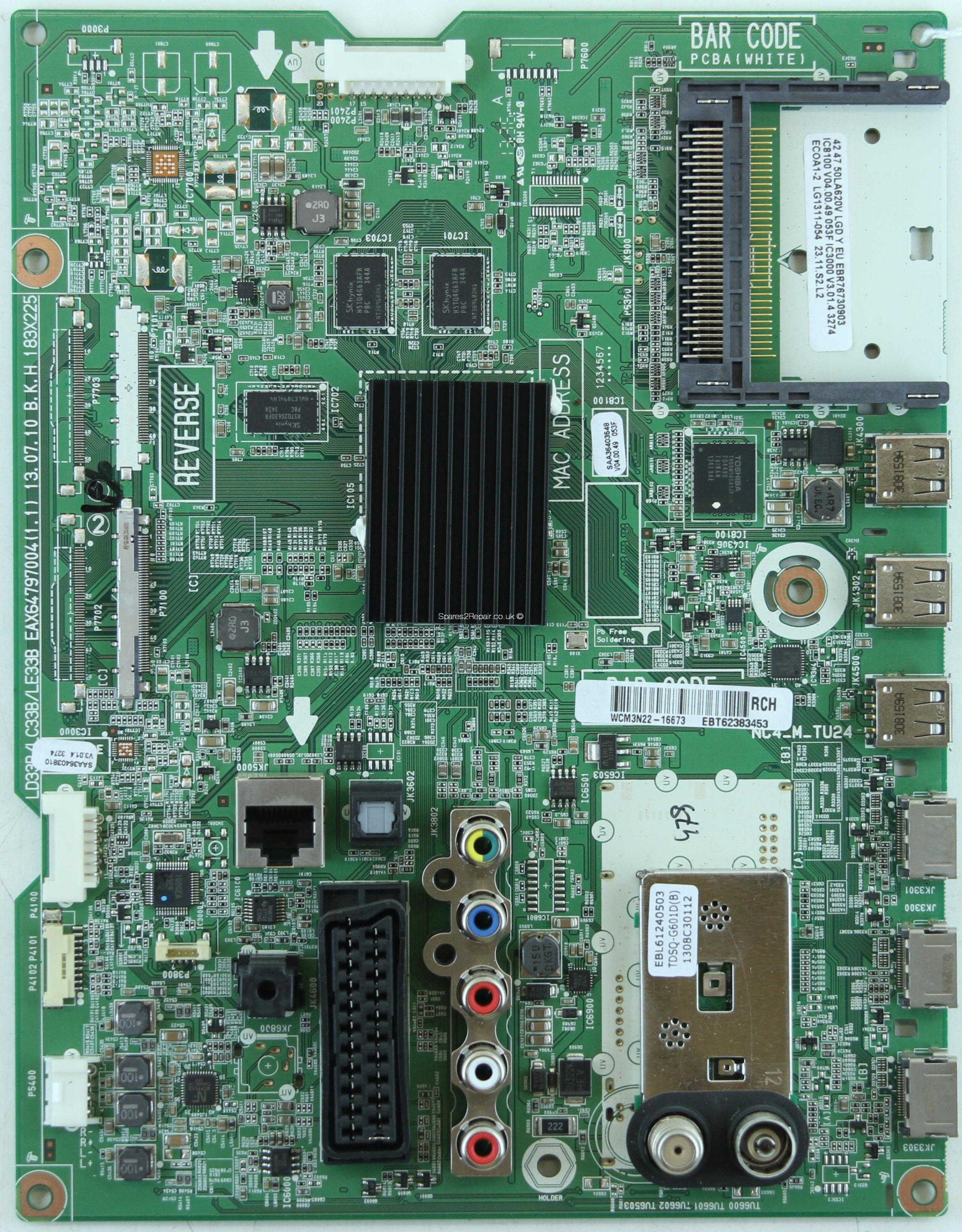

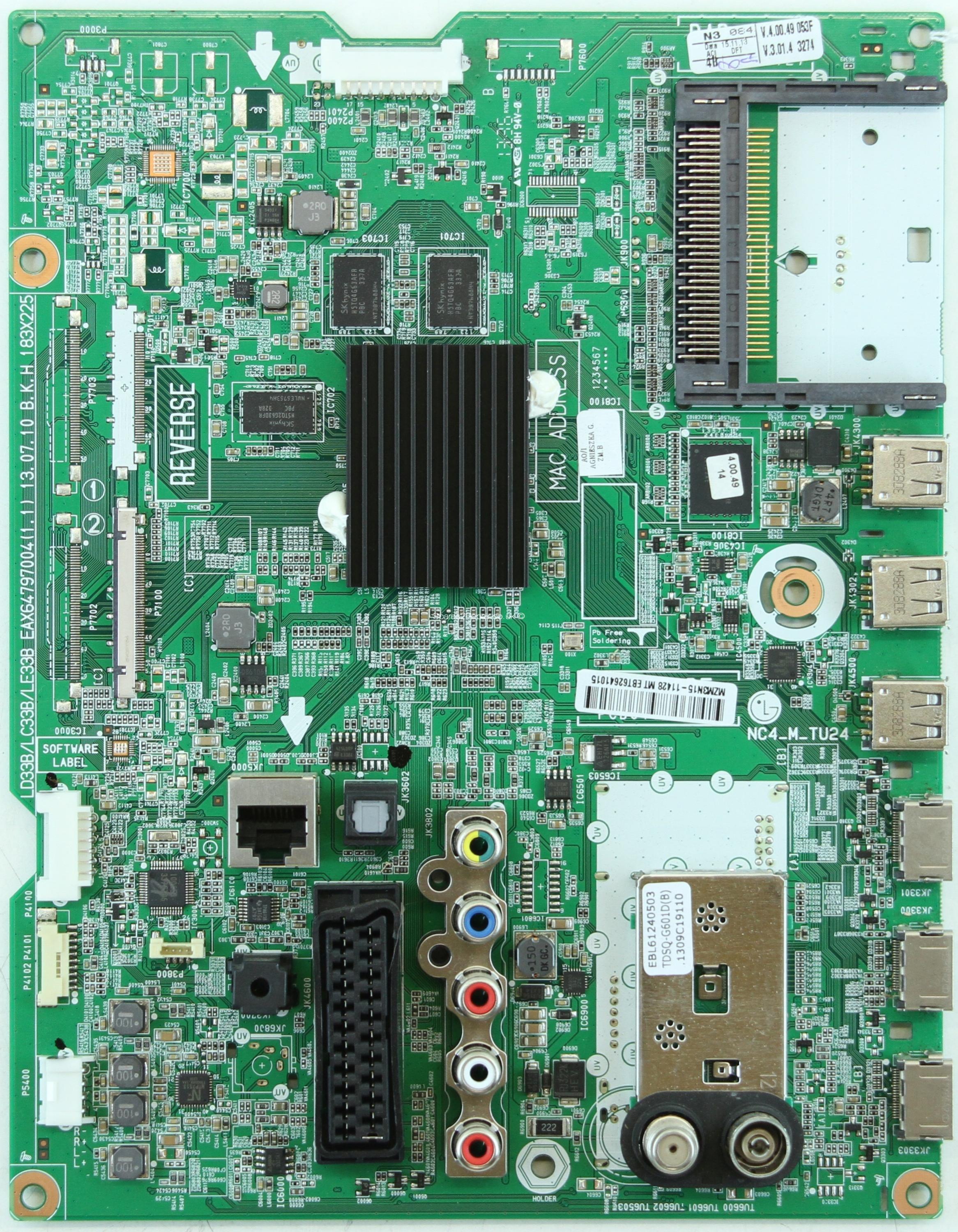

      Thanks for your reply which is appreciated. I'll find some photo's of the different mainboards and add them on.
      Edit
      To me they all look identical although I would agree that the information within the Flash IC's would be different.

                        The EBR number for the 42LA620V was EBR76730903
                        So it looks like you have to match both the EBR and EBT numbers exactly when substituting.
                        I don't have the set now since the person realised they had a 5 year warranty on it still running.
                        However trying to work out the correct substitution of LG boards is still useful to know.

                          I was thinking EBT, anyway all three have the same EBT and EBR yet look at th eRev of the data on those chips. There is a firmware upgrade so I bet once applied they'sd all end up the same. Chances are any of those boards would operate it and then you could like i've said copy or edit some data to correct the model and serial
