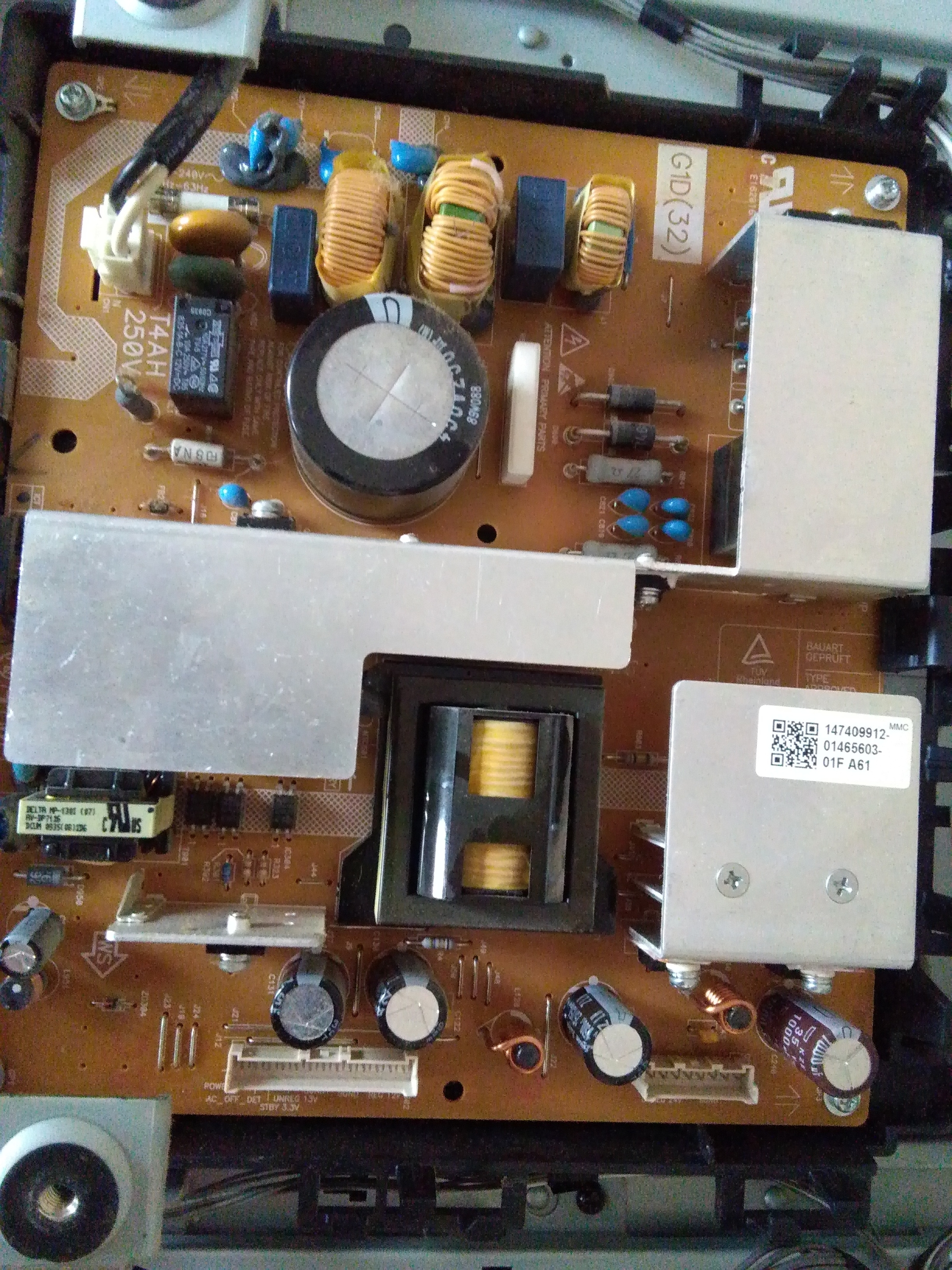

buddy sent me a sony with he four blink error code...couldn't find any info on it...wondering if its like a 32l4000....well i crack it open an check it out...if anyone has any info ...thanks...
Sony Bravia LCD KDL-32L4010 four blink error code

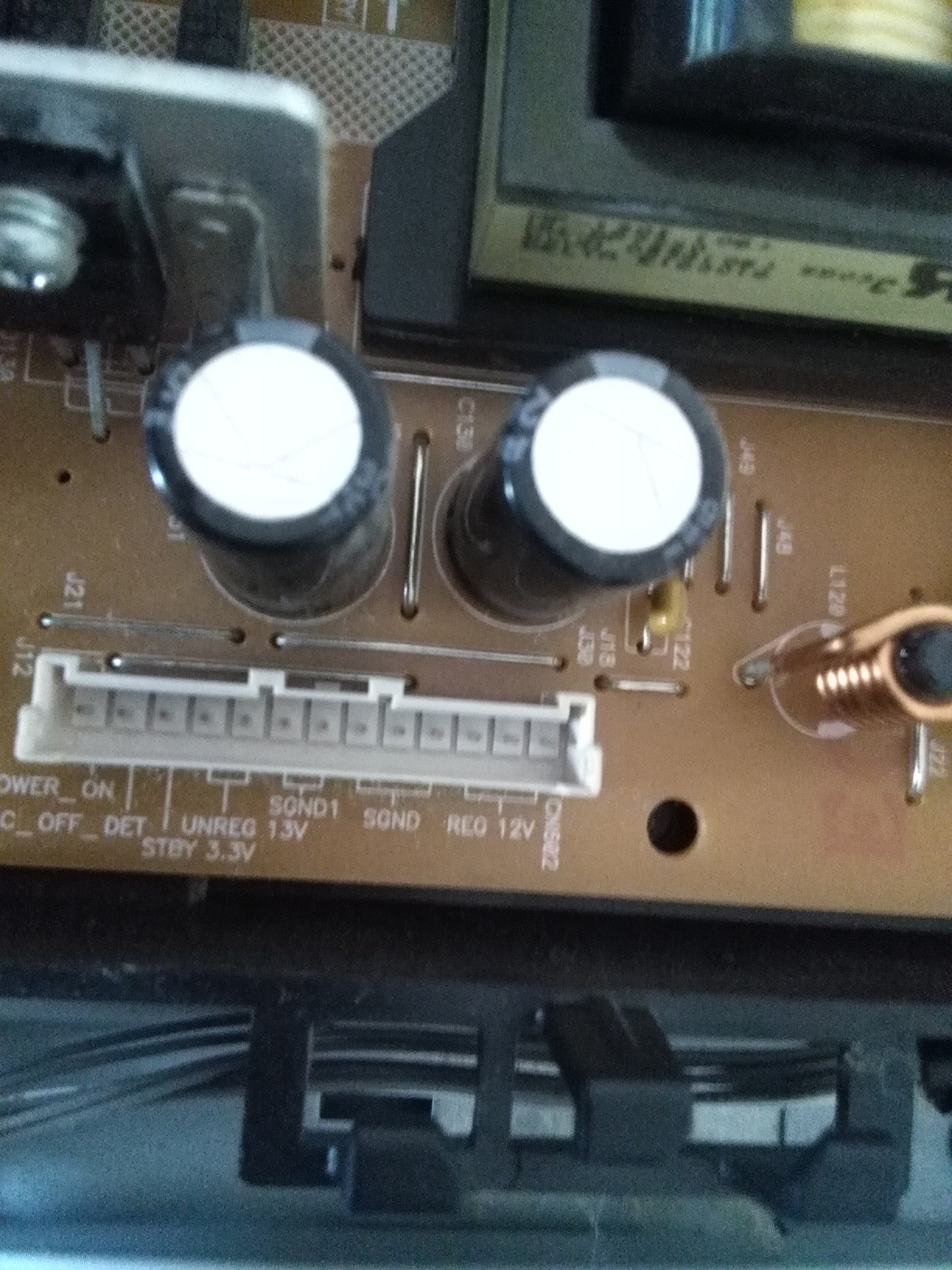

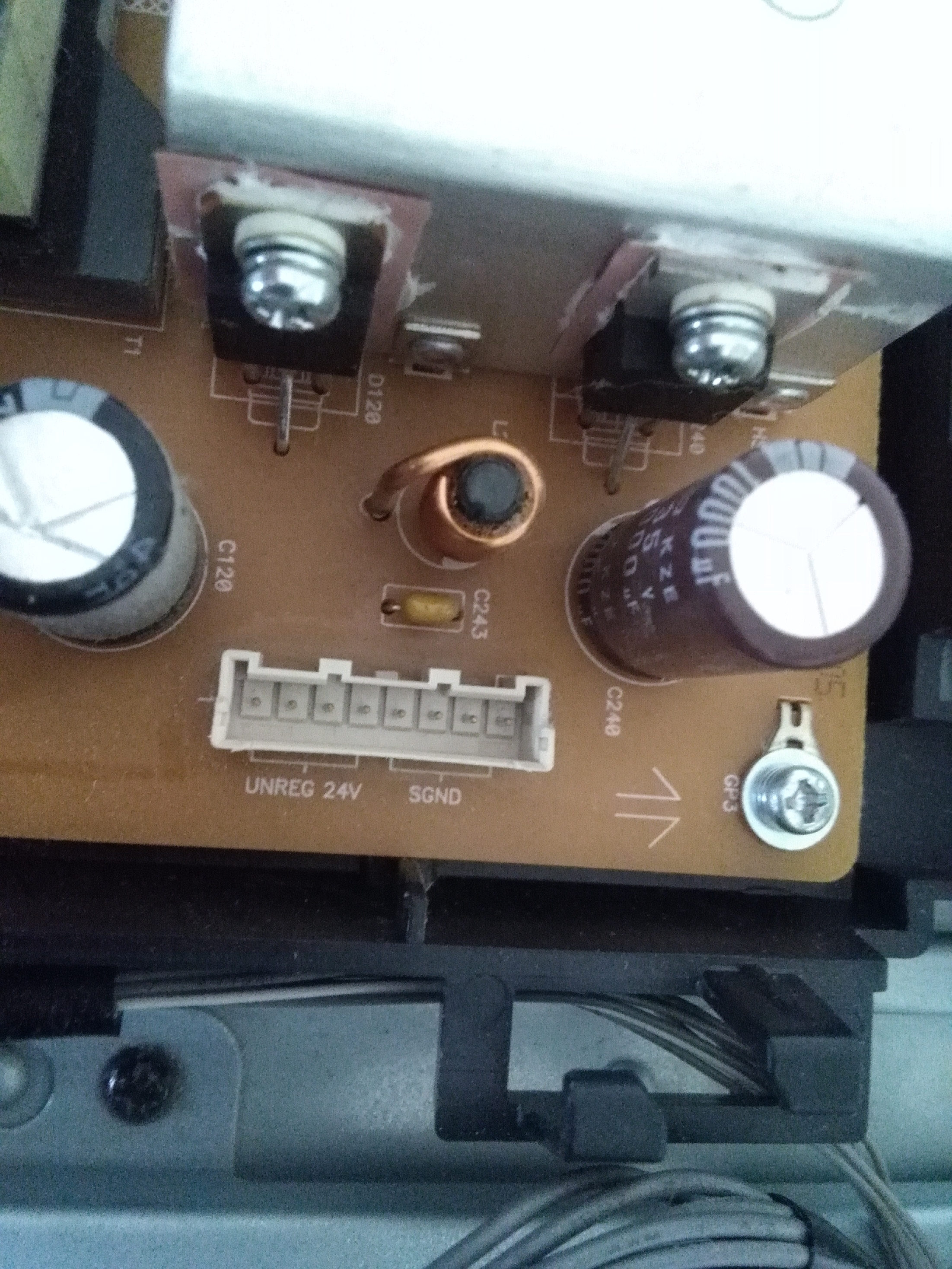

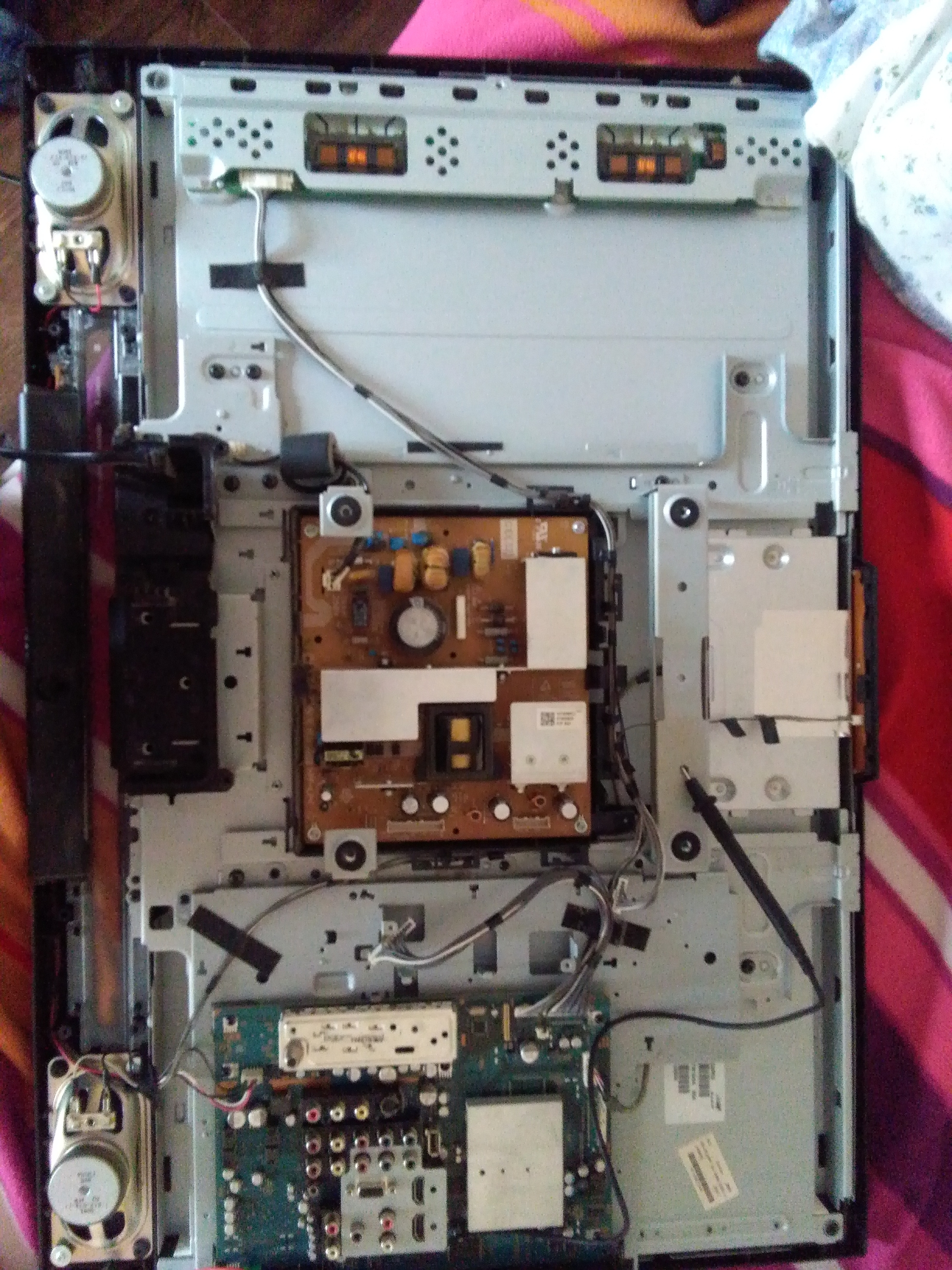

Without any voltage readings it's hard to tell what the fault is. Do you have any photo's of your boards.
You could try freezing the EEprom on the mainboard and then switch on in case it's a problem with that ICWilling to help but I'm no expert.
Re: Sony Bravia LCD KDL-32L4010 four blink error code
Per service manual this model does not use error code so that blinking light is not error code.

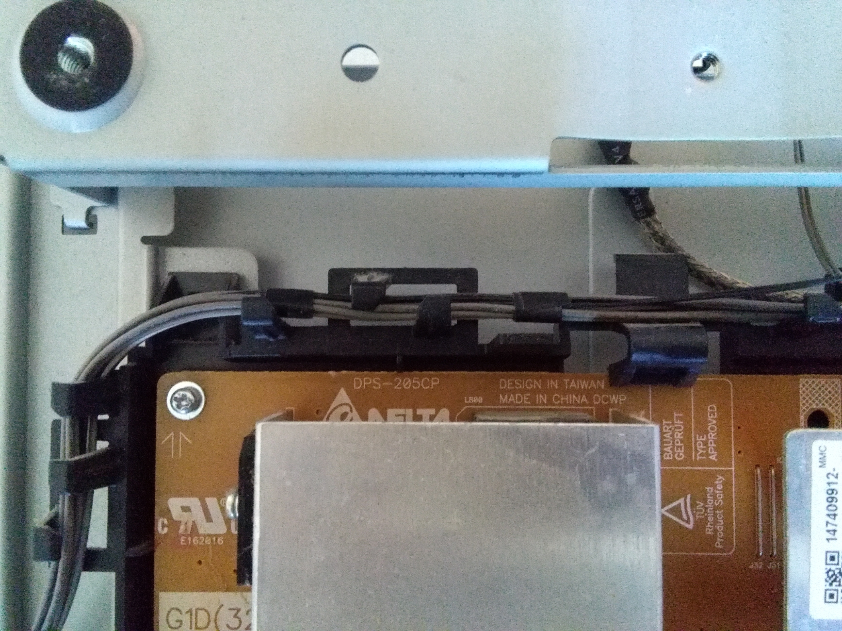

We need pictures of the whole backside of the TV showing all the boards and pictures of each board.Last edited by budm; 10-08-2017, 04:38 PM.Never stop learning

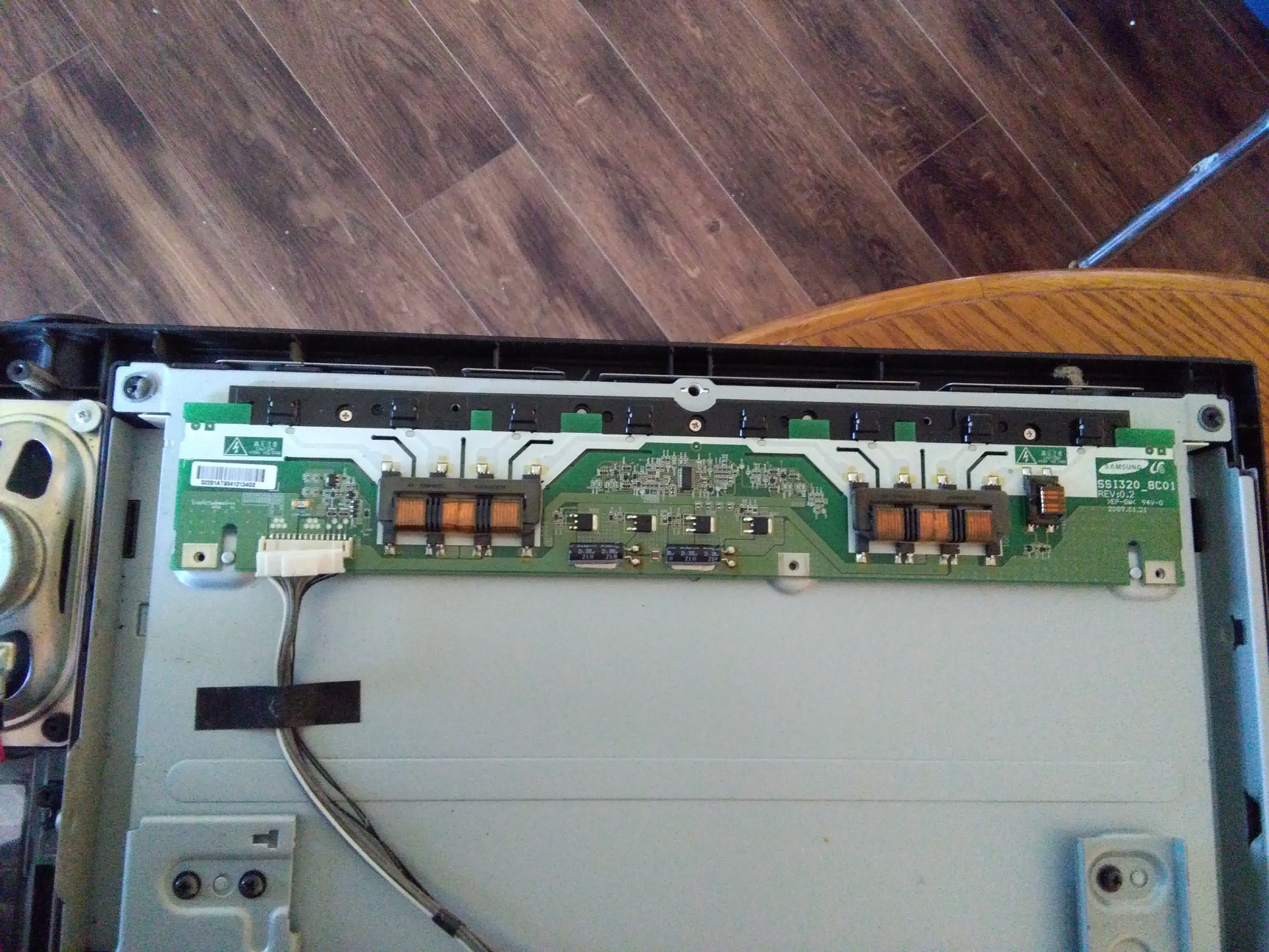

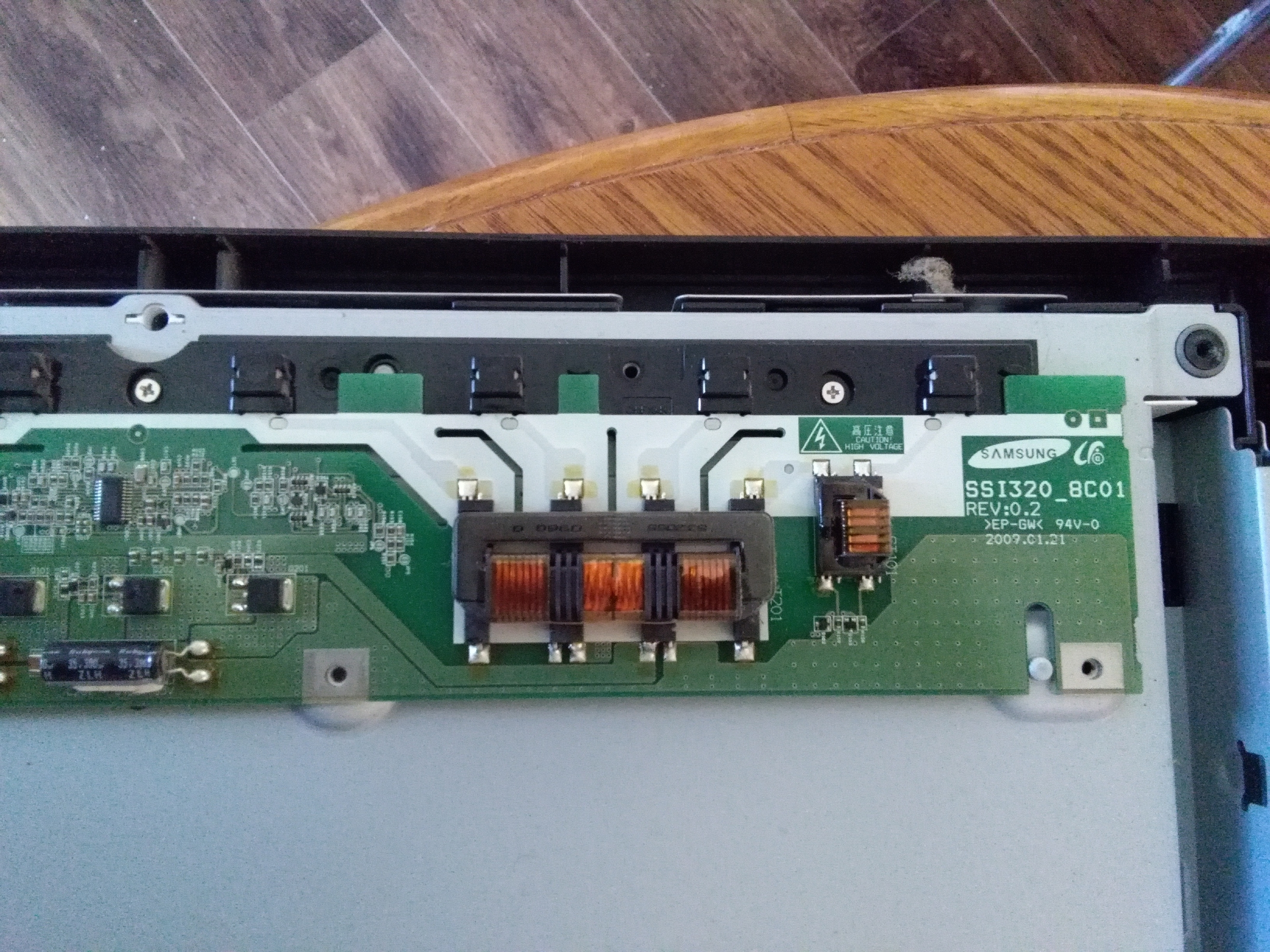

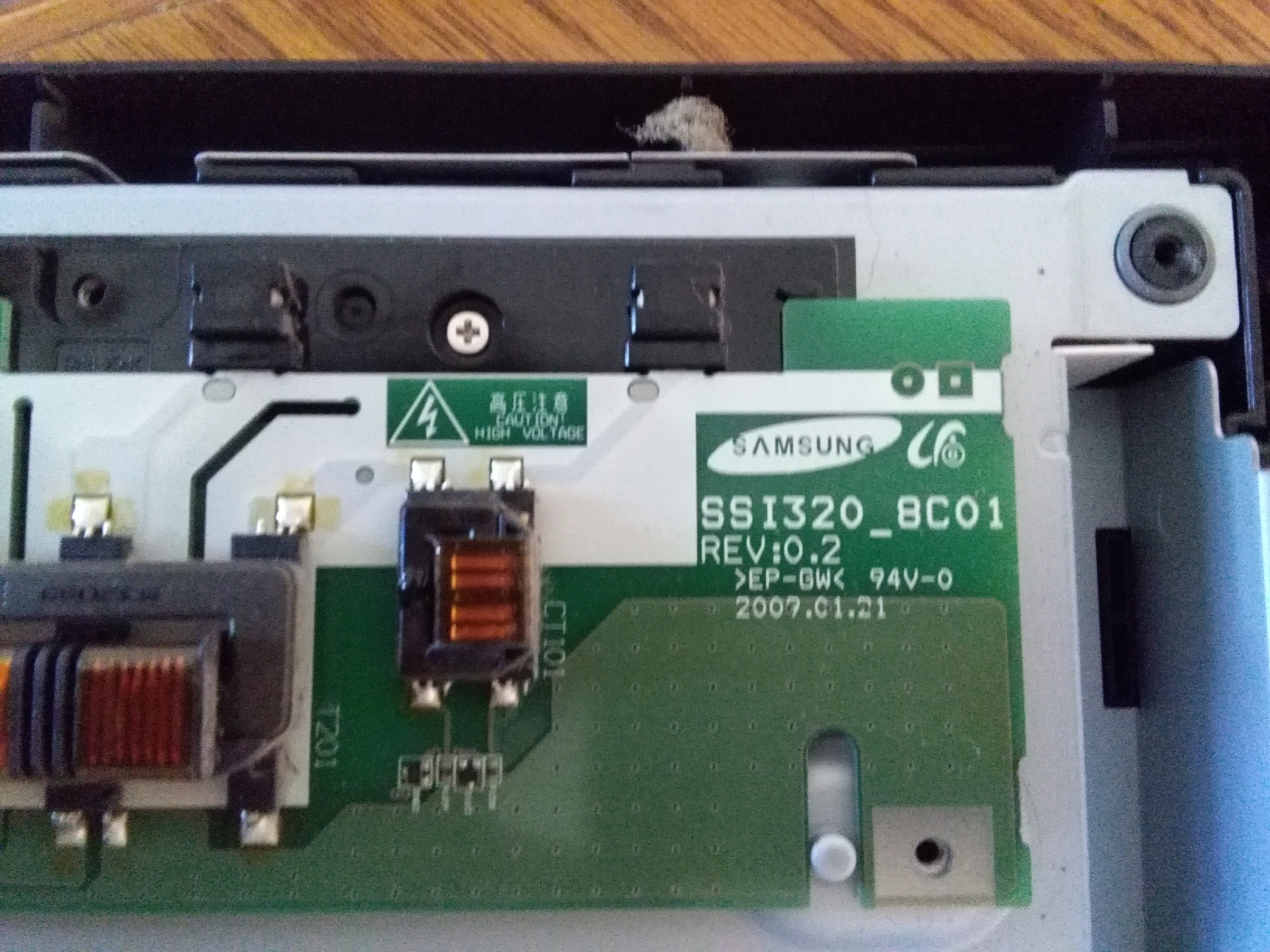

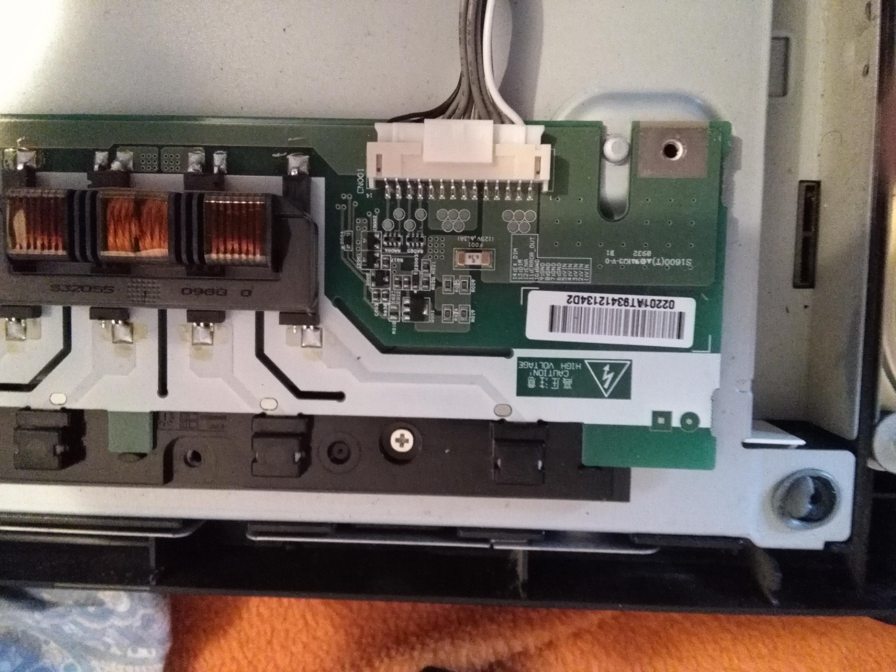

It looks like Samsung LCD panel and Samsung Inverter board.Never stop learning
There should be labels for the control signal pins on that inverter board connector: BL-ON (INV-ON), DIM, PWM-DIM.
See what DC Volt you get on those pin, I assume you do get the 24VDC.Never stop learning

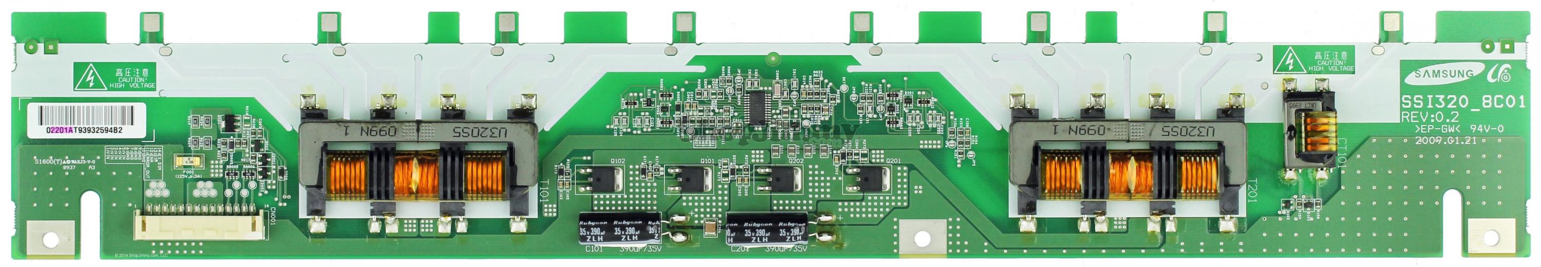

SSI320_8C01 (Sony 1-857-518-11 (LJ97-02201A) Backlight Inverter)
http://www.shopjimmy.com/sony-1-857-...-inverter.htm#
Pictures provided by shopjimmy.
I would check the resistance of the High Voltage windings of the Inveter transformers. Also check those two large lytics caps laying on its side.Last edited by budm; 10-13-2017, 09:14 AM.Never stop learning
