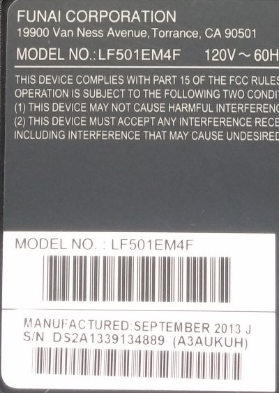

    Made by Funai:
    Power supply board S/N:
    Main board:
    Keypad:
    IR sensor board (Not photographed yet) has S/N BA3AU0G0203 1 __1.

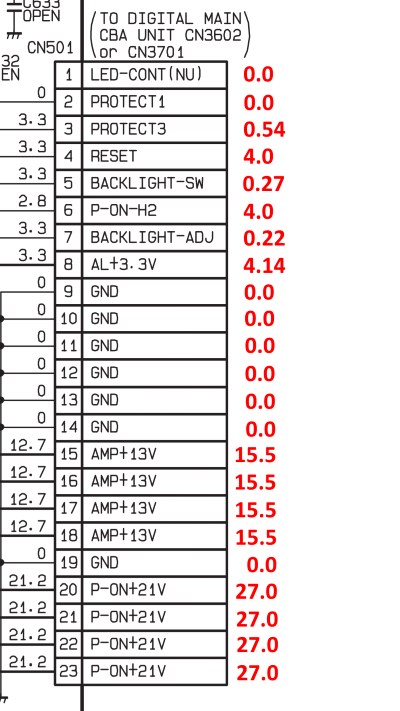

              Measurements:

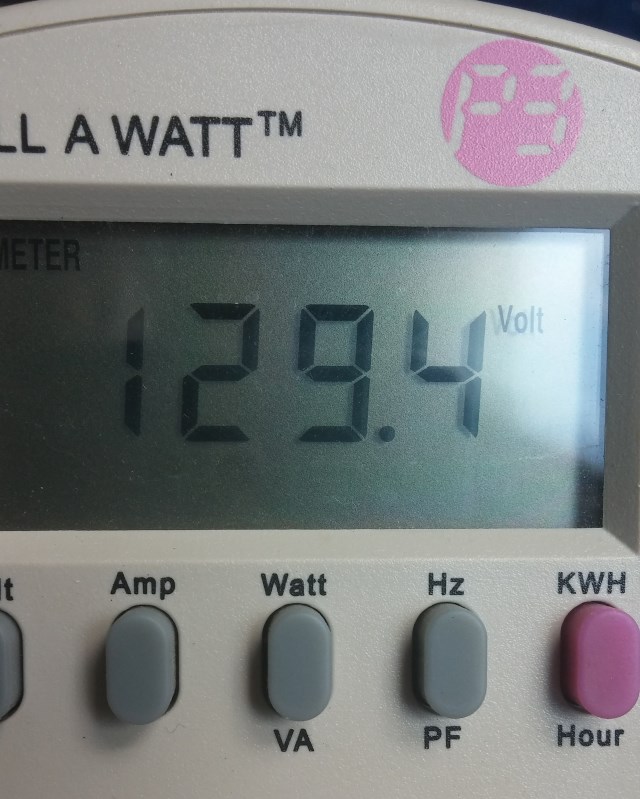

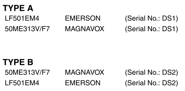

              Also attached, note from service manual confirms my set is TYPE B, given the DS2 serial number. I'm currently using off-grid solar and my inverter is a little high, as shown in the Kill-a-Watt. I'm thinking the Power Supply board is ok. I guess these TVs jump into self-protection mode at the drop of a hat, if that's what it's doing.

                It looks like your meter battery may be low because the readings are showing higher thane normal, I.E. 3.3V shows 4.14V.
                  You are correct. Batteryless analog meter has 3.3V, 12.7V and 21.2V readings dead on.
                  Protect3, Backlight-SW, and Backlight-ADJ are drastically low. The remaining readings are within reason.

                    The 12 and 21V supplies momentarily dip 10% when the red power LED blinks off (but not for the entire duration of the off cycle), as though something is trying to boot up. The 3.3V line does not dip.
                    The digital meter has the little battery icon displaying -- I guess that should have been a clue. I thought perhaps my 129V mains was the cause of high readings. Not so.
                    I tried it when I found it on city power. Same behavior then. My inverter sine wave isn't perfect here but it doesn't seem to affect computers or other LCD monitors. Am assuming it's OK for this TV too.

                      Originally posted by OldEE
                      Not so.
                      If you keep getting 129 V, then expect a bad neutral connection... Let me guess: around 125 V with no big appliances on
                      and then with one major appliance on, it jumps to 129 V and then 132 V or the like with 2 major appliances on, when reading from the leg that's not under high load...
