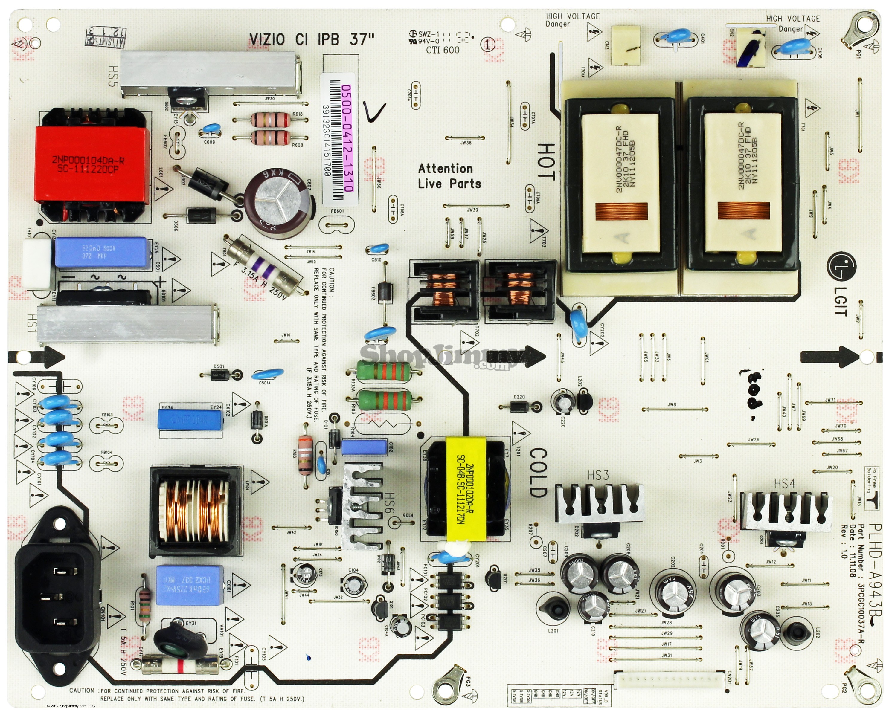

    When first turned on, i think I see some faint blue-ish light from the top left corner (looking at the back) through some of the holes in the metal backplate. But this only lasts a second or two. Can't tell if this is the backlighting trying to fire off, or something else.
    After not getting anywhere, I decided to inspect the boards more closely. The only thing I could find that might be a possible cause of fault is what looks like a small dead bug (ant maybe?) laying across two legs of a mosfet.
    Looks like "Q602" on the power supply board (see pictures). Not experienced enough to know what 2 legs of the mosfet the dead bug are laying across. My question would be could this possibly be the cause of the fault and how could I check it? Also, what else could I check to further trouble shoot this problem. I feel like I am on the right track with it being a back lighting issue. Thank you in advance for any assistance.
    Re: JVC Model: JLC37BC3002 - Backlight not working
    https://www.badcaps.net/forum/attach...6&d=1507079126
    That is the is the NOSFET for the PFC Voltage booster circuit. is he 3.15A fuse close to it good?
    You need to verify that you do have 3800~400V DC between the two legs of the main filter cap, the backlights inverter circuit needs that to operate.

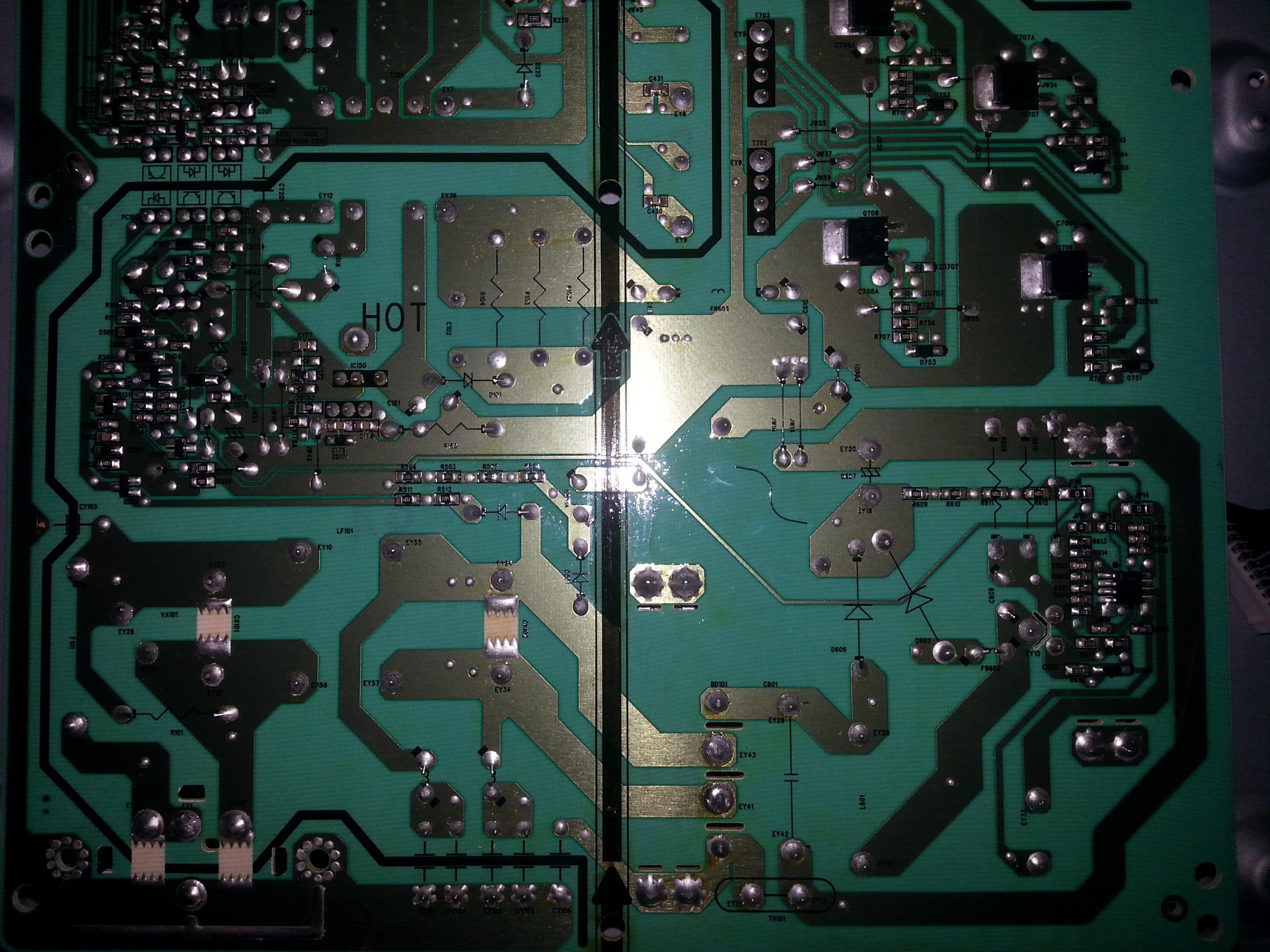

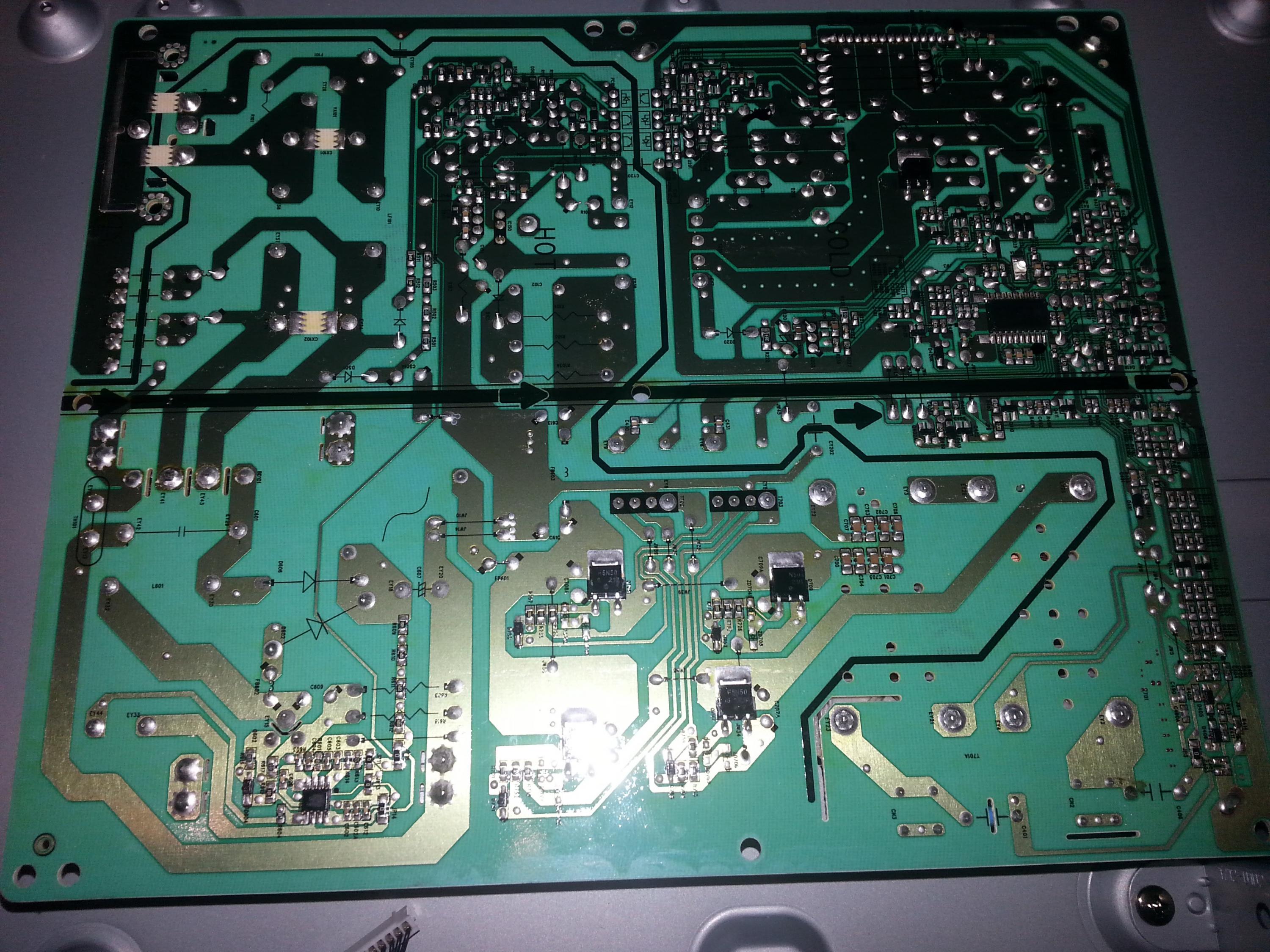

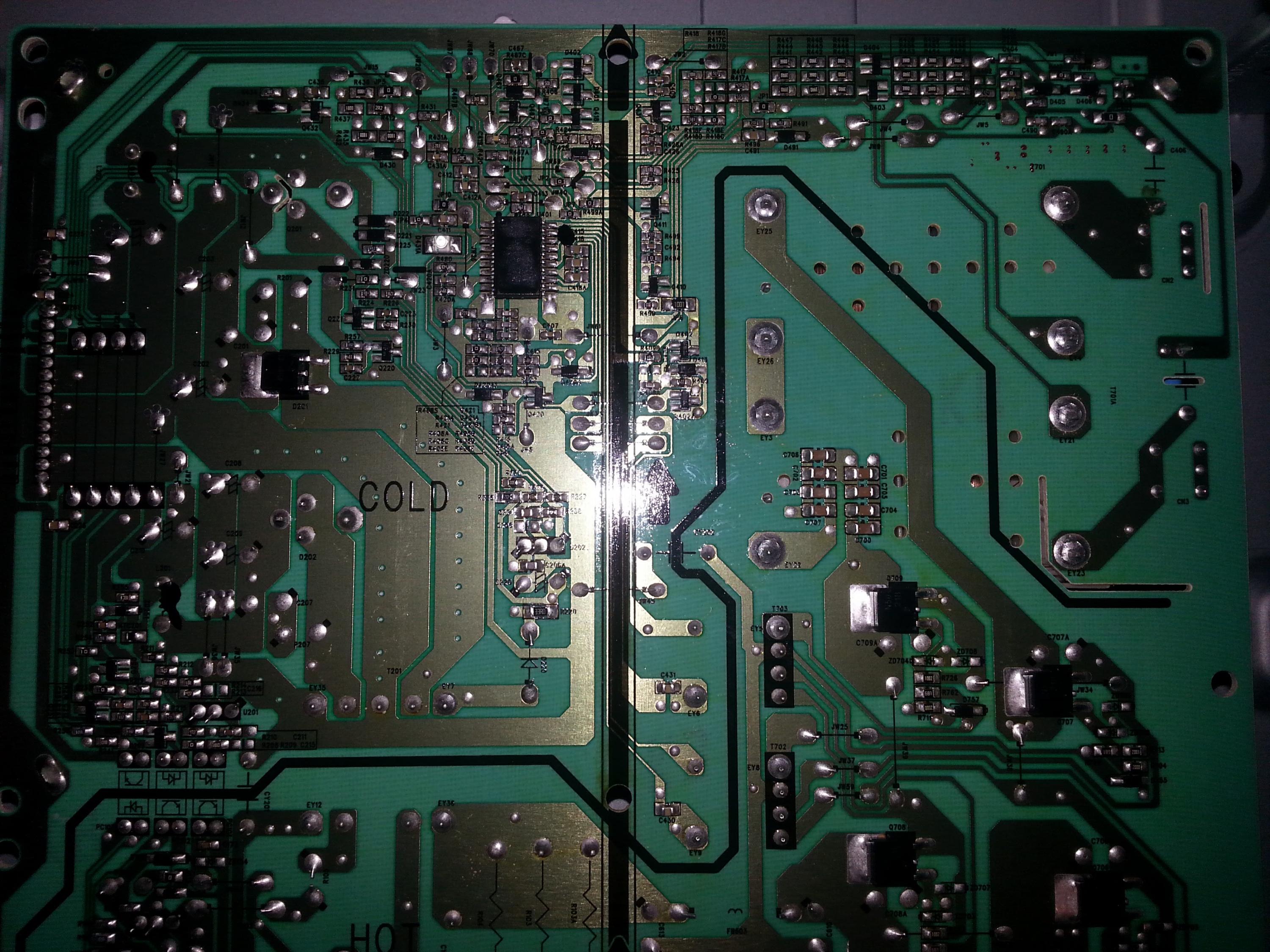

                  Post a pic of the back of the power board.
                  • kyrinth021883
                    • Sep 2013
                    • 40
                    • US
                    I have taken some, please let me know if you want me to try to get better quality or closer up. I can try.

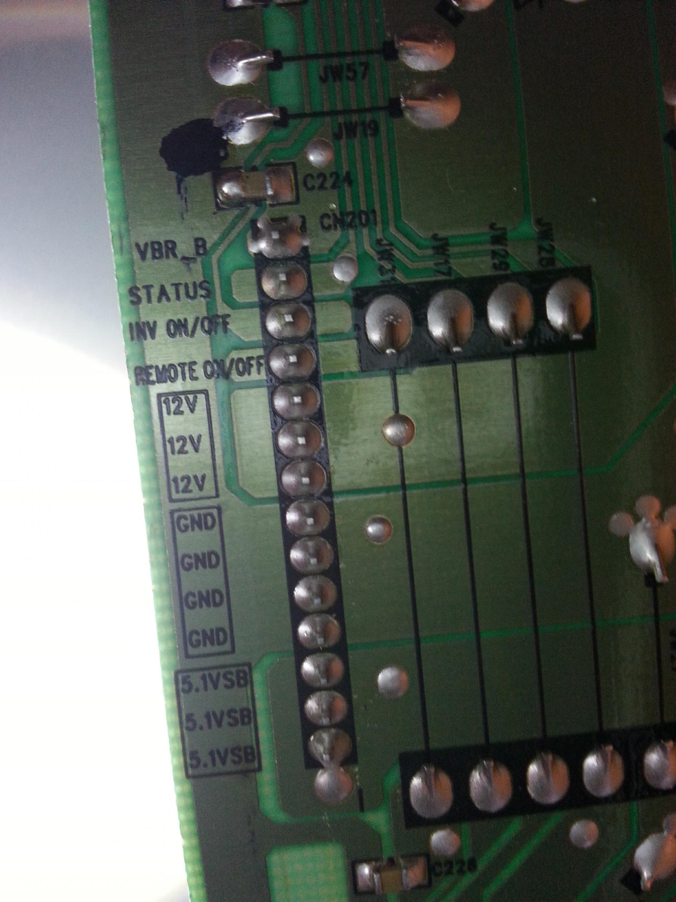

                        Can you post a picture of the underside of the board showing what the connector pin names are.
                        • dick_barton
                          • Aug 2015
                          • 6643
                          • Wales

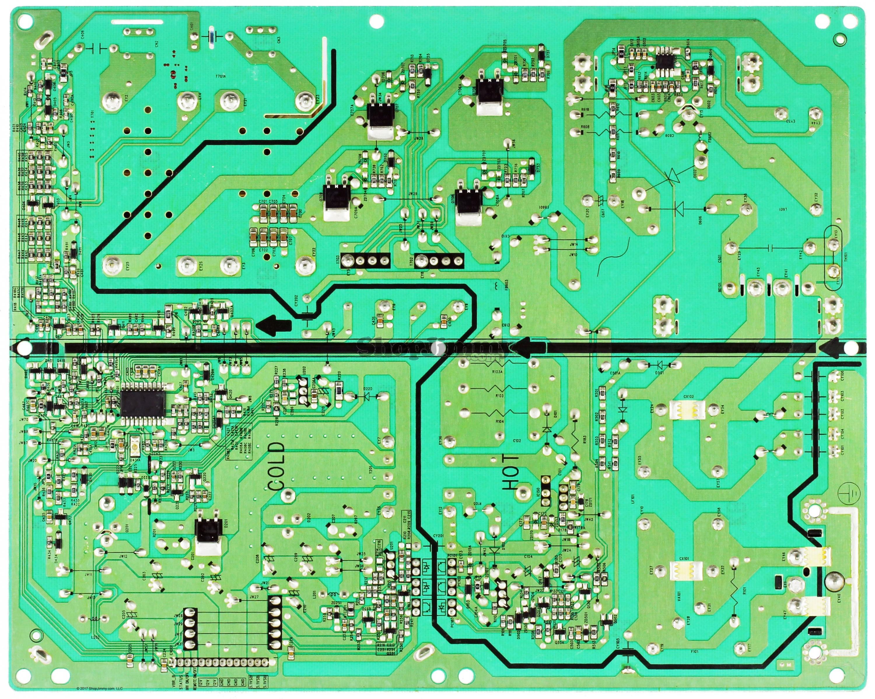

                          Having the correct pinouts as seen from underneath the board it looks like you have to jumper 5.1VSTB to Remote ON/OFF and 5.1VSTB to Inv ON/OFF using the resistors and then check that your backlights come on and stay on.
                          Explains why your 12V did not come on in the previous test.
                          Photo's courtesy of Shopjimmy
                            Hi, sorry it took so long to post a pic. Couldn't take one until I got home from work. Here is the pic you requested.
