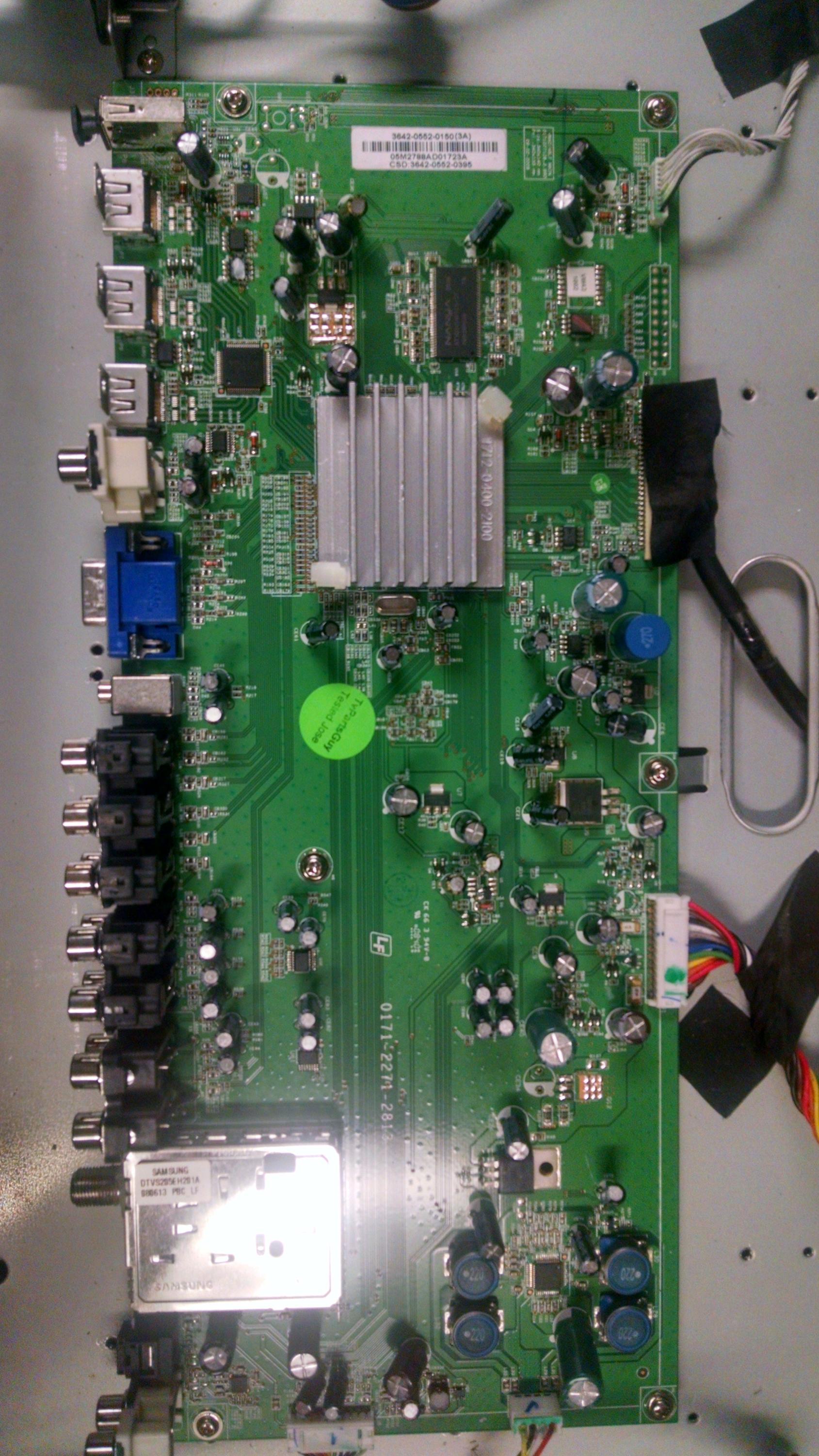

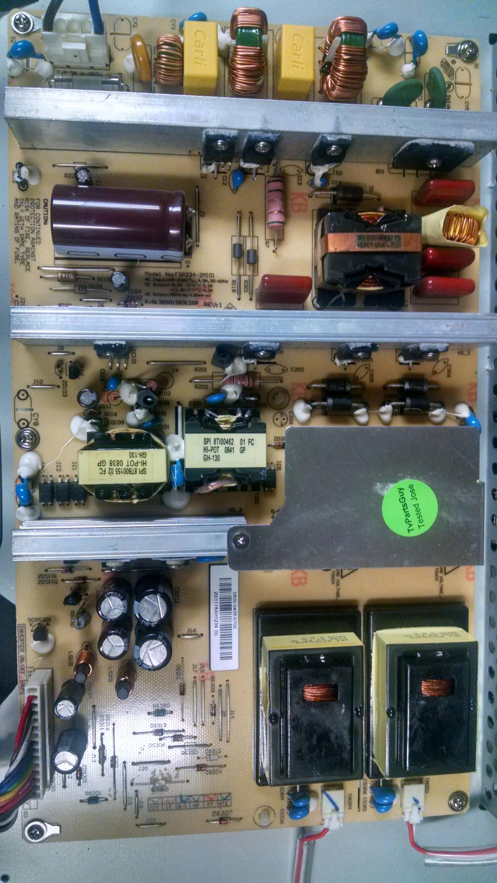

      Here are the board's

                          Pic 1 Inverter board Slave
                          2 inverter board Master
                          3 Main Board
                          4,5,6,7,8, Power Boards
                          if you want me to tell you which is the T-con board and other boards just send me a pic Attach. of the hole back of the tv with the back off.

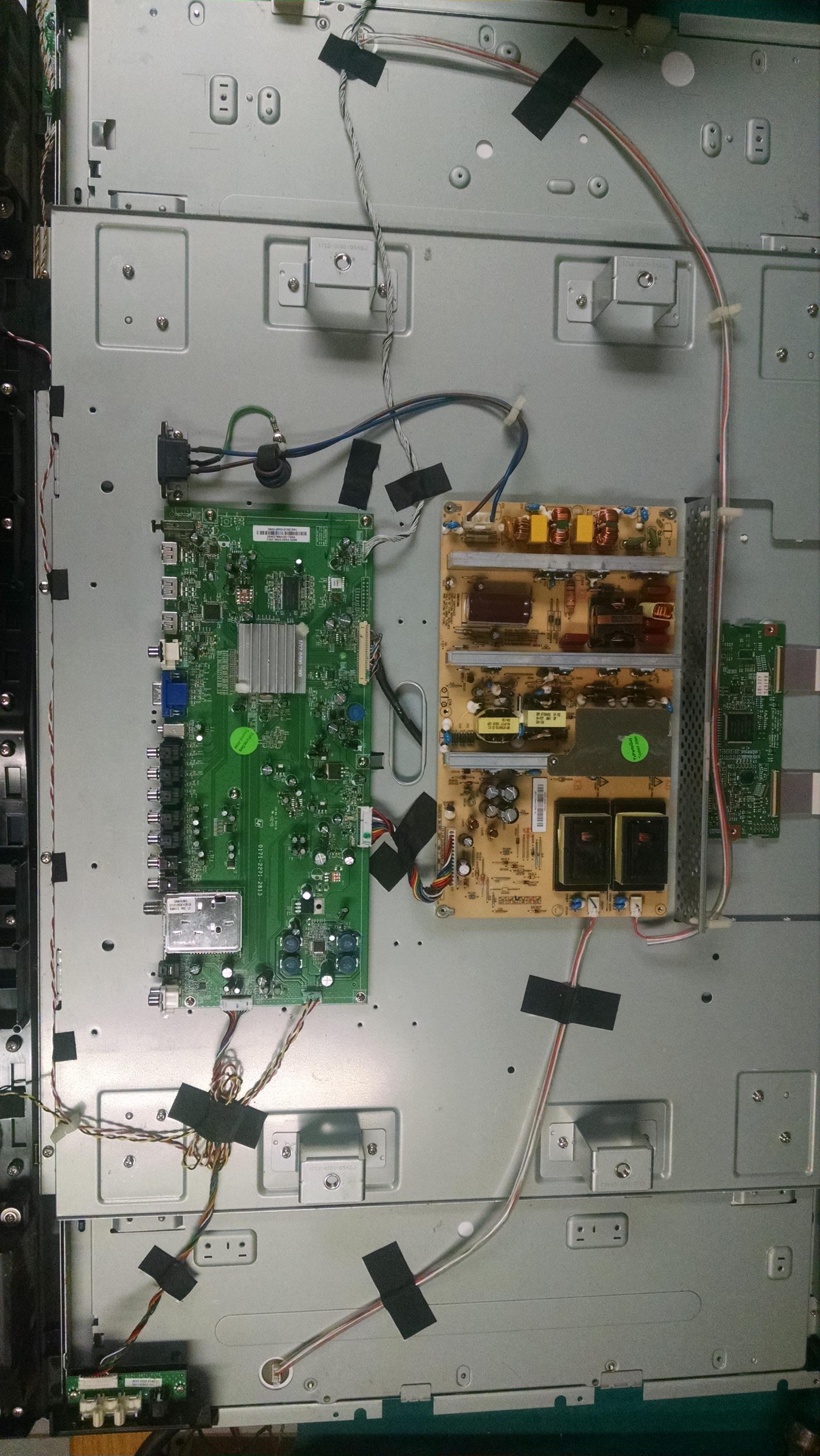

                            Here's pic ivtec

                                https://www.badcaps.net/forum/attach...0&d=1504739218

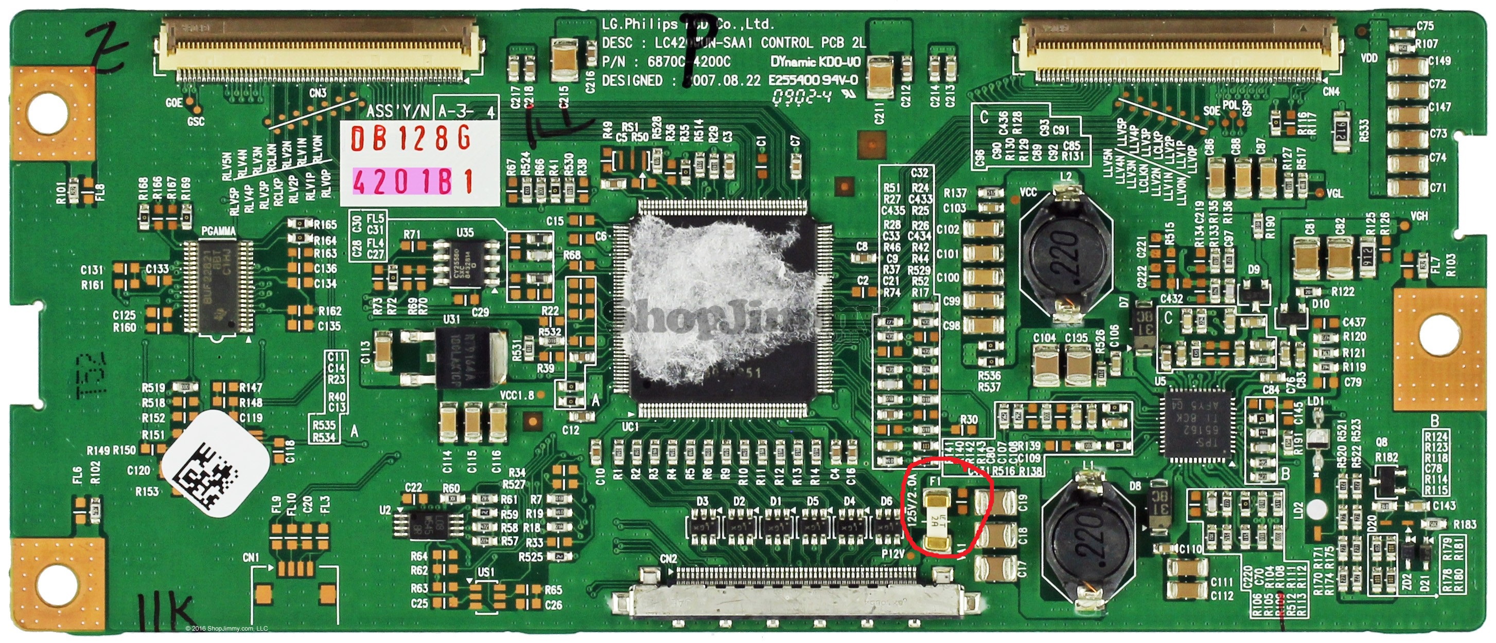

                                the big green board is the main board, the yellow/brown board to the right of the main board is the power supply-inverter combo board, the small green board to the right of the power supply-inverter board is the T-CON board.
                                The small green board on the bottom left is sub-input board. There should be another mall board where the power switch is located, we need to verify t hat the power switch is sending the signal to the main board or not, if it does not then there will be no PS-ON to be sent to the power supply-inverter board.

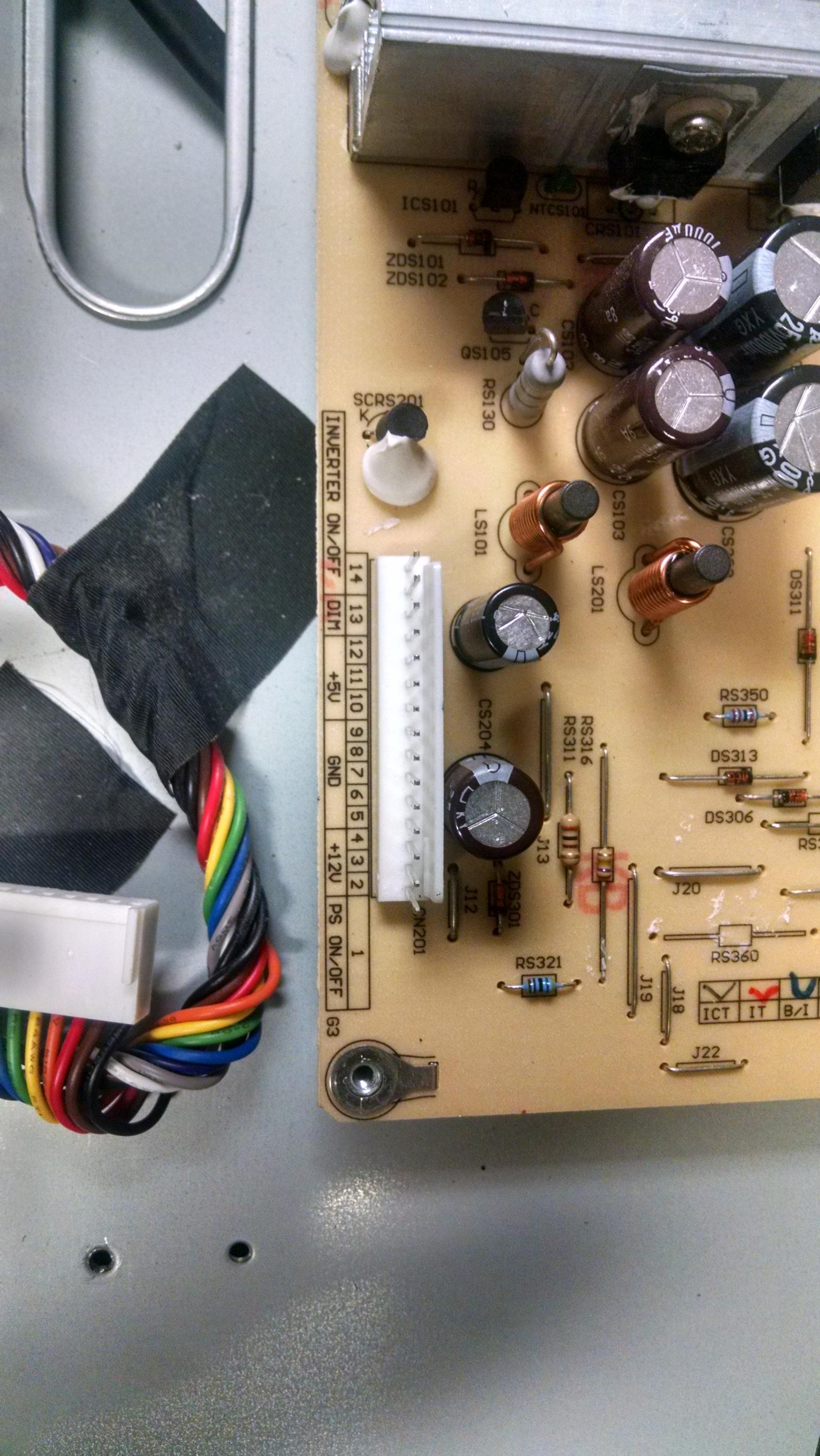

                                  I'm getting 3.3 vdc to power switch but not on ps_on while pressing power button. On the power supply/ inverter I get 4.9 vdc on all 5vdc pins but nothing anywhere else. Pic is the power supply pins, I unplugged it so you could see

                                    Marked T-con with a red circle and T-con board fuse check it if you have 12v both sides , i think.

                                        i checked the fuse and it is good
