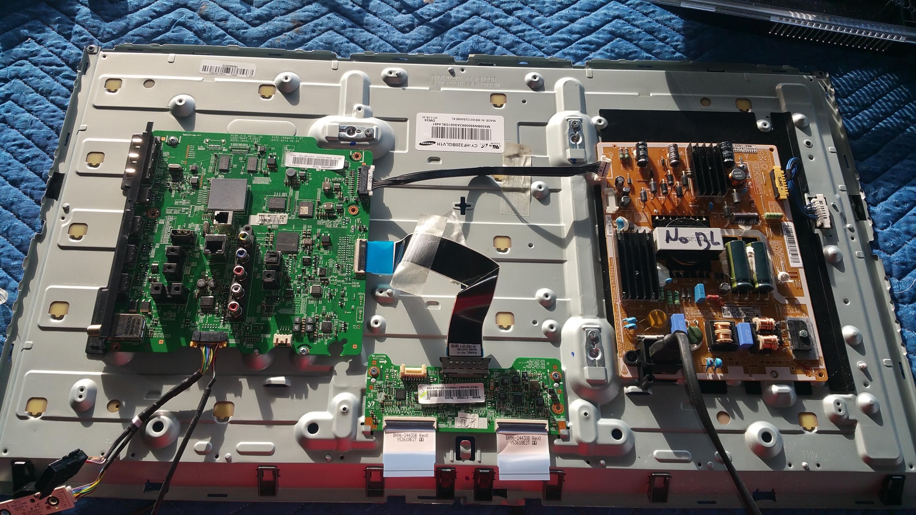

    Samsung Hospitality HG32NB690PF x7 No Backlight
    I got a lot in of Samsung Hospitality TVs... They all have the same problem.. They got power, they got sound, they got a picture, they just don't have any backlights..
    Usually, if it's an LED strip issue, the LED strips will flash momentarily and that's it...
    These are not doing that. Which indicates the Power PCB is at fault.. I find it hard to believe that 7 TVs would all have the same problem at the same time, but that's what it's shaping up to be...
    I was hoping someone might be able to go over voltages with me and see if I can get just one working...

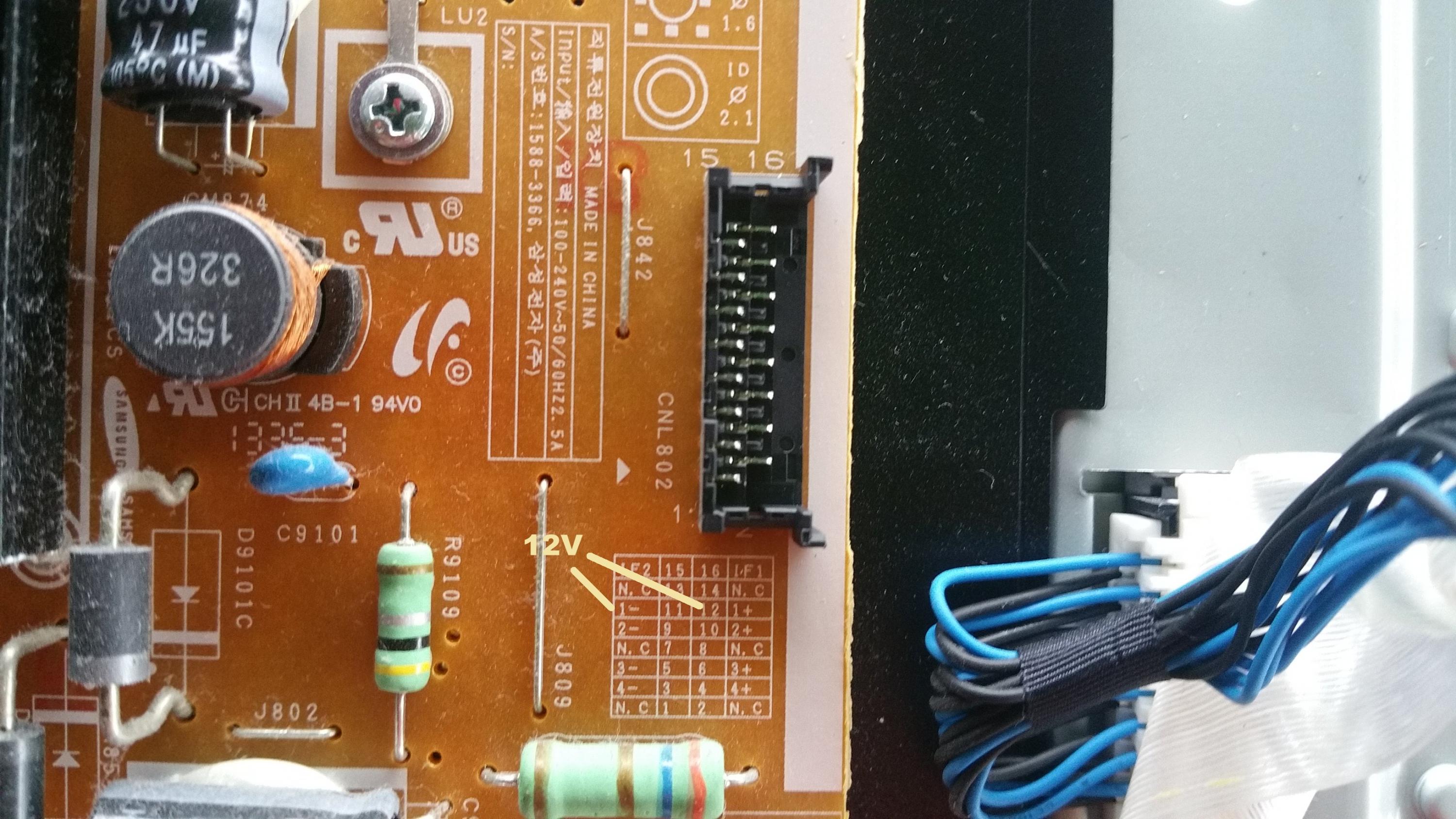

    first thing that i would do is disconnect the cable that leads from ps to main, apply power and see if backlights come on.
    next, check all voltages on the cable that go from ps to main and list for us all to see, in stby and when power is applied.

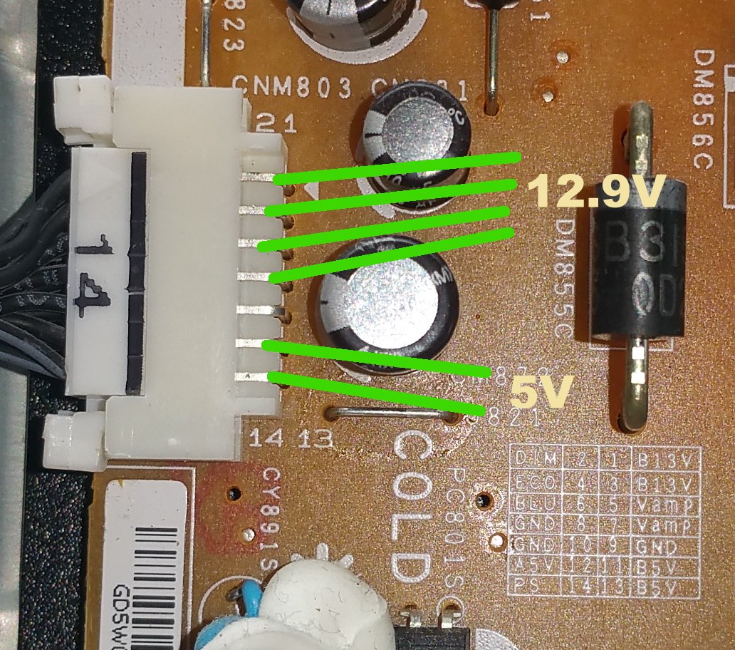

      Thanx for the reply
      No LED backlight when I unplug the cable between the PS and the MAIN board..
      Voltages listed in pic

        You need to measure the EVEN Column pins which are on the bottom side of the board or you can probe them on the backside of the connector. You have 14 pins total.
        I.E. Pin 6 is BLU (BL-ON) signal pin as shown on the printed chart next to the connector.

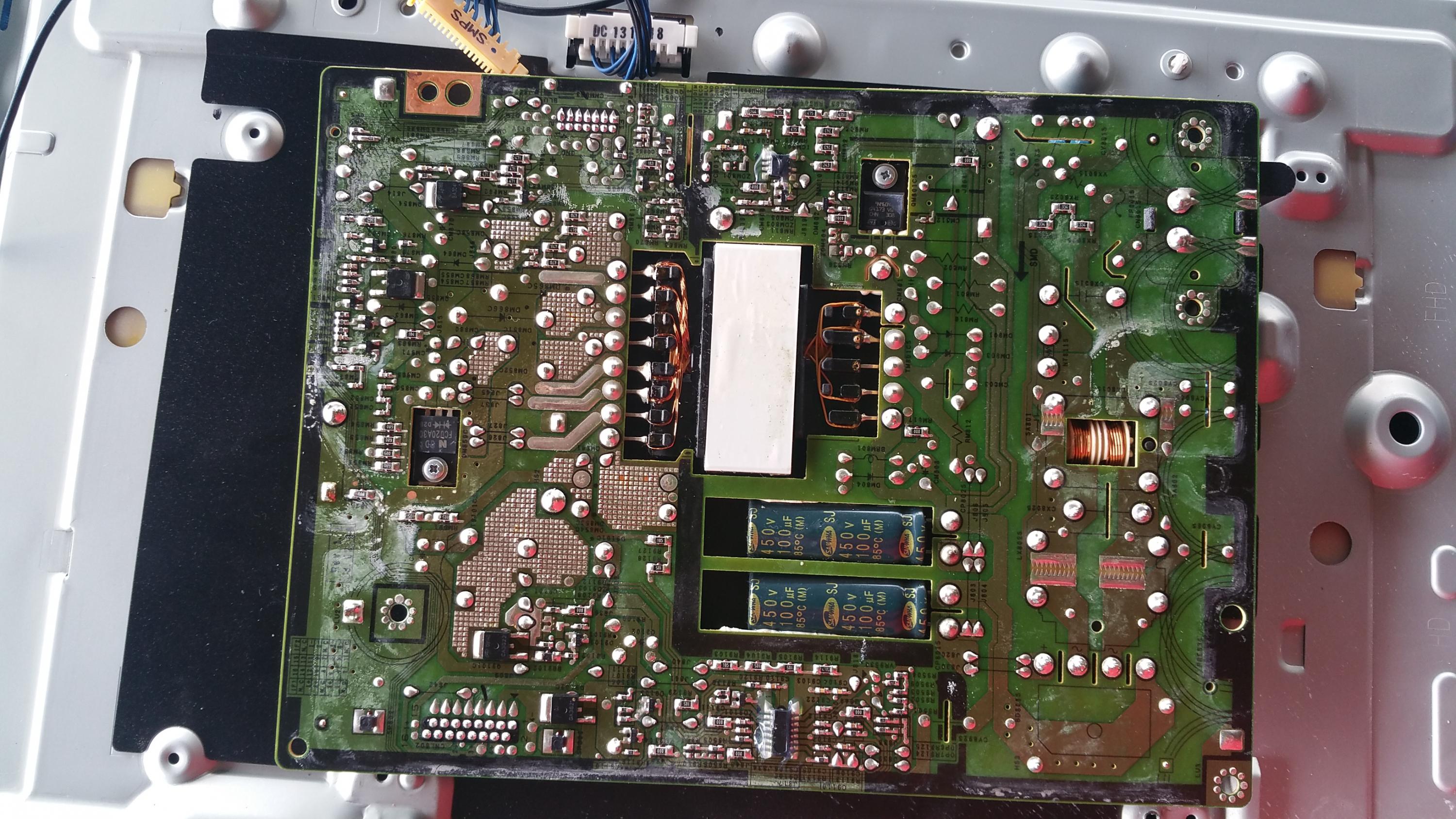

        We also need straight shot pictures of the top and bottom side of that power supply board.

          Thanx for the reply...
          Pics attached..
          2-DIM 3.1v
          4-ECO 0V
          6-BLU 5.1v
          8-GND
          10-GND
          12-A5V 5.2v
          14-PS 3.3v
          All voltages were read when the TV is powered up..

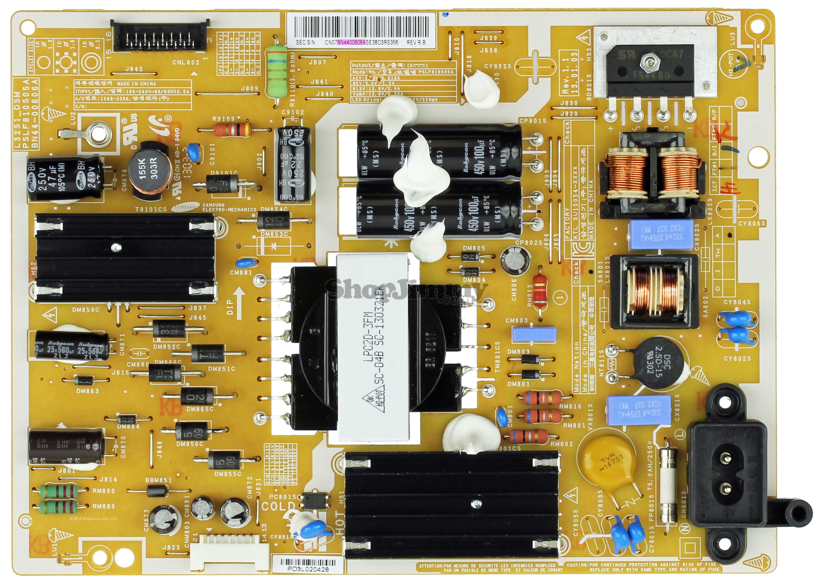

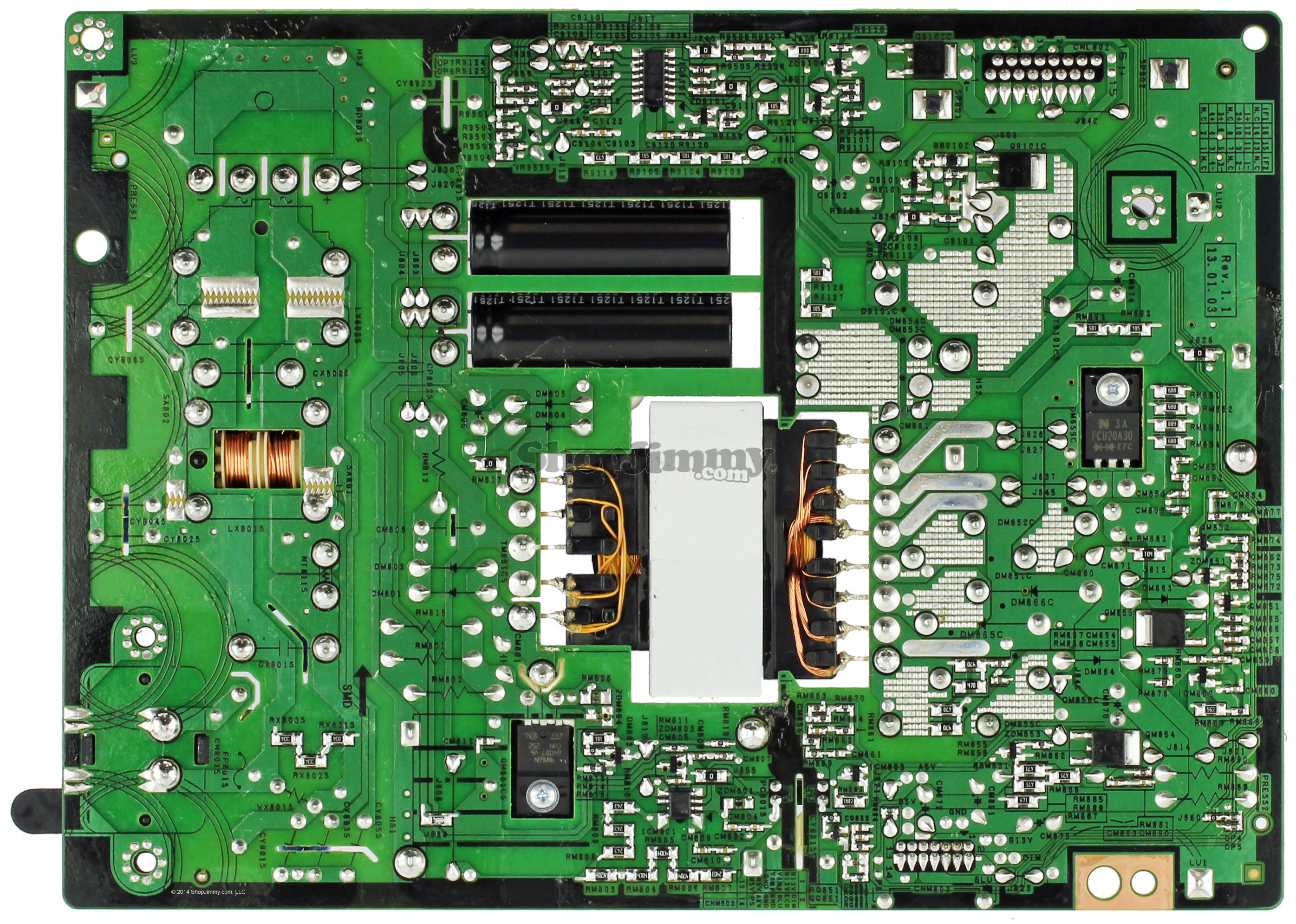

            Re: Samsung Hospitality HG32NB690PF x7 No Backlight
            Power supply board is BN44-00606A. Loaded LED power supply Voltage looks to to be 160VDC 320ma as printed on the board.
            Put meter's probes between the two legs of the LED Boost converter filter cap C9102 then turn on the TV to see how high the DCV goes up to and settle down to after 5 seconds.
            Pictures provided by shopjimmy.
            http://www.shopjimmy.com/samsung-bn4...led-board.htm#
            BTW, if you are going to work on lots of TV with LED backlights, you should get similar tool to this one:
            http://www.shopjimmy.com/sid-gj2c-le...ght-tester.htm

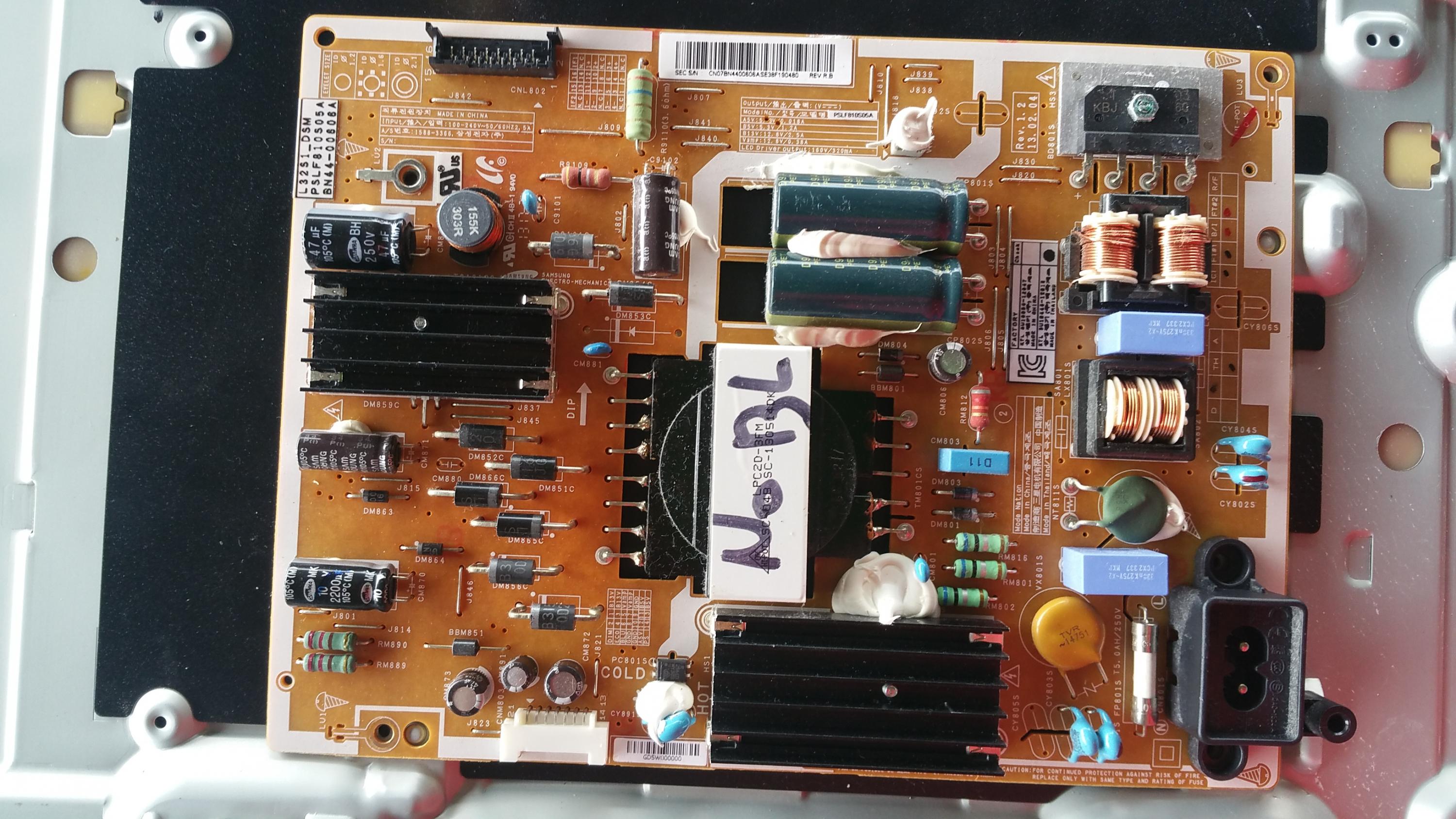

                    OK This is interesting...
                    I pulled a TV out that has been untouched... I cracked open the case and put my meter on C9102...
                    At standby, it registered a steady 107V.... At power up, it shot up to 223V, then counted down to 195-ish and then back up to 223-ish then counted back down to 195-ish, then back up and so on and so on and so on...
                    I pulled the LVDS cable from the Main Board, just for sheets and greens..
                    Power up the unit and it C9102 goes up to around 122-ish and hovers there...

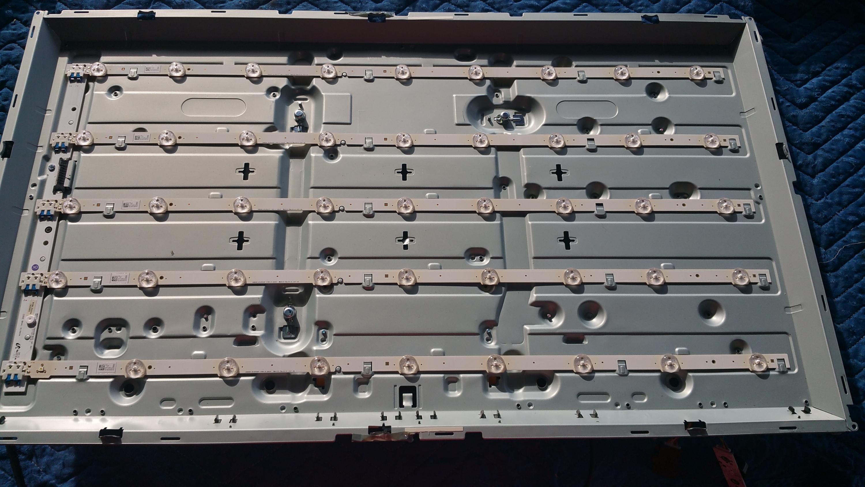

                                        So likely a bad LED strip??
                                        Anyway to test it short of an LED Strip tester??
                                        If not, any way to kludge something together until the one i ordered gets here??
